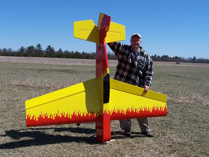

ORIGINAL: craigteffe
Hey Guys,
here is my latest project, a OMP Hybrid Edge 92 wing span weight in at 16lb 10oz. Should fly great with the DL up front.
Ohhhh yeahhhh! You're going to love that Hybrid.
I have a MVVS Prosport 58 in mine. What a monster! Mine ended up at 16 pounds 7 ounces.
