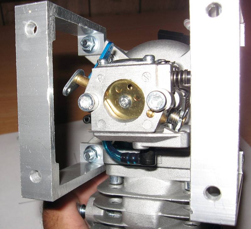

Default RE: DL-50 engine
May be difficult to see in these pics, but is a shiny coiled spring between the carb body and the shaft stop plate, fitted over the shaft of the throttle butterfly.
ID:	899715   Click image for larger version
