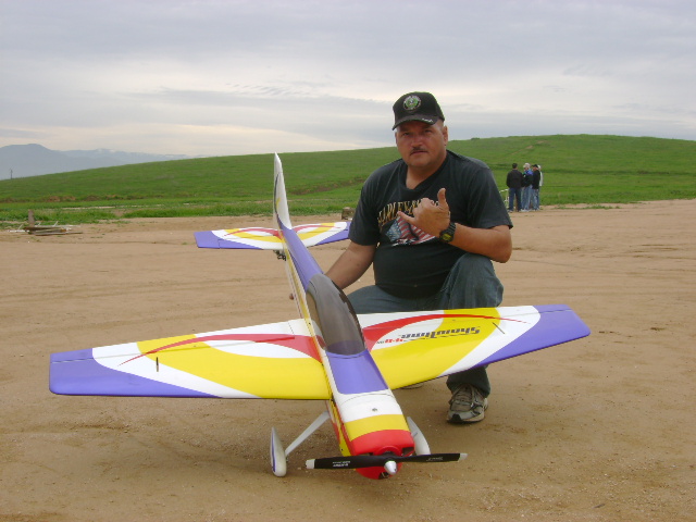

I can't wait to run mine it is almost ready to go on the Giles 202. But the money treee dried up tell next month Still need a prop and a couple more servos. Oh well it gives me more time to fly my other planes. This is the one that I am having fun with now
