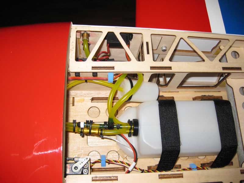

is that a header tank you are using beside the main tank?sorry i just dont have as much experience with this type of engines and or aircraft,i do run a header tank on all my helis,looks great by the way,i really like your setup on the tanks and a nice clean wire routing,

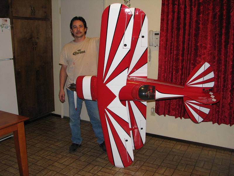

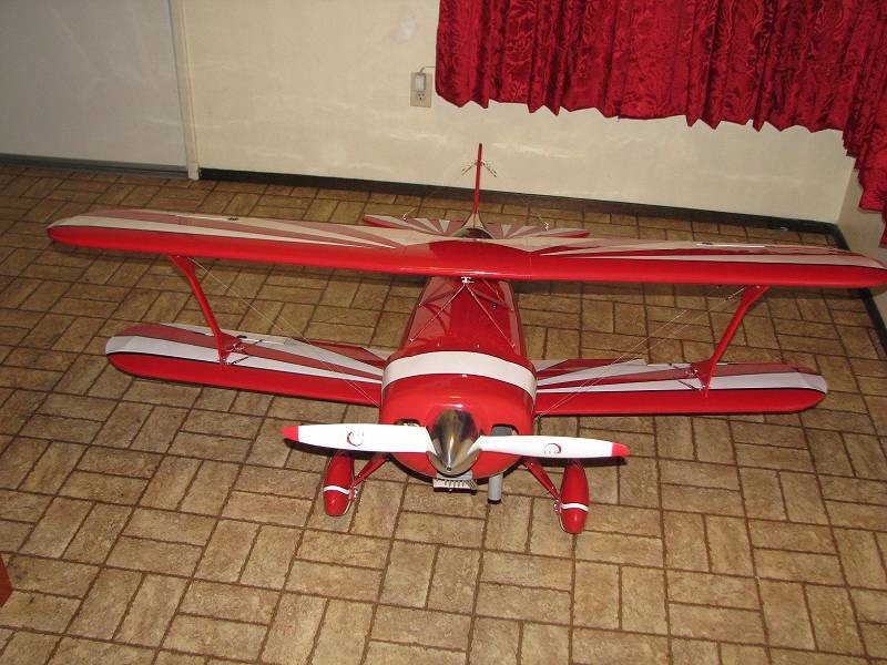

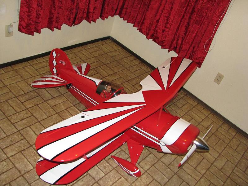

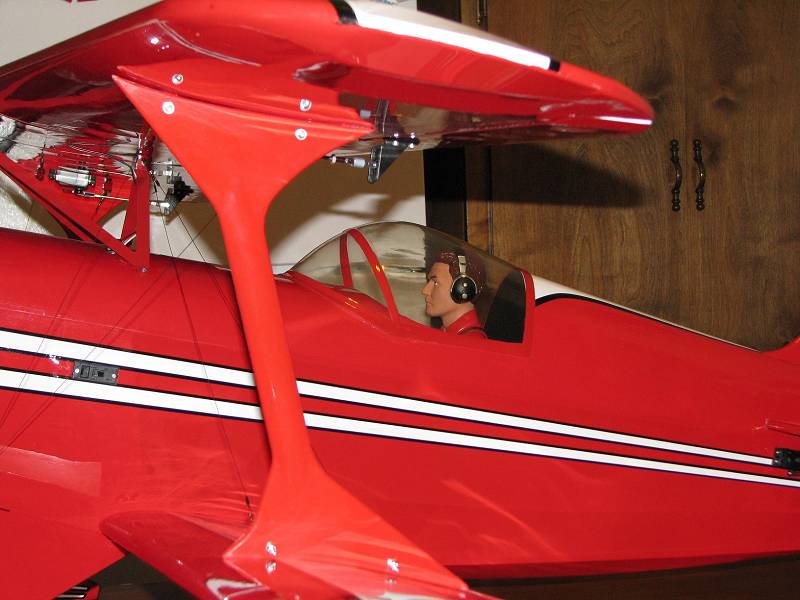

by the way heres the pictures of my finished GP pitts special with the DL 50 and a Xoar 22x8,i have not yet started the engine,need to program the radio and break in the motor,but im happy it is almost ready for its maiden flight
wish me luck guys
wish me luck guys
#2730
Beautiful plane switch (why am I complimenting someone on an ARF?).
Show us some engine install pics.
The Pitts is my favorite airplane of all time. I wish GP would have not discontinued that one. Sad. Take good care of her. [sm=regular_smile.gif]

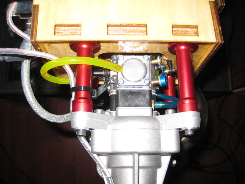

thanks for the compliment Tim,i agree with you,Great planes should of never stop production on this beauty of a plane,well hey i already posted the engine install pictures but ill doit again soon,just give me a chance to take the cowl apart,i made my own spark plug wire clip to hold it from swinging around,i could of went with something very simple from the hardware store but im way too picky and didnt like what they had,the outo parts store have the spark plug wire looms but still not good enough for the price,
anyway i had to drill a 1" inch hole on the firewall for the proper air flow for the carb,i wound a couple turns of fuel tubbing to hold enough fuel in the line in case i deside to go on a vertical downline so the engine doesnt quit,the GP pitts has a very different way of mounting the fuel tank and the firewall has very limited space for anything,i hope the next giant scale plane i get is not as complicated as this one to convert to gas,
this plane was design with the nitro engine in mind and the manual doesnt include instructions for the gas engine,i also had to relocate the throtle servo and re-enforce the engine box to accomodate the DL 50,well anyway the build went well and i should maden thins beauty soon,ill try to get some footage if i can and will post here for every one to see,dont expect much though im not very experience with planes but will try to keep it safe and fun as posible

ORIGINAL: switch26
Hey, don't go taking the cowl off just take more pics! If you want to post pics, just post the ones you already have again (you saved them in your computer, right?).
I think most of our recent stuff is easier to setup for gas as we are getting into that more and more.
A few years ago I had to do some vibration testing on an engine. We mounted a prop with one of the tips cut short onto a Pitts we had leftover from development or something. Anyway, I had to go out and fly the Pitts all day long and it was surprisingly easy to land - let alone fly and takeoff. When I was asigned the Christen Eagle project (which is the same basic airframe as the Pitts) we found that the C.G. could be moved farther aft. What I'm saying is when you balance your Pitts at the recommended C.G. this will be a good thing because she will be plenty stable for your first flights.
Let us know how it goes!
Tim

ORIGINAL: switch26
mstam1971
mstam1971
