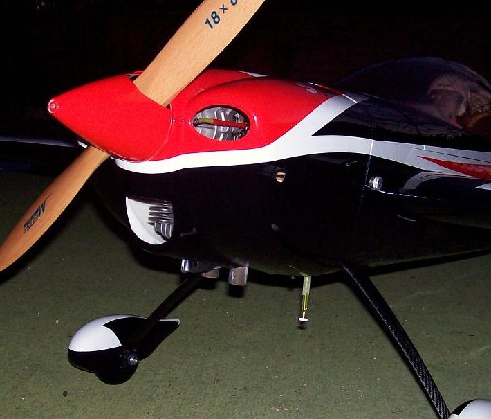

jedijody,
What brands of pitts style exhaust do you have nowor can obtain that work real good on the DLE30?Any gain or loss on engine performance with them? Thanks Capt,n

Default RE: NEW DLE30!
Check the website John, no performance loss on them at all and pretty compact.
ORIGINAL: jedijody
I agree with you, jedijody. A very good product for the DLE30.
