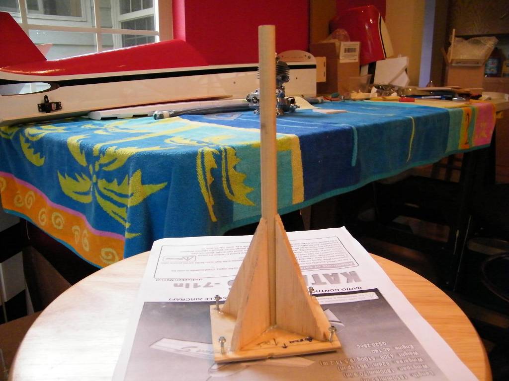

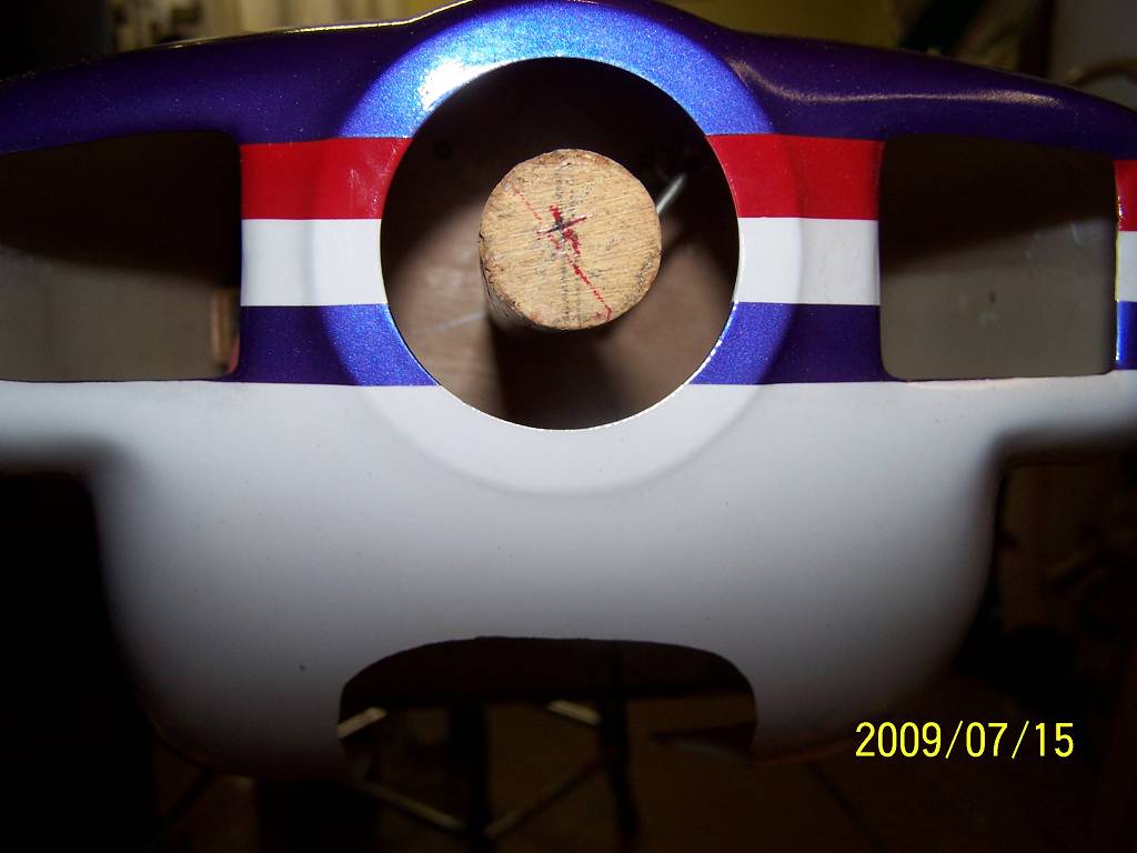

ORIGINAL: kerwin50
Does anyone have a engine mounting template?
Do you have the engine Kerwin...just place the stand-offs on engine and place on a flat surface...this works for any engine. Just have a piece of white paper and mark them.
I hate to add this...but there is a lot of guys that are not even trying to think on there own. I call it lazy.
Old 03-05-2011 | 01:37 PM
  #4497
Joined: Jan 2006
Posts: 88
From: alamogordo, NM
Default RE: NEW DLE30!
Its not lazy Cap'n. The templates have the centerlines drawn which make it easier to line up w/a firewall that has those lines etched on it so you don't have to guess at the location for the cowl's center or add unwanted up/dn thrust.
Old 03-05-2011 | 01:53 PM
  #4498
Posts: 12,957
From: Hesperia Michigan, MI
Sorry I should not have said lazy. Don,t go by the template alone. Do a lot of measureing &amp; checking to make sure you get things right...so you do not need to re-drill. I made a device like Tire old man &amp; Antique uses to center engine so crank will line up on center too. See beolw. Capt,n
