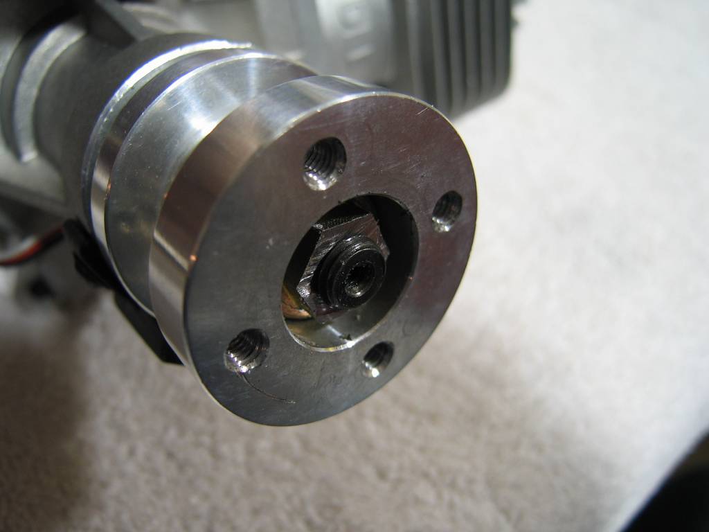

ORIGINAL: jedijody
ORIGINAL: hutchi
Mine came today an after grinding down my thinnest wall socket it still wouldn't fit in the hub have to drill out the hub to accept the socket, but this will still be better than drilling those 4 prop bolts. thanks Valley View
Hold the phone! Drill out the hub? Why wouldn't you just do this?
Very good...but why cut the hex portion back so far? It would be better to have nut flush with crankshaft end. Better holding & more of the hex is there in case you want to remove to do repairs later if needed. Capt,n

Most single bolt hub conversions have a short extension that fits into the hole in the end of the hub..I helps to center the adapter..Doesn't take much...
Drilling the holes in the hub to use larger bolts is no big thing..5mm .8 flatheads are stronger than the little ones the enigne comes with...Takes about 5 minutes..#21 drill and a 5mm tap...
You have to cut a small part of the hex off to clear the centering stub on the SBA. Look at the other picture I posted, it's easy to see there is plenty of hex left to work with. Anyone that routinely strips the hex off of spark plugs should maybe have it done for them.

ORIGINAL: jedijody
ORIGINAL: captinjohn
Jody...post a photo of the end of what you call a "SBA" That may help. Capt,n

SBA=Single Bolt Adapter, that picture wasn'tnecessary, he hadone in his hand.

I had no problem with cutting the hex end, took all of 2 minutes an worked great. glad I didn't drill out the hub for that little centering part of the SBA. now if this snow would go away we could get back to flying.
