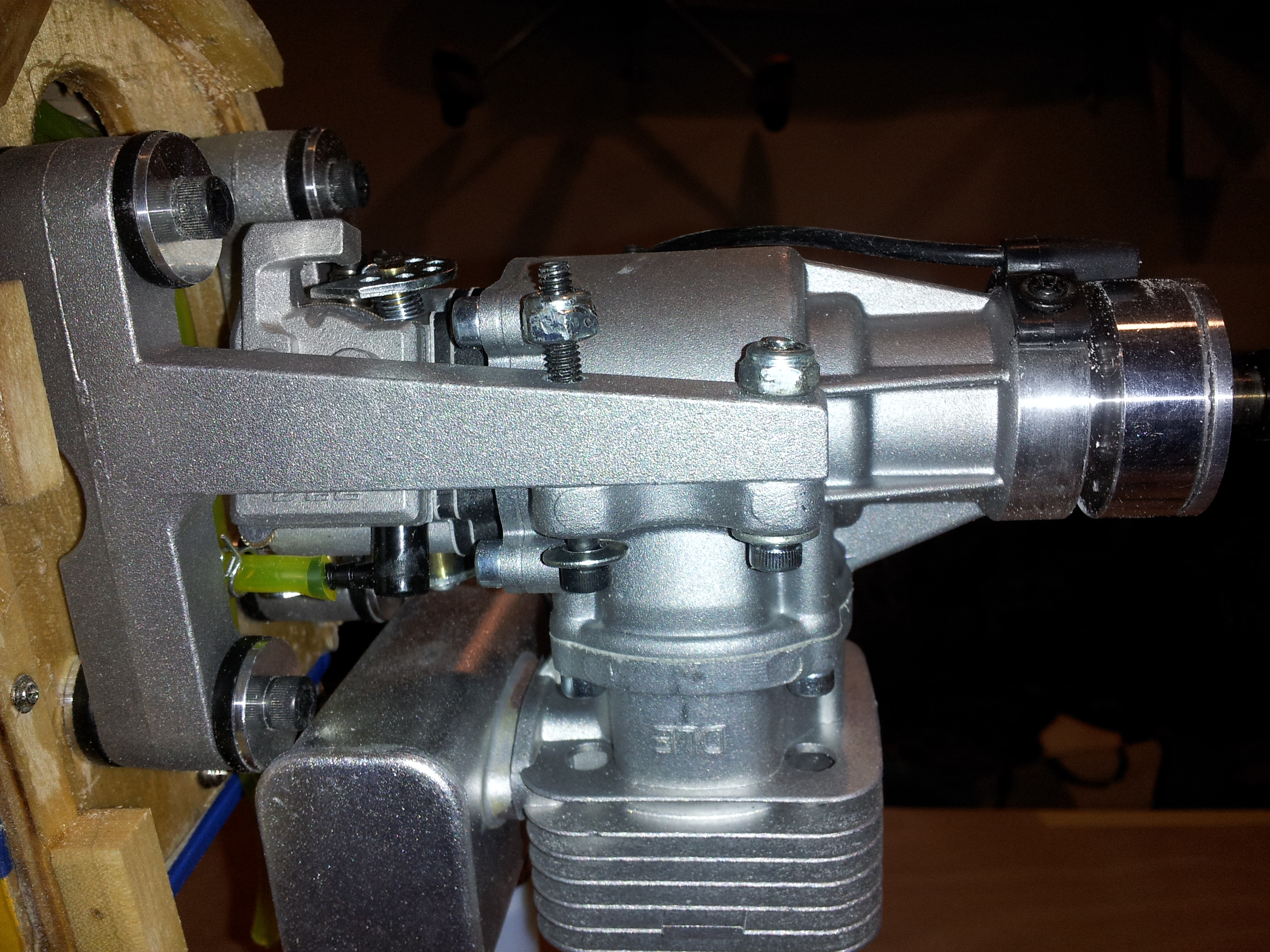

Be careful it wouldn't fit the rear mounted muffler dle 20 ra unless it's all the way to the tip of the mount
Old 01-07-2014 | 07:06 PM
  #6670

here the picture the muffler hit the rear bolt and the motor is at the end

The muffler hitting the rear bolt is not a serious an issue as the muffler hitting the washer under it! The bolt can be changed for a flatter type, but that washer has no place to go.
