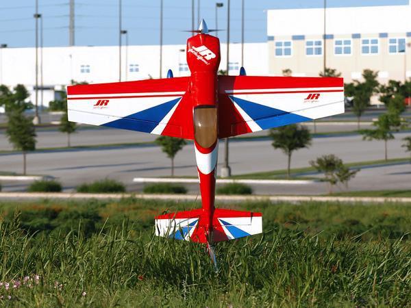

I fly a 3d profile with a OS 55AX. I only got a 600rpm increase using a Jett / Evolution performance exhaust over the stock muffler with baffle removed. APC 12x4 13,900 vs 14,500 rpm. I heard that stock the Evolution 60NX has a throttle transition delay which makes the engine junk for 3d, however several people with the performance tuned exhaust said the engine was transformed.
So does this engine transition a lot quicker with the Jett clone muffler? Good enough for 3d? Can it be modified for a front needle valve, does this help?

Throttle delay is probably due to using a remote needle valve. Evolutions used to ship with fuel lines to the carb that had a very small inside diameter. It would seem that using a larger id line would put the engine on par with other 2 strokes if a throttle delay is noticeable. I would question the 'junk' statement because I notice the delay on most engines myself.

BLW, I'm not so sure on your theory about the ID of the fuel line. The fuel is regulated by the hole in the spraybar, and thats smaller than the ID of the line.
I use small fuel line on most of my motors, and most are fuel PIGS (3-4 ounces of 15% per minute) and the small ID is not an issue. There may be a backpressure issue however, but the line is plenty big enough to deliver enough fuel to the motor.

ORIGINAL: AraTidwell
Ok, so I didn't feel like making a muffler with a beer can.... big deal.
That was just one of the tips you ignored.
Others include but not limited to:
1. 13x4 Xoar or APC - the right prop for 3D on a 55AX
2. Macs one-piece #6720 instead of the stock with baffle removed. Saves 2 oz.
3. A Saito 82 seems to work better for beginner 3D'ers
4. A lighter airframe
5. Careful tuning even with the stock muffler will still 3D just fine.
Ara, profiles aren't cheaper but they sure fly 3d better at this size.

I tried a 13x4 APC, the throttle resposne was not as quick and it made slightly less thrust than the APC 12x4.
No one ever said anything about the Macs muffler
I'm flying a poor man's 3d plane, I don't have the extra $150 for a Saito 82 but I agree that would be the best engine
Yes the airframe is a little porky, and to be honest it doesn't 3d that well anyhow... but otherwise it flies very well and smoother than any other profile I have flown. The airfame is also very durable.
Stock muffler with the baffle in was "scary" when trying to hover. It provided only a ounce or two more thrust than weight. The baffle outgave it a decent power boost.
And diss the aeroworks all you want... It will still do knife edge figure 8's with the left stick only. Its a pretty good flying airplane in general.

I flew my Mojo40 with a 55AX and a Xoar 13x4 on the stock exhaust with the baffle for 3 months with GREAT pullout from a hover.
My AUW with the stock exhaust and empty fuel tank was 4lbs. 2oz.
I eventually got a macs one-piece muffer, not for more power, but to save 2.2oz.
Now is seems like it's on more power but it's just the 2oz. saved. Only got a 100 more revs on the top.
But again, it's not the top end that we are concerned with, it's the midrange throttling.
