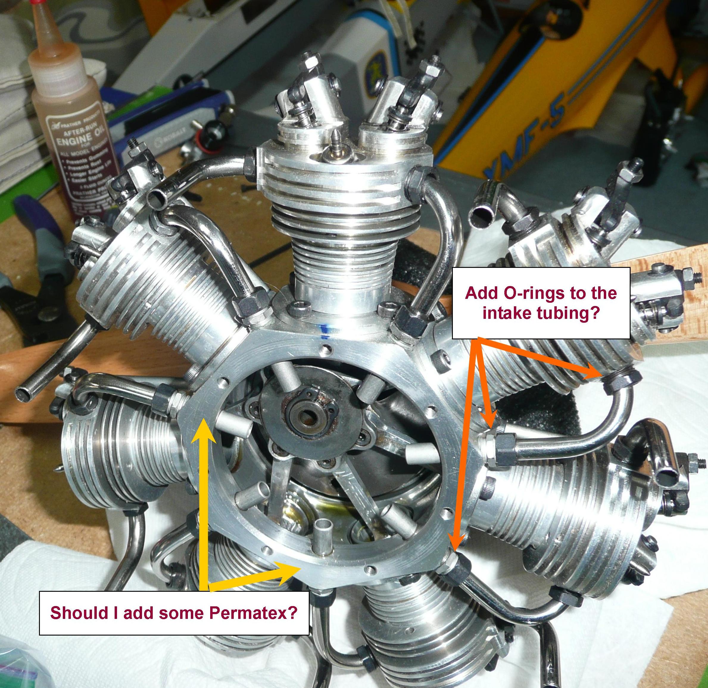

Hello radial fans!
I read that some are having troubles with air and/or fuel leaks on their radials. Here is a photo of my never used Evo 7-35.
Is it necessary to add O-rings under the jam nuts on the fuel intake tubes? Also, is it necessary to add something like Permatex RTV high-temp silicone to the crankcase backplate?
Thank you for any suggestions!
–DJ

O rings should already be installed on the intake tubes. Someone else got a 7-77 and it did not have O rings. Obviously the guy was not happy! A very thin layer of RTV or gasket seal would be fine. -Tom

  #2288
David Johnston's Avatar
Joined: Nov 2007
Posts: 52
From: Roseburg, OR
Post
Good advice - thank you Tom!
thanks for your words, Maxam
I used teflon tape to seal the exhaust ports to the exhaust ring Instead of the supplied washers and I have no leaks and also acts like a threadlocker.
regards
Old 01-13-2018 | 10:46 PM
  #2290
Joined: Nov 2007
Posts: 52
From: Roseburg, OR
regards
Hello Fulcrum - Teflon is probably an even better idea because I won't have to search for the correct O-rings.
Thanks!
--DJ
