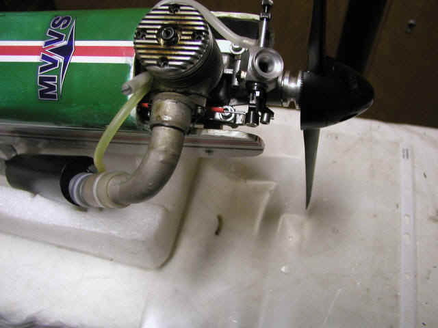

Okay, I'm really liking my .40, but I'd like to try a standard muffler, so I can easily install the engine in different planes. The Morris site lists a #3245 for "trainers". I did a search and found out that there are two types, 3245 and 3245a. The "a" is quiet and apparently robs the engine of a lot of power. The morris site didn't list any "a" variant, just 3245. Is there a big drop in power with this muffler compared to the mini tuned 3248 silencer?

I can recommended you this muffler

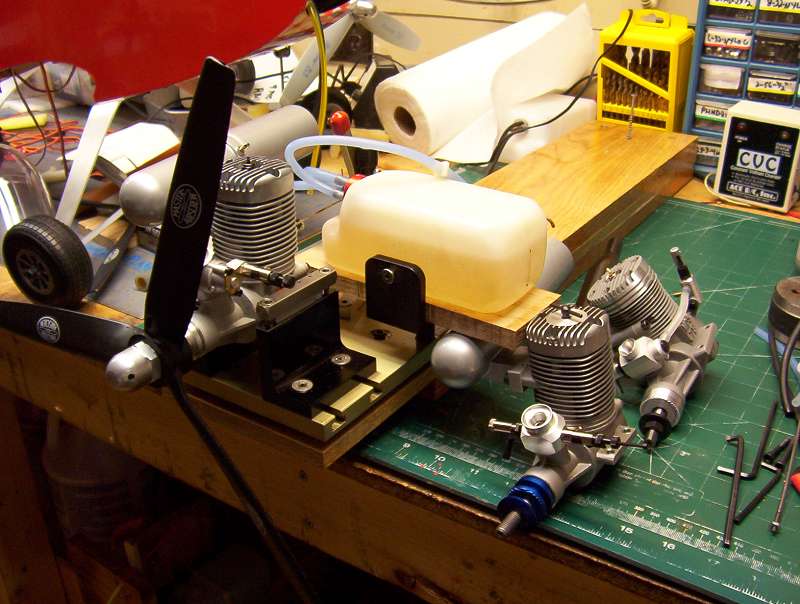

This one on the .91 is a 3255A, same on the .61 below and right of it. Neither had any metal in them, the .91 is yet to be run, the .61 has been run on glow and then the Diesel head was put on. The standard "dustbin" muffler is a little loud for my taste but not bad. The .61 lost 200 rpm with the 3255A as a glow, no diff. with the Diesel. Go here and click on Silencers "http://www.mvvs-nl.com/index.html"

The A-type robs some power, as in any aftermuffler, but it is not of a concerning nature. If you cannot afford the power loss, there's always the larger .45 engine in the same housing to make up for it.
Without the A type, the engine could not be flown at our field.
