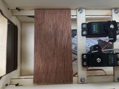

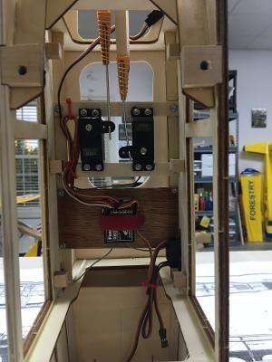

In the old days, when a project reached this stage, you would just wrap your receiver and battery in foam and stuff them under the fuel tank. That’s what the plans show. But nowadays, with smooth-running outrunners you can dispense with the foam. And, if you have an ESC with a BEC, the battery as well.
So, I fabricated a shelf to hold the receiver. And, while I was at it, installed a switch in the recommended location.
Here's the shelf, scrap 1.0 mm ply that I salvaged from packing material years ago.
Here's the shelf fastened to the side rails with #2 hardware.
The two photos above show the Velcro installation.
Then, the shelf went back in and the antennas located inside scrap plastic tubing, both . . .
horizontally and . . .
vertically.
Next up, the receiver switch. Because this connects the ESC to the RX, it has three wires.
Here it is, installed pretty close to the recommended location.
All done.

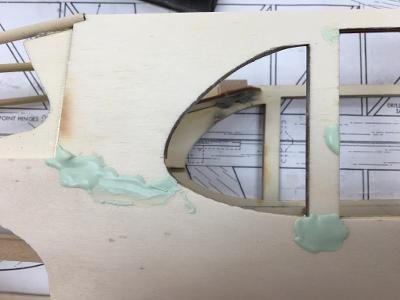

All the advice articles tell you that unless your balsa and plywood are baby smooth, your resulting iron-on covering will turn out terrible. While I have found this to be an exaggeration, nicks, divots, and lumps, and bumps will show up. However, pinholes will not. Indeed, I normally Woodpeck balsa and ply, creating a field of tiny pits, to minimize air bubbles. Those surfaces always appear smooth after covering.
Before I could even think about covering, however, there were some important details to clear up. Well, actually, only two. It was a slow day.
First up, shaping the window cut-outs for the pre-formed windows. Here, I have fitted the front and center panes, but the rear one is giving me ulcers.
A few passes with a sanding drum resulted in . . .
perfect fits all the way around. (The panes look cloudy because they still have protective films applied.)
I decided to enlarge a slot in the bottom of the fuselage in front of the firewall to allow more air flow. The new, larger hole then required some reinforcement.
Air exhaust hole with reinforcement glued on and clamped.
With this, I had created and/or adjusted all the holes intended for the fuselage.
It was time to fill and sand the unintended holes and divots.

Time to fill the dents and gouges. But before I did that, I gave the flat portions of the fuselage some passes with a random orbital palm sander. This works wonders on plywood, removing CA blobs without cutting into the underlying wood as long as you keep the sander moving.
I got this sander for $12 on one of the Amazon Prime days last year (with free next day delivery)! If you keep it moving it's very safe to use on lite ply or anything harder.
My preferred filler is UPOL Dolphin Glaze, a two-part, fast-setting putty that sands like lite ply. It is fiddly to get the proportions correct, but becomes easier with practice. It is also quite expensive and hard to find in local stores, but a $25 investment should take care of at least four large models, maybe more.
Here's what you need to use Dolphin Glaze. From left to right: mixing cup, micro scale, plastic spreader (for large areas), mixing sticks (for blending and dabbing), glaze, and hardener.
On plywood I use an oscillating multitool with a sanding head to knock the glaze almost level with the wood and finish with a 240-grit sanding block.
I got this much of the fuselage filled with about 5 grams of Dolphin Glaze. You can start sanding it in about 20 minutes.
I filled these holes before quitting for the day by simply dabbing DG into the crevices. It hardened completely overnight.
In the morning, despite being as hard as it would ever get, the glaze looked like this after 30 seconds with the multitool sander and 10 seconds of swiping with a block.
Once everything was filled and sanded flush, it was time to do some rounding. The bottom edge of the fuselage should not be a sharp corner, for example. And there were other places where a little softening will look like tubular supports once the Ultracote goes on.
Surprisingly little elbow grease produced a nice radius where the fuselage slabs meet. I was trying for 3/32". What do you think?
Finally, I added a fake stringer to the fuselage side from under the rear window to the tail.

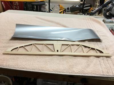

To make this Goldberg Cub look like a Flitfire I chose silver Ultracote. I prefer UC over other brands because I believe less of what’s underneath shows through. I understand that it’s a little heavier, but on the type and size models I build it doesn’t matter much in the end.
I was excited to find a cut pattern in the instruction booklet. But that euphoria quickly faded when I realized that, back in the day, rolls of iron-on covering were 27” wide. Today’s versions measure only 23.5” in width. I think this is called “shrinkflation.”
This cut pattern would have worked fine except that it's for 27"-wide covering. Today's versions are 23.5"
Regardless, I cleared the bench and set it up for covering.
Far end covered with a towel; this is where ironing will take place. Cutting mat at near end.
Even though I knew that the Goldberg pattern was useless overall, I did use it to cut pieces for the horizontal stabilizer and elevator and went to work. Covering these components took until mid-afternoon.
Here, I have Woodpecked and fine sanded the horizontal stabilizer. Then I wiped it with an alcohol-soaked paper towel.
Prior to ironing the covering on the stab.
Covering ironed on but not trimmed or tightened.
Here it is trimmed and tightened.
Both the stab and elevator have been covered, trimmed, and shrunk. I have also hinged them and installed the control horn. The assembly is ready to install.

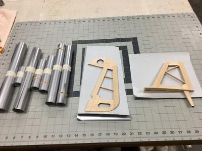

Then, I decided to stop covering and to lay out and cut the remaining pieces. It took the remainder of the first roll for the fuselage bottom, top, and sides. It required a second entire roll for the wing pieces and about half of a third for everything else.
All covering cut to size; much of it rolled back up and labeled.
Having all the covering cut and at hand, I looked forward to getting back to ironing, stretching, heating, and tugging (and cussin').

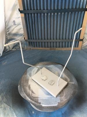

Before starting the fuselage, I visited the paint booth with the LG wires and brackets.
Here they are, painted silver.

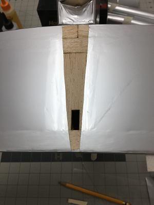

First, I did to the wing what I should have done at first: I skinned the upper center section with 1/32” balsa. This covered the mottled catastrophe that resulted from trying to level that area with glaze.
This should sand out easily and smoothly and cover the irregularities that remained after several applications of glaze.

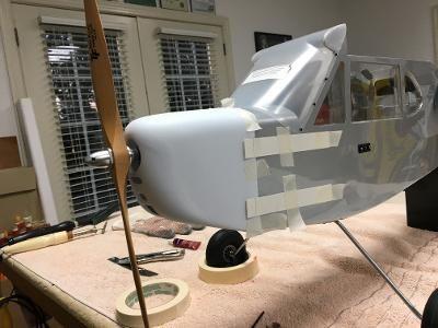

Positioning and installing the cowl.
Here, I have positioned and taped the cowl in place prior to drilling tiny holes . . .
for the M1.7 x 6 chrome-plated sheet metal screws. After the test flights, I intend to paint the cowl to match the fuselage and add some engine detail.

While awaiting my head to get in the right place for the last of the covering, I installed the pilot to the faux cockpit floor. The pictures tell the story better than mere words:
Many of the items needed to fasten the pilot (right) to the faux cockpit floor (top).
Normally, I would just glue the pilot in with silicon caulk or canopy glue. I wanted this one to be removable in case the winner of the model wanted to personalize it. Here, the cardboard pattern is ready to attach to the pilot with double-faced tape.
Pattern stuck to pilot and marked for drilling.
Pilot drilled and screws started.
Cardboard pattern transferred to faux floor.
Floor marked for drilling.
Floor drilled and ready for pilot.
Pilot installed top view and . . .
and bottom.

Installing the aileron servo.
Here, the servo rails have been epoxied to the underside of the wing.
I secured one aileron in neutral while I adjusted that servo linkage.
Finished. The arms offset to the front will provide aileron differential.
