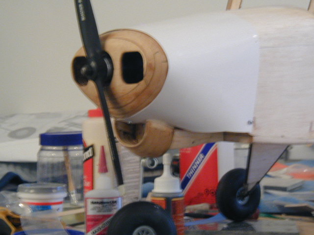

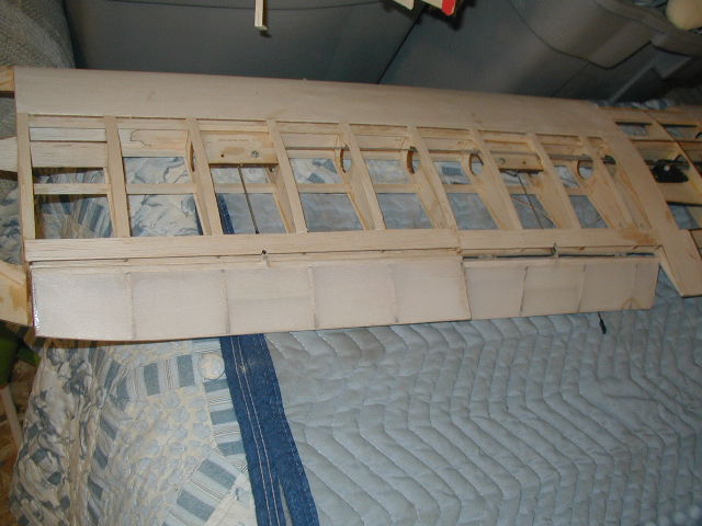

Good Morning. Uhh, Afternoon? What ever. Lots of fotos today. The first few are the wing trailing edge parts with their new Koverall skins. I guess if you've see one you have seen them all. I covered them first just to get the hang of the Sig process. That way I hope to have edged up the learning curve a little when it comes time to cover the wings and fuselage. The last time I covered an airplane I used the "bottom,sides, top" method. Anyone got a better one, please share it with us. I bought three bags of cloth so I have lots.
I just mounted the nose scoop. I was not happy with the construction sequence but I could not think of a better method. Follow the instructions and it will work. It took a while to get it done, but short of a fiberglass cowl this is the best I can do. Speaking of a F/G cowl, how does one intrest the cowl builders in making some up? I know they do 'one offs' but I think this plane will need a glass cowl. I cant' see the ABS/ balsa setup lasting too long under normal conditions. If you fly your Tripe very often this setup looks a bit weak. ( Ken, you listening?) Time will tell.
My wife has forbid any use of nitrate dope in or near her house while she still lives. But I will manage to cover the rest of the plane somehow. We have ways.... More later

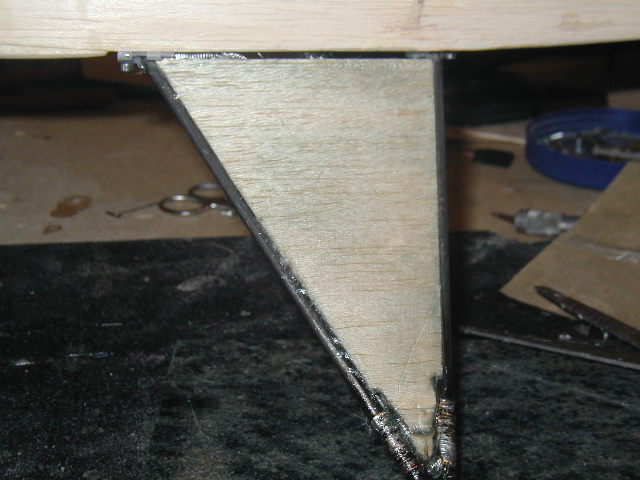

Howdy, Well I glassed the gear legs tonite. The plans call for them to covered with your favorite covering material. The factory used plastic and I am using koverall. But for things like gear I like to use very light F/G cloth and resin. It does not add a lot of structural strength to the gear, but it does make the wood stay in place better than Monocoat etal. At this point the gear cant' come off the plane so I had to glass the legs 'in place'. The first foto shows the template for the cloth in place . the second shows the it out flat.
You cut two peices of the cloth, (.75 oz/sq yd) Apply resin and cloth. when you fold the ears around to the back they should overlap by a 1/4 inch, give or take, with no need to trim the glass in place. The reason for the template is so I dont' have to mess with a larger piece. With the gear mounted it's a pain to align and cut the cloth while holding the airplane. If you have ever used the light weight cloth you know how hard it is to cut. The last shot is of the glassed leg. I lay the resin on pretty thick and let it soak into the balsa. Lay on and soak the cloth and when I am happy with the lay of the glass, squeegy off the surface. This leave a fabric like finish and needs very little sanding. I suppose that you could use water based polyurethane rather than epoxy, or polyester resin as in my case.
I really did not need to to this but I want the balsa filler to be a little tougher than it would be if done per plans. Plus I wont' worry about the gear deforming when I remove them to cover the fuselage.
More later.

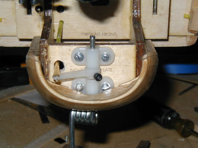

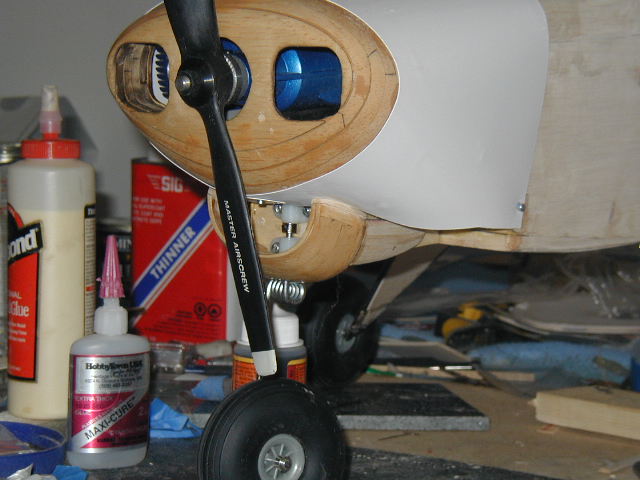

Just a quick post while the dope dries. I have had a tough time with the nose gear steering setup. The photos in the build manual show the tiller mounted below the air scoop. I tried it there and HATED IT. Very ugly. Ken at Mosquitobite said he hated it too so he moved it to the middle of the block as per DuBro. The tiller needs to be cut off a little (one hole) and Ken says that a hole drilled in the ply mount wont' hurt it. When you drill the hole in the firewall stay as far outboard as possable to avoid running into the tank. I used a throttle cable with a clevis but you can use your favorite attachment method. You dont' need a huge amount of throw on the steering. Because the TriPacer is so short coupled and the rudder is powerful 30 degrees each way is plenty. Maybe less. I intend to paint the whole area with flat black to make it dissapear.
More later.

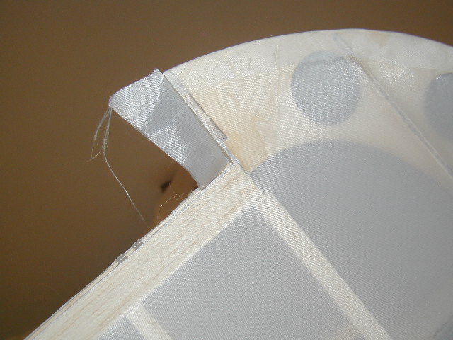

Well, today I accomplished a major milestone. I covered the wing using one piece of Sig Koverall. Yes one piece! I am starting to love that stuff. You don't cover this wing like a trainer. You start at the trailing edge on the top and dope the fabric on the edges of the rear cabin top. all the edges of the windshield cutout at the leading edge and all along the trailing edge sheeting. No dope is applied to the ribs or the sheeting. When the top of the wing has dried turn it over and dope the edges of the windshield cutout and along the sheeting running fore and aft that corresponds to the fuselage sides. Dope the fabric to the trailing edge sheeting. Again leave the wing tips alone. Once all the dope has dried the fabric can be pulled tight toward the tips. I trimmed the cloth a 1/2 inch long and doped the bottom of the tips rolling the excess up over tip bow. Allow the bottom to dry and do the same for the top of each tip. when you are finished you will have about a 1/4 inch lap on the bottom which will be nearly invisable when finished. When you trim the excess cloth from the trailing edges leave a tab at the root and tip rib on the upper surface. These tabs will be pulled down to cover the exposed ribs and doped to the lower surface. You then shrink the cloth from the center out to the tips. Try to shrink both surfaces evenly. A little on the top and a little on the bottom as you work your way outboard. Shrink slowly as Koverall has been known to crush wings if not done carefully. The batteries in my camera died, so I will try to post a shot or two tomorrow.

As promised, here are some shots of the covered wing. It takes a rather large piece of fabric to do this in one pass. The tot of the cabin extends back beyond the trailing edge so you must add about 4 inches to cover it all. You can see the tabs at the tip ribs; they get pulled down and under to cover the exposed wood of the ribs. The TriPacer is the first project Ihave built using the Koverall fabric. You can use heat activated glue but the Nitrate dope process was recommended and I think it works great. The fabric can be moved around wile the dope is drying so wrinkles are not a problem. If you can stand the dope fumes this is the way to go. I have covered with paper, silk, pre-glued fabric, and plastic. I think I have found a new favorite.

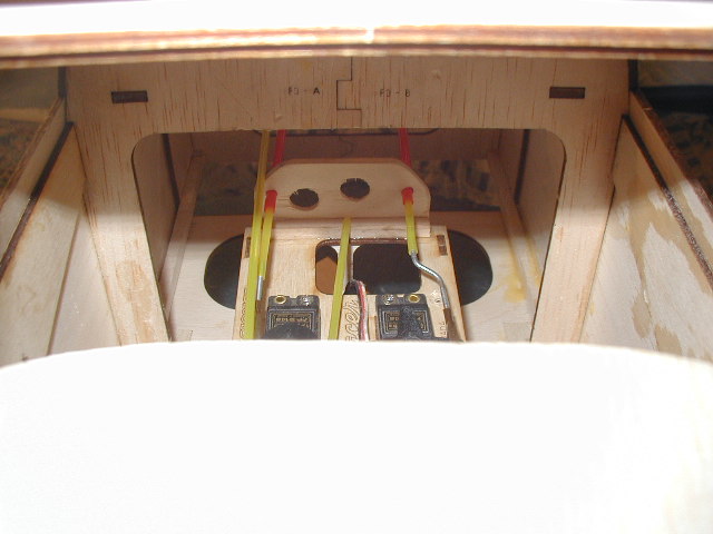

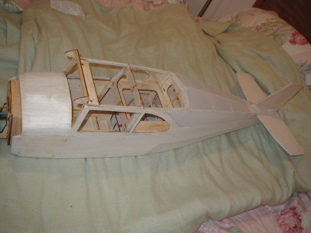

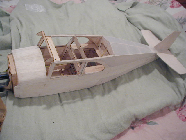

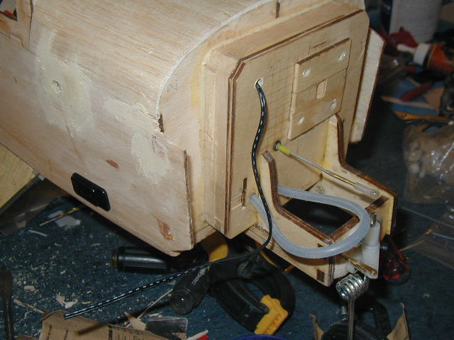

Well, we are at the stage where the less glamorus aspects of building take place. Those of you building the TriPacer per the plans can skip this posting. You who are not happy with balsa stick pushrods might be interested in the way I installed mine. For starters, I found it necessary to switch my servo positions for the rudder and elevator. The plans have the push rod ends going through two pre cut holes in the aft bulkhead. These holes line up with slots burned in the fuselage sides. There are two slots on each side. You punch out the one that lines up with the holes. Because my nose wheel steering cable comes in on the starboard side I felt that I should place the rudder servo on that side as well. That meant that my rudder pushrod had to exit on the opposite side from where the kit was engineered. To make this story short, I had to drill new holes in the aft bulkhead. One lower and one higher than the stock holes. The reason for this is simple, I will not cross pushrods. Lots more work for me, but cleaner, I think.
The first photo shows the pushrod bracket I made and glued to the removable servo tray. it is 1/8 th basswood and a 1/4 sq. stick.
The second photo shows an intermediate brace C/A'd across the rear cabin former. It is a scrap piece of 1/8 th. balsa with a 1/8 th by 1/4 strip glued along the top edge as a stiffener and lightened with holes.
The third shot is of the fire wall being mocked up. Steering and throttle cables, fuel lines and remote glowplug igniter wire. ayou can see the igniter jack on the side of the fuselage.The messy area above the jack is where the remote fuel fill valve will be mounted.
The last picture is of the receiver antenna leadout. It will be glued to the fuselage spine at a slight angle, the antenna will run out and back to the vertical stabilizer and attached using a DuBro hardware set.
Almost ready to cover the fuselage and start final assembly

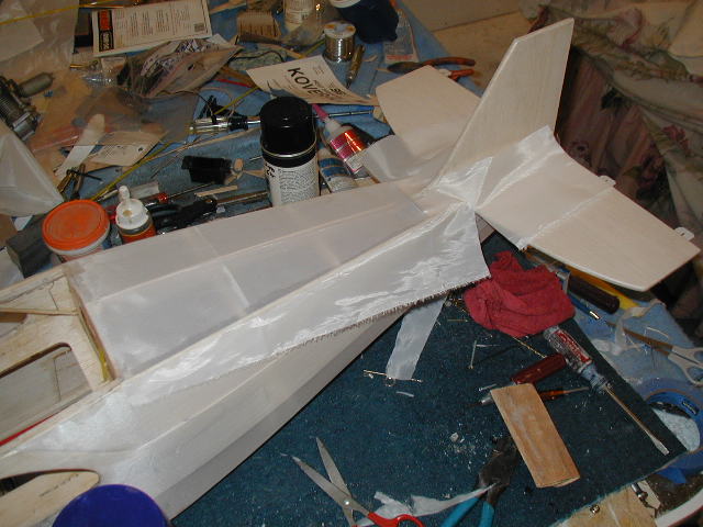

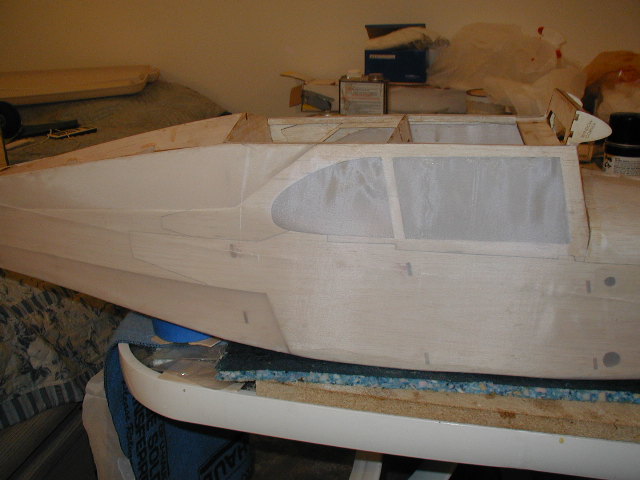

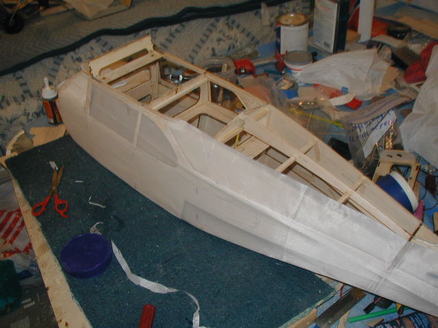

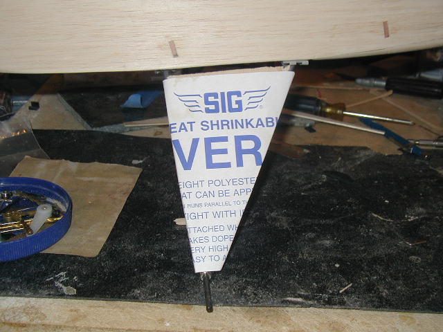

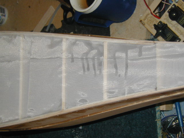

The cover is complete. If you have used Koverall before this is no big deal. If you have not used it you are in for a pleasent suprise. As with most other planes we cover the bottom, sides and the top. With the tripacer I found that covering the sides was easier if the horizontal stab was not glued in. the stab gets in the way of the cover at the rear. Apply the material to the sides and cover over all the slots where the stab is glued, you can cut the fabric away with a knif after is has been shrunk. make sure to dope around the holes so the fabric stays in place when it's cut. Cover right over the window openings doping at the perimeter only. Once you shrink the fabric you can dope around the openings, When the dope is dry cut the windows out leaving about 3/8th to 1/2 inch of material. this is folded over the window lips and doped down. It is a nice finishing touch. As with the wing, the fabric is only doped at the edges. This covering system takes more time than film but it gives a very scale like finish. Any Questions?

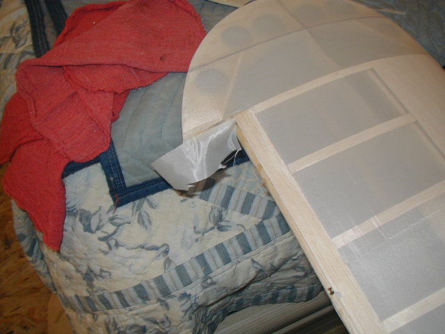

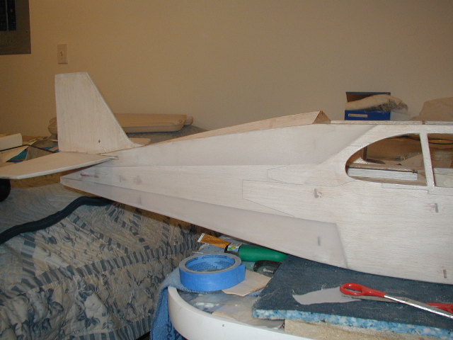

Second post tonight. Some more photos. The first three shots in the last post show the fabric before shrinking. The forth shows the cabin windows finished.
These last shots are of the cover going on the side and top, and the finished product.
Now it's two coats of filler dope and on to paint.
More later.
