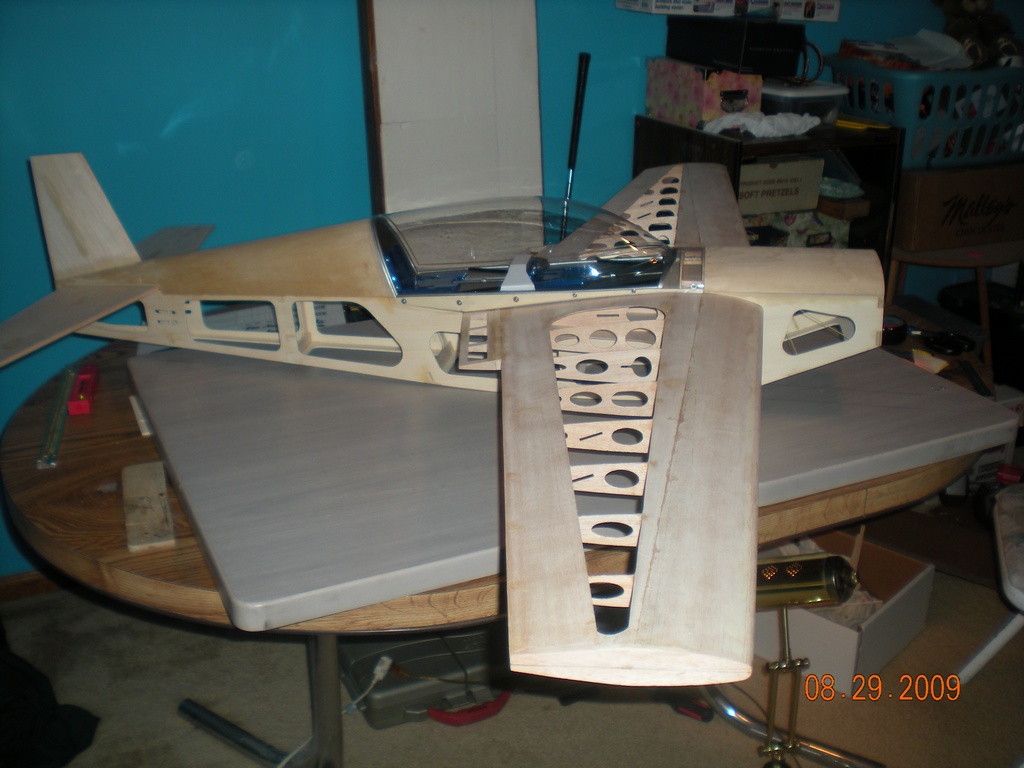

Finally! Some progress. I have joined the wing. I hope to have the wing done by this weekend. I am pleased.

Well, I am pleased with my efforts so far. I mounted the center servo mounting plate on the rear of the wing even though I am going with two servos. I figure a little more bracing won't hurt anything.
Itching to get to the fuse... Should be only another week or two.

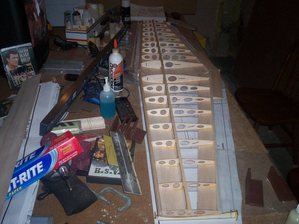

I learned something today about using the iron and wood glue method.
If you wet the top of the sheeting to form it to the contour of of the wing, wait until it dries before you add the wood glue to the bottom of the wing. I was finishing my last bit of sheeting with the iron today. I thought that the balsa sheeting seemed just a bit too plyable for my liking, but thought applying the iron would dry it right out.
That it did- and warped the H#@*L out of it! [sm=48_48.gif][sm=confused_smile.gif][sm=cry_smile.gif][sm=cry_smile.gif]
I'll have to start fresh with a new sheet of wood. I'm not going to have that "perfect" look to the wood structure anymore. But, no one will notice when it is covered.
I was hoping to move on this weekend, but I need to address this properly. At least the glue on the wing is not waisted. It can still be activated with the iron when I put the new sheet on.
Brian

Brian, how much heat are you using on the iron when you are gluing down the sheeting?? I have never bothered with the glue and iron because of the areas I have lived. I just use thick and medium CA. Today it was over 110 degrees and my planes set out in the sun for hours, they get very hot, one of the reasons I only use the Tex or Ultracote coverings, they hold up very well without sags and bubbles. I have always wondered if the sheeting would lift in our heat and come loose. I would like to try it though.
Today I turned it up to 350 degrees- which may or may not have affected the process to my dismay. I'll have to do this a couple times to find out for sure.
330 degrees works fine.
I don't know the 110+ degree heat will effect the glue adversly. I suppose if exposed to the direct sun in the heat it may.
It takes a lot of heat to activate the glue. The key is to let it dry enough so it is tacky- not wet. When the two surfaces meet it acts just like contact cement. Then hit the joints with the iron. Works great!

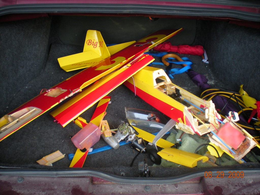

Lost my midstar in a mid air crash. That was my trainer and first plane. My plan was to fly this one until I was ready for my Goldberg extra next flying season. Not sure I'm ready for it yet, but I'll give it a try. We shall see. Looks like I'll have a lot of time on my hands to get this bird ready. Aiming for mid September. What color should I paint the top of the center console in the cockpit? Blue, Black, Silver, leave it white, or any other color?
