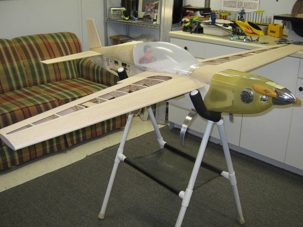

Here is a picture of mine as of this morning. Hope to have it ready to cover next week, it is getting close. Basically a stock kit but i have implemented a few things learned for the first i built and flew for 10 years. That is still going too and now belongs to my son. I added a 5 ply doubler at the canopy mounts, after a few years one of the light ply mounts broke flush with the wing saddle. The canopy on this one is removable, after years of being in the sun #1 needed some work to repair the inside of the canopy which was sealed up, not fun, not pretty either. I left the lightening hole wood in the ribs on this wing. Yes, it is slightly heavier. On #1 i could feel the wing getting weaker as time passed and i think a lot of that was due to handling it and the ribs breaking or cracking at the lightening holes. Better to have a slightly heavier plane and a strong structure that will last a good long time. Besides, this is only 1/16" wood, not very strong or heavy to begin with. Just my opinion on that. Up front is a faithful old O.S. 1.08 recently back to Hobby Services for a going through. I picked up the fiberglass cowl at a swap meet last year for $5.00, probably the best buy of the swap meet season for me. Not so lucky on the landing gear. It just came in this week from TnT, very nice gear but a little pricey. Being unemployed i have to watch all my pennies and nickels.

Very nice work. I screwed my canopy down also in order to get inside. Only downside I see is when the sun hits it, you will notice that the plastic expands and the bottom edge gets a little wavy. But when it cools down it goes back flat. I put a white towel over the canopy when it is sitting out in the sun at the field to sheild the sun. How thick is the landing gear? Mine is home made. 1/8" aluminum. I suspect 3/16 would be better cause mine bends pretty easy. Not bad for me (new flyer) cause it acts like a shock absorber . Or maybe the grade of aluminum I used isn't the good stuff. Eventually I'll upgrade to the TNT.

Al, drill a couple of small holes thoward the rear of the floor board or pan and the heat will vent into the inside of the fuse. You can also drill some very small holes in the very back of the canopy on the outside to vent, either way works.

My first one had a 1/8" thick TnT gear and while it was ok, after years of flying it was a bit bent out of shape. I don't why, all my landings are picture perfect. Any way, i went with 3/16 thick on this one. Good idea on venting the canopy!
