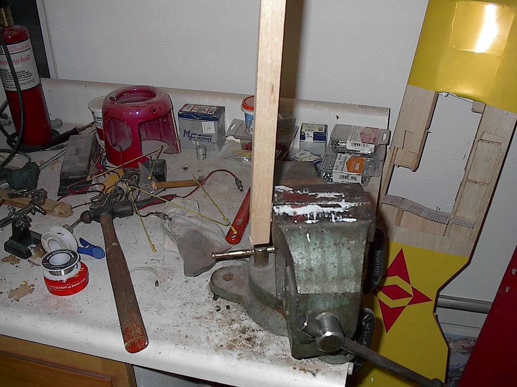

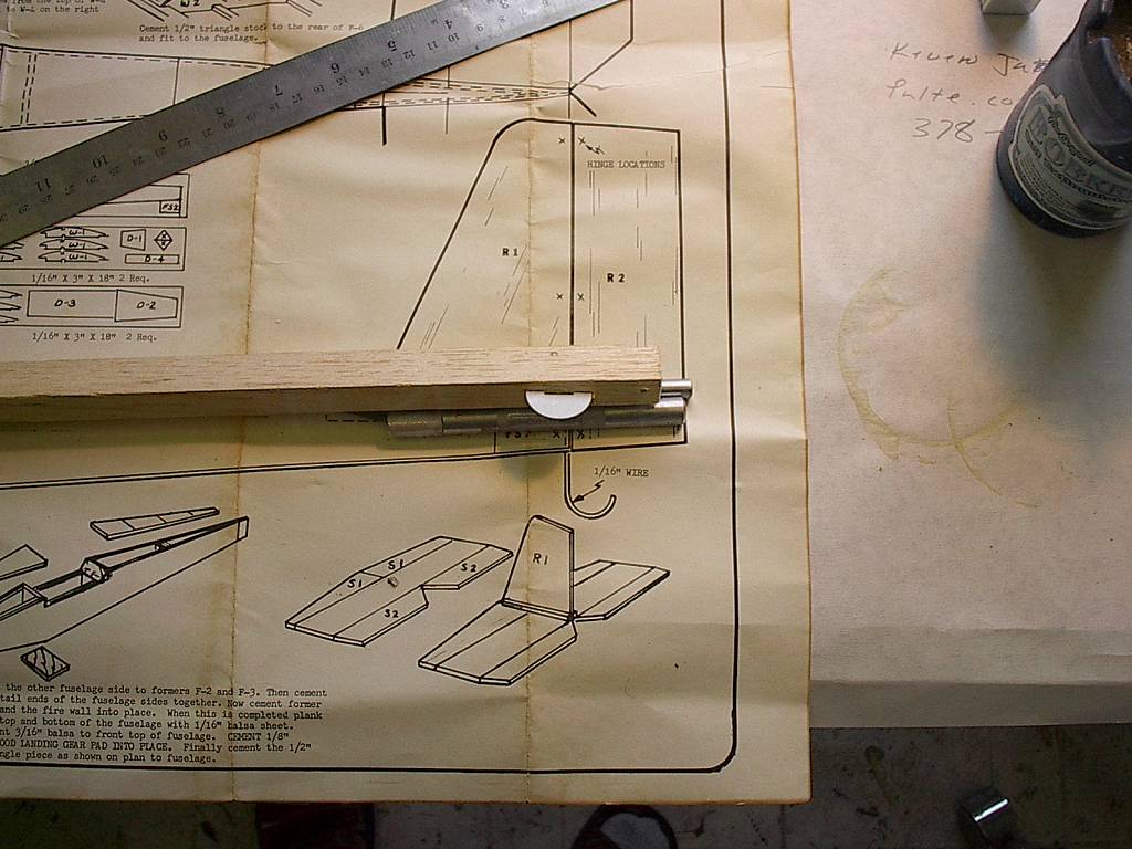

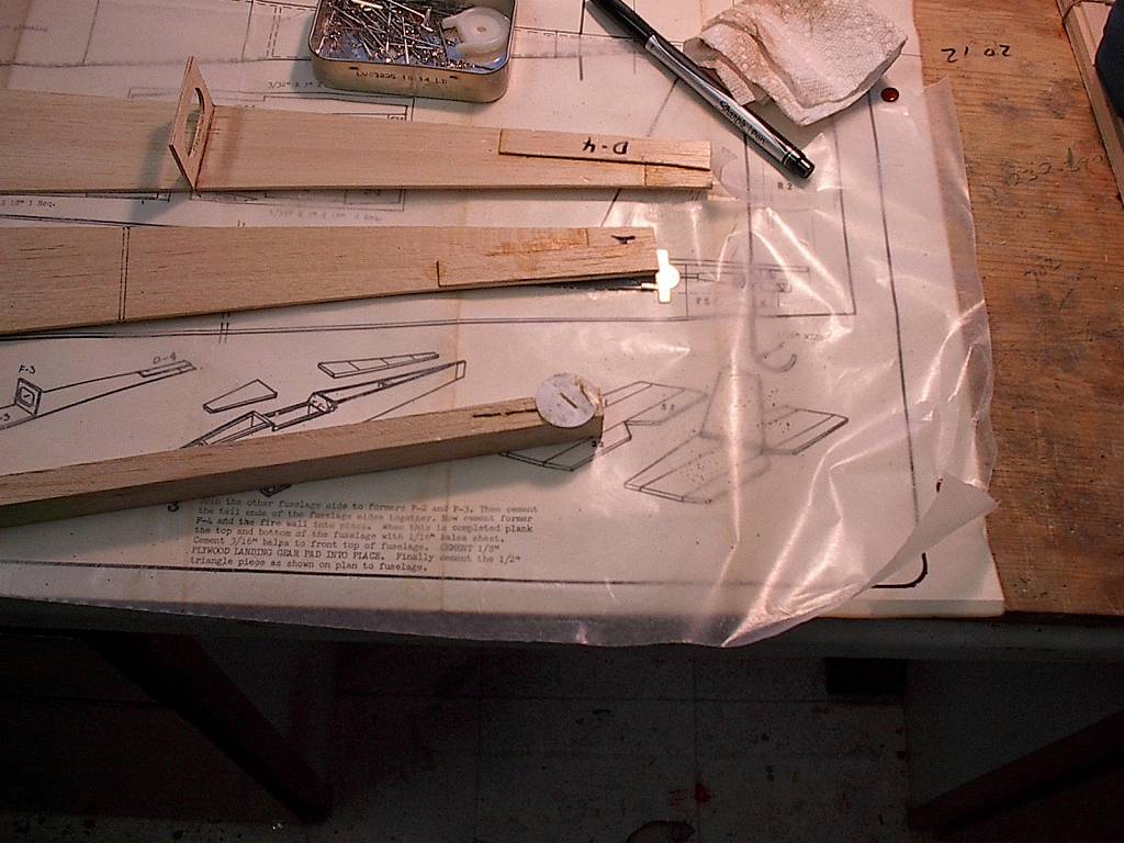

I went out and set up a piece of balsa just like I would do if I was going to use CA hinges, shot in a load of Pacer Hinge Glue then stuffed the hinge into the slot, that was a lot tougher then it sounds, Pacer is pretty thick. I let it set up for three and a half hours, nothing better to do, it's raining out today. After the 3.5 hours I gave the hinge a good tug, it didn't budge so I stuck the hinge in the vise and save the wood a pull, it came out this time. The glue was still tacky but where it was set up there is wood that clung to the hinge, Pacer is some very good glue and if it was squished in to the slot first then the hinges pushed in then it will hold very well. If the glue was just flowed onto the hinge there is no way for it to flow into the hinge slot and work like CA.
Gene

Thanks Gene and Brian, if nothing else those two post are prolly some of the most valuable in this whole thread, I can't add to what Minn has said about installation he covered it very well.
Some of you may agree with me on this or not, but I always use a good quality CA hinge such as Greats planes makes.

If you look in my #1 photo where I cut the slot you can see a center hole I drilled, this is a must do thing when installing CA hinges if you want the CA to wick all the way through a CA hinge. I'm not sure but I think Mike or Ken showed this in a thread about using CA hinges. I don't use them on my planes but I have installed them a lot in planes I have built for others and never had a problem with them. There is no reason why I don't use them, they are fine if installed correctly, I try to use hinge pins if I can on my planes, just because they are easy. I end up using more of the Dubro flat hinges though depending on the edges of the wood, TE or LE. It's just one of those choice things, I often mix them too, use pins and flat. The little plane I'm building right now I'm not sure what I will be using?? The wood for the elevator and rudder is only 3/16 or 1/8 thick. I'm thinking of adding some wood and using the pins for the small electric planes. This is an old 1/2A kit and my first stab at electric power. As small as it is I'm still cutting a lot of lightening holes in it. Not needed but just beacuse!![8D]

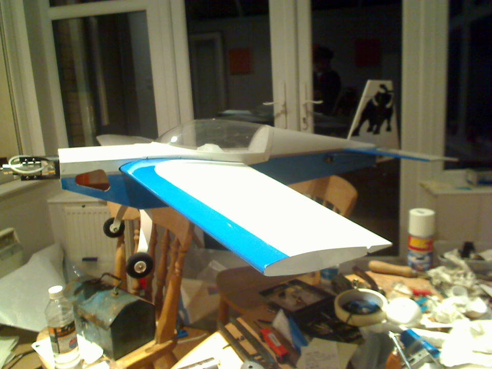

Hey Guys
Thought Iwould put my tools down for a bit and take some pics of where im at.. Apologies for the bad light but its getting dark here in the UK very early to the cam wouldnt focus that well.
Ihave a few bits that Ineed to finish off ...like the pattern on the wing etc, but im hoping to maiden her this weekend!.........without her cowl that is.
Regards

Looks good, I would even be able to see the checkers on the bottom!!!

Very nice and colorful! Us older guys have to be on the look out for color and this one would be easy to see! Good luck on the maiden. Right is right, left is left, up is up, etc. You wouldn't think you would have to repeat this but an experienced flyer at our field had not only his ailerons reversed but the elevator too on a P-51 maiden a few weeks ago! Not a pretty site!

Yes, I purposely made it visible because the skies here in the UK in winter as you can all imagine are pretty grey all the time, so the colors really help to see it.
I will be checking that up is up and what not about 50 times before I go anyway, otherwise Ill be crying like a little baby if it hits the ground!
