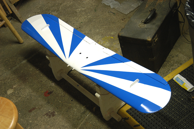

ok heres my bottom wing with some paint on it. I used sig dope applied with a spray gun.

Gumhead,
That's looking really good. Give yourself a pat on the back!!!
ken

Gumhead, looks great. What did you cover with before painting? That looks easier and better than cutting covering for designs and stripes.

ORIGINAL: cubfloater
I used Sig Koverall. I wouldn't say it is easier, lots and lots of painting. In fact it probably takes 10 times longer to do.

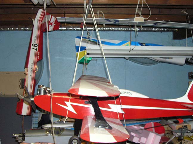

This is how I do my bipes, Just hang a plumb bob and it will piont to the CG point your at. Boy is my Hog dusty!!!!
Dauntae

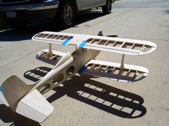

I don't know how some of you guys manage to build planes that weigh so little.
My Hog Bipe is ready to be covered.
The engine and flight pack are installed for pictures and CG check.
Being curious how much Koverall and dope will add to the all up weight I hung it on the fish scale and it is 7lbs 15oz.
It may hit 8 1/2lbs flying weight by the time it is covered and painted.
I have seen many posts stating ready to fly weight at 7 1/2 lbs, I just don't see how you can do it without major material substitution.
I resisted the urge to beef up anything with the exception of some triangle stock at the gear mount plate and I went easy on the epoxy this time.
Maybe I will switch back to the aluminum landing gear since the Dubro weighs more but even then I am still well above many people's flying weight.

Sig tends to put a lot of heavy balsa in there kits but a 8 1/2 lbs Hog Bipe will be fine, It can handle the weight with the 2 wings, I think mine came out around 8 1/2 lbs and it flies great so use the new landing gear because alum. gear always seems to get bent on the not so perfect landing (for me any way)

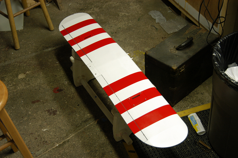

Well I finally finished painting the top wing...
Its still cold in the shop, hopefully things will start to move a little faster with some warm weather.
Next is to tape off and paint the body.
Heres a couple of pics...
