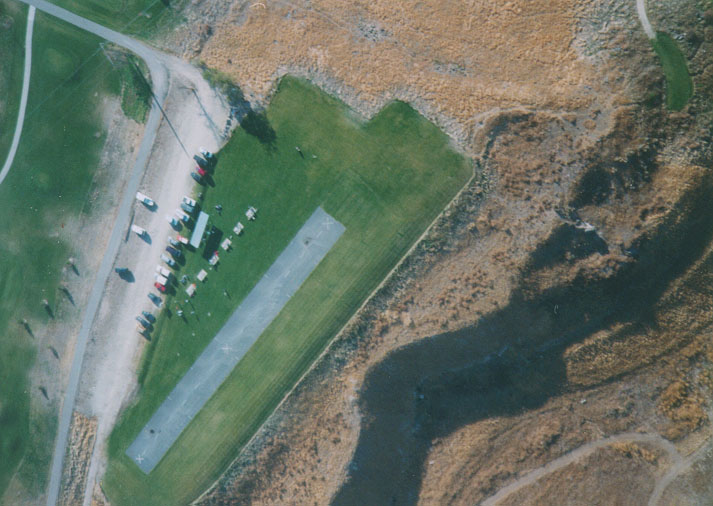

http://www.americanturfflyers.com
Look under the picture gallery and you can find some pictures of our field. The pics are on Page 4 and are older, but it does give you the layout and there are others scattered throughout the different picture galleries. Oh.. and the videos are good too.

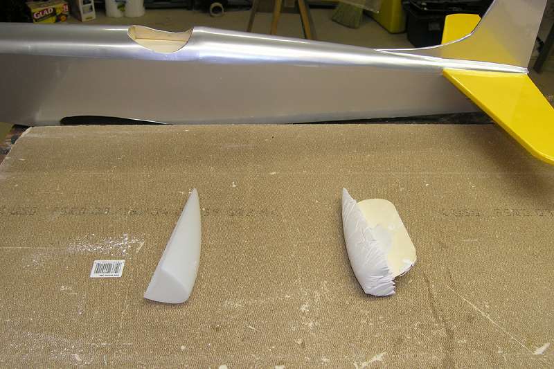

Well Hooked, I finally decided that I was going to try to cover the headrest rather than paint it. The first problem was how to hold it while you heat and stretch. I was determined I was going to do it with a single sheet. This was my first attempt at so complex a shape. So here is what I came up with. I lined the inside of the headrest with plastic wrap and filled it with plaster of paris, holding a piece of light ply. After it had set, I removed the plastic wrap put it all in a vise and got started. While the results are not perfect, I think I got a better job than if I had tried to paint it. Installed it just like we do canopies...Fred123

Fred123-
That's looking good! I'm using a razor plane and carving the headrest out of a balsa block. It is taking a little time, but I think it will turn out good. It also looks like the covering job is nearing completion and it looks great.

fred - I appreciate you posting pictures of the covering of the headrest and the process that you used. I am probably going to build mine out of balsa block. I still have a way to go and can always change my mind, but that is my plan for now.
jspencer - If you could post a picture of your balsa block headrest I would appreciate it.

Hooked-
I'll post a picture of the headrest tonight sometime. I got a balsa block that was just big enough for the height and width (just turned out that way), and the length was about 3" longer then needed. I transfered the front of the headrest onto the block by tracing it. I also outlined the shape of the bottom onto the bottom of the block. The side profile was the hardest to transfer to the block, but I got it close enough and once it is sanded smooth you wouldn't be able to tell the difference between the original and the one that I made. I've got the general shape now, but still need to transfer the shape of the rear turtle deck to the bottom of block for mounting and carve that out. Then I'll just need to do a little more planing on the top and sides and it will be ready for final sanding.

on the headrest. I did the same thing and carved one out of balsa. I HATE plastic on my planes. So I did the same thing Jspencer did and carved it from balsa. After you get it carved use a dremel to carve out as much of the inside as you can. It will make it easier to mount, and save a small bit of weight.

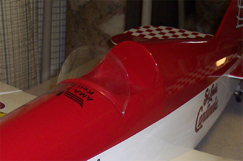

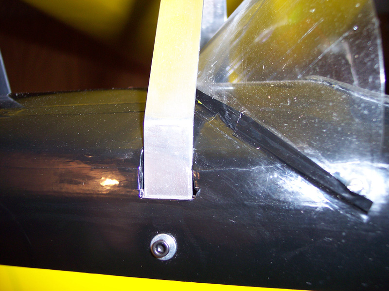

RCKen: Help, Help...Do you have any tricks for installing the windshield?. I am using formula 560 glue and have cut out a 1/16inch strip of covering to give the glue contact with balsa. Looks like I would only need to clamp it on the very tips for the glue arc to make contact. However, it turned into one big mess with glue everywhere.. Thank goodness it is water soluable. The Plexiglas is so springy it is very difficult to hold in place.. What about a screw at each point of the windshield, or is there a way to form the Plexiglas so that it would hold its shape? Fred123[&:] P.S. Tried the screws, and they worked great.. Sometimes it helps to talk about ones problems...Fred123
#245
RCU Forum Manager/Admin
Fred,
Ok, here you go, here is how I mounted mine. Like you I hate the cements and haven't ever been able to get a good result with them. I use a screw at each corner of the windscreen (cut by the template on the plans), and then I use monokote to hold the windscreen down. Cut a strip about 1/4" wide and use your trim iron (or a regular covering iron set at a lower temp) to apply the strip. Put the strip on with 1/8" on the plane and 1/8" on the windscreen. You may want to practice on the scrap first to make sure you don't get your iron too hot, but trust me this works great. This is how I mount the canopy on all of my planes.
I've attached 2 pictures. The first one is from my hog bipe, but I couldn't get a very good shot of it. The second pic is from my Slow Poke. I mounted the windscreen the same exact way so you should be able to see what I am talking about.
The edit was because I accidently hit ok before I uploaded the pics. here they are

RCKen: I went ahead and used the glue. I have had good luck with it on my SE and 4*. The screws are just holding the windshield in place until it drys. They only go into the 1/16" sheet so won't hold much . Couldn't get them low enough to get into the plywood. Will probably leave them in place though. I will trim where the windshield meets the deck with Astrokote.. Fred123[&:]

Hey Guy's I have a question. On the windscreen, I was having the same quetions, but have thought of a way that might work to hold the thing in place. What if I were to leave a square tab of the clear on the outside edge of the windscreen, cut a small slot in the balsa for the tab to be slipped down into, and then shoot some CA in the slot? It would be something similar to the cabane struts where they go down into the side of the fuse. It is just a thought, but I might try it...just wanted to see what you think.

Hooked,
The only problem I can see with the "tab" on the windscreen is you need to seal the front of it, otherwise th wind is going to try to lift it up and tear it off. That's why I put the monokote on it to seal it down. I've been using monokote to attach canopy's for about 6 years now, probably 8-9 different planes. Never had a problem.
