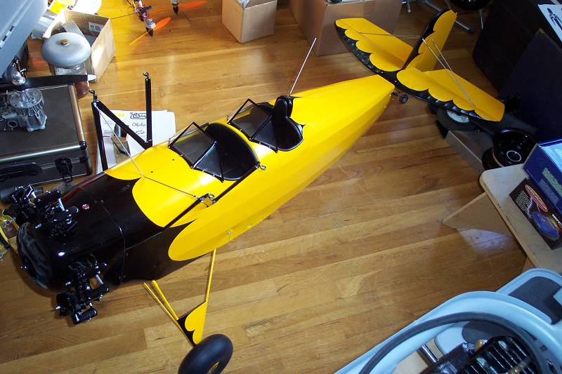

Hi Fleet guys, this one was built 86, recovered once & repainted...has original Q 35 still runs great...best biplane I ever had...Alex

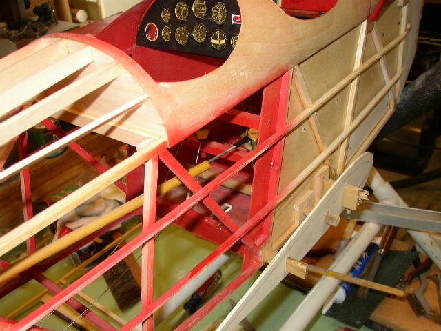

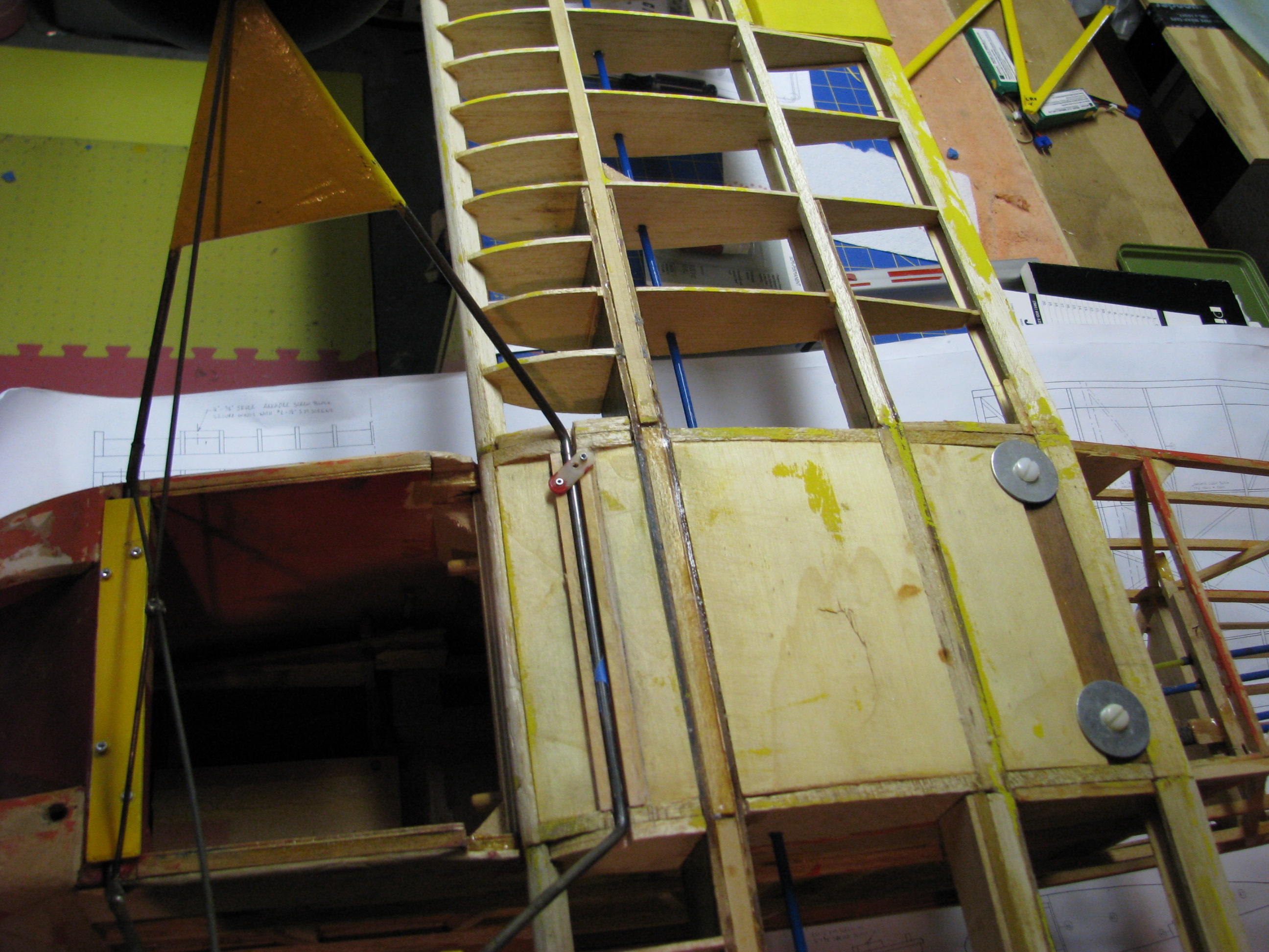

I found some K2R to suck the oil out of the balsa. Stuff still works good but, now, it has a nice aroma. One coat and brushed the rest. I'm also scrapping much of the epoxy layer I used to fuel proof the firewall area. After 20 plus years, it had softened a bit making removing with a sharp chisel a bit easier.
I'm still thinking the mechanics of how to remove the bottom wing attach structure. The pix, if one can make it out, shows some penciled ideas. Got to beef the inside before any cutting so nothing gets out of alignment. Most doable.
Top wing is ready to glue up but I need some more working space on my boards.
Pix upload has hit a snag. I'll put them up when I figure this out.

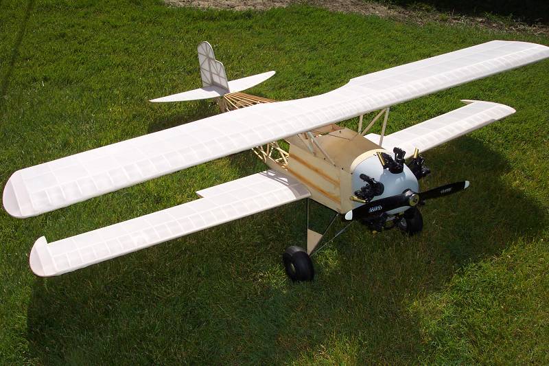

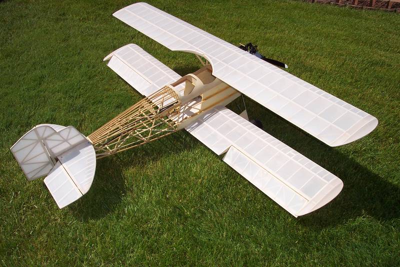

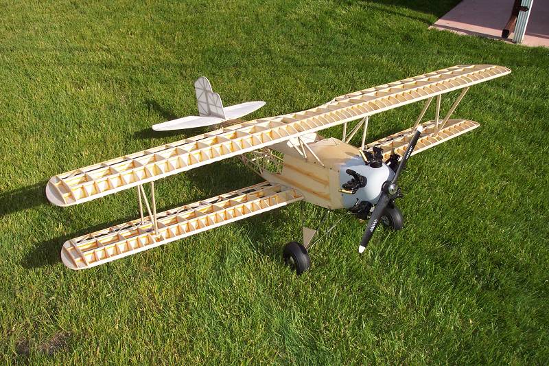

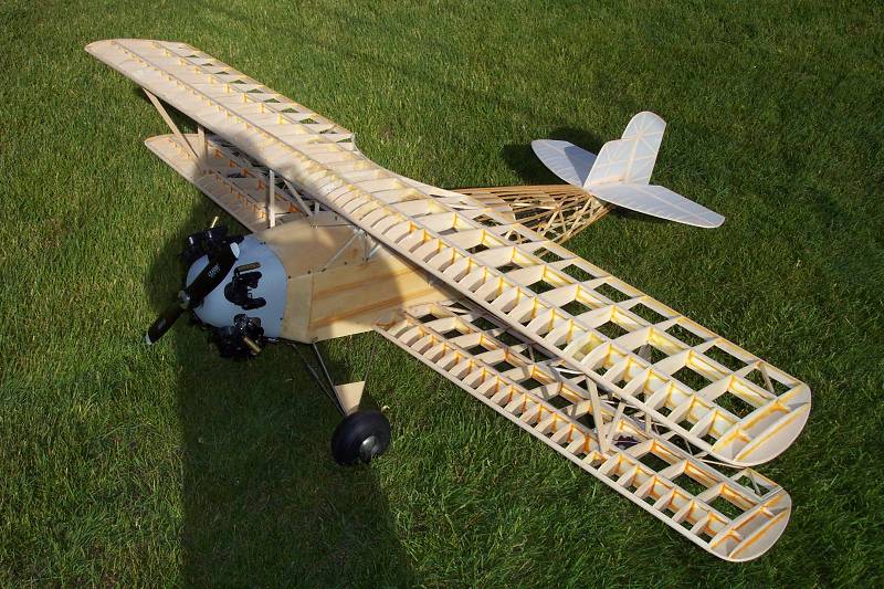

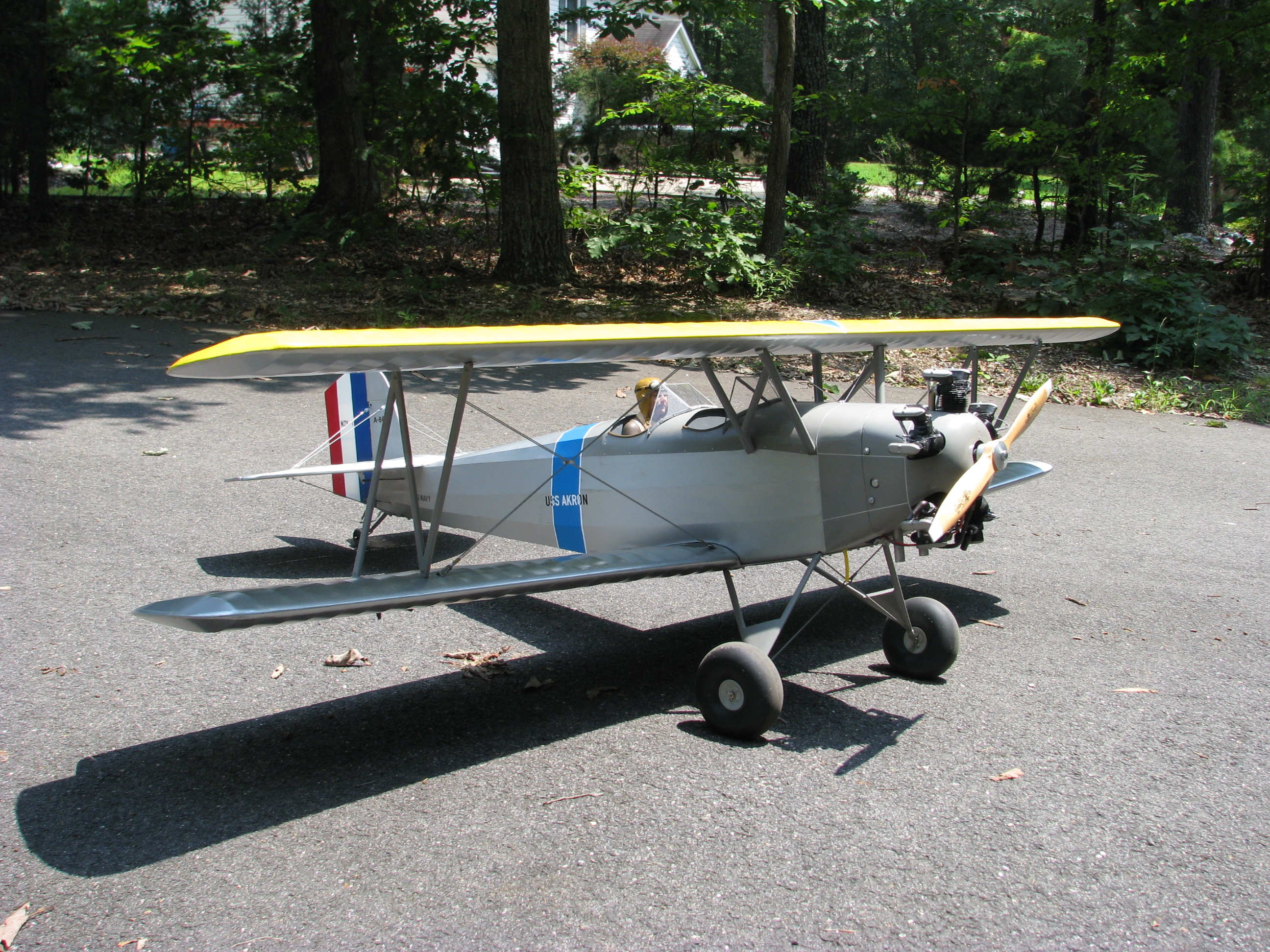

Hi, this is my 1/4 scale Fleet scratch built from Jerry Beherns plans. both wings are 1 piece, G38 for power, Futaba Radio...

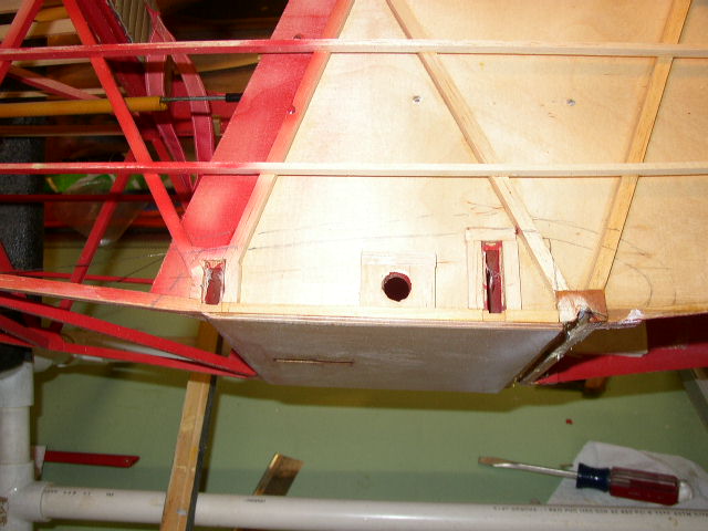

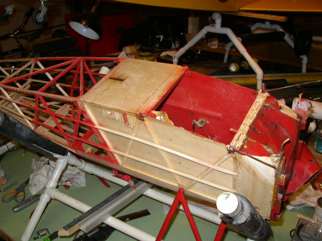

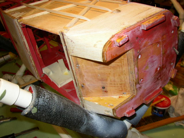

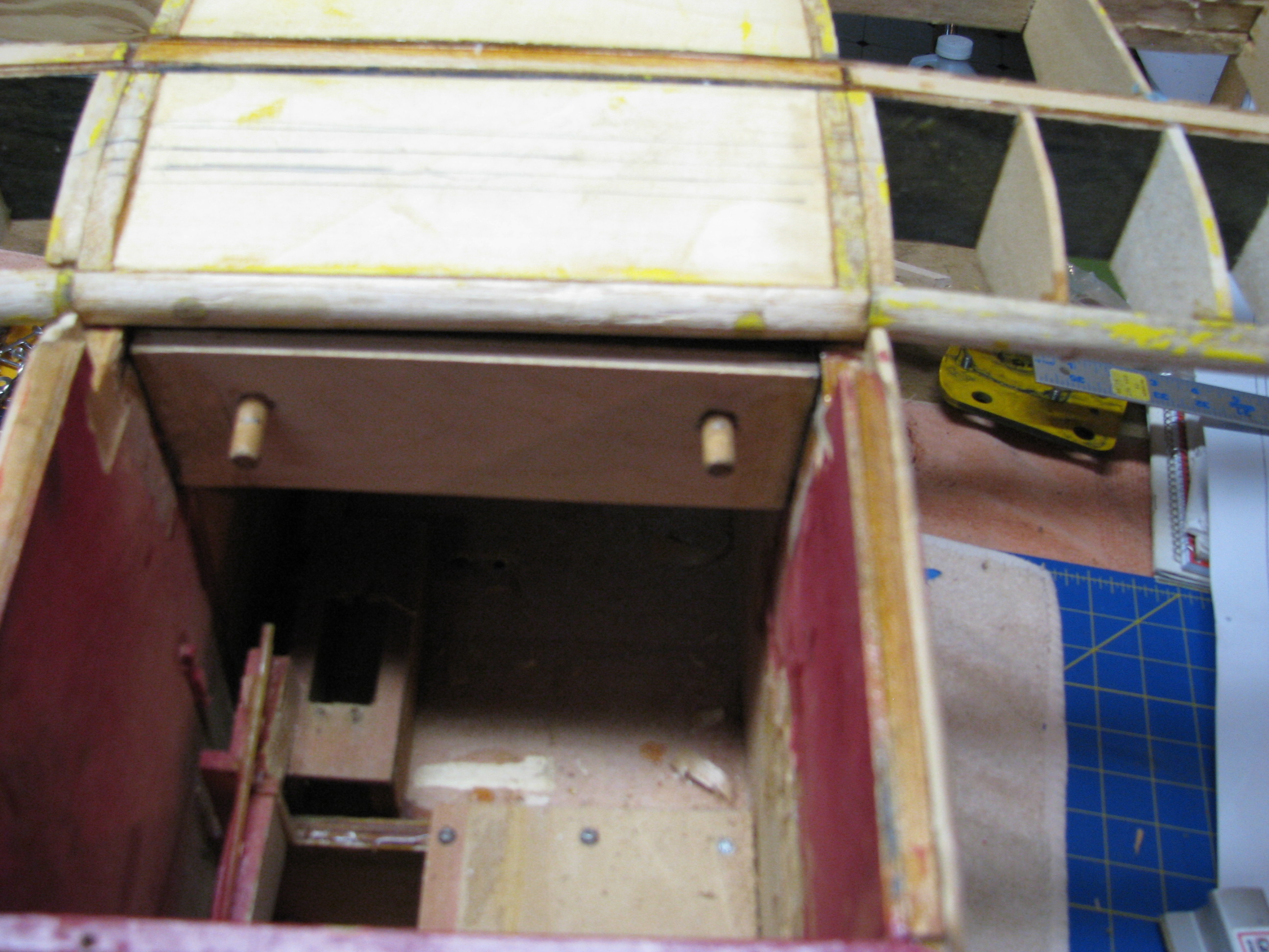

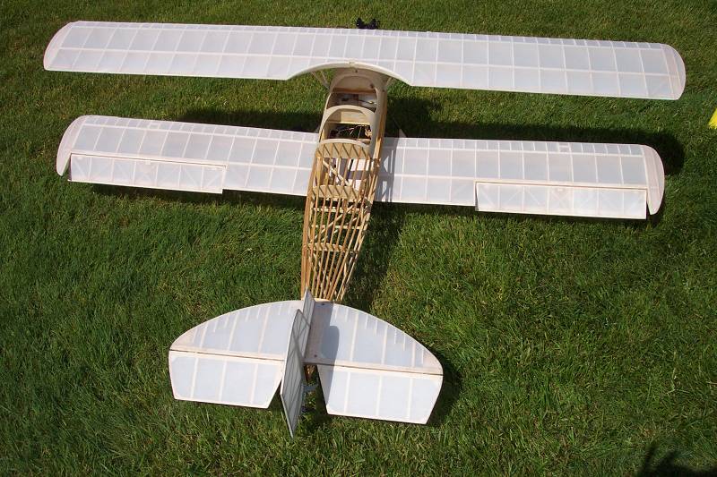

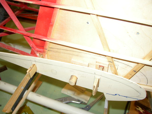

Still playing with ideas and wood before I start cutting up and risk some thing that may make more work if I just go off willy nilly and start sawing up a perfectly good fuselage.
I'm still plan on using the already existing wing splice boxes within the fuse. A matter of beefing up the internal structure before cutting the box out. Then , I'll use the wing box as a major mount and glue the wings at the 4 degree dihedral angles. Attach to the fuse will be two locator dowel pins and nylon screws ala Top flight Kits.
The balsa piece is a template to insure both sides are identical as I can make them. 1/2" dowel flows through the fuse and out the other side.

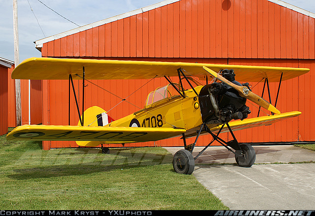

Color will be AN Orange/Yellow and will look like the 16B Finch used by the RCAF. I may even put the full canopy over the cockpits.
Ray W.

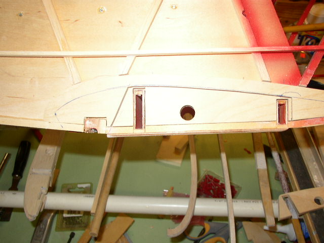

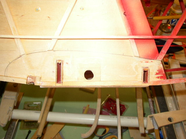

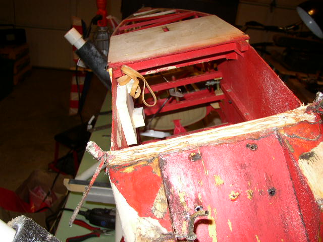

Okie Dokes, getting closer to cutting the fuselage out for the wing plug that will connect the two wing halves.
I had more pix but somehow my 'puter won't download them all.

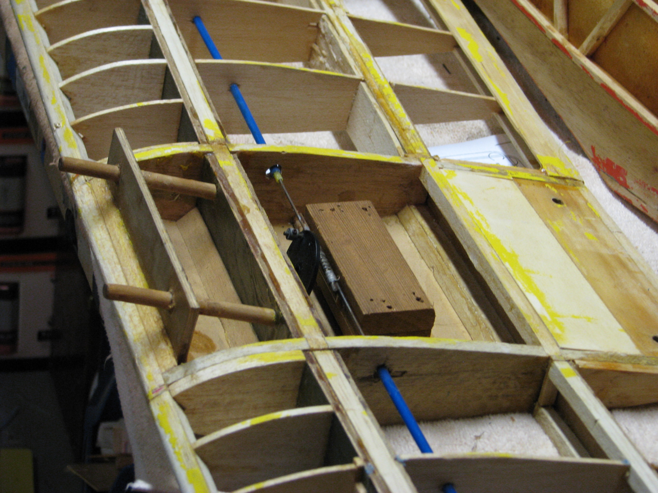

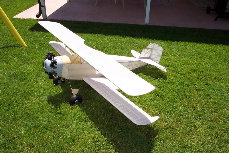

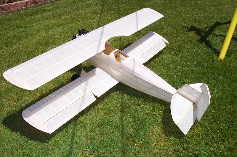

Here is what my Fleet looked like when I acquired it. The original builder did the one piece wing set up for both top and bottom. As you can see, the rear landing gear block is in the fuse in front of the leading edge of the wing! Bad, bad! I relocated the LG block to the proper scale location on the wing. The wing dowel pins were OK so I left them alone. Cleaned up and replaced the center section sheeting and made sure everything was smooth.
Jim

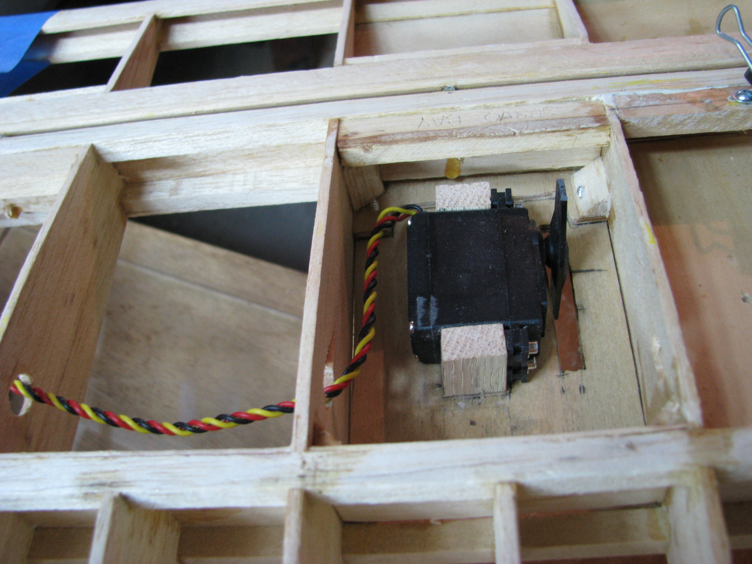

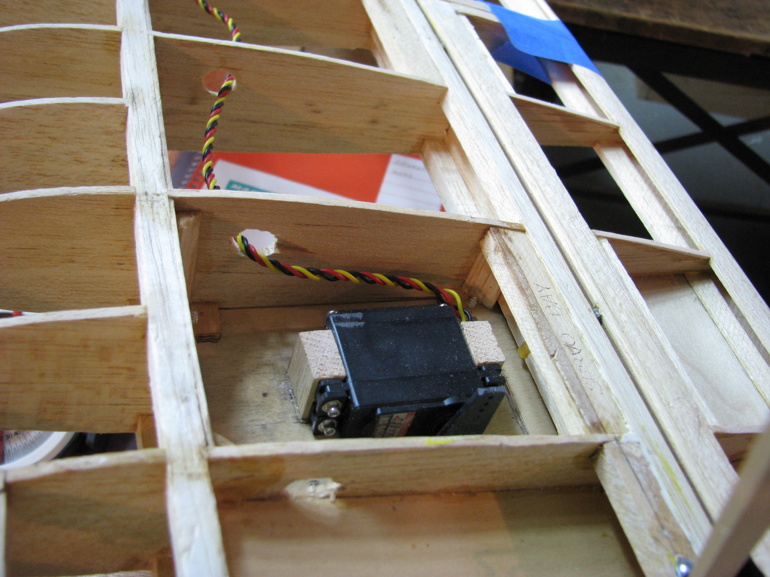

Disregard that center wing servo location above. I have 645s in the wings
for each aileron.
