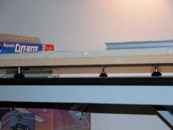

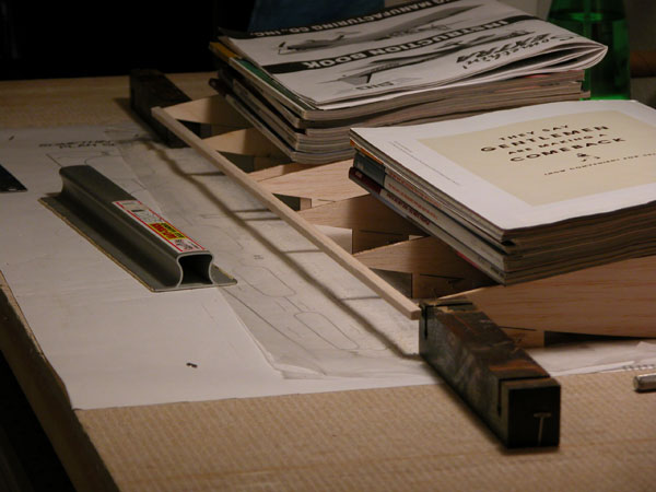

On a side note, I ended up constructing my own building board for this build as the table that I used to use had a big shelf on it and is no longer acceptably flat. I just took a sheet of 2'x4' 3/4" MDF, 8 adjustable furniture feet and T nuts, all from Home Depot, and made a building board that can be adjusted at 8 points. This way you can sit it on even a warped surface and still be able to level it out for a flat building surface. It's not perfectly flat, but I stretched strings diagonally from corner to corner and adjusted the feet so that there is no more than 0.5mm variance in the surface. I think that's pretty good for having only invested $16.
I put the usual sheet of ceiling tile on top of the MDF, let it settle down with some weights on it, and now have an acceptable building surface. I will also post some pictures of this setup. While I do wish I had the setup to build with magnets on a steel sheet or similar, that's just completely not feasible with the space and budget constraints that I have right now. Besides, I built my previous planes on a flat table with a ceiling tile, and they all came out just fine.

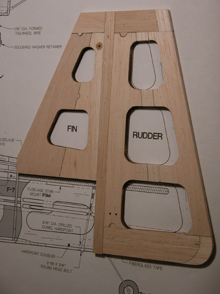

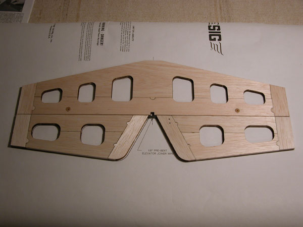

As promised, here are the first round of pictures. You can see the completed tail feather assemblies. I also glued together the wheel pants. The seams leave something to be desired, but I will get them smoothed down. Speaking of, I am planning on using plastic film (Monokote or Ultracote, whichever I end up getting) to cover the wheel pants. If I need to use some sort of filler material and sand it down, what should I do to prep over that so that the covering will stick to it?
Also, there is an overall picture of the building board that I made, as well as a picture showing the adjustable feet underneath the baord. Personally, I think it's a neat solution for obtaining a flat building surface, but I would suspect I'm not the first one to do it, or some variant thereof.
Next up is to start buidling the wings. I like starting with the tail assemblies for some reason. It just gets me into the right mind for working on a plane and not jumping in straight to a more critical object like the wings or fuse.

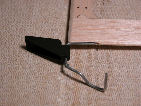

I picked up the .60 size Dubro tail-gear and have fitted it already to the rudder. I ended up bending my own wire for it since I felt the one it came with was a bit too short and I wanted about another inch to the wire. On an important side note, I'm going to keep the hinge point of the tail gear in line with the hinge of the rudder. This means that due to the slight angle at the aft end of the fuse, I'm going to have to make some sort of small wedge or something for the tail gear block to mount to. Shouldn't be a big deal though and it will relieve stress in the hinging system, and thus less of a load on the servo.

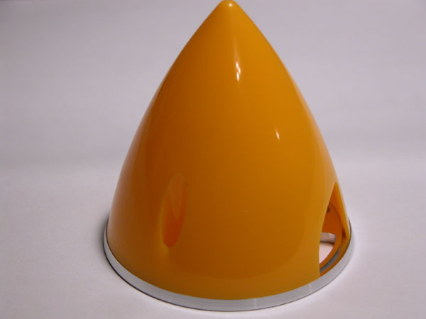

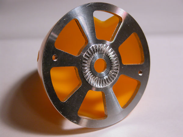

Also, I found a spinner I like. I never knew there were spinners with aluminum backplates. I didn't want to go full aluminum due to the weight and cost, so this is a nice compromise. The aluminum ring will be a nice accent I think.

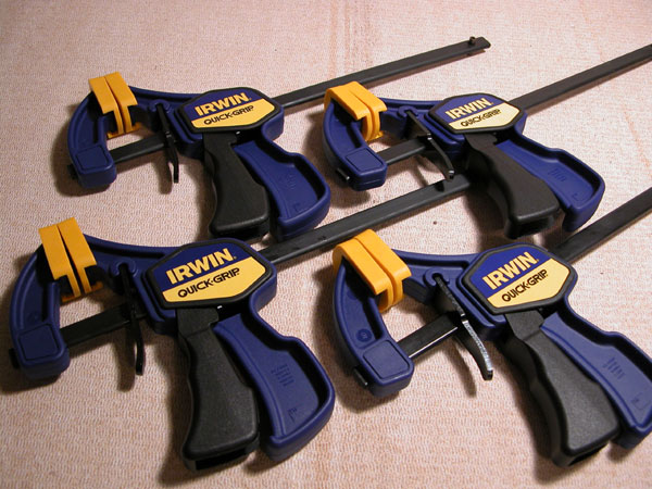

Finally, I found a nice deal at Home Depot. A four pack of 6" clamps for the price of two. Sweet. Clamps are always useful. They may be a bit more difficult to use as opposed to the small versions of the clamps, but then again, they will certainly have more squeezing power. [8D]

BLW, Yeah that's a BJ industries landing gear. I was advised not to use them as they are weak and bend easily. Inspite of the warning, I bought them anyway. Guess what. They bend easily! I advise against them. I currently have the polished aluminum version without the holes and they are great.

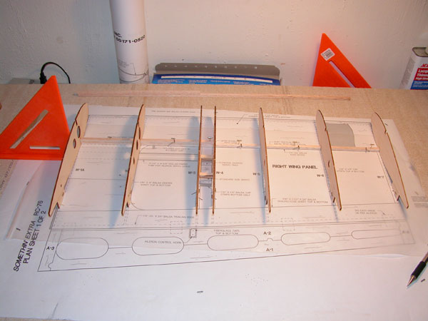

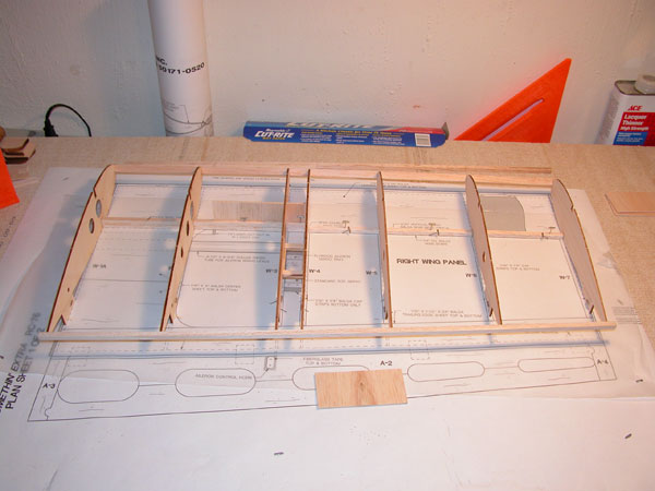

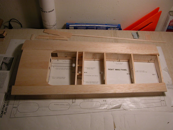

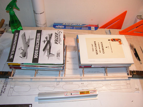

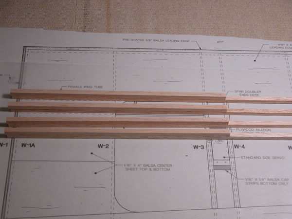

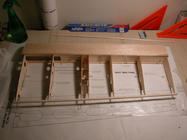

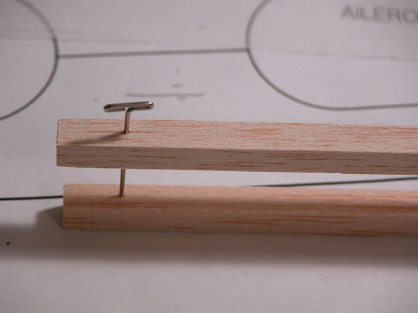

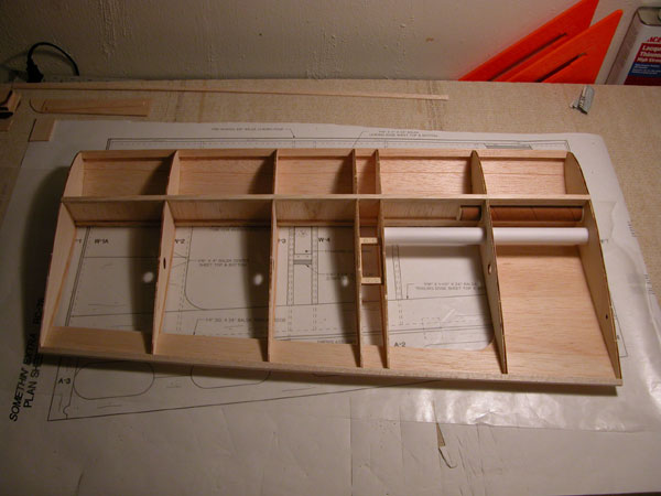

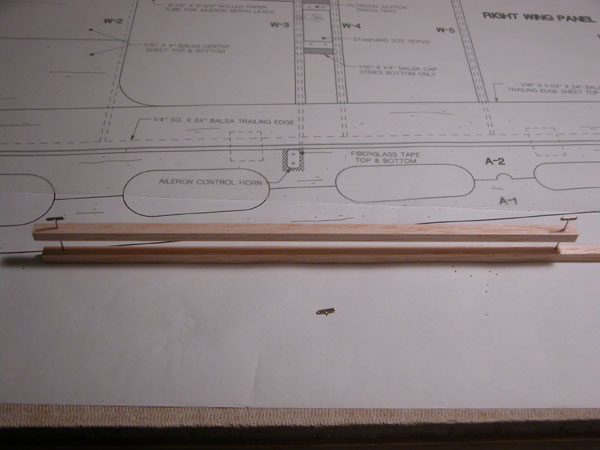

Started work on the right wing today. First off, I came up with a simple way of aligning and gluing the spar doubler. I simply lined it up over the full length spar prior to gluing and then ran two pins down through both sticks (seen in the pictures). I then pulled the spar doubler up some, applied a bead of glue between them, and then just pressed it back down letting the pins guide it. I put a few weights on top of the doubler just to try and hold it down as flat as I could, though I don't know how effective it was since the joints set up quick with the CA. Viola! Four nicely done spars in a few minutes time and they all came out without any noticeable bends or warps.

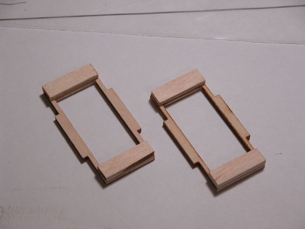

On the aileron servo mounts, I put an extra piece of wood on the backside of the mount where the screws go into. This just gives the screws a little extra material to bite into.
Finally, I got the ribs lines up and glued down. I'm going to keep checking the ribs as I build up the wings to make sure they stay at 90 degrees to the board, paying close attention to the root rib.

yel914- oh well on the BJ gear. Sure looks nice. I'll order the plain one if mine is too soft like you said. It is the 60 sized one. I have another plane that came with a super soft dural gear. I made a saddle mount thing of ply that overhangs the bend a little and presses firmly against each side to keep it from flexing. It works.

Didn't get a whole lot done today. This build is going slow. [
] I'm normally much quicker than this. Perhaps it is because I'm just being extra perfect about every little thing. Also, I don't really have a whole lot of time in the evenings. All my free time is on the weekends. Anyways.
Got the LE and TE glued on and started on the shear webbing. The shear webbing is really what is slowing me down right now since I'm measuring and cutting and sanding and checking and sanding more. At least it will result in a perfect fit. No special tricks were used, so just an updated picture of the wing.

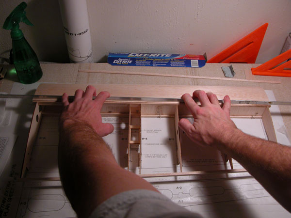

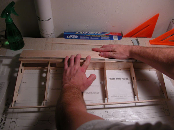

Finished up the top part of the right wing tonight. Have a few tricks to detail.

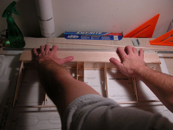

For putting on the leading edge sheeting, I first glued the front edge to the inside edge of the shaped leading edge as the manual suggested. Took my time to sand down some of the front of the ribs so I would get a relatively flush fit between the sheeting and the leading edge. Then, I sprayed some water on the outside surface of the sheeting and spread it around. No big trick there. Then, applied CA along the ribs and top spar. Here is the trick I used, shown in the pictures below (after the sheeting was on, I wasn't going to try and take pictures and install sheeting at the same time
). I took a piece of angle aluminum that I had, and held it down with a fair amount of pressure on the sheeting at the leading edge. I then slowly slid it back along the sheeting maintaining pressure and keeping a little bit of pull on the sheeting toward myself. I then held the bar in place above the spar and took my free hand and made sure the sheeting was making contact with all the ribs. It worked quite well actually.
A trick for sanding the TE to match the slant of the ribs, though I'm probably not the first one to do this; use a large, heavy object, or some sort of block to hold the trailing end of the outside ribs in place. This way the whole TE won't go back and forth when you sand it. Also, having a vacuum cleaner handy is nice to get all the balsa dust off the board.
So, I ended the night with all the top sheeting in place. I will pull it off the board tomorrow, trim down the overhang on the root and the tip, and proceed from there.
). I took a piece of angle aluminum that I had, and held it down with a fair amount of pressure on the sheeting at the leading edge. I then slowly slid it back along the sheeting maintaining pressure and keeping a little bit of pull on the sheeting toward myself. I then held the bar in place above the spar and took my free hand and made sure the sheeting was making contact with all the ribs. It worked quite well actually.A trick for sanding the TE to match the slant of the ribs, though I'm probably not the first one to do this; use a large, heavy object, or some sort of block to hold the trailing end of the outside ribs in place. This way the whole TE won't go back and forth when you sand it. Also, having a vacuum cleaner handy is nice to get all the balsa dust off the board.

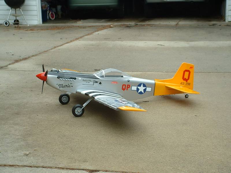

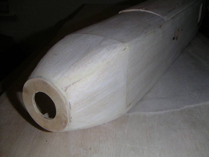

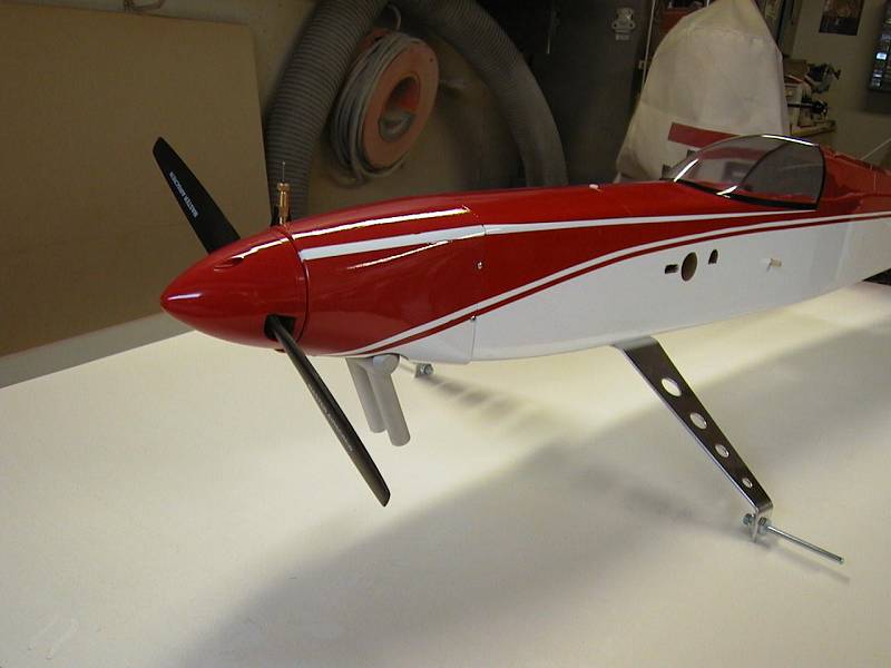

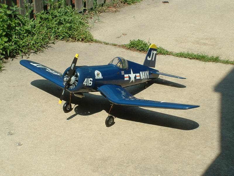

Here's my version of a balsa cowl on the SE. I'd never done a cowl like this before so I just copied what a friend has on a scratch built plane. The right side still needs some work but it is pretty much open; it has to be to be able to remove & install the engine. I'm not completely happy with the way it turned out but it should work OK for a first attempt.
For a first attempt, I think you did well. The main problem I see with a cowl on the SSE is that you need to go from a square shape to a round one in about 4 1/4". A large 2 to 2 2 1/2" spinner helps ease the transition. Chuck, you may look at putting holes in the plywood ring behind the spinner. Then you can access the bolts that go through the engine mounts to the firewall. You might be able to remove the engine and mounts as a unit.

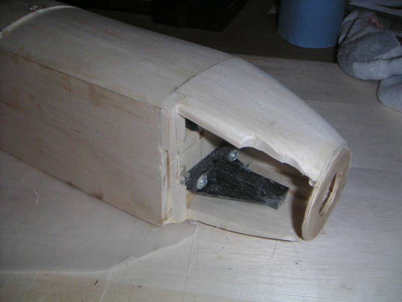

I used t-nuts in my engine mount so I don't have to worry about access for holding a hex nut. There is just enough room to slide the engine in and out. I secured the engine with allen-head bolts. The cowl is glued permanently to the fuselage. I plan on doing it again on my next kit, a highly modified, scratch built 4-star. This time I am going to add something to make the bottom of the fuse a little more round and maybe increase the curvature on the top. This will make the cowl look a little better I think.

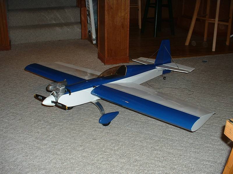

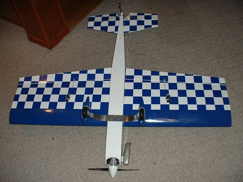

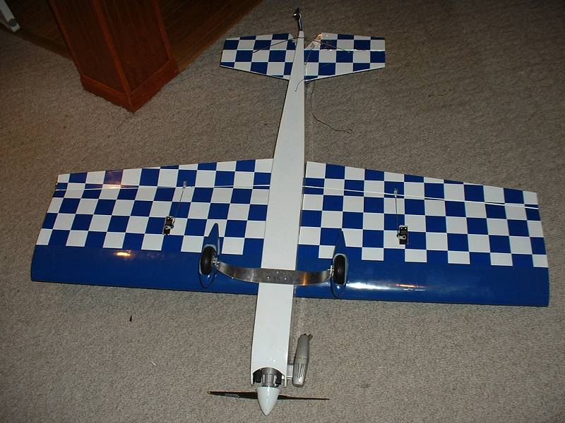

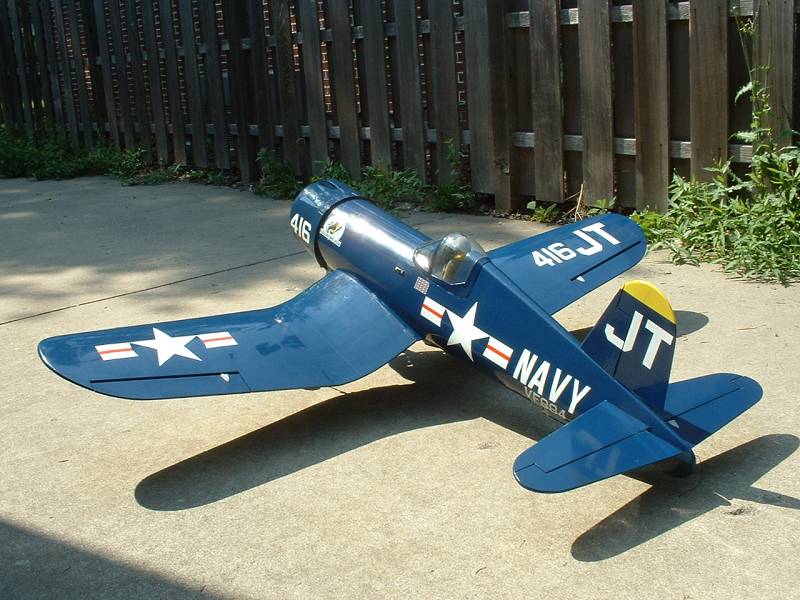

I just finished my SE and here she is. It took three weeks and I am maidening her tomorrow. I figured I better get some pics before the flight. This is my first kit and I think it came out pretty good. Now on to a 28% ege 540 kit. Good luck with yours, looks good so far. Here is my Mustang and Corsair also.

Thanks. I maidened the SE today and you are in for a treat. A really good flying airplane for sure. The thing rolls at twice the speed as my Mustang or Corsair and comes in on final nice and soft. Those warbirds really take a lot of flyin to land. This was a nice change of pace and can do some really cool manuvers. You'll love it. Good luck on the rest of the kit looks great so far.
