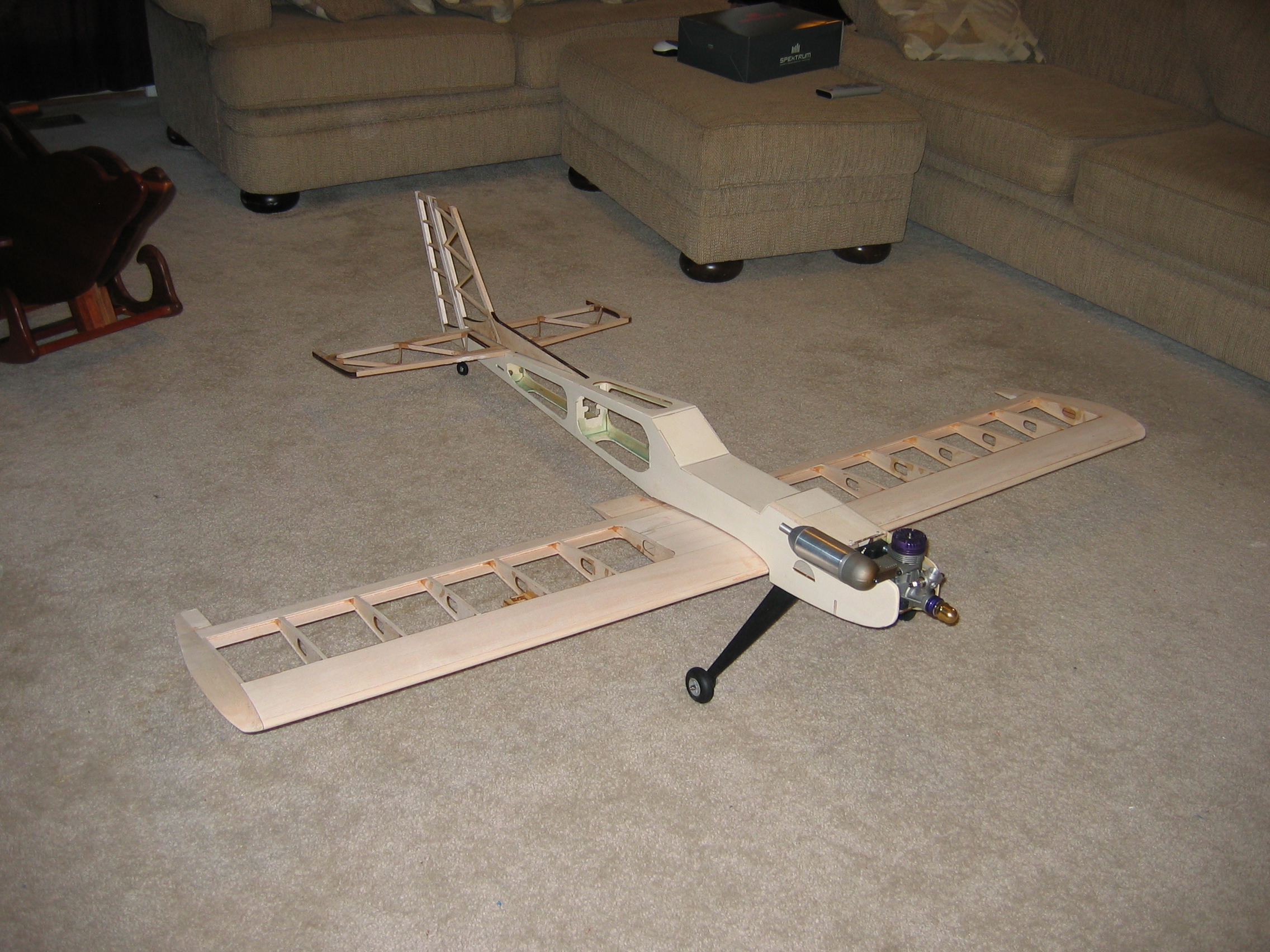

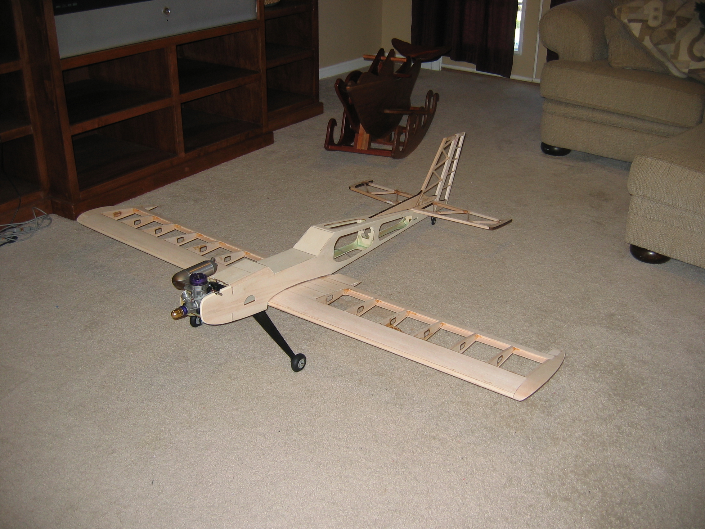

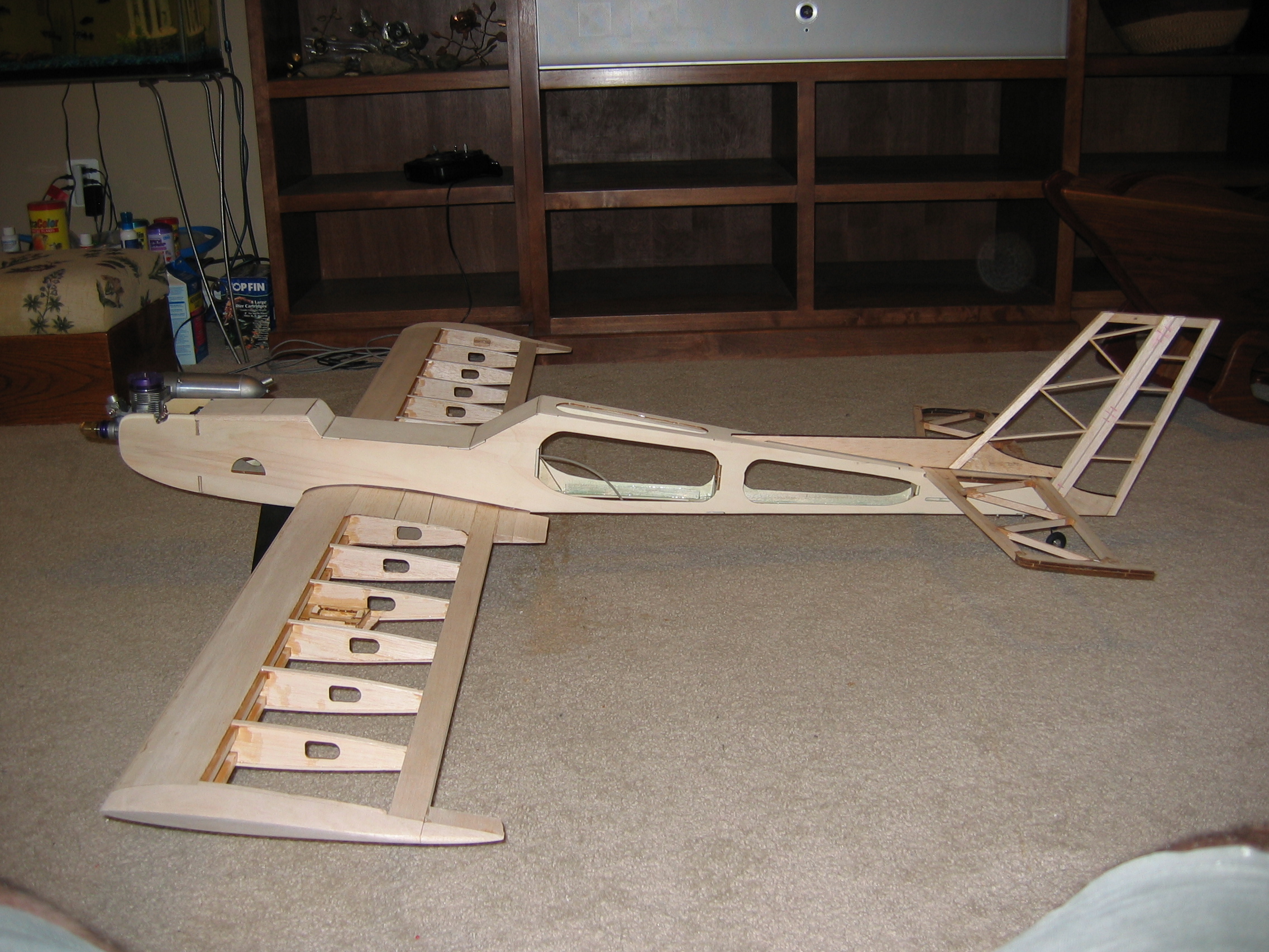

I started building my Tiger 60 about 1 1/2 months ago, after crashing my Tiger II. I'm almost to the point of being able to start covering. I've cut 1/2" off the dihedral on both wing tips. I've widened the ailerons, and I'm widening the elevator and rudder. I have a Tower .75 I was going to put into my TF GE Corsair, but have decided to use it for the Tiger and I'm going to electrify the Corsair. Here's a couple of photos.
