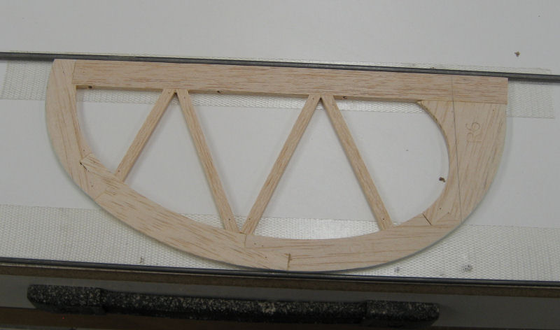

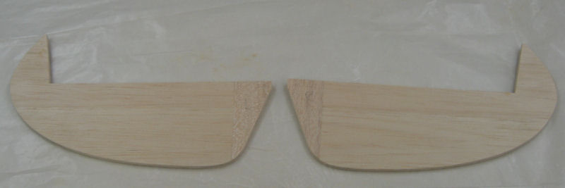

OK, on the the pics (hopefully they showed up in the right order...but I'm sure you can figure it out if not):
1. The obligatory "before" shot. I was lucky enough to get this kit on eBay along with a Stan's Fiber Tech cowl and wheel pants, and a 2 1/2" aluminum spinner...all for $165. Good deal
2. Closeup of the cowl & pants. These are very nice...much better than the stock ABS.
3 & 4. Lots of parts! Everything's marked & accounted for, so...on to:
5. Fin & rudder framed up.
TBC...

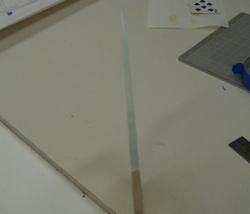

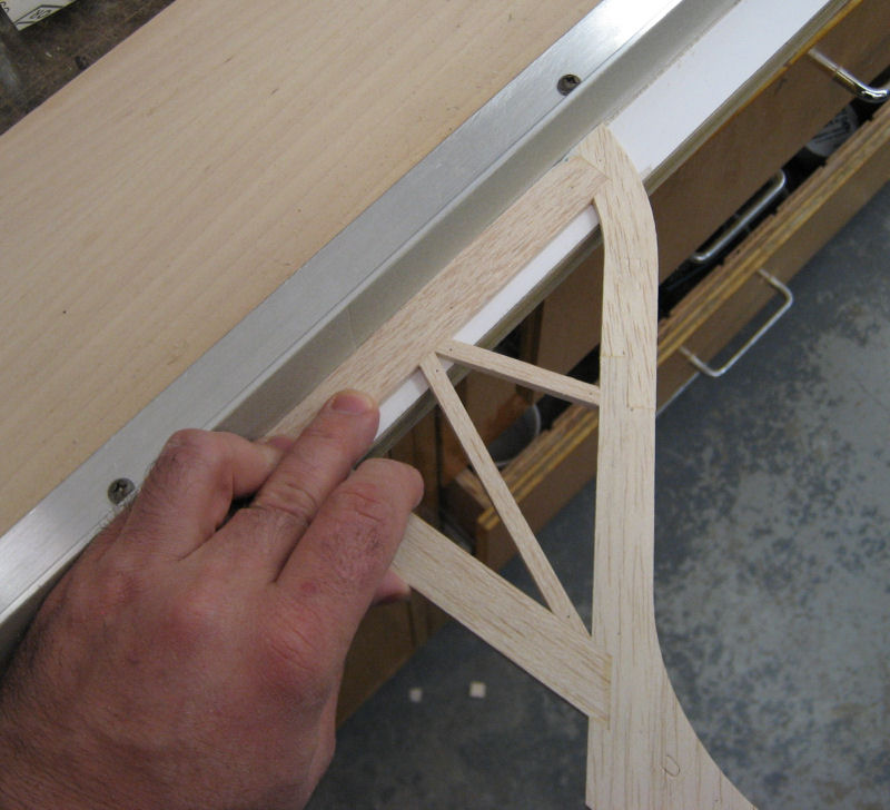

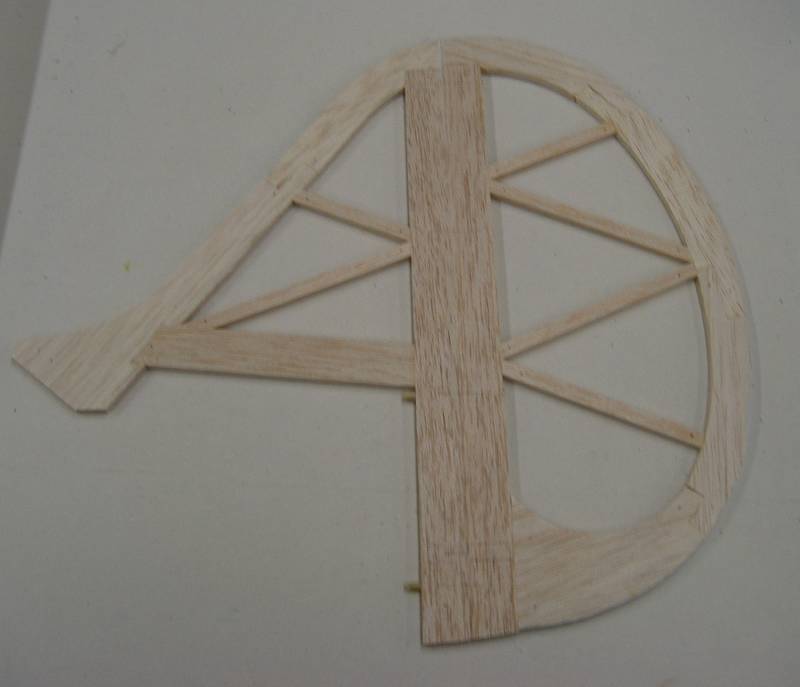

Another good night in the shop. Good to be building again
1. Straightening the fin TE and rudder LE.
2. Jig I use to straighten and square edges of control surfaces, sheeting edges to be jointed, etc.
3. I'm using Robart hinge points. I prefer to drill for them when all edges are still square...so I did it before the rudder is tapered.
4-5. The bonus is that I can join the surfaces using 1/8" dowels and sand it as a unit to ensure everything is flush. (Credit to Paul at Airfield Models for this fantastic idea...at least that's where I saw it )
6-8. Tapering the rudder. I don't remember where I saw this idea, but it works great. Taper the first side using 3/16 wire on the LE and 1/8" wire on the TE. Flip it over, leave the 3/16" and replace the 1/8" with 1/16". Results in a nice uniform taper. I know the directions say the TE should end up at about 3/32", but 1/16" is close enough.
9. Fin & Rudder sheeting joined.
10. Stab and Elevator frame up started.
Oh, the blue stuff on the fin/rudder is some of the pics is Evercoat polyester filler. The die-cutting was a bit crunchy in some areas.
TBC...

Looking good Chris! A couple of questions for you ...
ORIGINAL: ChrisMH
Are you using sandpaper in that Jig? Having trouble seeing it. Is the paper only on the Vertical side of the jig?
ORIGINAL: ChrisMH
Can you elaborate a bit on this process? Are you sanding everything down until flush with the wires? Making everything slope evenly from "front to back"? A little more explanation on that process would help me tremendously.
Looks like you have a great deal of experience in the shop. Hopefully I can absorb some of that experience through the forum.
Thanks for sharing with all of us!
-MA
Old 12-05-2006 | 04:38 PM
ChrisMH's Avatar
Joined: Aug 2006
Posts: 223
From: Fort Wayne, IN
Default RE: Super Skybolt Build
ORIGINAL: MasterAlex
Yep. It's a piece of aluminum angle with 220 grit sandpaper glued to it (3m super 77). I used a left over piece of formica (the white strip) from a kitchen project to create a low-friction horizontal surface to slide the piece being trued on.
I can take a couple of close ups if that's not clear enough.
The wires act as a stop to create a straight taper between the leading edge and trailing edge of the rudder. I just use a sanding block that straddles both wires and sand until I'm not taking off any more wood.
Chris

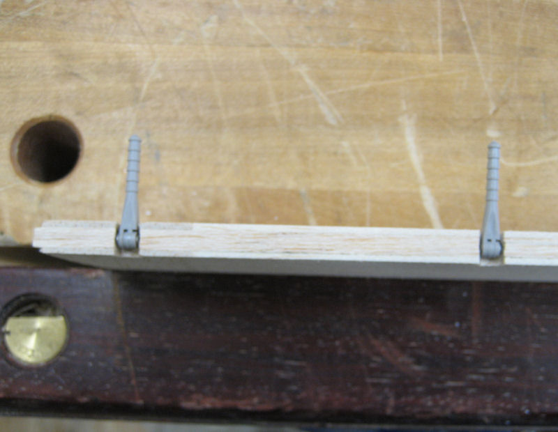

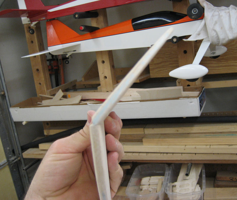

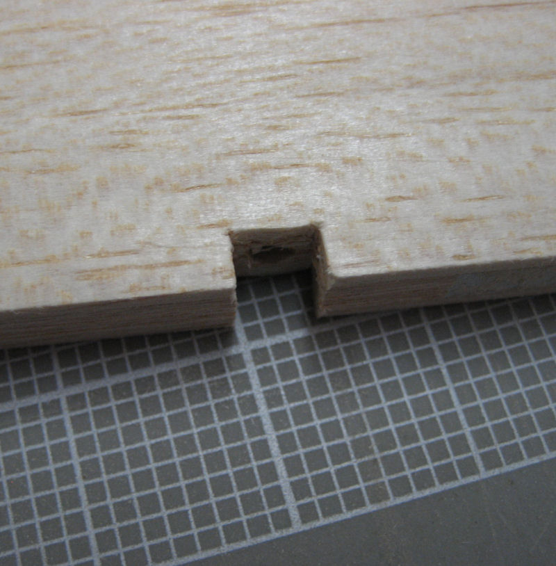

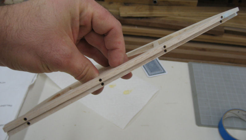

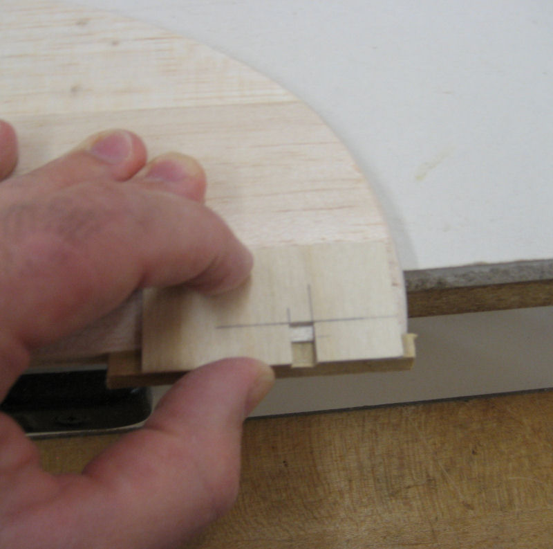

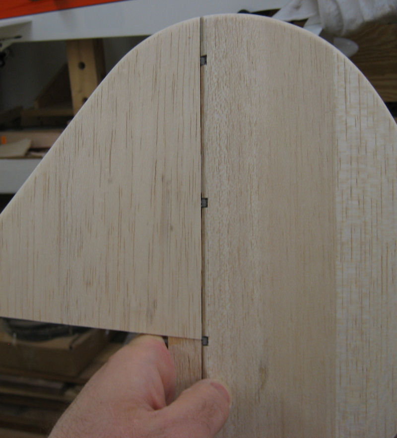

Made some progress this evening.
I build slowly, by the way...I say it's because I'm meticulous. My wife has another word for it...but whatever
1. Got a package in the mail today. I've never used Koverall before; should be interesting. I think I'll buy an airbrush when I get to the finishing stage.
2-3. This is a jig I made to cut clearances for the Robart hinge points. It allows me to cut uniformly for all hinges. I use the jig on the LE of the control surface to mark the location of the cutout. Then I use a square to extend that location to the left and right sides of the control surface. Then I align the jig with the marks and cut along the edges. Some cleanup on the inside and you end up with:
4-5. A nice clean clearance. And they'll all be the same, which appeases my need for uniformity.
6. Sanding block I made to bevel control surfaces.
7. The sanding block makes it easy and quick to make a nice clean bevel on both sides.
8-9. The results. A nice tight hinge joint with plenty of travel. Pretty happy with this one. Now...to repeat it 6 more times.

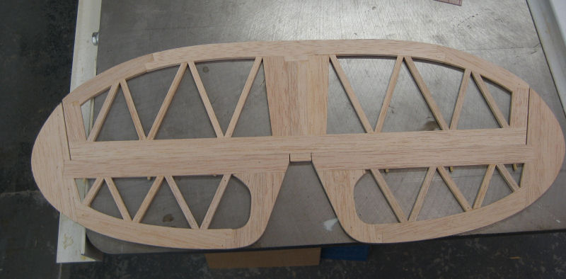

10. I'm sanding the elevators as a unit to ensure they're symmetrical.
11-12. Now that the elevators are symmetrical, I can trim the ends of the stabilizer to match the elevator balance tabs. Can't get much better than that
Hmmm...do I take too many picutures?

I'm deviating from the plan's use of dual pushrods to control the elevators. I'll be using a torque rod with a single pushrod. Should be a touch lighter and a bit simpler.
1. I made a torque rod with 1/8" wire and 5/32" brass tubing. I chose 1/8" because it's beefy enough and because the combination of the tubing and wire puts the rotational axis at exactly the same point as the Robart hinges. So no binding.
2-3. Torque rod installed, hinge holes drilled, and elevators sanded flush with the stabilizer.
4. Elevators tapered using the same method I used for the rudder.
5. Fuselage sides glued up. I filled in the die-cut holes for the pushrod exits. I'll drill angled holes (using brass tubing) for the elevator pushrod and the rudder pull-pull wires once I figure out exactly where they will run.

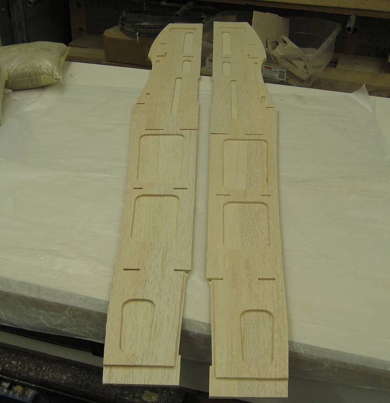

It was actually nice enough to fly here today...so I did. Maidened my Skeeter 36 (electric 3d from Billy Hell RC), which flew great...except I stripped the gears on two Futaba 3110 servos...haven't investigated that yet...kinda disappointing. Did a little building, but nothing major. Mostly sanding. Every time I sand I'm more in love with my Delta air cleaner. Lovely.
1. Horizontal stab sheeted. Seriously...it's under there.
2. Elevators sheeted.
3. Fuse sides are complete with doublers. Die cutting on all of these was terrible.
4. I made a new firewall out of 1/4" Baltic birch (far right). I don't know what kind of plywood this kit uses, but it's awful.
<rant>
OMG what is up with the quality of wood and die-cutting in this kit? The balsa ranges from rock-hard to soft as jello. Maybe I got an old kit. Maybe the dies were old. But this is some of the worst stuff I've seen. I do believe I'll end up remaking most of the fuse formers, plywood ribs, and any parts that hold the wings on. Disappointing. Good thing I love the way the plane looks as much as I do. Note that I did buy the kit on eBay, so it may have been old. I hope so, and I hope the new ones are better.
I think you can look for me in the scratch-building section after this...
</rant>
