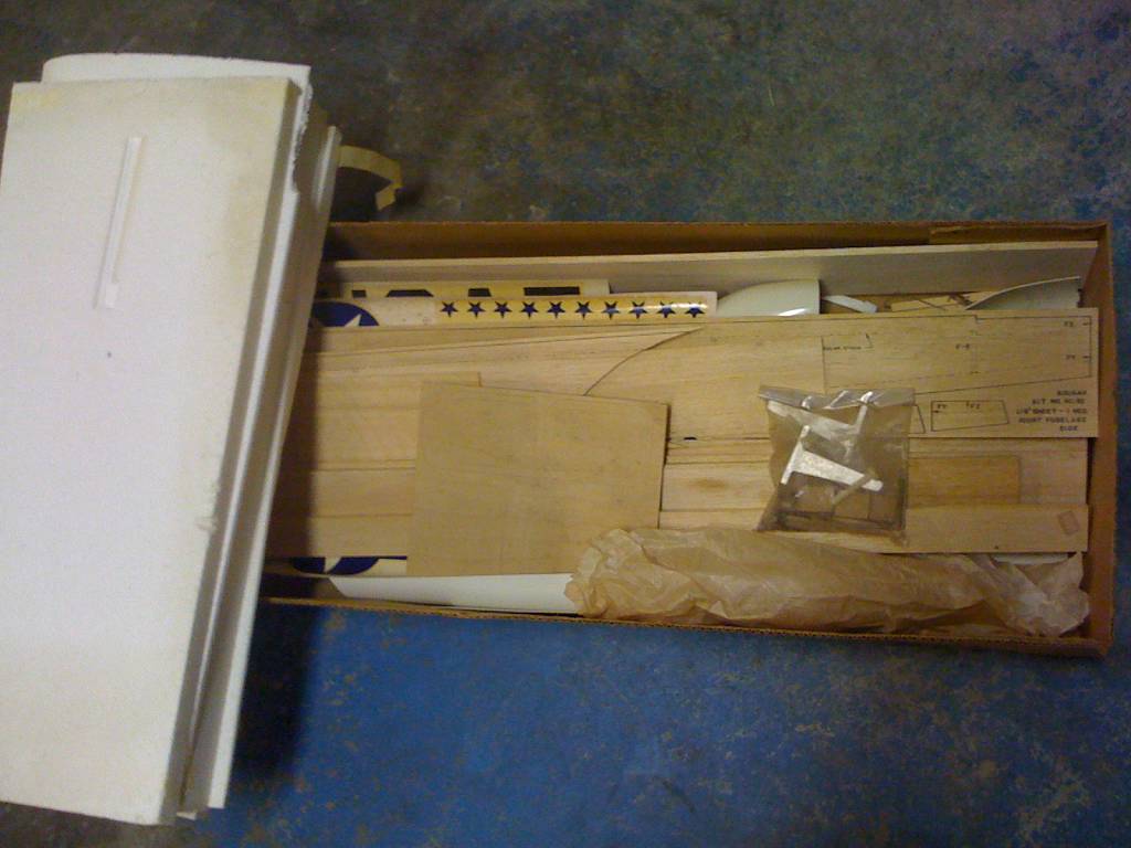

A buddy of mine gave me an old Kougar kit and I'm not going to do anything with it. I thought I'd post here first to see if anyone is interested before I list it on the for sale thread. Like I said it's old and missing some wood but all the important stuff is there. IE; wing cores, deck, cowel, canopy... Also the Hardware pack is there but no plans. I'd let someone have it for shipping plus a little to get it boxed up. The top box is missing.
Let me know...

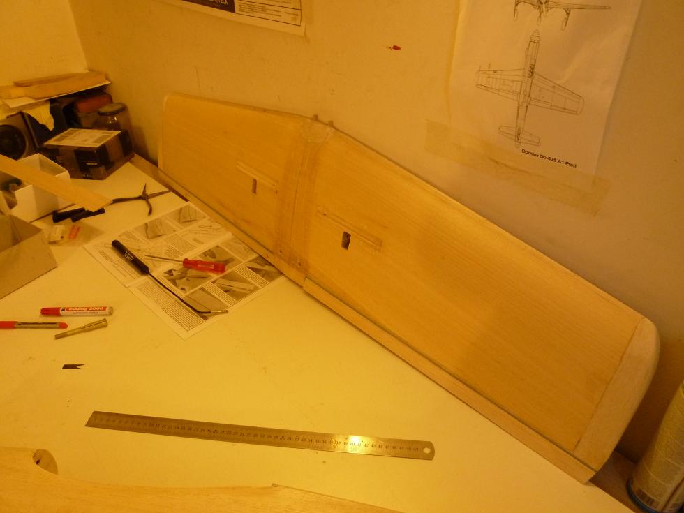

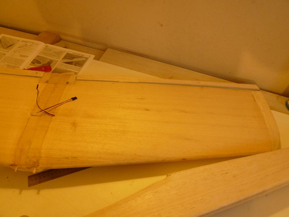

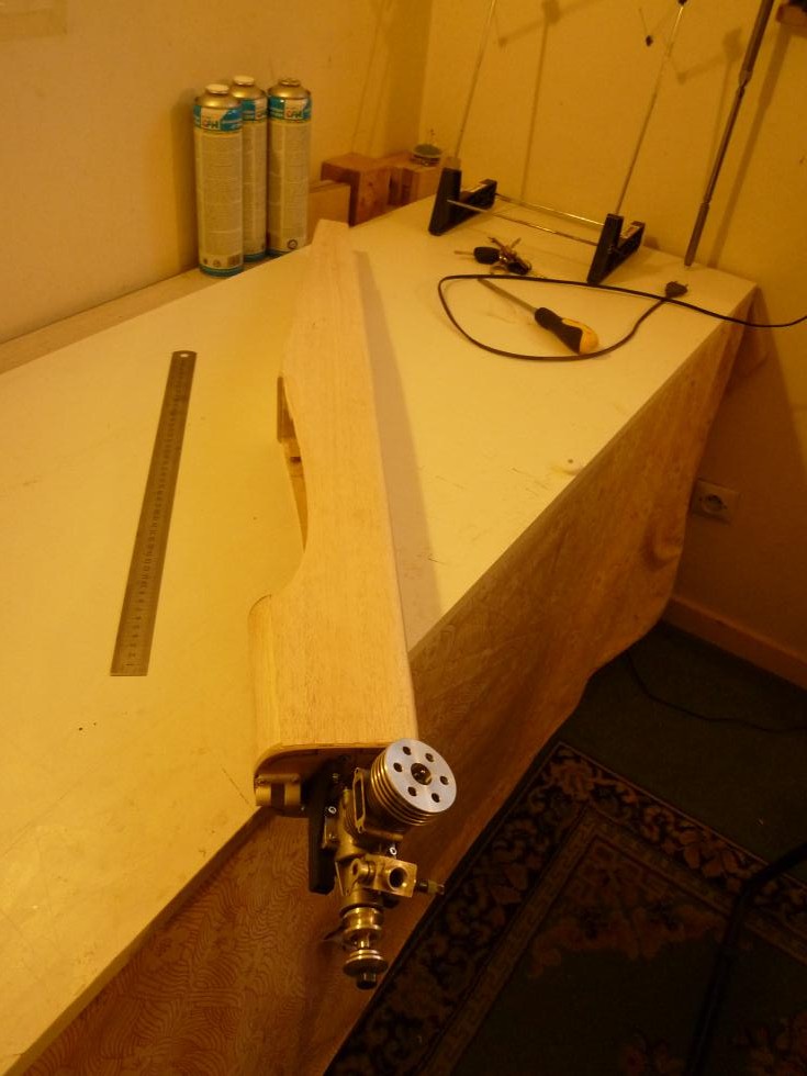

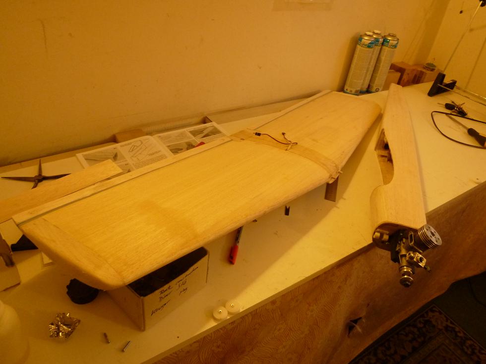

For the wing of my new Kougar, I used Samba boards in one piece glued with gorilla glue, in place of the balsa boards, and two servos HS 81
for ailerons

[quote]ORIGINAL: claude roland
for ailerons

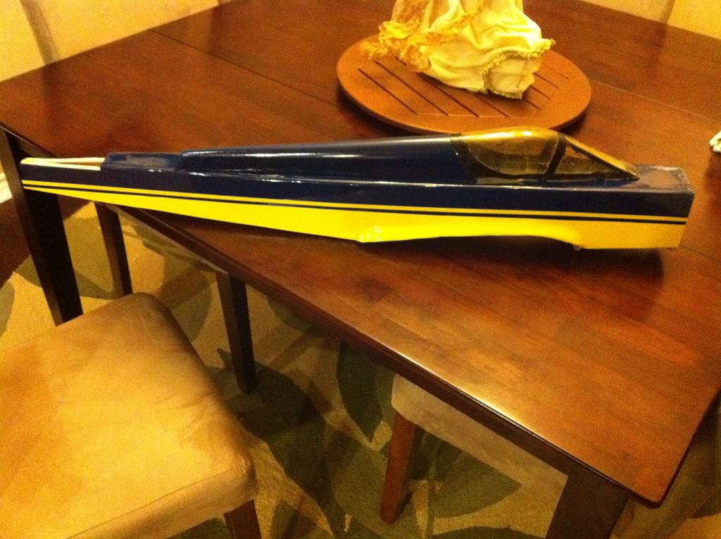

Just thought I'd throw up a photo of my Kougar restoration. I got it in trade a while back but it was in need of TLC. I have already started cutting the tail to make it a little more sporty. I am planning an O.S. .46AX since that's what was on it, and the cowl is already cut for it. The wings are going to be a hassle as they were cut up pretty good for retracts. However, they were very big and bulky for such a small model. I have since removed them and am filling in the holes with pink foam and guerrilla glue.

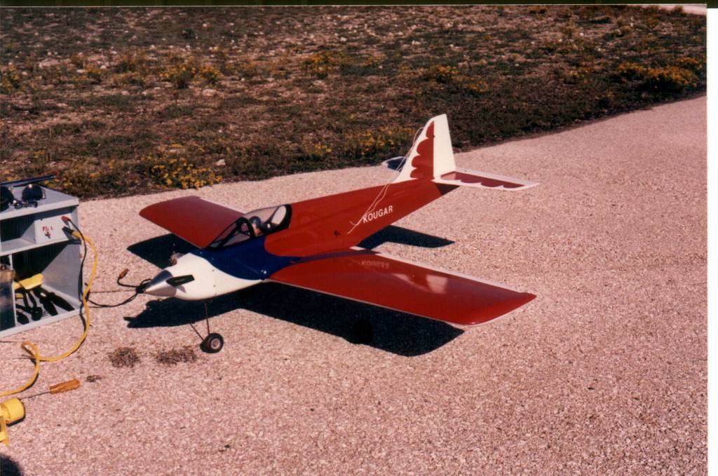

Here's pic of My Kougar from a few years back..
I put retracts in mine it has a Webra Speed .40
Epoxy paint
Very Grovy flyer I must say
Happy Landings Ya'll
Chip

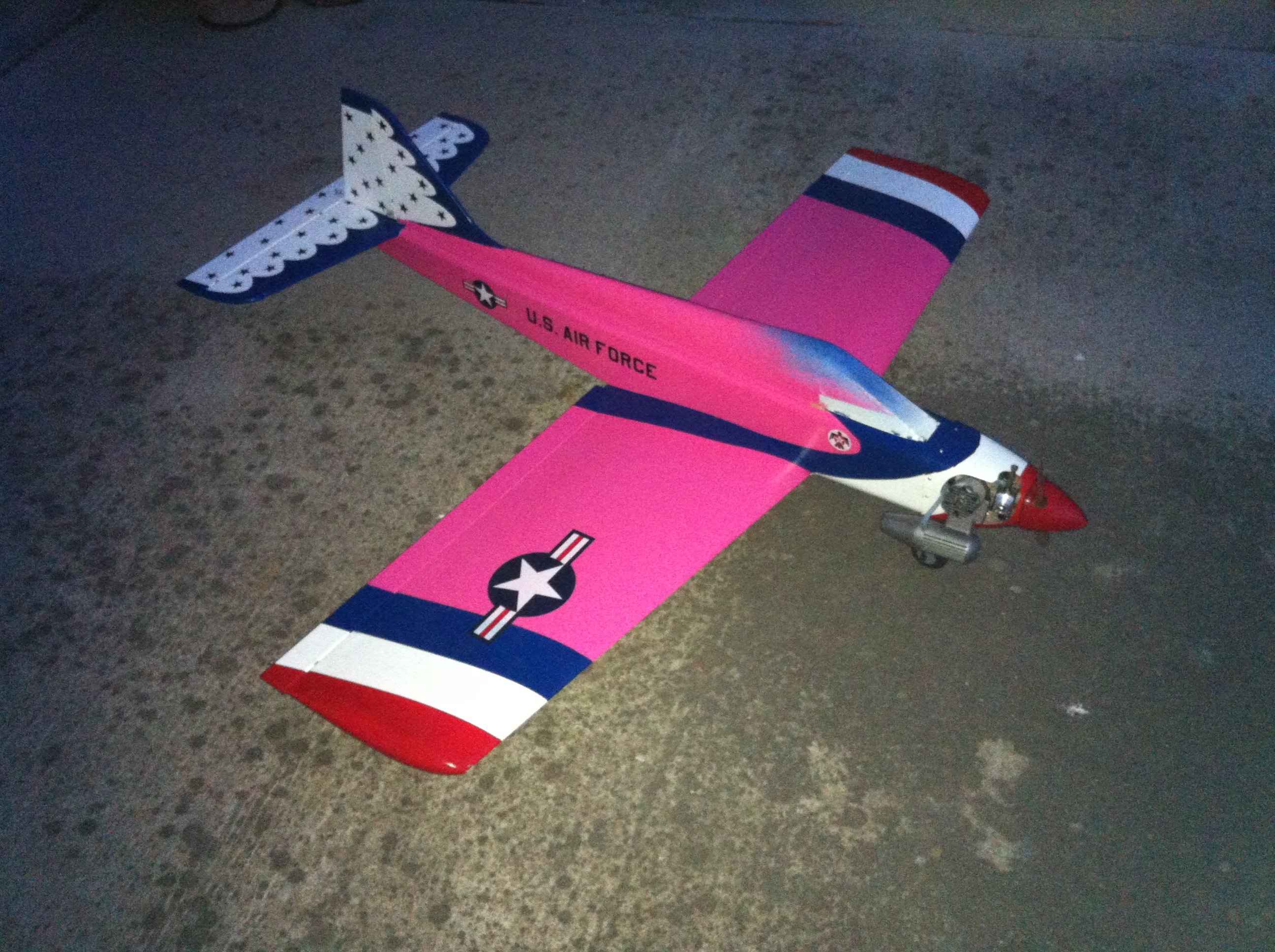

Just rolled out my Kougar from the hanger for the first time. Power is an Enya 45 and empty weight is 5.4 lbs. My daughter bought it for me for Fathers day last year. I said, you bought it so you get to pick the color. It took a while, but a pink Kougar doesn’t look too bad.

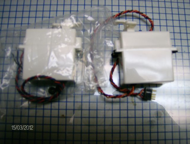

hi all you kougar fans installing retracts.
I have 2 ace 180 degree retract servos brand new never been used.
the connection arm on these has 3 holes which is suitable for 3 gear retracts
I will try to post pix of these and will let them go for $15.00 each plus shipping
if anyone is interested.

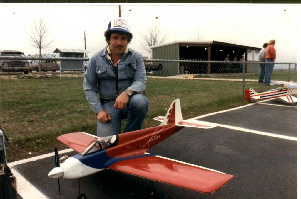

Hey Guys,
Saw the Kougar post and thought I'd put a few cents in..
Here's a pic of my Sig kougar from back in the day think it was 1988 or so..
Mine has retracts, webra speed .40 for power K&B superpoxy finish.. just under 7.5 lbs..
I flew it all of 5 seasons and still have it.. Great flying bird, loved it..
Happy landings ya'll
