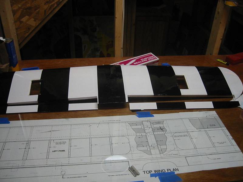

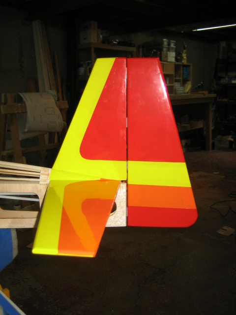

Here are a couple of progress pictures from last night and yesterday. I really love building and creating planes that won’t have their clones showing up at the field. What I really despise in this process is how much time I take to cover. It’s a double edged sword – make the pattern easy to apply and less time consuming to cut and iron down and I’m less satisfied with the results. I have no one to blame but me for the pain endured in covering. Okay, therapy session over.
The three pictures below show progress over the last 2 days. Picture1 is of the Top Wing (finished back in March) and the ailerons that I covered yesterday. Fortunately when I cut the covering for the wing, there was enough extra to lie down onto the aileron keeping me from crafting the black & white pattern. All I had to do was line it up and iron it down.
I then created the wing “sheet” by piecing together the black and white stripes as I had done before (for an explanation of this see page 11 of this thread). Once the sheet was made, it was fairly easy to iron it down and hit it with the heat gun. Picture2 shows the Bottom wing half covered and mostly trimmed.
The Bottom wings have the servos mounted in them (I did the dual aileron modification), so the access hatches have to be cutout of the covering. Picture3 shows the hatch cutout in the right wing.
Progress? Yeah, I suppose it is. I hope to wrap up the left side and the sunburst pattern on the tops over the weekend. We’ll see how far I can get as the sunburst pattern has a bit more measured cutting.
Picture1 – Aileron bottoms covered to match stripe pattern
Picture2 – Bottom wing half covered
Picture3 – Servo hatch cutout
-MA

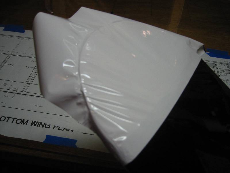

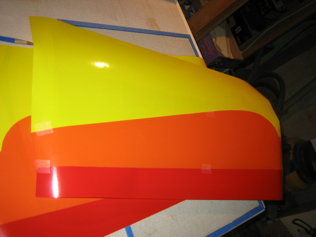

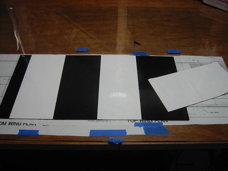

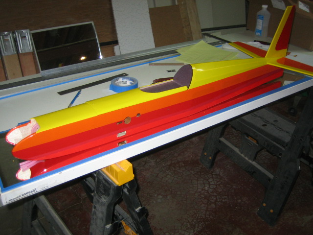

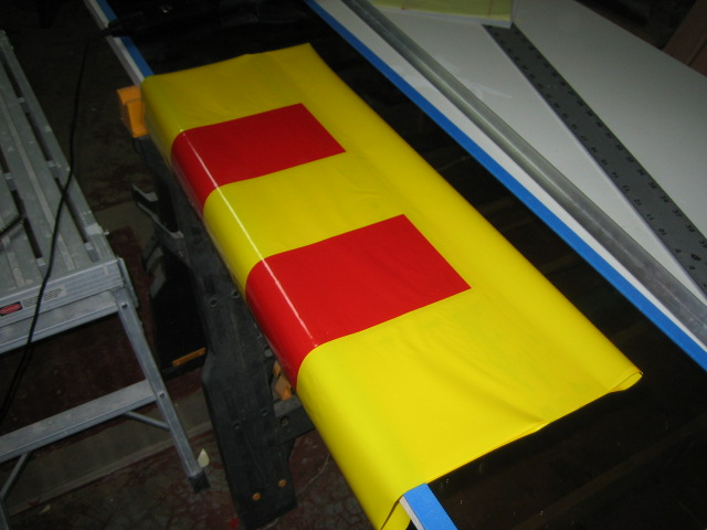

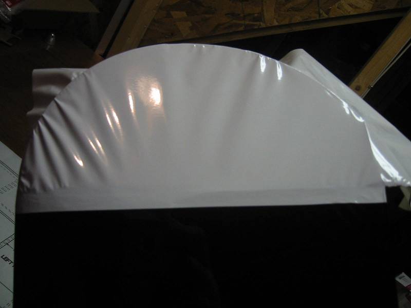

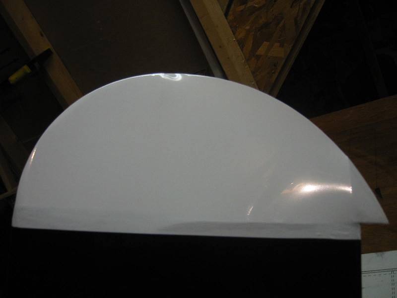

Back at it on Saturday. I’ve decided that I have got to be the slowest coverer on the planet! [:'(] This whole process took me about 2.5 hours this morning. I am very satisfied with the results, I just wish I could get there faster … shrug
Picture1 shows how I start putting together the sheets of covering so I can attach as a single sheet. I like doing it this was so I can ignore where the solid surfaces are under the covering. Today I finished the left bottom of the bottom wing and the bottom’s of the bottom ailerons. Picture2 shows the completed bottom wing with the ailerons spaced beneath.
When covering the tip I figured I’d show how horrible it looks about ½ way through the process. The first time I did this, I thought I had ruined the tip completely. This is more a testament to Ultracote than my skills, but you can certainly see how forgiving that material is. On this particular build, the black is Monocote and the White is Ultracoat – no reason other than that’s what I had.
Picture3 shows the wingtip after I had tacked down the covering on the top, bottom and center of the ellipse. I had also stretched the covering and tacked it down between the top and center sections. Picture4 shows the wingtip after I had completely stretched and ironed down the edges. This is truly a scary sight to behold isn’t it? [:-] Ultracoat shrinks very well and Picture5 shows the tip after I hit it with the heat gun… amazing difference, eh? There were still a few very minor blemishes in the tip that came out with my trim iron (picture6).
Next I have to flip over the wing and make the sunburst for the top. We’ll see how far I progress the rest of the weekend – probably not much given my schedule. I do feel very good, however, about picking this back up.
Picture1 – Creating the full sheet
Picture2 – Bottom of bottom wing completed
Picture3 – Tacking covering on wingtip
Picture4 – Wingtip ready for the heat gun
Picture5 – Wingtip post heat gun
Picture6 – Wingtip after some touchup with trim iron
-MA
