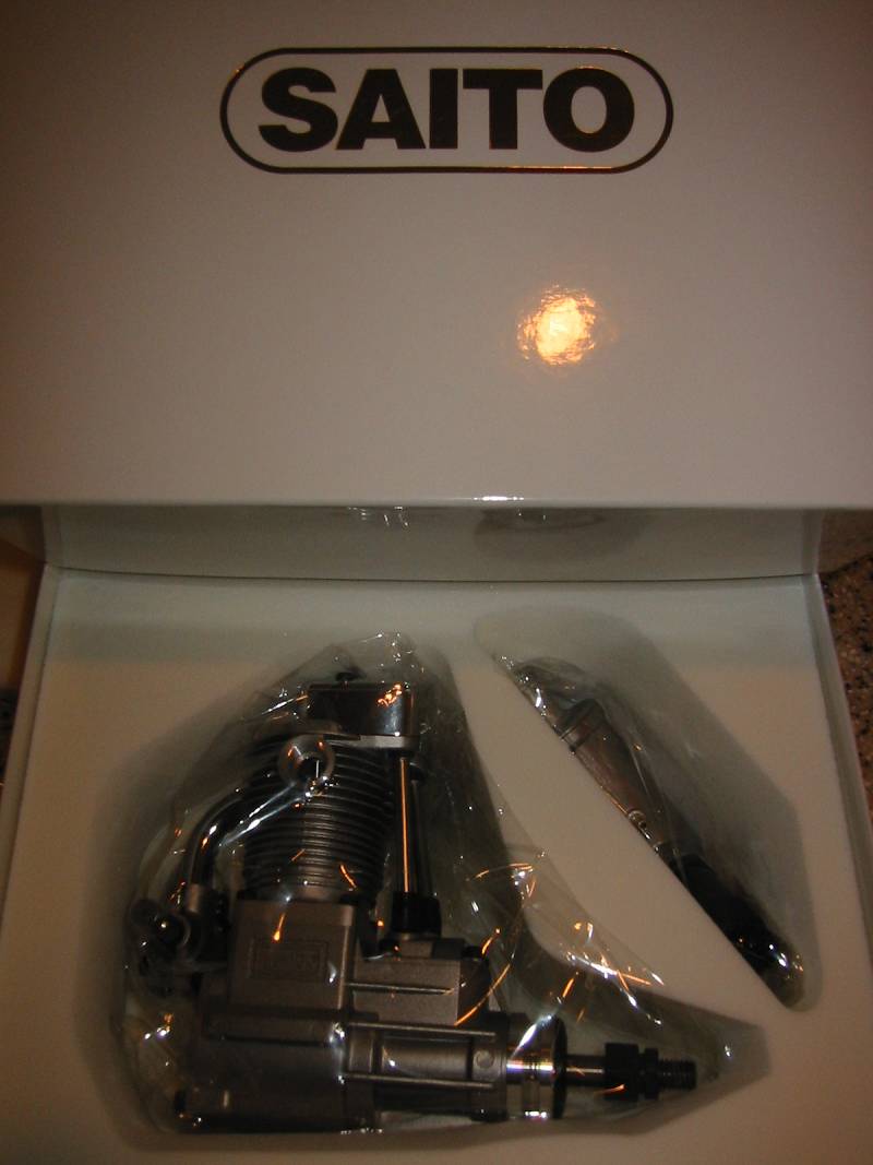

Chashint, My bipe came out at 7 lbs even. I had a Saito 72 and I was supprised because I like glue. Only thing I did was to sand the tail a good bit because I read in Hook's thread where lots were coming out tail heavy and I didn't want to have to add weight. Mine balanced perfectly and flew great. Hope to build another soon as I miss it. It flew off into the woods and never could figure out how I lost reception. I guess I should have called in the NTSB. I then built an Astro Hog and have only flown it once. I guess I'm nervous it might escape too.

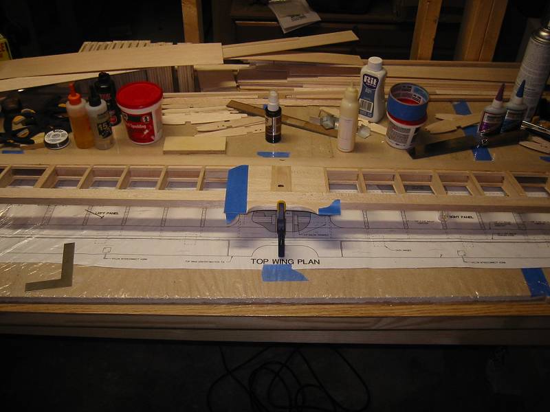

When I last posted, I was finishing up the wingtip sheeting and attaching the trailing edge centerpiece. Both of these steps are represented in Pictures1 and 2.
The next step is to shape the top wing alierons into the wingtips. Since the centerpiece is curing, I decided to move on to the lower wings. I'll re-visit the ailerons on the upper wing when I have to do so on the lower wing.

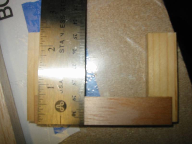

TaDa! Milestone moment in the build - changing out the plans (Picture3). For whatever reason, I feel like the bottom wing is going to go faster. Probably because I've already done most of this once on the top wing and I think I know what to expect. We'll see - if today's build is any indication, the bottom wing will be mostly complete in a couple of days.

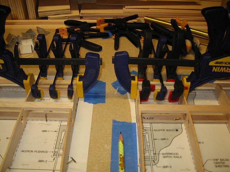

Next came the placement of the Top Spar and leading edges (Picture6) - since we've covered most of this earlier in the thread, I won't re-hash the techniques.

Picture2 - Trailing edge centerpiece, shaped and curing
Picture3 - Here are the bottom wing plans before I cut them out and placed them side by side

Picture6 - Top Spar in place, leading edges getting clamped and curing

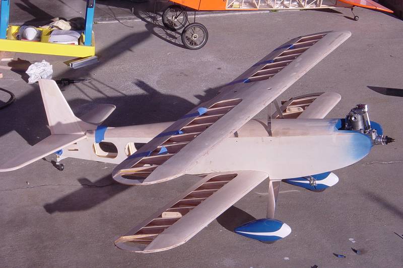

My Hog is in the "buff" right now. Just a few more details to iron out along with a bunch of sanding, and this pig will be ready to cover! I'm having a blast with this build. It's my first bipe, and it's already a whole new world!

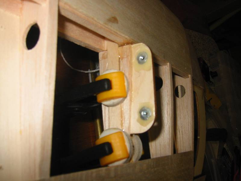

Anyone out there superstitious? Me? Naw, not me - I wore the same pair of socks to every football game in high school - didn't "feel" right playing without that particular pair. Tore my ACL the game I didn't wear em ... No, I'm not superstitious. No black cats in the shop ... ever (but that's a different thread here on RCU
). Anyway, according to the date stamping on my camera, this is the 13th day of the build - cue spooky music.Today, I start by shaping the trailing edge of the wings like I did on the Top wing. Once again, my trusty razor plane makes quick work of it (picture1). From here, I goto the I-strut mounting also like the top wing. I had a bit of trouble here as some glue had squeezed down into the space between the 2 W-2 ribs - I shot a picture (picture2), but you can't really see the glue in there - trust me, it was there. I used a small file to get rid of the glue and made room for the I-Strut. This is where the "building gods" were trying to get my attention - saying, "Alex, look at the plans ... this is important ... we're making this difficult so you'll pause, re-read the directions, and not go down the path you're clearly on ..." Unfortunately, I disregarded the signs and plodded along, epoxied the struts and clamped (picture3).
When the epoxy cured, I came back and added the wingtip sheeting like I had on the Top Wing (picture4). While the sheeting dried out from its shower, I started on the aileron hatches. Pretty straightforward stuff here. One neat device I picked up at one of Hobby Lobby's "crash sales" last year was this neat little device that plugs into a battery and allows you to work/center servos without a radio - nice. I used this (picture6) to make sure my servo was centered before epoxying to the hatch. Also, when I drilled out the servo mounts, I used a pin drill - very handy as well (picture7)
... continued in next message.
Picture1 - This is after about 5 minutes of plane work. Imagine how long that would have taken to sand off - not to mention the balsa dust.
Picture2 - Glue seeped into this area where the I-Strut gets inserted. I used a file to get it out and inserted the I-Strut.
Picture3 - I-Strut epoxied into place, clamped, and curing - you Hog experts are laughing/crying at this picture...
Picture4 - Wingtip sheeting - the sheeting is wet, which is why its darker in color.

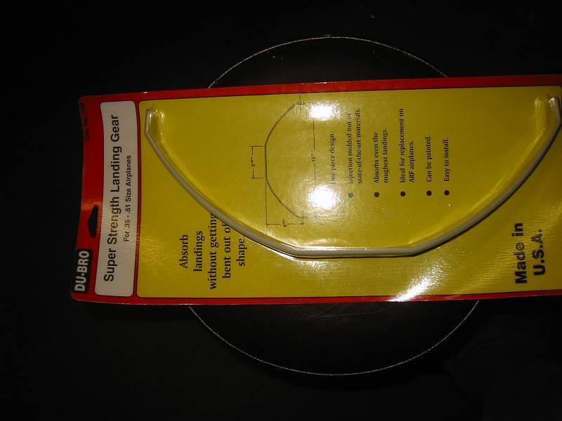

Picture5 - Dubro langing gear I picked up at the LHS
Picture6 - New gear compared to the Kit Supplied gear - slightly taller and wider.
Picture7 - Servo centering device.
Picture8 - I liked this so much I posted it twice!
Picture9 - Drilling the servo mounts.

I removed the ribs with the I-Strut from the wing entirely - GASP. (Picture6) Honestly, this came after careful consideration. I had a plan on how to "fix" this...

Picture1 - I crafted this to make sure the wing had the proper dihedral

Picture7 - Making an extension to fit between the ribs
Picture8 - Dry fitting the assembly onto the proper wing - popsicle sticks re-inforcing either side of the ribs and extending up to sheer webbing
Picture9 - Epoxied and clamped

Picture6 - Entire assembly removed from the wing
