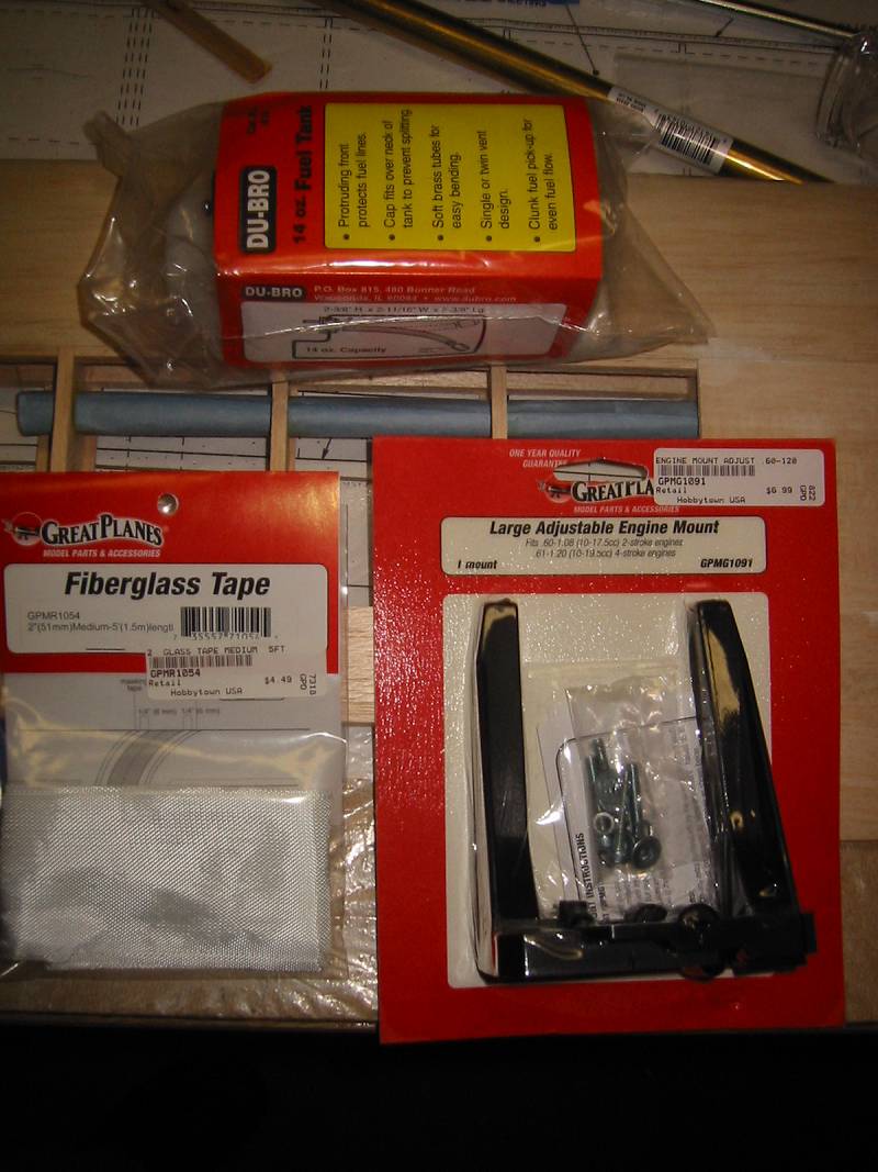

Old 02-20-2008 | 07:08 PM
  #158
MasterAlex's Avatar
Joined: Jun 2005
Posts: 786
From: Central, IN
Default RE: Sig Hog Bipe
Well I finally got over to the LHS and picked up some strip fiberglass for the bottom wing (shop gremlins must have taken the kit supplied tape). While there, I picked up a glass motor mount for the Saito and a 14oz fuel tank (Picture1). I managed to finish the bottom wing by adding the block trailing edge (what used to house the aileron torque rods) (picture2), then sanded down the center and prepped it for the strip fiberglass.
Whenever I add the strip fiberglass to a wing I try and keep the epoxy on the tape and off the edges. I usually tape off the area as you see in picture3. This keeps the epoxy from getting where it shouldn't. I let this setup overnight and came back and sanded down the rough edges of the fiberglass tape. Finally I glued on the plywood wing bolt plates (Picture5) and set aside the bottom wing.
Next up - the Fueslage
Picture1 - LHS supplies
Picture2 - Trailing edge blocks glued - securred with that ever versital blue painter's tape
Pciture3 - Containing the strip within the tape keeps things neat and tidy
Picture4 - Epoxy applied and curing - tape removed
Picture5 - Clamped on the plywood wing bolt plates

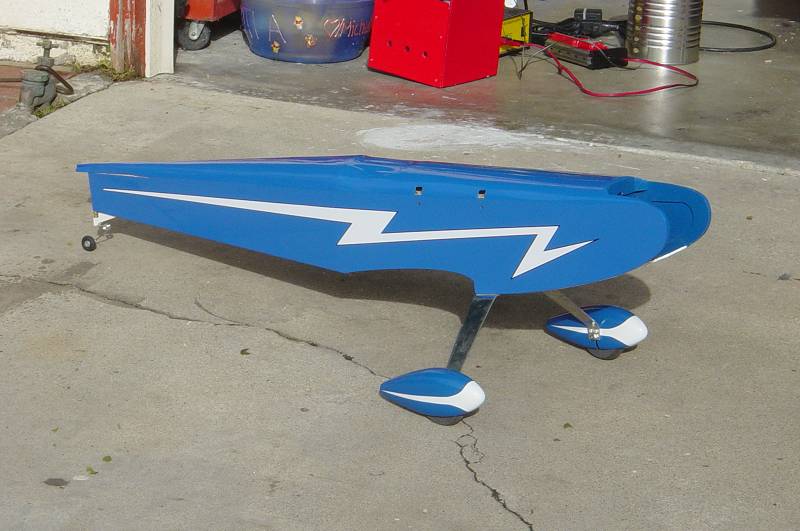

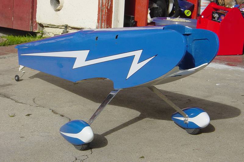

Old 02-22-2008 | 03:13 PM
  #165
*JCB*'s Avatar
Joined: Sep 2004
Posts: 689
From: Long Beach, CA
glad you got things worked out, MA.
As for my Hog, it's ready to cover!!

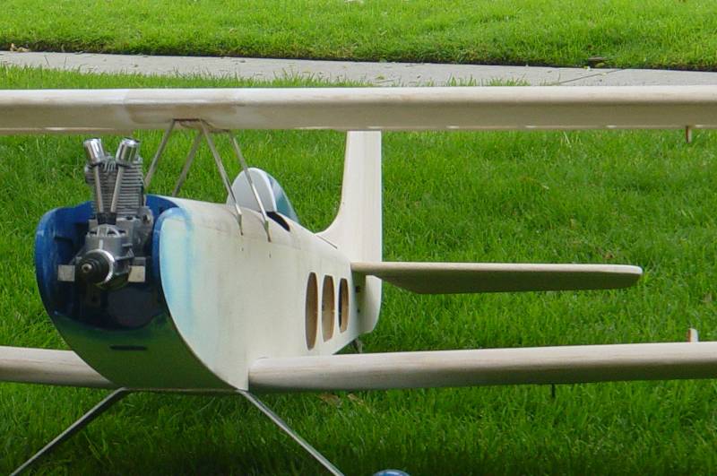

Old 02-24-2008 | 06:45 PM
  #172
*JCB*'s Avatar
Joined: Sep 2004
Posts: 689
whoa baby - i'm gettin' excited!

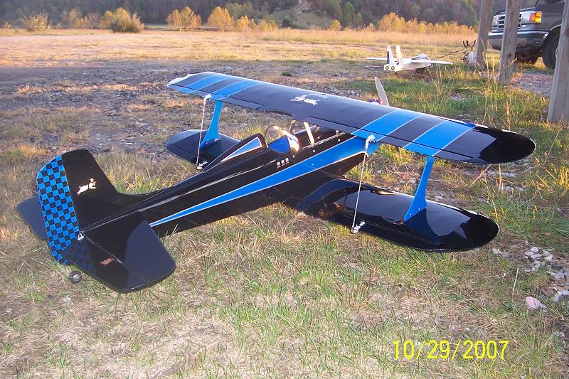

Old 02-25-2008 | 12:32 PM
  #174
r2champion's Avatar
Joined: Sep 2006
Posts: 497
From: Mayking, KY
Just another Hog to add to the collection...I still don't have the 91 4-stroke on her yet, but will within a few days.
