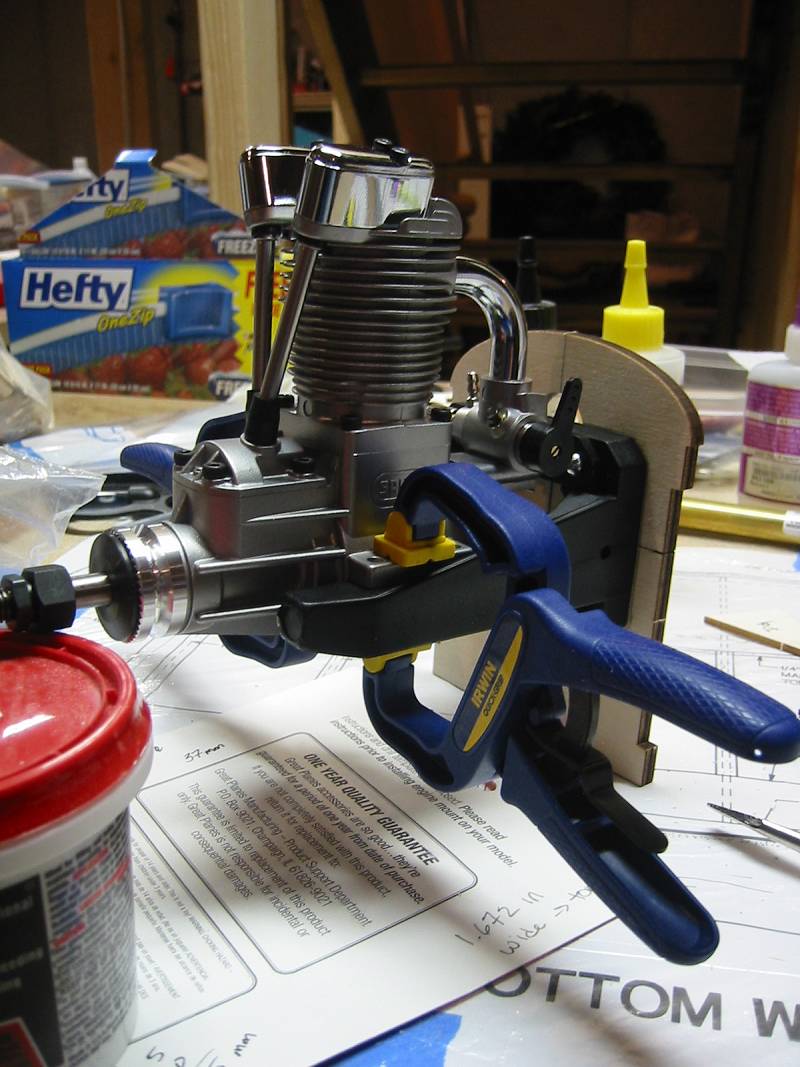

Guess what showed up in the mail today? Yep, you guessed it, sheet 1 of 2 from SIG! They Rock!! I called them on Friday morning and I got the package today - no hassles; as it should be. [sm=thumbup.gif]
I had done some of the fuselage assemblies before noticing my "plan issue" and I'll post those pics here. I purchased the Great Planes adjustable engine mount for the Saito 100 instead of using the kit supplied one. Here are some pics of me marking the firewall (picture1) for the mount. I was impressed by the design of this adjustable mount. They give you a template for the mounting bolts that you drill to begin with, then the posts can slide further apart (while keeping the "base" hole pattern) - took me a bit to believe how simple this was - but it worked.
It was nice to see how the Saito looked on the firewall (picture3) ... I can almost hear it now.
Next I went on to the fuselage doublers, making sure I had a left and a right side, I glued them down and left them to cure overnight.
I came back and added the cabane support (P3 and P4). I tried to be careful here and not get glue in the opening of P3 as I've seen other's get bogged down here. I drew out the areas that needed glue on the fuse before proceeding (picture5). I then carefully applied CA for the P3 block and pressed it into position. I followed that up with the P4 support. All that was left was to drill out a hole and pound down the 4-40 blind nuts. The epoxy is curing on the blind nuts as I type this...
Next up - attaching the firewall and F3 former as the skeleton starts to take shape.
Picture1 - Firewall centerlines marked
Picture2 - Engine Mount drilled and temp secure
Picture3 - Ain't she perdy?
Picture4 - Fuselage doublers - quadruple checked for right and left sides
Picture5 - Marked the cabane support before gluing
Picture6 - Completed fuse assemblies and cabane support

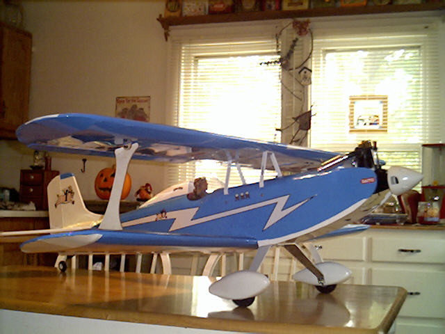

I used Ultracote Corsair Blue on my Herr Pitts Special Bipe w/ Krylon Fusion Navy paint on my cowl in the below pic. It's a shade off but it's pretty close to the naked eye. Seems my camera picks it up more. Thinking a coat of black before the application of the Navy mighta helped darken it a bit? Cleared with Minwax spray polyurethane.

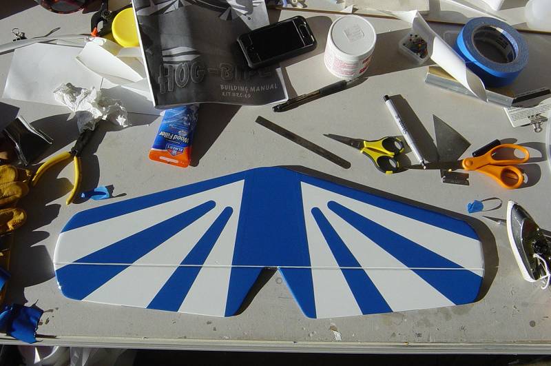

somegeek: I'm using Ultracoat along with some random paint from Home Depot or Lowes (i can't remember). I just picked the color that matched the best. See attached pic for brand of paint
On to why i'm making this post - my horizontal stab is done being covered. SHEW - WHAT DID I GET MYSELF INTO?!?! Being incredibly picky about details, it took me a LONG time to cover the stab, hopefully the wings won't take as long. I suppose a good amount of the time was spent figuring out angles for the bursts, so i think with that being done, the wings may go a little faster. However, I'm pretty happy with the outcome of stab. It's not perfect and it's a hair different from the box cover, but like i said, i'm happy with it...

Those bursts look good! I like the curved tips. Still have the burst look but no worries regarding edges peeling up.

I figure the "back end of the hatch will be held on with magnets and the front will have dowels through the firewall. The airflow will try and lift up the hatch at the front (not happening with the dowels) and will be less of a factor at the "back" of the hatch. If, after I build this, it appears that it's not going to work, I'll add the screw re-inforcement before the maiden.
Picture1 - Rare earth magnets 1/2" diameter
Picture2 - Quick mockup of former and magnet configuration
