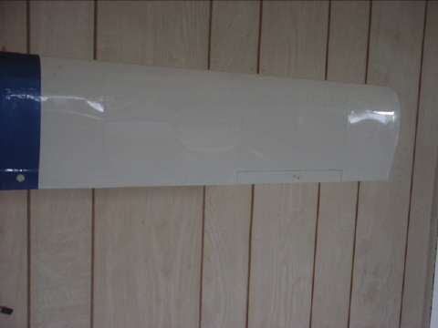

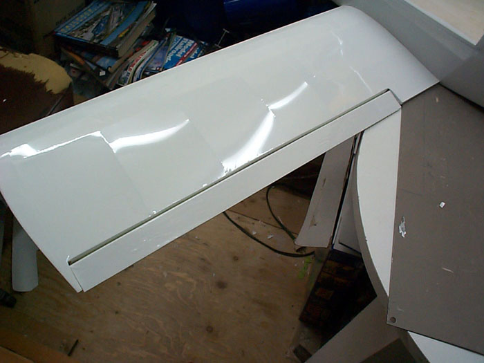

i found it easy to convert my wings to aileron equiped
here's my piper cherokee wing i converted in only 20 minuites

thanks derailed, looks good, i did exactly the same thing. are you using two servo`s or one. if one how did you route you linkage ?
sjim
Old 07-07-2003 | 07:44 PM
Posts: 63
From: bathurst , NB, CANADA
Default need to build
i used two servos
this way, it can double as flaps
AKA flaperons
wonder how it stalls
lol
Old 07-08-2003 | 03:38 AM
Joined: May 2003
Posts: 8
From: Hudson, FL
ok i never thought about that, flaperons, i like going slow, but not that slow guess i`ll use the two servos system also,thanks for info, cul sjim

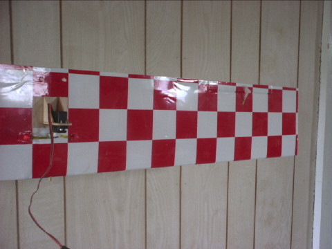

On my Senior Kadet I just cut off the back of the stock trailing edge which left 5/8" remaining. The thickness was then about 1/4" at the back edge. Next I used standard 1/4"x2" tapered stock to make full width ailerons. CA type easy hinges were used and dual servos. The tip of the aileron stock gets angled to match the wingtip shape.
This is about the easiest way to make ailerons for this wing. By the way, I've been flying this plane for about 2 years now and it still remains one of my favorites.

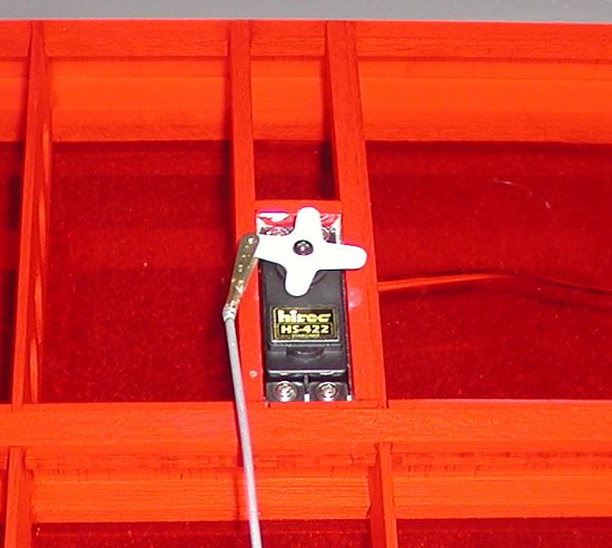

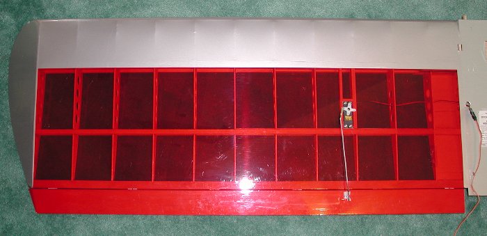

Old 07-08-2003 | 08:29 PM
Posts: 200
From: Raleigh, NC,
Here's a closeup of the servo mounting area. It just takes a few extra sticks and no structural changes to the wing.
