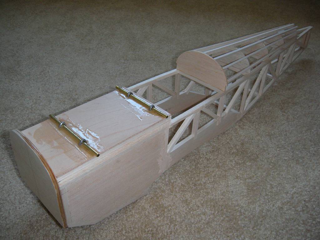

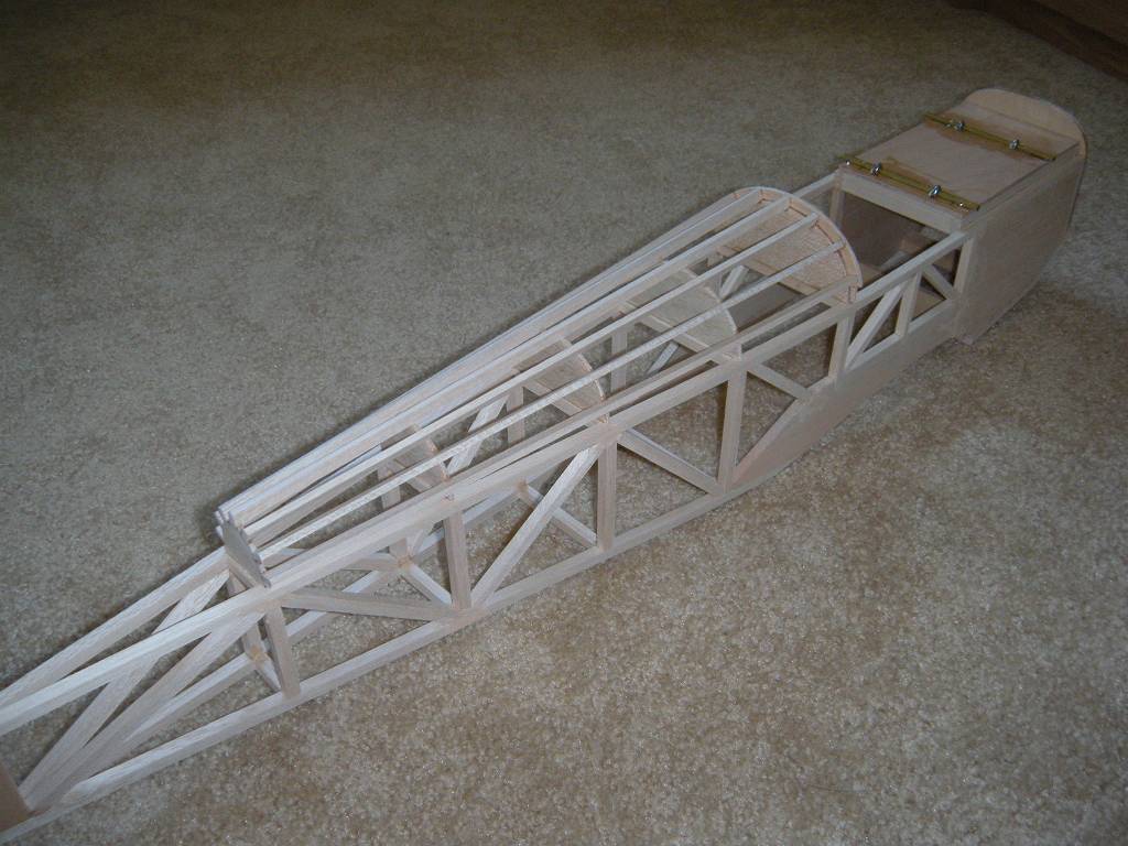

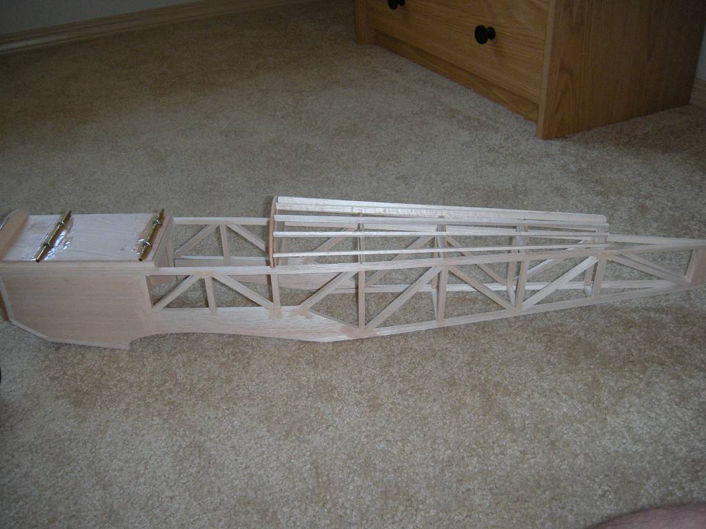

<span style="font-family: Comic Sans MS">and todays work, so far. the upper bulkheads, stringers and the ply top on the front with the with the cabane strut supports. got a little funky with the epoxy...</span>

Crash, looking great. It's going to be a head turner with the transparent covering. The only prob with the fuel usually is the nitro evaporates out, but I often fly without nitro and still get great results. As long as you are getting sufficient RPM I wouldn't worry about it. I've used 4 year old fuel in an old beater plane with no ill affects, and it was stored in an uninsulated garage through Iowa summers and winters.

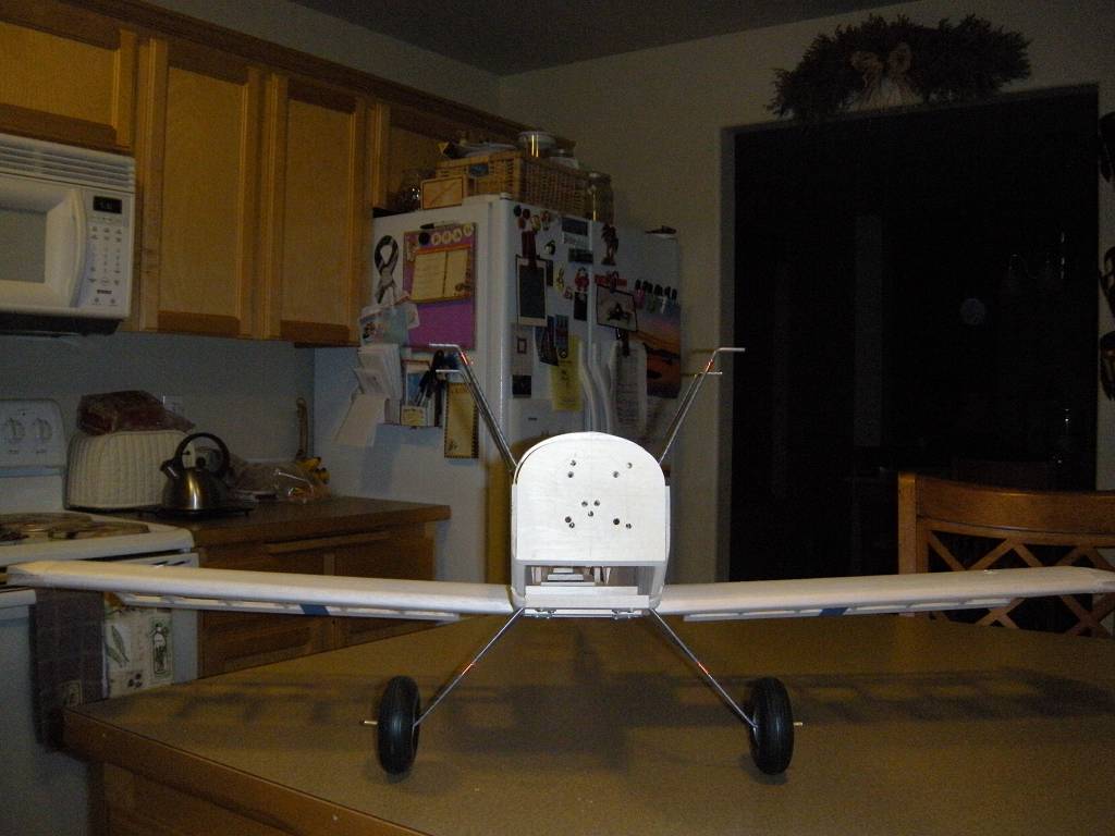

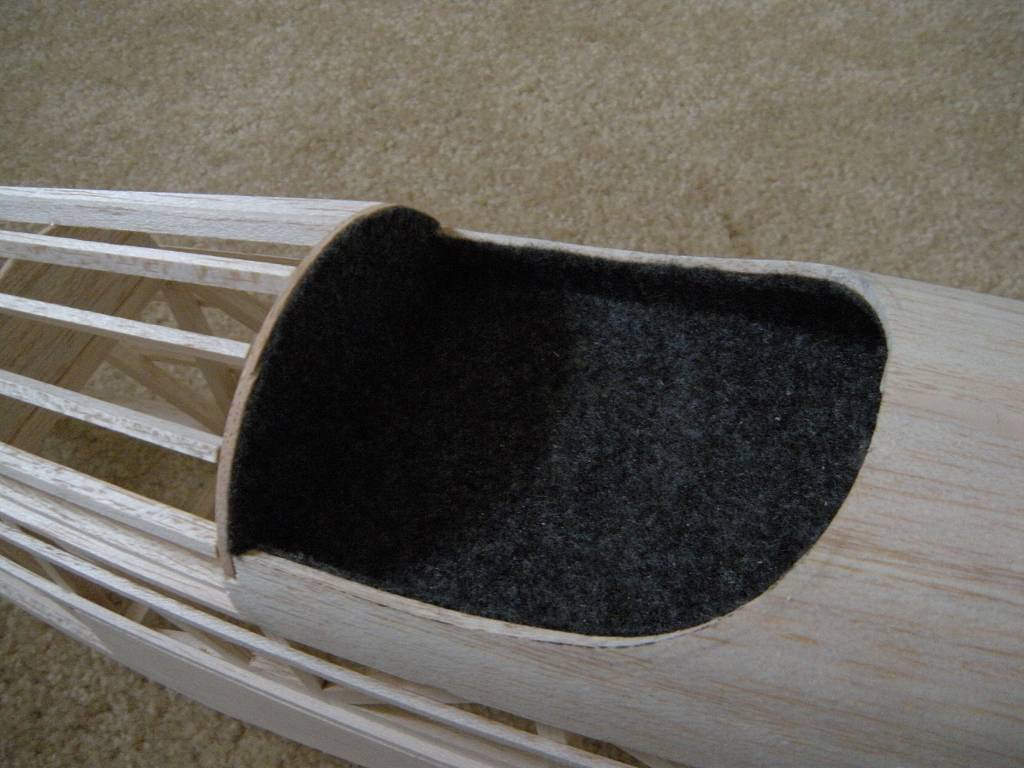

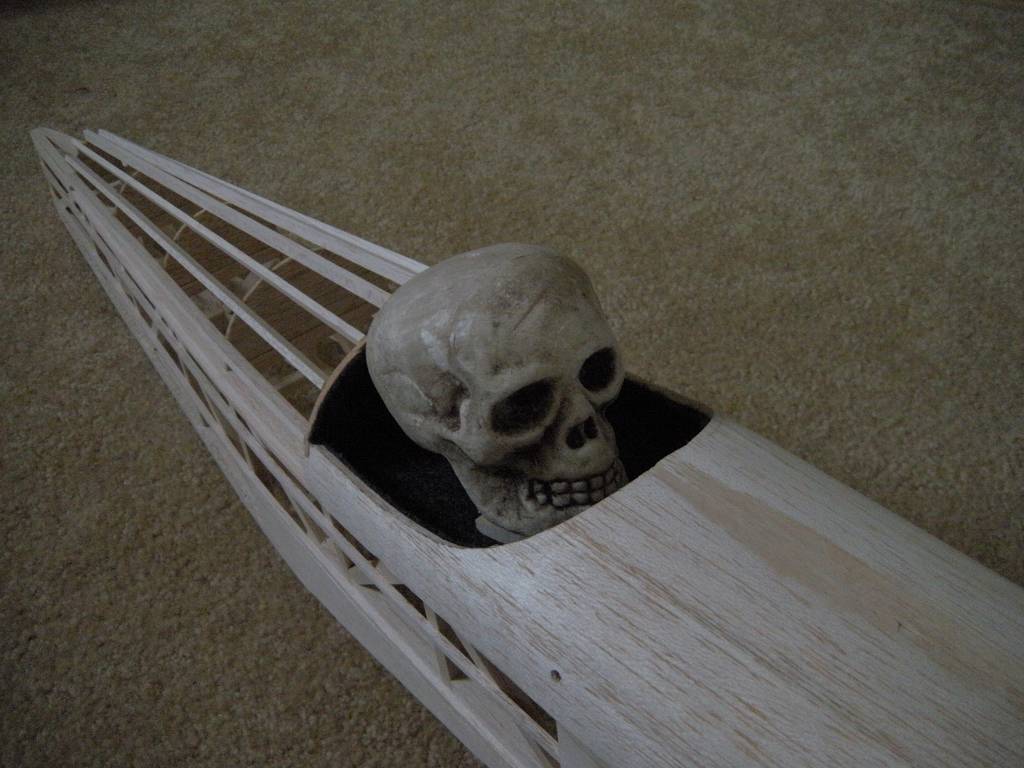

<span style="font-family: Comic Sans MS">the tail feathers are done. here's the pics. this is my new pilot i recruited from Michael's store. pretty cool. i put the carpeting in the cockpit too. yesterday i ordered the covering, some fuel line and a tail wheel assy and some 1/4 scale guages from towerhobbies. i also found a new hobby shop, but it's about a 45 minute drive to get to. probably a good thing, so as to not spend too much money. wore work to come soon. i'm having problems fitting the cowl on the front end, but will get started on the wings after while. </span>

I never would have thought of using felt. It looks great!

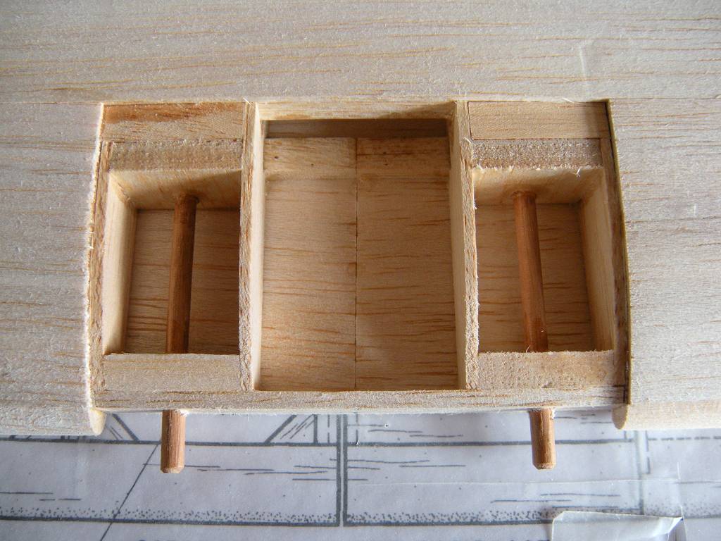

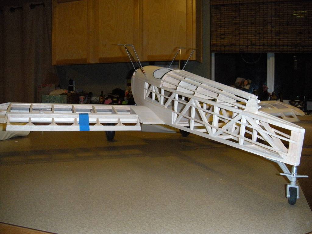

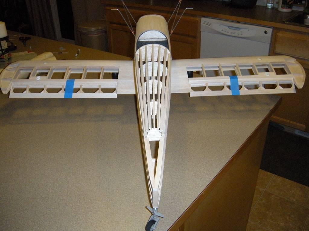

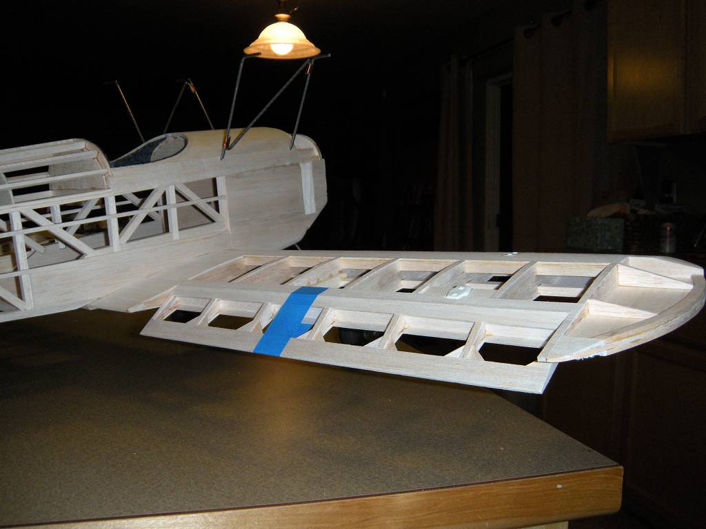

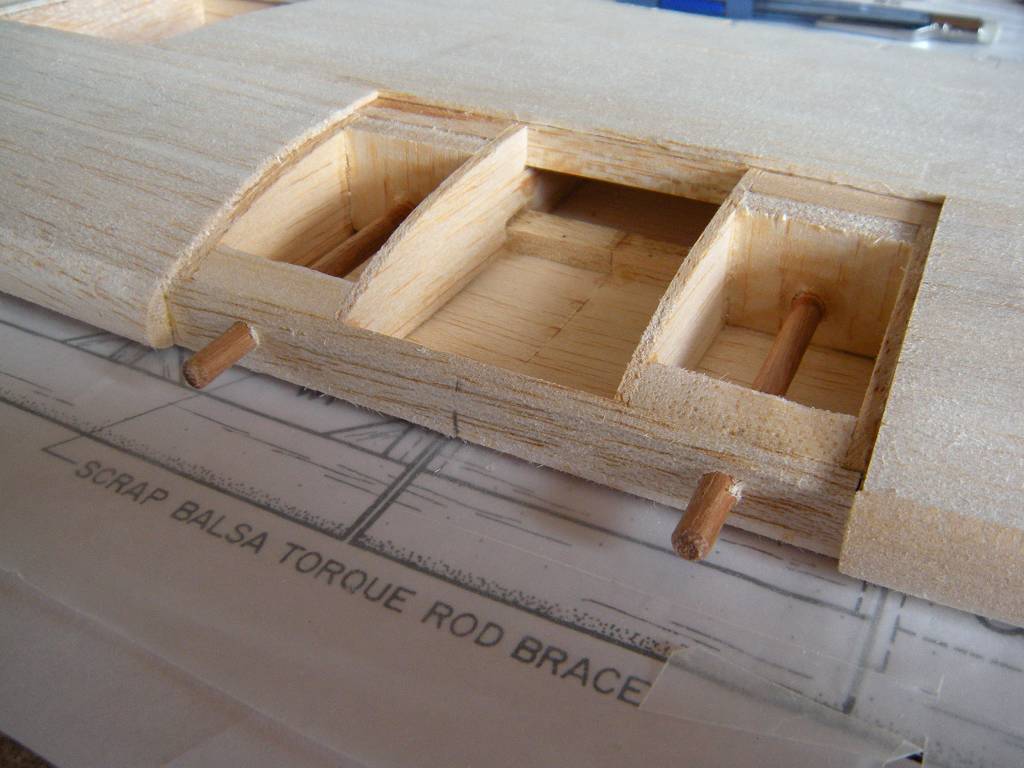

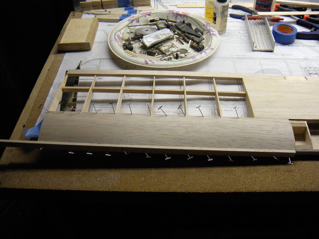

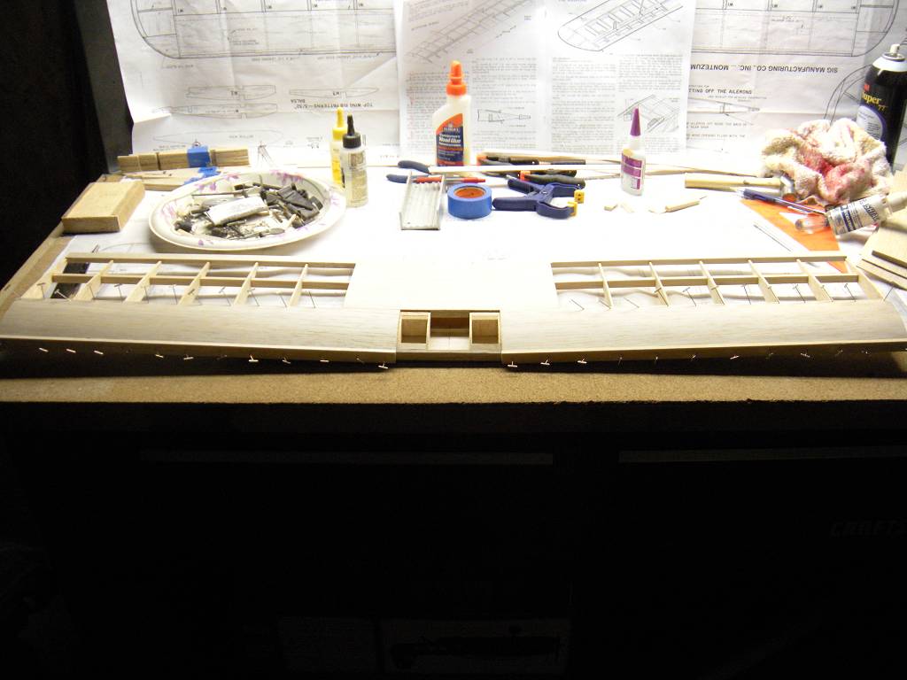

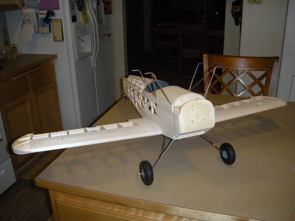

<span style="font-family: Comic Sans MS">a little progress on the bottomwing. i got all the ribs glued down, the T.E. glued down, and the sections cut for setting the dihedral for the wing panels, seperate from the center section. some of the other parts, the dib gussets, i think will have to be done after the wing is removed and i can work from the bottom. the instructions for some of it are kind of confusing on how to do it with the wing still on the board. being able to handle the wing will make things a little more simple, i think. here's the pics.</span>

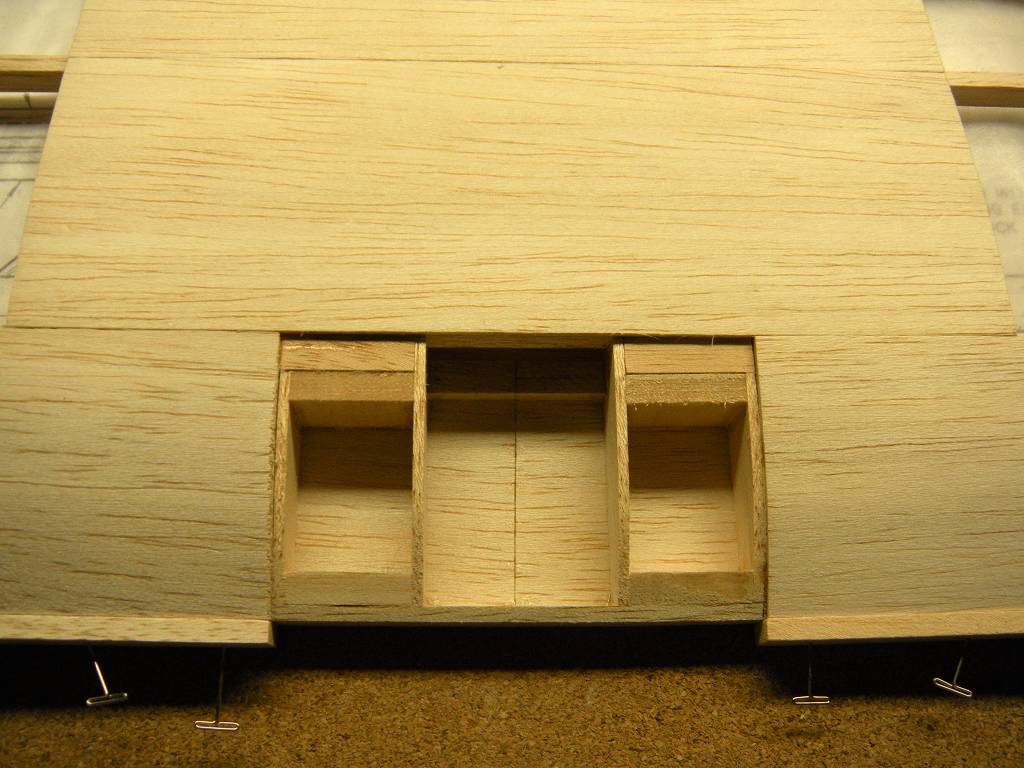

Be sure to add the optional shear webbing.
Brian
Old 09-06-2010 | 06:49 PM
  #88
Joined: Aug 2009
Posts: 643
From: McChord AFB / Orting, WA
Default RE: the Invisible Mini
<span style="font-family: Comic Sans MS">dang Brian, you read my mind. i was just going to post and ask if i should. the instructions and plans don't mention anything about it, but i have on all of my other planes. next question... should i on both sides, forward and aft, of the spar? grain going up and down, yes?</span>
Old 09-06-2010 | 10:38 PM
  #89
cfircav8r's Avatar
Joined: Jul 2004
Posts: 1,244
From: Hampton, IA
Allways vertical grain and I usually put it in between the spars right down the middle, however front, back or both will work (I have heard that when a twin spar system fails the top spar breaks upward, but most full sized A/C use it in between). The most important thing to remember is it has to be fully glued and fit snug side to side, and if in between, it has to fit snug top to bottom as well. Anywhere that is does not have a tight fit or is not glued well will create a shear point. It can be a bit tedious fitting them but will add a tremendous amount of strength,and is well worth it.
Old 09-07-2010 | 12:53 AM
  #90
EscapeFlyer's Avatar
Joined: Aug 2003
Posts: 2,396
From: Brooklyn Center, MN
The most important thing to remember is it has to...fit snug side to side
I won't say this is wrong. However... Many a kit emphasize this is not necessary at all. Personally, I have always found myself doing just as cfircav8r suggests here.
On my first miniplane I used 3/32 inch ply. The other two mini's used 1/16" balsa. The grain is vertical. One side (either side of the spar) is sufficient. My shear webbing was glued on the aft of the spar.
Another option in place of the shear webbing is the truss system with 1/4" balsa sticks. It is 6 one way, a half dozen the other. Whatever floats your boat.
Lookin' good!
Brian
Old 09-07-2010 | 09:36 AM
  #91
Joined: Aug 2009
Posts: 643
<span style="font-family: Comic Sans MS">so, criss-cross BETWEEN the spars? (not an "X", but a diagonal)?cuz i only have about a half or 3/8inch between the top and bottom spar. i think i may do the shear webs.</span>

Crash,
Shear webbing is perfect.
Here is a pic of what I was talking about regarding the truss method:

<span style="font-family: Comic Sans MS">somehow i thought you were talking about that way. another question... how much trimming was necessary to get the cowl to fit on your plane? i had to do quite a bit for it to go on far enough to not see the ply inserts on the side of the nose. i'm not sure if it needs to go on that far, but even the circumference of the nose area was alot bigger than the inside of the cowl. i put the ply inserts on at the same place as shown on the plans, but i couldn't even get the top of the cowl over the fuselage to begin with. that's why i have the turtle deck at the very forward still removed. did i do something wrong with it? everything was built over the plans.</span>
Old 09-07-2010 | 12:24 PM
  #94
Joined: Aug 2003
Posts: 2,396
You've built it right. Lots and lots of sanding and shaping. Particularily on the bottom and sides.

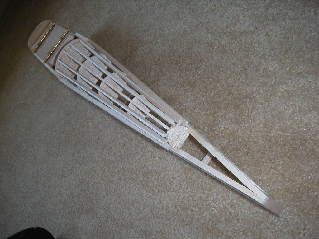

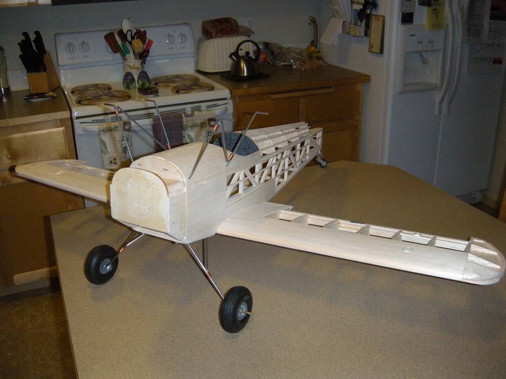

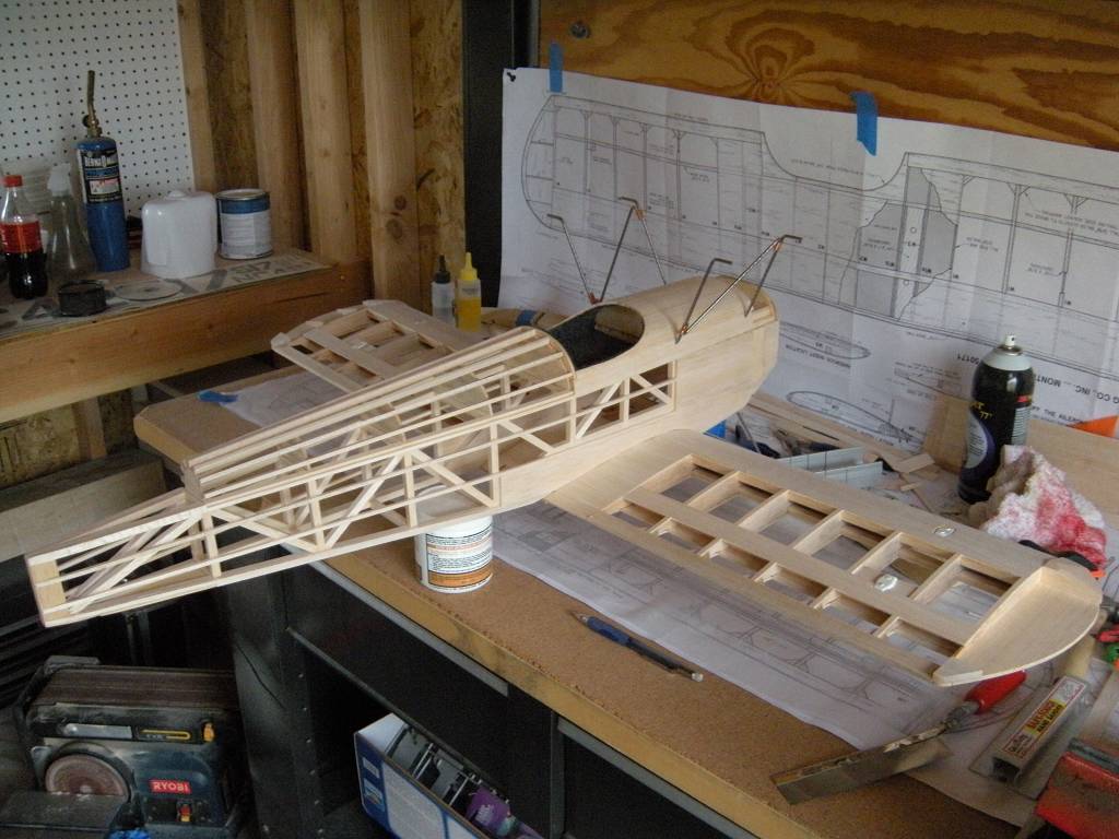

<span style="font-size: small"><span style="font-family: Comic Sans MS">i got much of the bottom wing done yesterday. i didn't realize how much time it actually takes to get everything perfect. i still need to do the cap strips and the aileron work and cover the center section of the bottom aft edge. i went a little different because of the servos going on the wing panels instead of the center wing.the leading edges are all good. the blocks for the N-struts will still need to be cut out and installed. there's a lot more to this wing than i thought there was, just looking at it. i've decided to see if i can't fit the standard servos in the wing. i think when i was looking at them before i was just looking at the thickness of the wing rib; not with the cap strips installed. if i need to, i will just cut the corner down a tad bit on the mount part of the servo to keep it from jutting out under the skin. speaking of skin, i got the clear and transparent red from towerhobbies the other day and am getting anxious to cover. funny though, last i remember, I HATE COVERING!!! but i'll post pics this afternoon of the wing done up as much as i've got it. maybe get a little more work done on it also; kitchen pass has been submitted. </span></span>

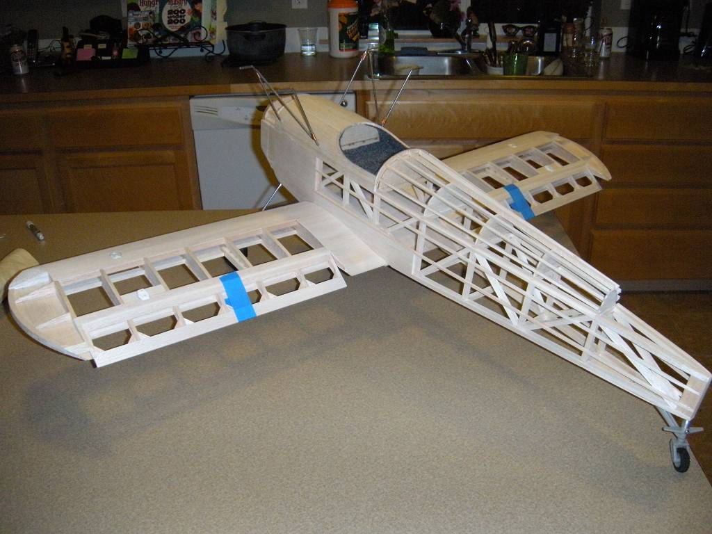

<span style="font-family: Comic Sans MS">here are the pics of the wing from the work i got done the other day, and a couple of others, from the nose of the fuse. the pic of the center wing, i was planning on installing two dowels instead of just the one, at the L.E.. i didn't get to work on it yesterday, as i hoped to, but i still need the shear webbing on the T.E. of the main spar. lastly, my instrument panel as layed out, and then what i was wanting, but couldn't find labels for.</span>
