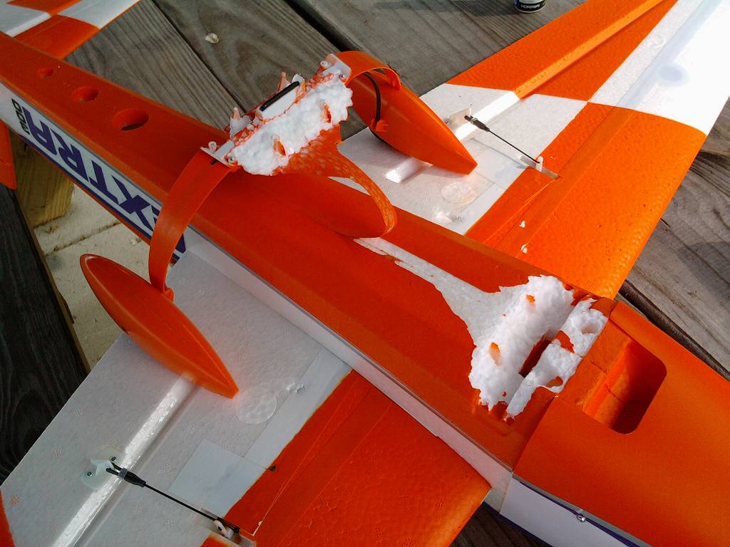

#56
Posts: 550
From: nowhere
I just lost the gear on mine on touchdown...
Came in, set her down and the gear folded back, heres some pics, it appears the mount wasn't fully glued into the fuse.
What did you all do to balance your extras? Leave them stock? Mines a little to tail heavy I think.
Also mine wants to snap / roll to the right whenever giving up elevator. a little up and it rolls kinda corkscrewing instead of looping.
a lot of up and it will snap to the right, anyone else have this problem or know what I should do / change?

#64
mine tracks great, unless you yank on the elev. stick too hard........+1 on the expo for ailerons..... this helps on landings, small corrections, etc. make sure there is'nt too much elev. throw and the tail is reasonably straight. measure your elev. compared to wingtips..... there has to be a reason if it snaps bad, and won't loop straight at all....
My gear mound came out on a bad landing. Not much glue..... 5 min. epoxy and it's been great for about 6-7 more landings........ 2 of them pancaked into grass.... one at a park and once I didn't carry throttle/speed and fly it down, and it stalled just before it made it to the diamond.......... So far it's looking good so far............. and when flown in nice it doesn't mind even some rough grass......

#74
Posts: 550
From: nowhere
Another guy at the field lost his landing gear on his..
as preventative measure I'd try to wick some foam safe ca into / around the gear mounting plate, then lay a piece of reinforced packing tape over the gear..
I repaired mine with slow cure foam safe ca thick and packing tape and its holding great.
My bird is very pitch sensitive though, haven't really messed with the cg but I am gonna tweak that this week.
#75
Joined: Apr 2004
Posts: 20
From: Millburn,
NJ
Try sliding the battery forward to adjust the CG. It's a tight fit but you can push it pretty far forward. Make sure the ESC is in the upper cut-out area, not the battery area, to make room for the battery. My ESC came popped out and was floating around the battery compartment.
