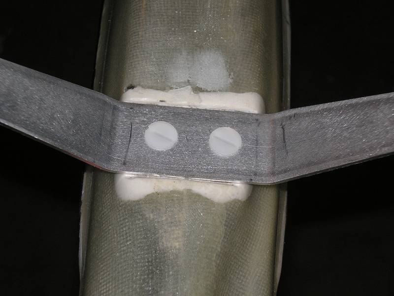

It is getting late so I chose to glue some parts in place and go to bed.
The landing gear block can be glued in with epoxy or Shoe Goo. The later is actually more durable and that is what I used.
The area behind the wing is very easy to get to with this model. Some Velcro was glued behind the wing should I choose to install the battery there.

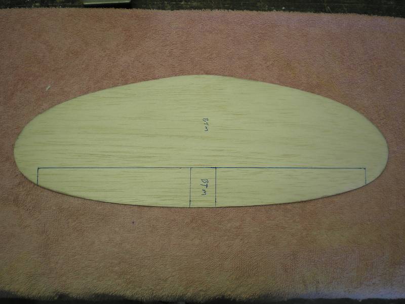

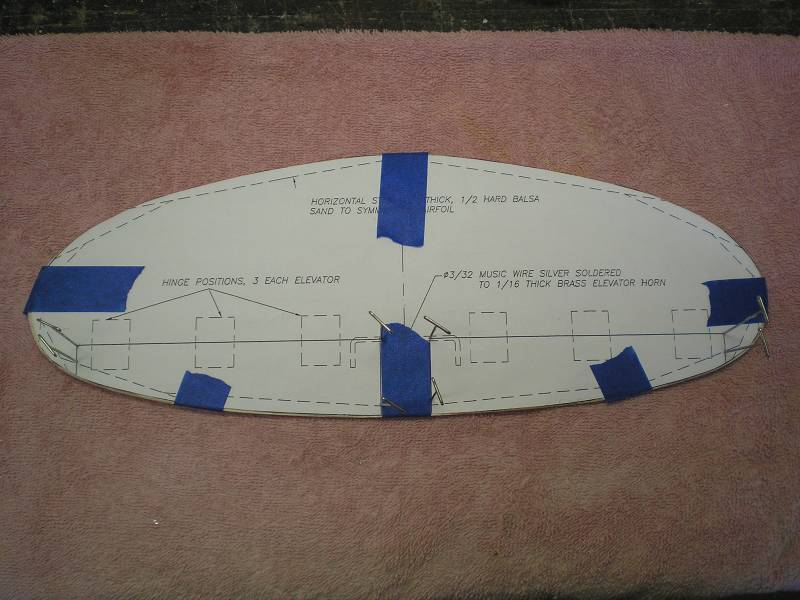

The kit contains a pre-slotted horizontal tail surface.
Some 1/64" thick plywood was traced and installed at the leading and trailing edge.
Thin CA glue was used to hold it in place.
Edges were sanded flush with medium sandpaper.

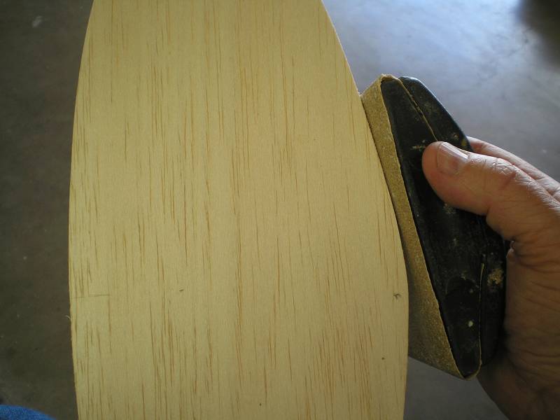

#96
Joined: Nov 2007
Posts: 2,060
From: Fritch,
TX

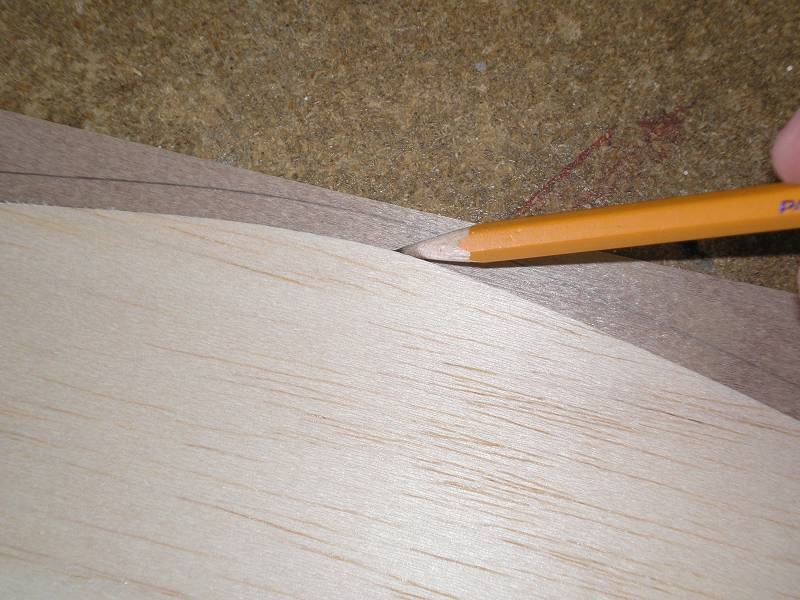

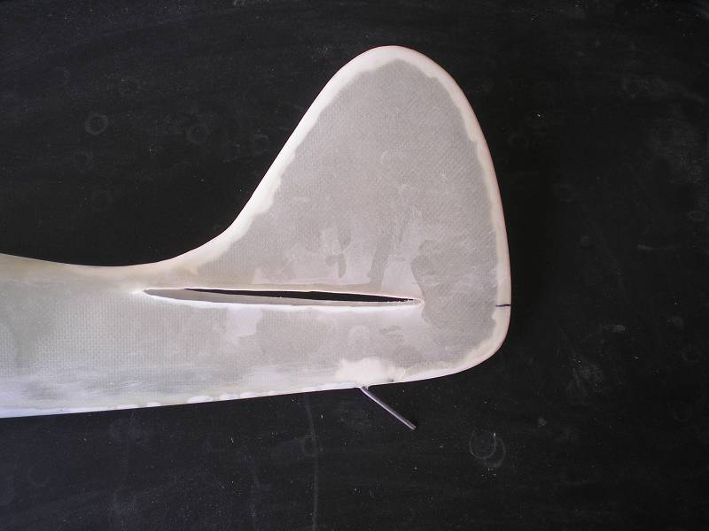

Rough shape the tail surfaces with a sharp knife.
Next use some 60 grit sandpaper to continue to shape.
Test the fit in the slot at the tail.

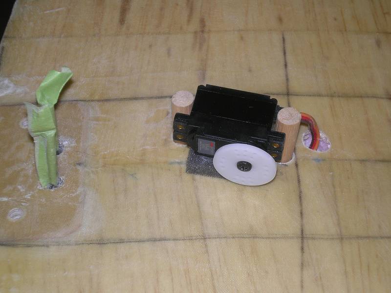

The aileron servo will be mounted similar to that of my AJ-2. It will be on the top of the wing.
Drill 3/8" diameter holes for dowel rods pieces.
The servo will be mounted to the dowel using servo screws.

Here is what the model looks like with the wing and tail installed.
Next will be the tail hinges, fiberglassing the tail, and painting.
I can hear the engine roaring already.

Temporarily attach the plans over the tail surface. Use some pins to mark the hinge line and cut lines.
Remove the plans and mark the hinge line on top and bottom of the wing.
