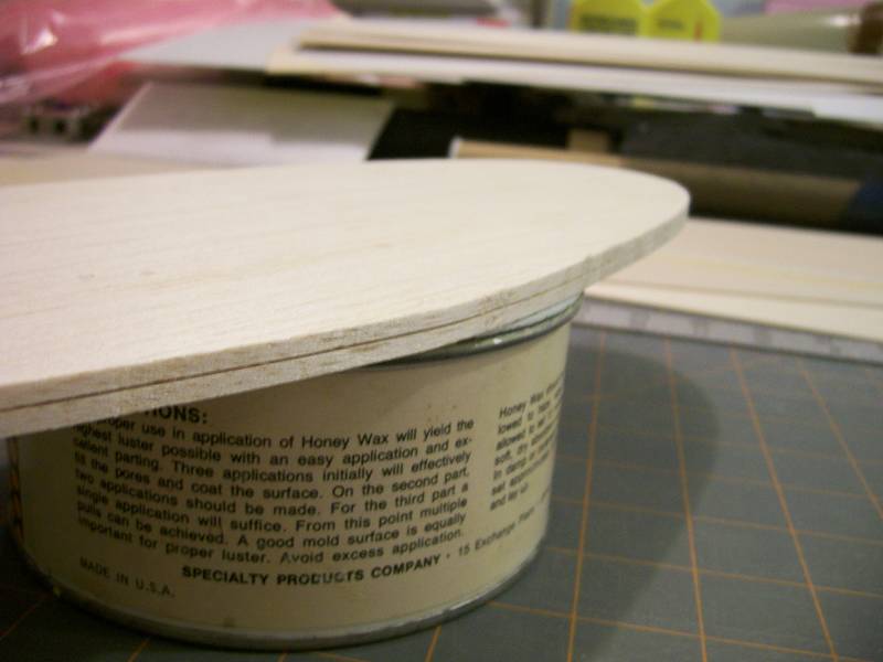

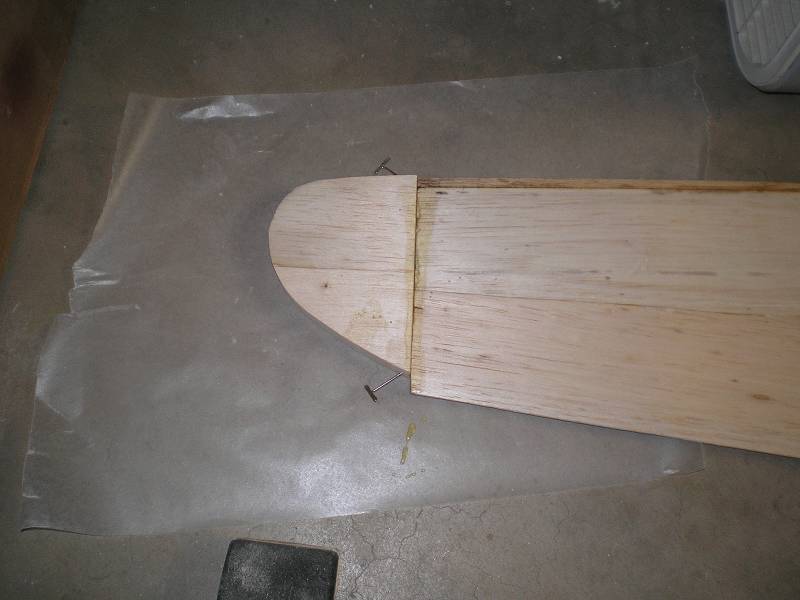

Cut out the wing tips using a saw.
True the tips so that they fit to the cores.
Mix up some epoxy and glue on the wing tips.
The wing is laying upside down and some weight is applied to the tips.
This allows them to glue on relatively level with the top of the wing.

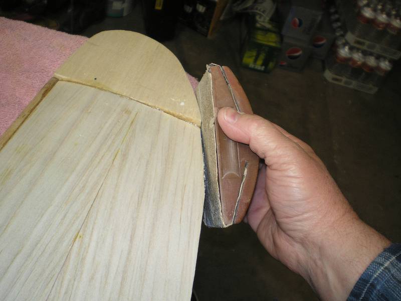

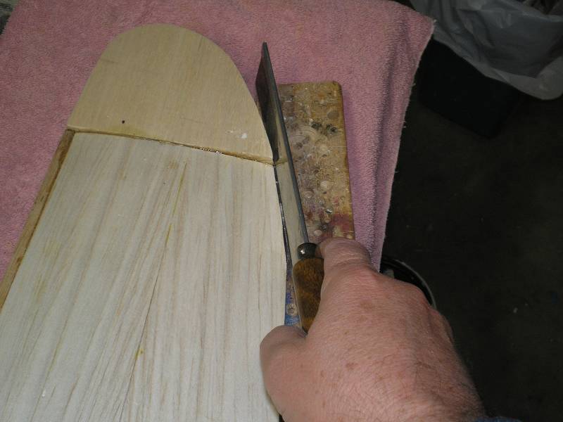

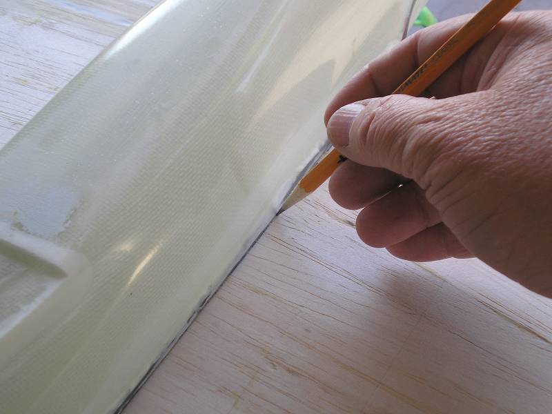

Use a French Curve to blend the wing tips into the wing.
Trim with a razor saw and sand as needed with a sanding block.

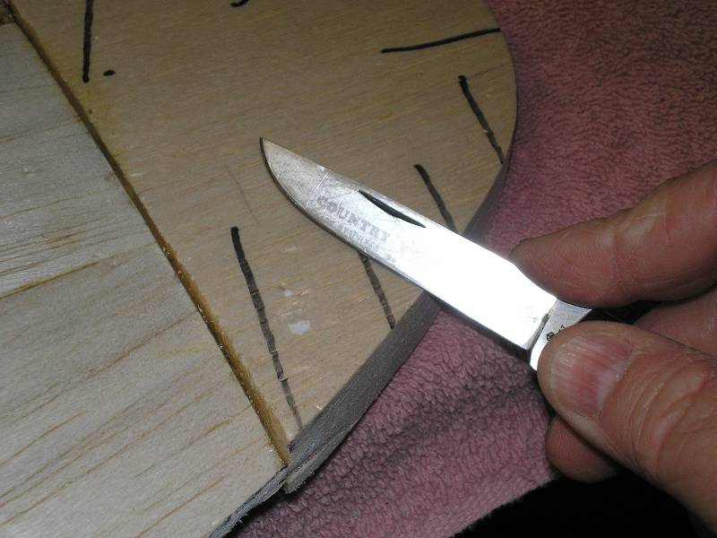

Rough out the tips with a sharp knife.
Check out the fit using a ruler. It should be relatively level with the top of the wing.

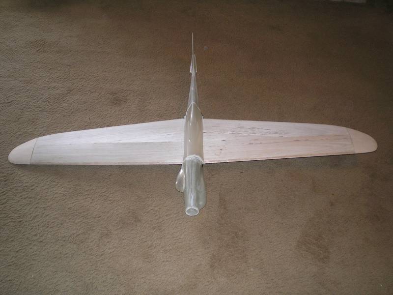

The stinger wing weighed in at about 9.5 ounces complete with shaped wing tips and leading edge.
This is in the same range as a lightweight Q-500 wing.

The following show some of the progress of the model.

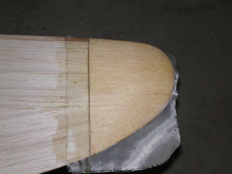

The balsa wing tips are fragile unless reinforced.
Some 2" ounce fiberglass and Skin-It was applied on the tips.

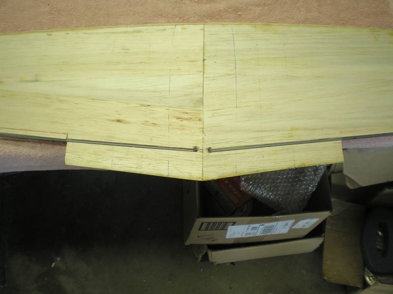

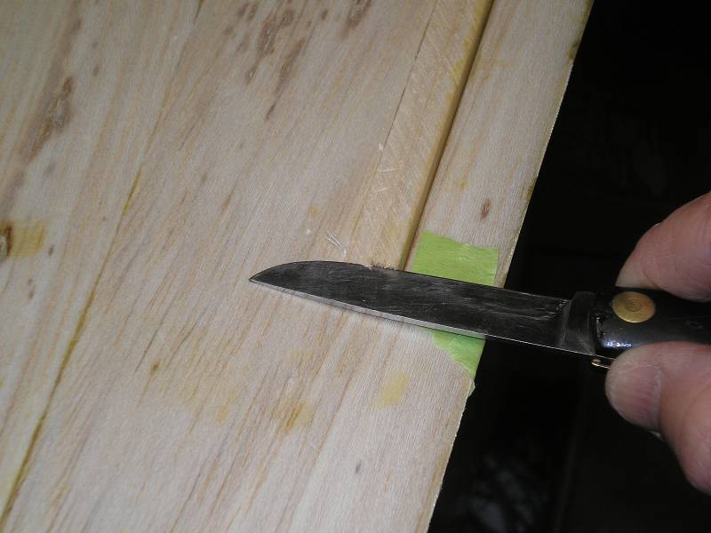

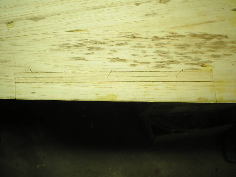

The ailerons are made by marking the approximate size on the sheeting. The ailerons were made approximately 10" long . They were 1 3/8" at the widest end and 1 1/8" at the narrow end.
A red line is marked about 1/4" in front and behind the blue line. This is for the 1/4" thick balsa stick.
Cut out the ailerons allowing for the balsa sticks.
Cut the sticks to fit and glue them to the aileron and the wing. Don't glue the two sticks together.
Pin and tape the surfaces in place as needed. Allow to dry.

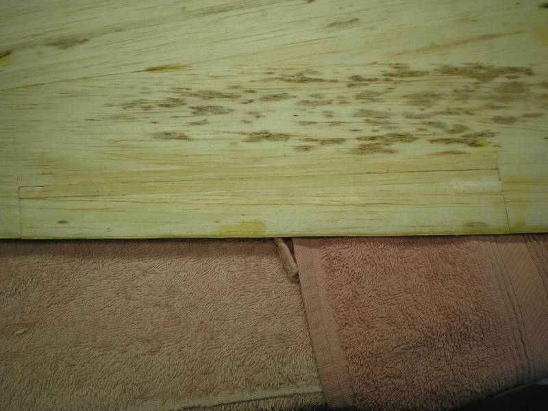

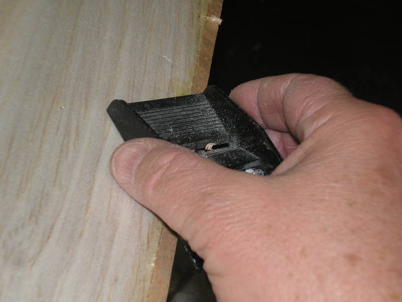

Use a sharp knife to rough the edges to shape.
Follow with a razor plane and then a sanding block.

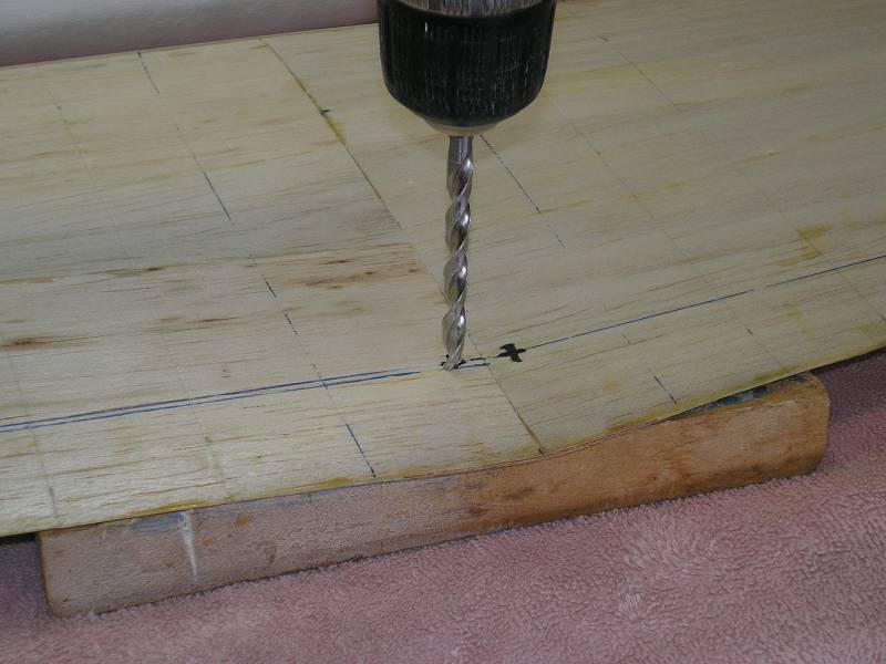

Dubro Heavy Duty Strip Aileron Horns (558) are used on the model.
Drill 1/4" diameter holes through to the top of the wing for the installation of the aileron horns.
Cut slots for the rod and test the fit.

Sand the surface flush with the balsa skin.
ID:	1193521   Click image for larger version

Trace the outline of the fuselage on the bottom of the wing. Mark the location of the front and rear 1/4" thick plywood wing hold down blocks on the fuselage. Glue the blocks in place using Shoe Goo or epoxy.
ID:	1193523   Click image for larger version
