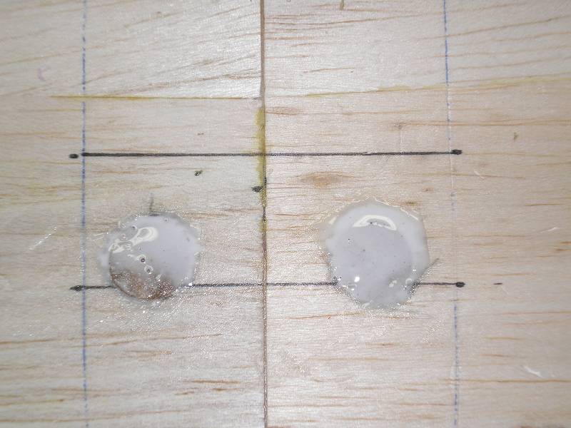

Cut pieces of 3/4" dowel and glue them in place using a mix of epoxy and micro-balloons.

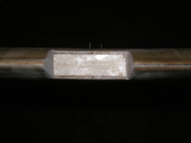

A piece of 1/8" thick plywood was glued between the sheeting to reinforce the joint.
The sides were sheeted with pieces of balsa.
Both the 4 ounce bladder tank or the 6 ounce clunk tank are acceptable for this model when powered by Thunder Tiger Pro 40.

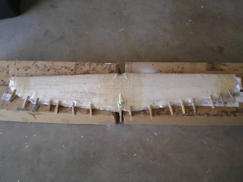

Ichose to fiberglass the wing with 3/4 ounce cloth and Skin It epoxy.
A piece of glass cloth was wrapped around the wing surface and laundry pins were used hold the cloth in place.
Two containers of Skin It were mixed. Each was about 1 ounce.
Apply the Skin It on the surface and use a squeegee to spread out the glue.
Set it away from everyone and let it dry overnight.

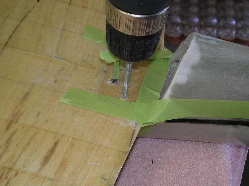

Default RE: Stinger Build Thread

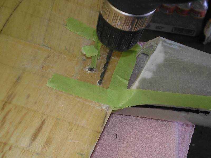

Drill and tap the wing and hold down for the nylon bolts.

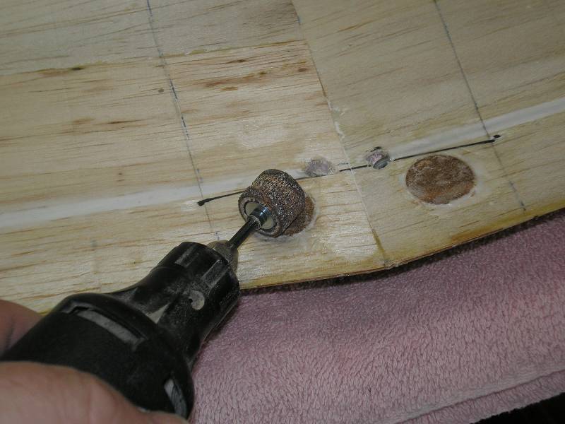

From: Fritch, TX
The wing is counter sunk for the front bolts.
Some minor grinding (with Dremel) is required to get the hatch to fit.

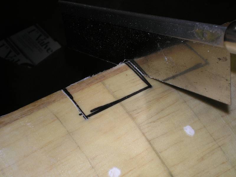

From: Fritch, TX

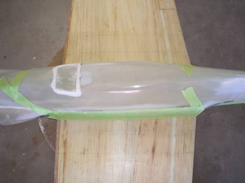

Use a Sharpie to mark the approximate size of the cutout.
I used an earlier model (AJ-2) as a frame of reference for the cutout.

Old 05-18-2009 | 09:30 PM
  #66
Joined: Nov 2007
Posts: 2,060
From: Fritch, TX
Adjust the size of the hole based upon trial and error.

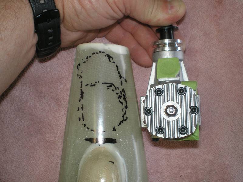

After fitting the compartment should allow the installation of the Thunder Tiger Pro 40 and any other Q-40 engine you want to run.
My model will use the interchangeable Jett mounts. Either motor will fit with just minor changes.

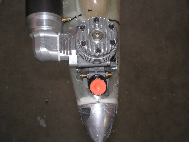

Cut out the firewall and sand the edges to fit as needed.
It should fit relatively loose at this point.
ID:	1201345   Click image for larger version
Old 05-20-2009 | 08:06 PM
  #69
Joined: Nov 2007
Posts: 2,060
From: Fritch, TX

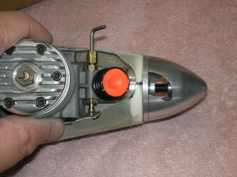

Use a Dremel tool and/or sandpaper to roughen the fiberglass.
Install the motor mount, engine, and firewall.
Tap the firewall forward with a screwdriver.
Tape the spinner in place so that the motor is lined up.
Once aligned CA the motor mount to the firewall.

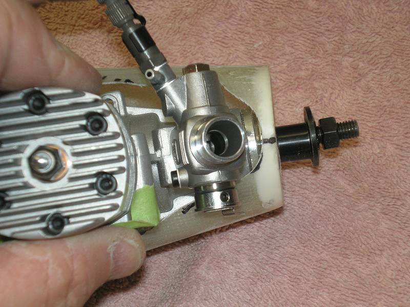

Use a long drill bit to drill the motor mount holes.
Remove motor and associated materials from the fuselage and drill remaining holes.
You can install an engine kill or install a throttle linkage for the Thunder Tiger Pro 40. I prefer an engine kill so that type of installation is being installed for both motors.
Reinstall the motor mount, firewall, and engine kill into the fuselage.
Install the motor, align as needed, and tape the spinner in place.

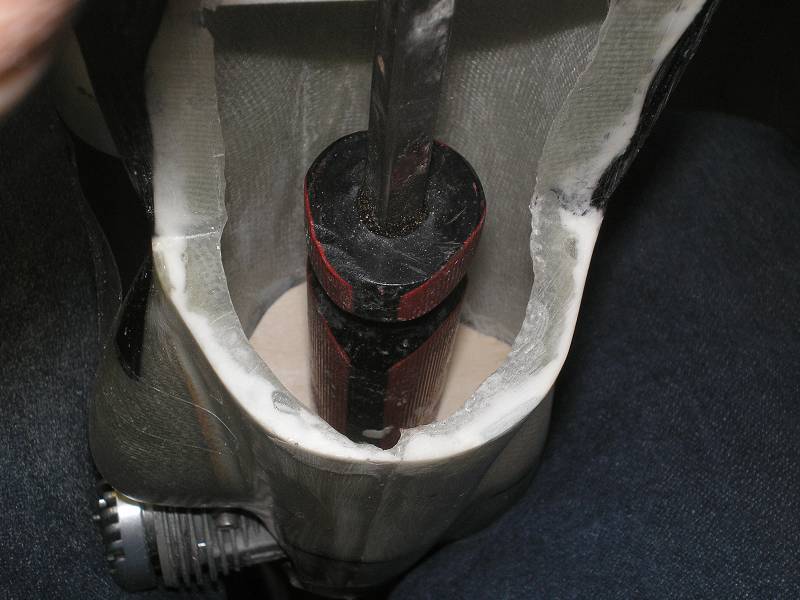

Mix about 0.25 ounce of 30 minute epoxy and apply to the firewall glue joint inside the fuselage.
Add some cut up pieces of fiberglass cloth to the epoxy inside the fuselage.
Let this dry as needed.

My Q-40 motor was removed and the other motor mount and Thunder Tiger Pro 40 (TT) were test fitted.
I ended up adding a 1/32" thickness piece of plywood behind the TT mount to bring the spinner farther forward.
Some epoxy was added on the surface of the firewall, spacer, and back of the motor mount.
The motor mount was then attached using 6 x 32 bolts. Some 6 x 32 bolts were installed on the front beams of the motor mount.
Fiberglass cloth and epoxy were mixed and applied to the front motor mount beams.
Apply fiberglass cloth and epoxy at the seam where the firewall attaches to the fuselage.
