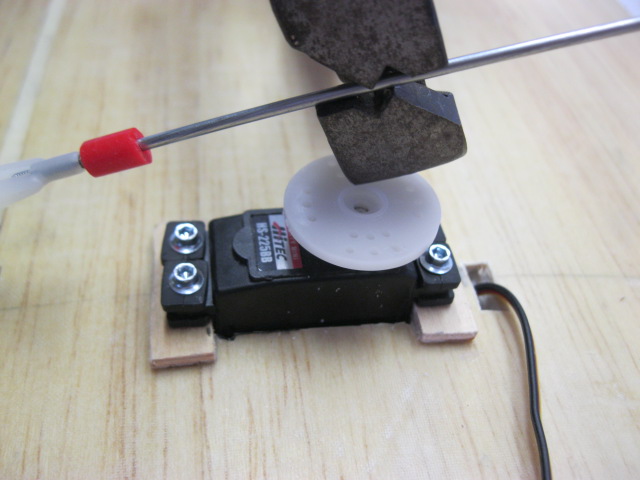

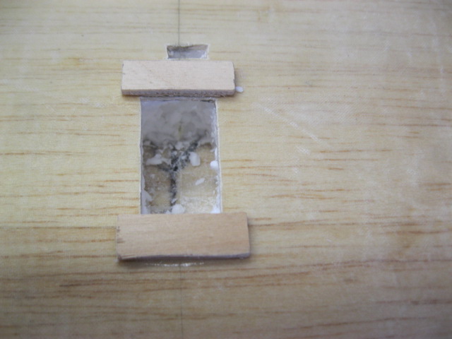

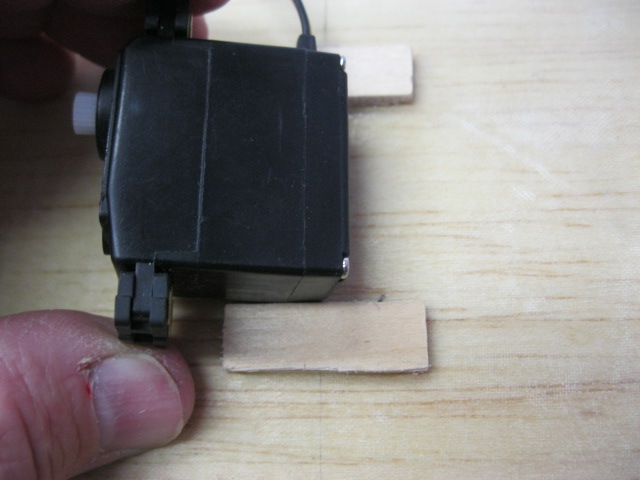

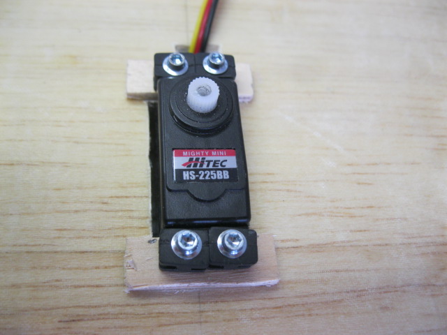

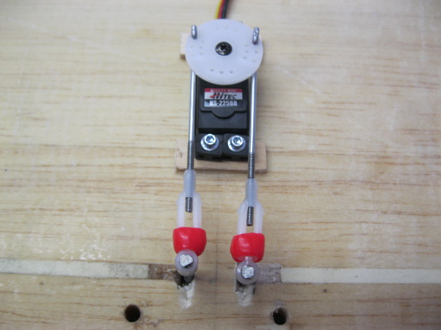

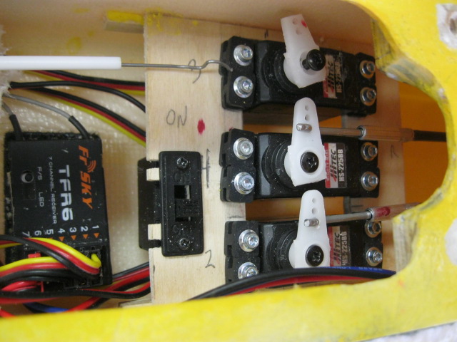

The aileron servo is being mounted and the pushrods are being made in the following photos.

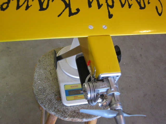

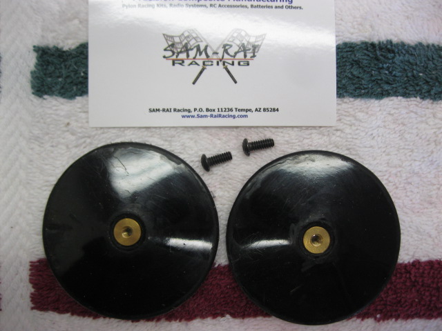

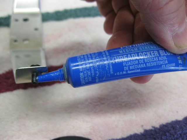

Shape the leading and trailing edge of the aluminum gear with a file.
I purchased the streamlined wheels from SAM-RAI RACING.
http://shop.sam-rairacing.com/Airpla...ssories_c8.htm
The provided button screw goes through the hole in the gear.
Loctite is applied to the screw and the wheel and axle is screwed on.

Question, why the aileron differential? was it tested and needs to be like this? or is it good for all Q500?
Old 09-11-2013 | 09:42 AM
  #55
Joined: Nov 2007
Posts: 2,060
From: Fritch, TX
Originally Posted by apereira
Great build!
The aileron horn connection is actually a little forward of the hinge line. By connecting to the round horn on the servo you actually get close to the same amount of aileron throw in both direction.
I found this out on earlier installations.
On high wing Q500 racers this type of installation can help aileron performance (makes it roll better).

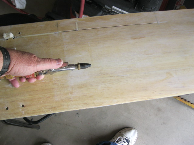

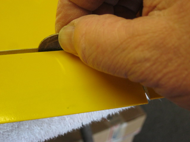

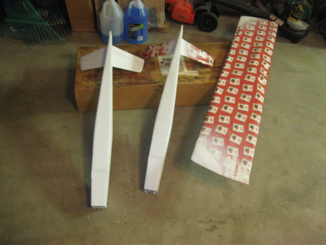

Any pinholes and defects will show up when the model is painted.
The next few steps show how to fill the spots with thinned out lightweight spackle.
I've also been repairing a model for a friend of mine. This model will also be filled at this time.

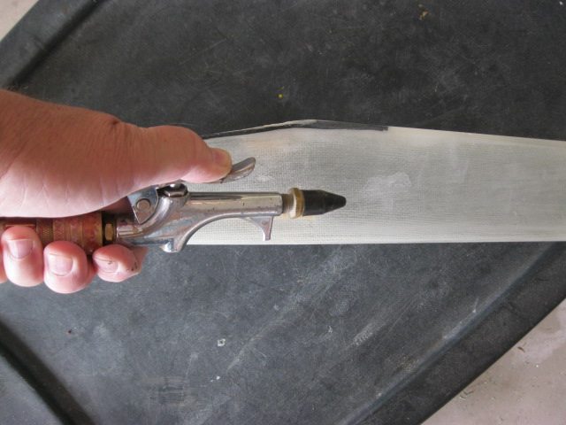

In a couple hours the spackle has dried enough to sand.
Lightly sand with some 220 grit sandpaper.

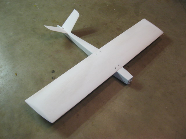

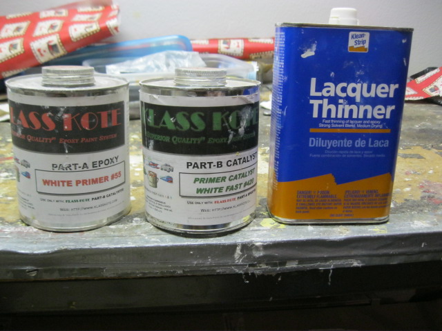

A light coat of Klass Kote white primer was applied in the following pictures.
I used lacquer thinner to reduce the primer. Approximately 1 part thinner was added to 1 part primer.

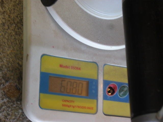

The hard part is to get an attractive paint job without weighing too much.
My painted models are nominally 1 to 2 ounces over the minimum.

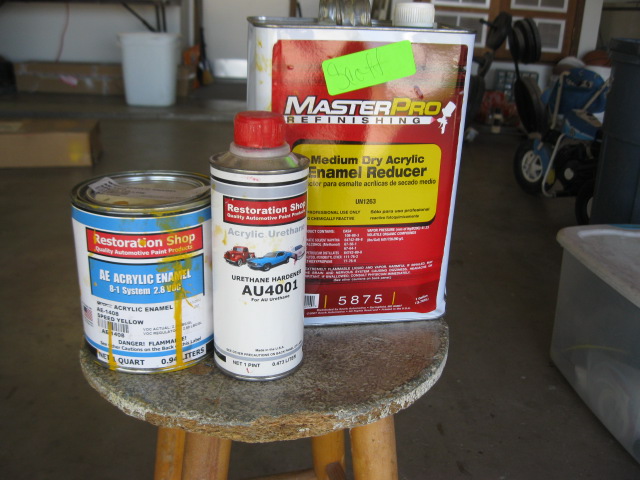

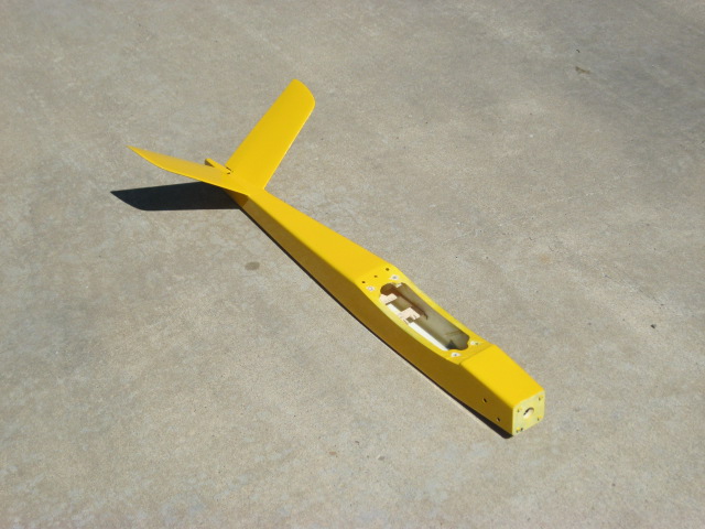

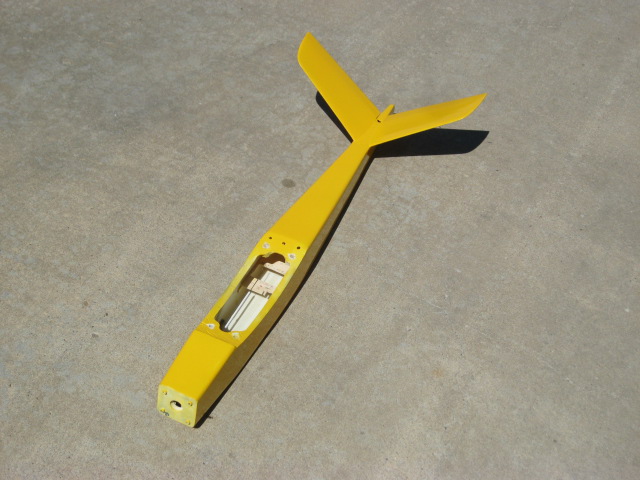

After priming and sanding it is time to spray on the color.
I used acrylic enamel automotive paint. This type uses hardener and is fuel proof without clear coat.

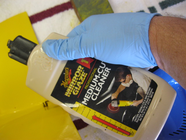

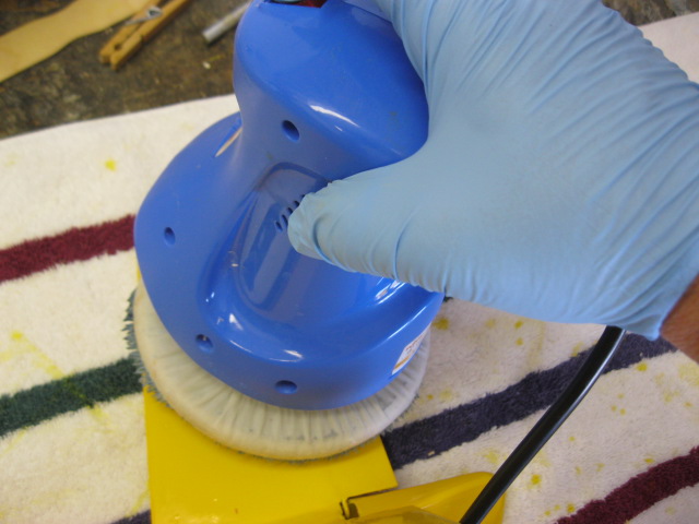

I used Acrylic Enamel (type with hardener) automotive paint.
I am trying something new this time. I did not apply clear coat over the fuselage paint. I had applied too much paint already and was planning to avoid adding more weight by not applying clear coat.
The surface was wet sanded with 2000 grit wet-and-dry sandpaper used wet. This was followed by various polishing compounds and finished with car wax.
The overall surface has a semi gloss finish and is satisfactory for a Q500.

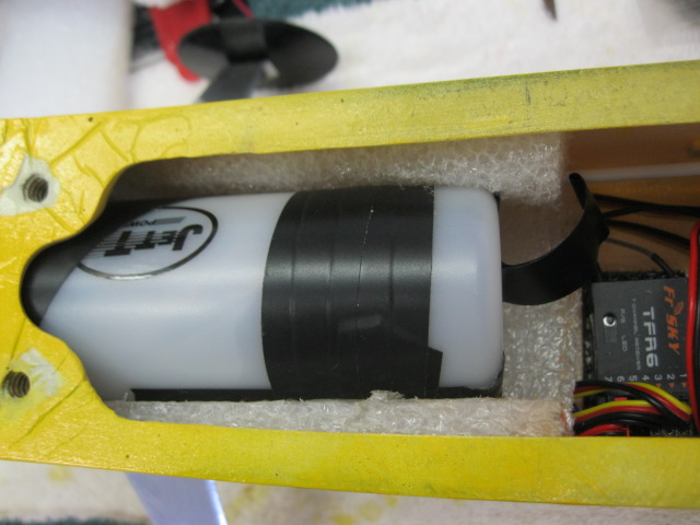

Next is reinstalling the radio and engine. This goes very fast as they have already been setup and installed.

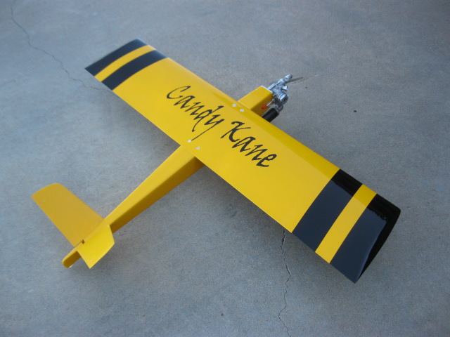

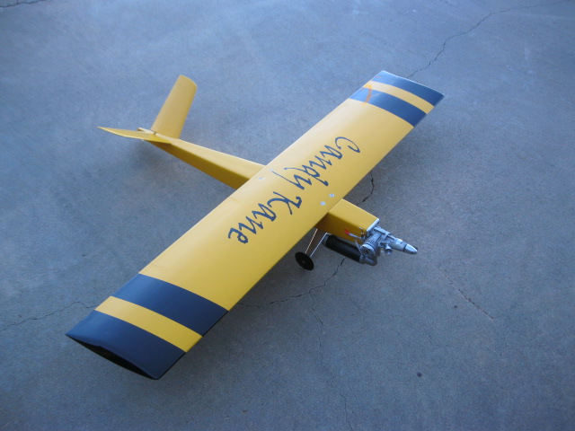

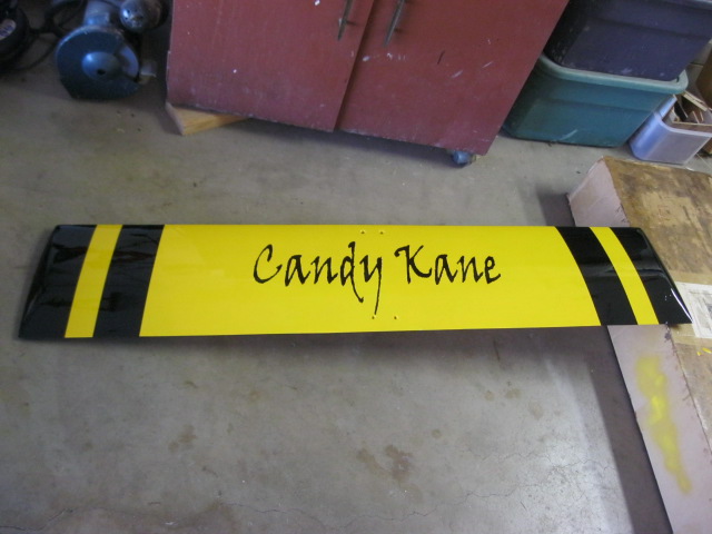

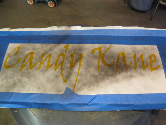

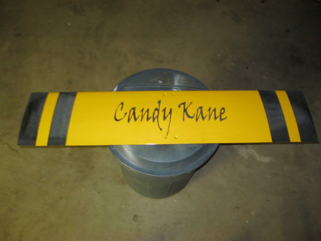

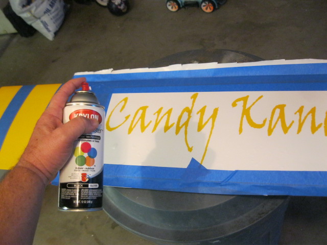

Today I will pick up the stencil for the "Candy Kane" lettering on the wing. I'm hoping to finish the wing this weekend.

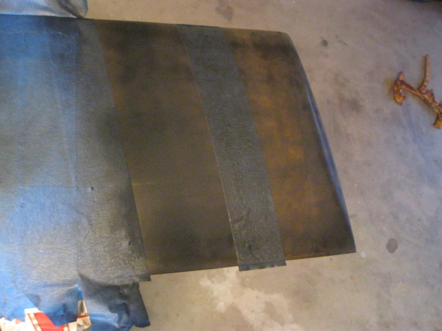

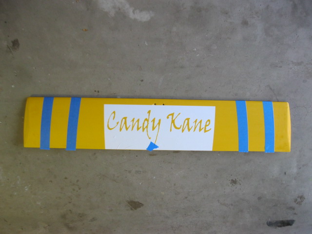

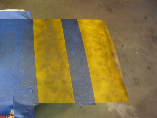

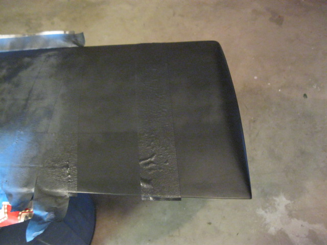

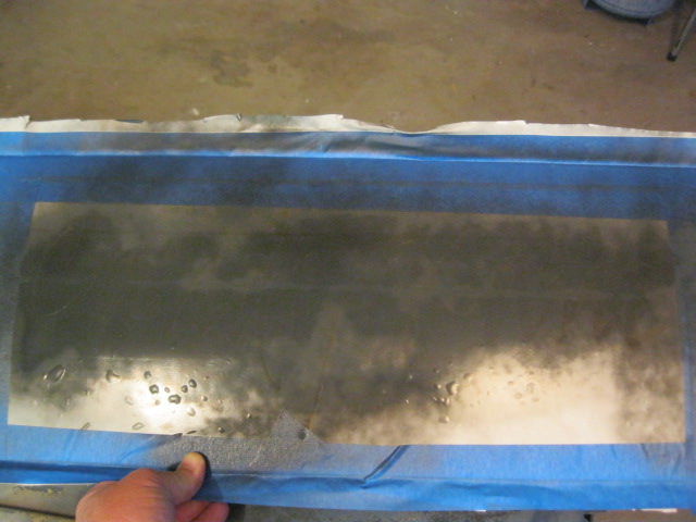

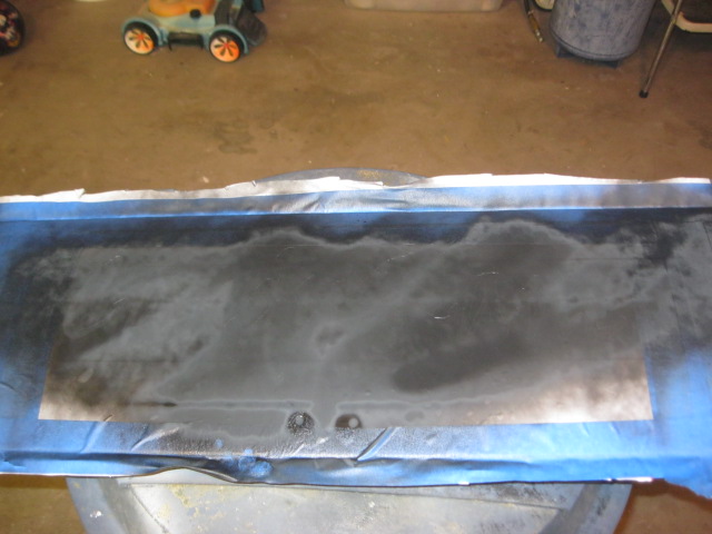

The pictures below show how to mask off the wing prior to adding lettering and stripes.

Gloss Black Krylon spray paint is being applied in the pictures below.
Start with a very light coat and then follow with several others.
The paint is dry in a few minutes.
Remove the masking immediately after the paint dries.

Old 09-28-2013 | 06:06 AM
  #71
Joined: Nov 2007
Posts: 2,060
From: Fritch, TX
Default Candy Kane Build Thread
The wing was finished by applying a light layer of clear coat.
Start by applying a light mist over the surface. Wait a few minutes.
Apply more coats until the surface starts to get shinny.
ID:	1925661   Click image for larger version

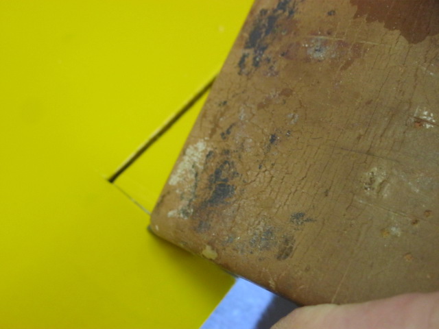

The ailerons were cut free with a razor saw.
Use a cut off disk to remove any mater at the hinge.

Old 09-29-2013 | 07:26 AM
  #73
Joined: Nov 2007
Posts: 2,060
From: Fritch, TX
The finished model weighs about 1 ounce more than the minimum.
ID:	1925843   Click image for larger version
Old 09-29-2013 | 07:29 AM
  #74
Joined: Nov 2007
Posts: 2,060
From: Fritch, TX

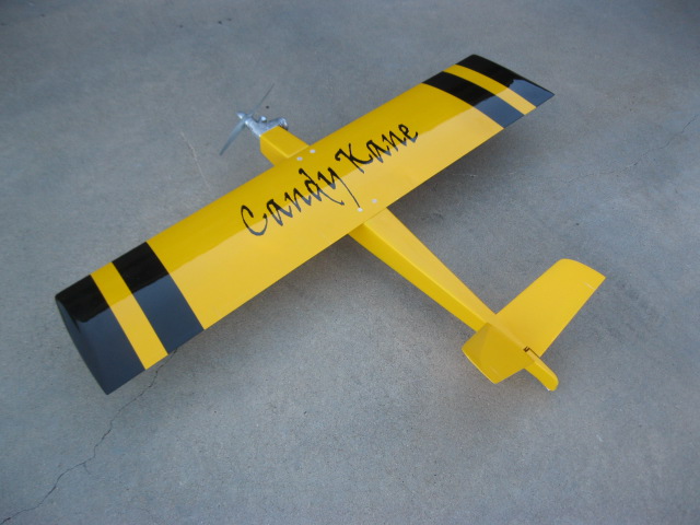

Here's the moment I've been waiting for, completion.
I'm planning to bring this one to the Wichita (Goddard) race in a few days.
ID:	1925845   Click image for larger version
ID:	1925846   Click image for larger version
ID:	1925847   Click image for larger version
ID:	1925848   Click image for larger version
