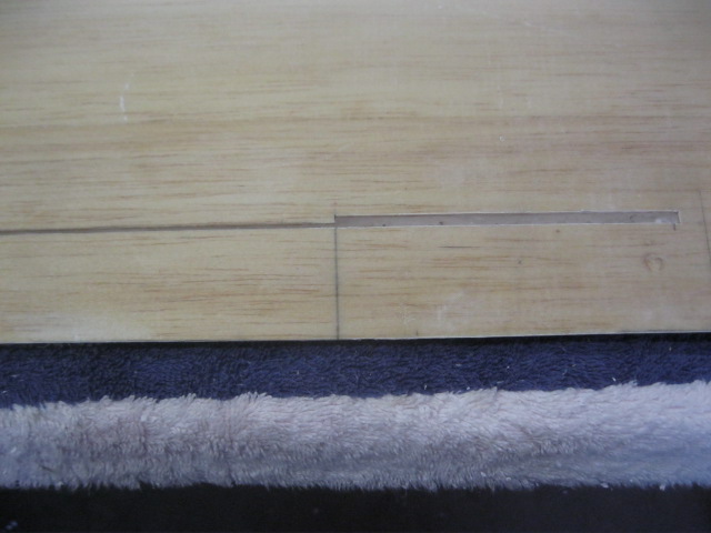

Begin by making or buying wing skins.
Mine are made from 3 pieces of 1/16" x 4" x 48" lightweight balsa sheets for each side.
They have been taped together and each side is now 10.625 inches wide.
I've taped 2 sides together and will use the hinge as the leading edge.

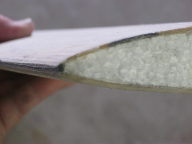

Here are pictures of getting ready for vacuum bagging:
I use a layer of 1.6 ounce glass inside the sheeting to provide strength and a thin trailing edge.
I piece of vertical carbon fiber sheer acts like a spar.
A 3/4" wide piece of 7 thousandths carbon fiber is located on the bottom of the wing between the cores and sheeting.

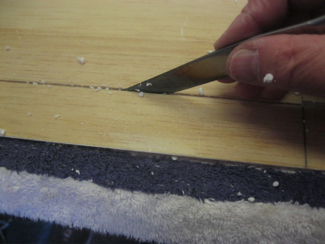

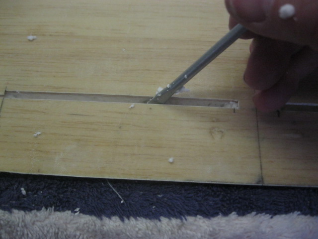

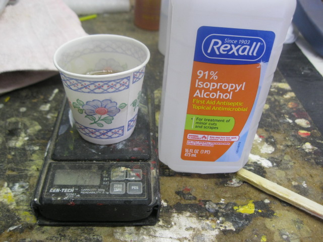

A carbon fiber leading edge is fabricated using several pieces of carbon fiber tow.
Finishing epoxy was applied to the carbon fiber tow and vertical sheer.
Approximately 1 ounce of finishing epoxy was then mixed a side of the wing. This was drizzled on and then spread with a plastic squeegee.
The other side was done the same way.

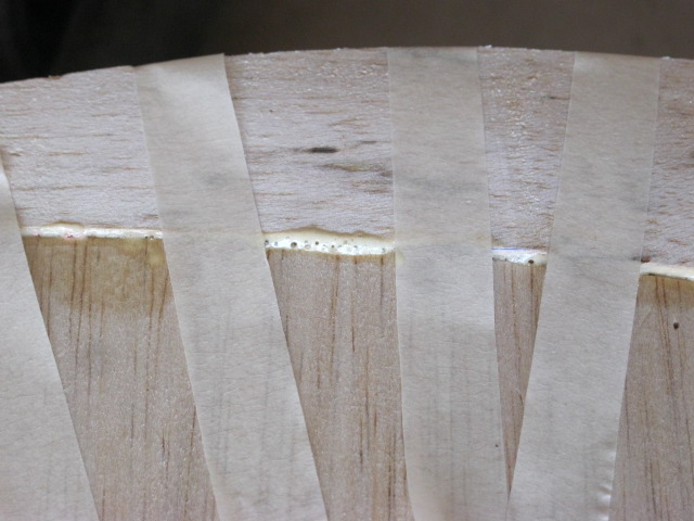

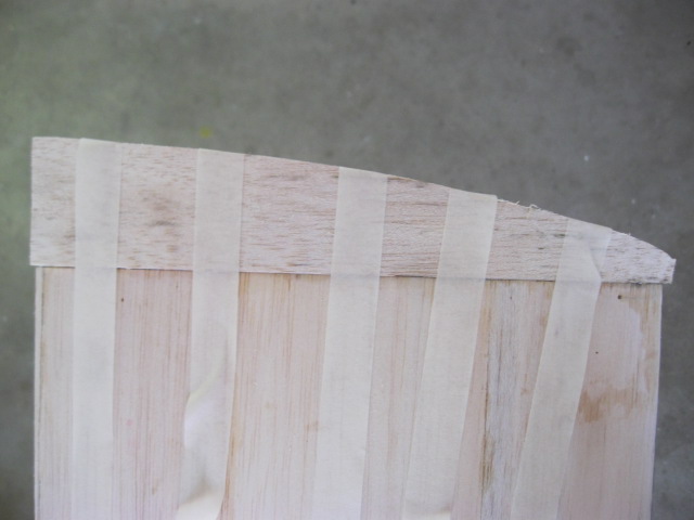

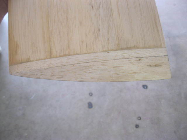

I used the Sam-Rai wingtip as the pattern.
Trace the pattern onto contest grade (very lightweight) balsa.
They were cut out using the jig saw and were glued on using Gorilla glue.
Wet the surface with water prior to applying the glue.
Tape the wing tips in place.
I applied a little too much glue and it foamed outside the joint.
It is easier to remove the extra before it dries

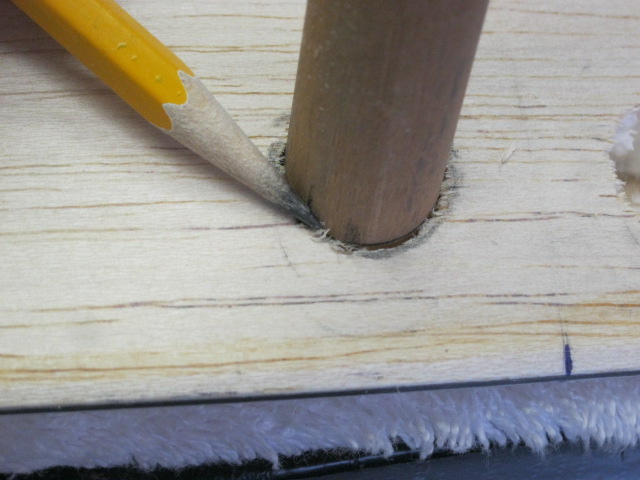

Pieces of dowel rod are glued in the wing in the following pictures:

Approximately 1.5 ounces of finishing epoxy was applied per wing side.
A cap full of 91% alcohol was added in the epoxy to thin it out.
A plastic squeegee was used to spread out the epoxy.

Trim off the outside edge of the vacuum bag to remove the caulking prior to separating the wing from the peel ply.
Make sure the epoxy is fully dry and not tacky before separating the layers of fabric.
I used a sanding block to trim the excess fiberglass cloth from the edges.
The surface of the wing was later lightly sanded with some 220 grit paper on a sanding block.

Earlier, some test holes were drilled to check the location of the wing dowel pieces. The holes are where the plywood pieces are glued.
The rear blocks and landing gear blocks were glued in place with medium CA.
The front blocks didn't attach flush to the provided 1/16" plywood plate and therefore were glued in place with Shoe Goo.
