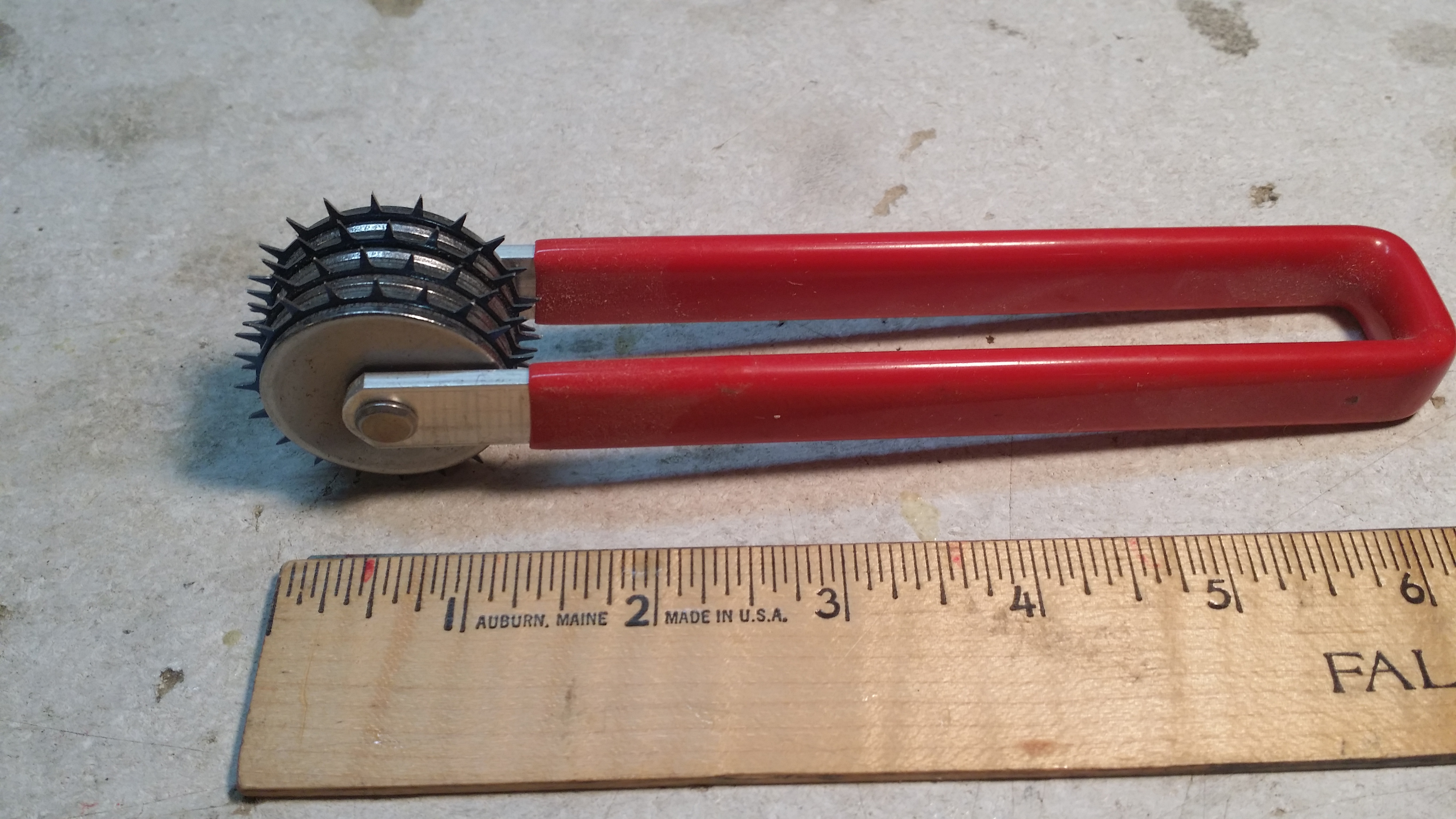

The tool above was called the woodpecker and its intent was to use before covering on all the sheeted surfaces where Monoocat was to be applied. The reason for the long spikes is that they needed to pass clear through the sheeting to provide ventilation while covering and it works like a charm taking only seconds to do when done right.
Hold on now, Yes I have used it often and oftenI I simply forget so lets move on to where the airplane or a panel is already covered and yes absolutely use the dressmakers pins (a technique I used and have written about often) for example lets suppose you have a single ridge like wrinkle that is perhaps three inchs long and maybe one or two more parallel and nearby.
