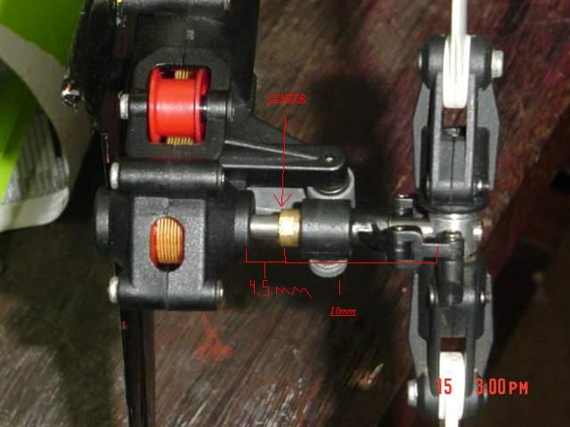

Hi, Zanasi went at my house and he brought his helicopter so I can help him out.
We followed the instructions in the manual but we couldn't ajust the travel limit as we wanted.
Fist, Our problem is that the travel to the right is less than the travel to the left. So the heli is very slowturn to the right because as you said the torque of the main rotor is always happy to help the heli turn left.
I will write the instructions and feedback what we did:
We did.
We didn't understand that part. Reset what Switch? We tought it could be the tail lock switch, so we did as if it is.
Ok, We did that, but here comes the problem. Fist he set the max value of the right rudder command, it's works perfectly, but when we give left rudder binding occurs. So we set the left rudder so no binding occurs, but when we do that, the right max value come back to the old value. This happends because there is only one pot to set the max value of the right and left rudders, and it's seems that it is linked.
That's the problem!

There is also a part of the instructions that mentions setting the piroet rate:
Lift the model into a stationary hover. If you are comfortable, perform a full stick pirouette to the left, and then to the right while noting the speed in which the model rotates. If the model rotates more quickly in one direction that the other, adjust the travel adjust down on the fast side and retest. When completed, the model should pirouette at an equal rate in both directions.
Also, try adjusting the linkage mechanically, you might be able to "center" the throws so that you get a better balance between right and left.

This is the image,,,can you see,, the travel limit is 4.5mm to left and 10mm to right,,,and the center is about 4.5mm,,,,so travel limit is more to right than left,,,,I think that we can't ajust mechanicly the travel didn't????
That looks normal.
On the Raptor, when the slider moves to the 4.5mm side (left, port), the nose turns to the left. When the slider moves to the 10mm side (right, starboard), the nose turns to the right. Since the torque of the engine acting on the main rotor is trying to turn the nose to the left all the time anyway, you don't need as much left as you do right. You need more right than you do left to have a balance. This setup looks totally normal.
Just be sure that there is no binding in HH or rate mode while you are on the ground and then carefully fly it. Presuming the gyro is mostly configured correctly, it will do the right thing once you are in the air.
-Mark

How the Heli is going to stay if I put the comand in center of spindle in HH???It work's??Did you understand me?For example: 4.5mm + 10 mm = 14.5mm / 2 = 7.25 mm = center.
Code:
Correto
| 4.5| 10 |
Left | Right
Max | Max
Tail-Blade
Center
Incorreto
| 7.25 | 7.25 |
Left | Right
Max | Max
Tail-Blade
Center
