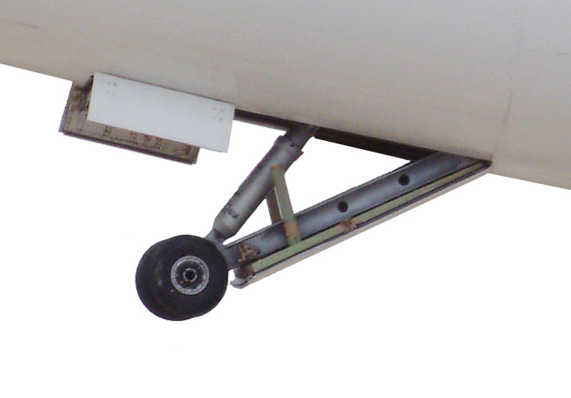

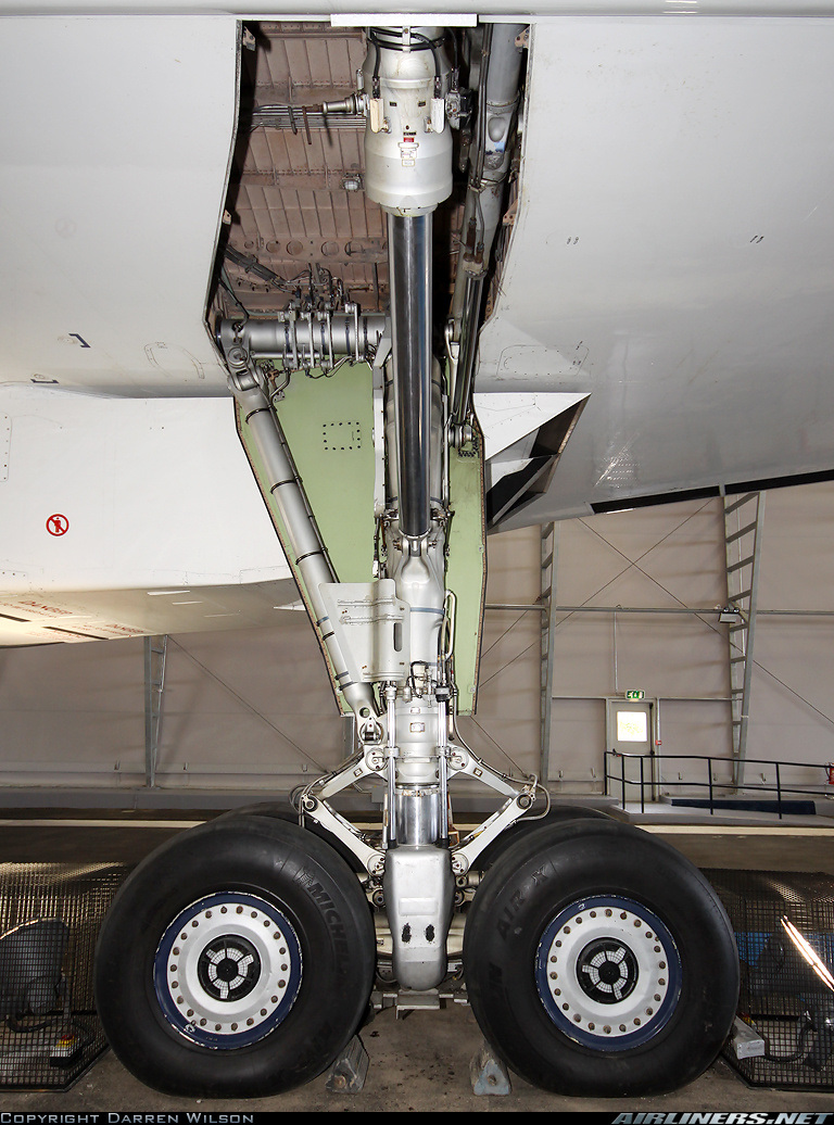

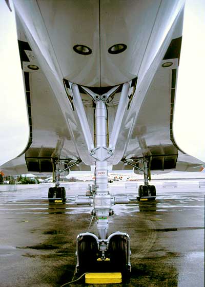

I have spoken to couple of custom electric landing gear manufacturers to make all 4 gears for this model, i have provided them with most of the needed information and documentation, now i await there reply with price quotes. I will be adding ply reinforcement plates and carbon to reinforce landing gear bays structures in the wing frames. From the sounds, it looks like main landing gears will have scale 3 point mounts, very similar to actual aircraft's configuration.

I like to know if a Robo straight strut's main tube leg's length could be extended from max available length of 9-13/16" by adding another 1-1/4" to it. If yes how can this be done and if not, then why?.
The reason why I'm considering this route, is the company who is going to make landing gears for this model dose not want to add side links and drag links to the main nose leg due to higher costs on my end. All they can do is traditional straight leg on electric retract and i'll have add side links and drag links later on myself. To do traditional type both mains with trucks and nose gear they want $1000 USD, now considering that if nose gear leg will be traditional type from them, why have them do it if this option could be done by adding extension myself, this way i can save on cost yet get landing gears done.....
http://www.robart.com/products/58-di...ight-robostrut

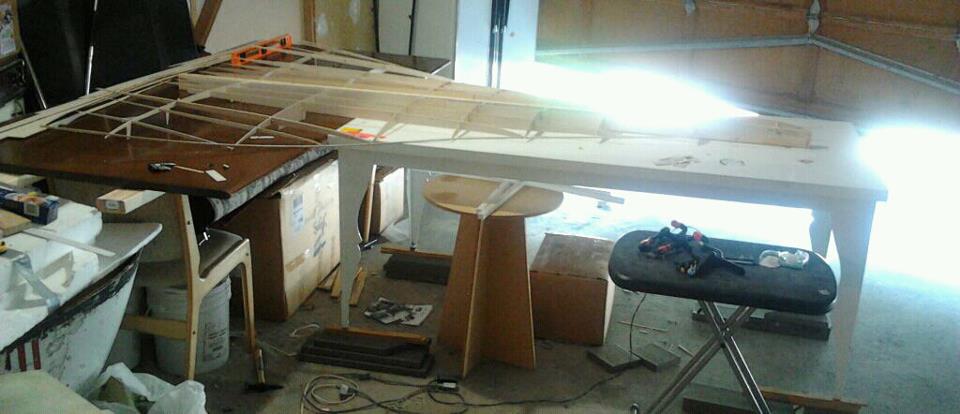

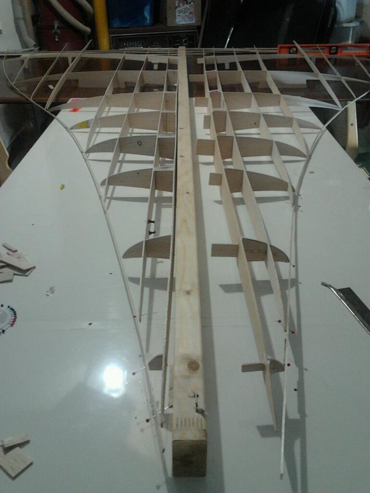

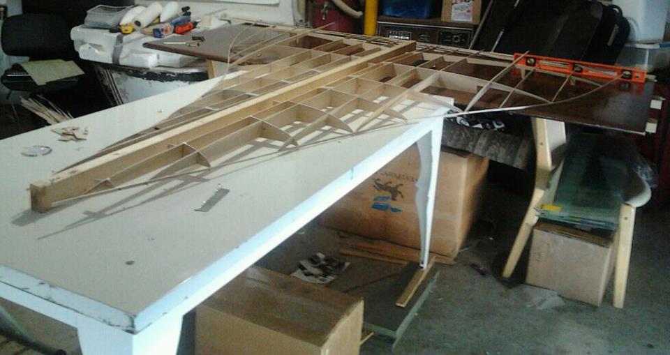

Had to get another table so i could work on both wings together. Both wings were placed on the tables once both tables were set up for this
step. I also got 2x3x96" stud to align both wings. Basically both wings were set on each side of this stud, leading edge strips were loosen up, this allowed spars to move easily, then both root ribs were clamped on the stud, this straighten the ribs against it, then opened up my drawings and started to measure each spar's tip for it's ground clearance, this way i start to match all the ribs that were bit off by taking out that particular spar and cutting the root joint on better angle so tips would measure the same as on the drawing. Took few hours to do this as there were few that needed this attention. After this, i made sure all the spars were 90 degree to the root rib and then did same with ribs to the spar joint angles. I still haven't glued anything as yet, i will go over again to make sure all are perfect before i glue these the joints together.
Another area of concern is where main landing gears will mount, now do you guys suggest to add lite ply strengtheners on both front and back spars and then both rib or should i use triangle gussets on each inner corner, and then do 6.0oz carbon cloth's lay up on the inside of these boxes....

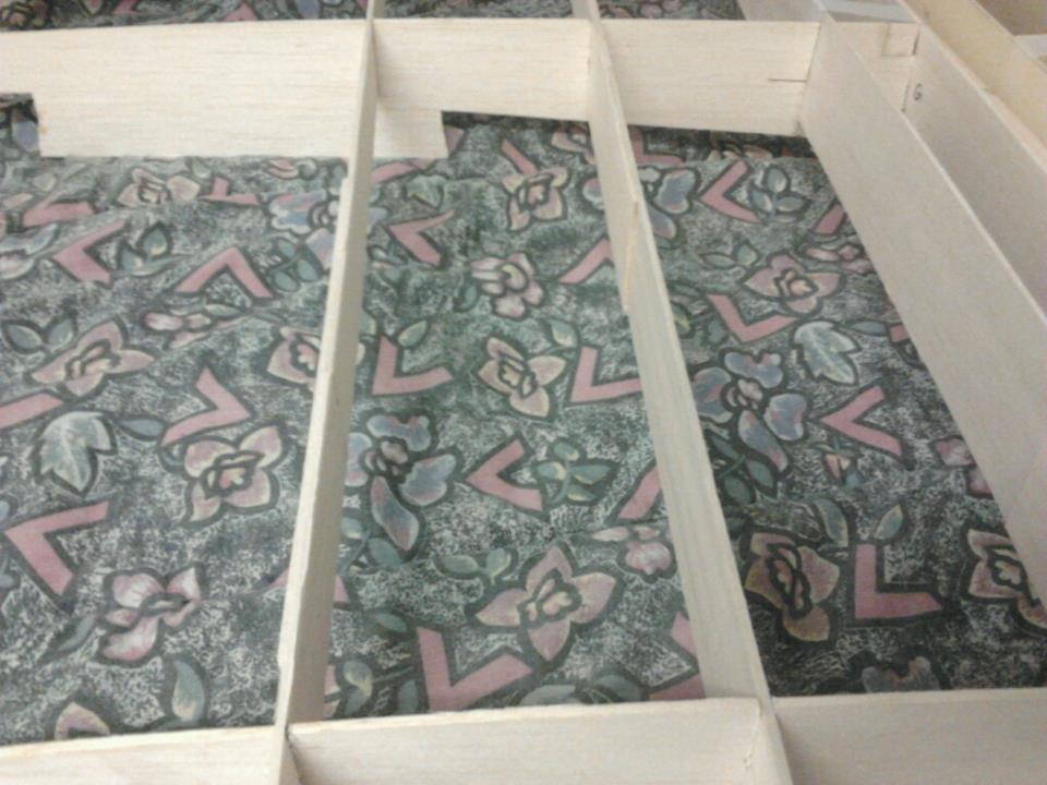

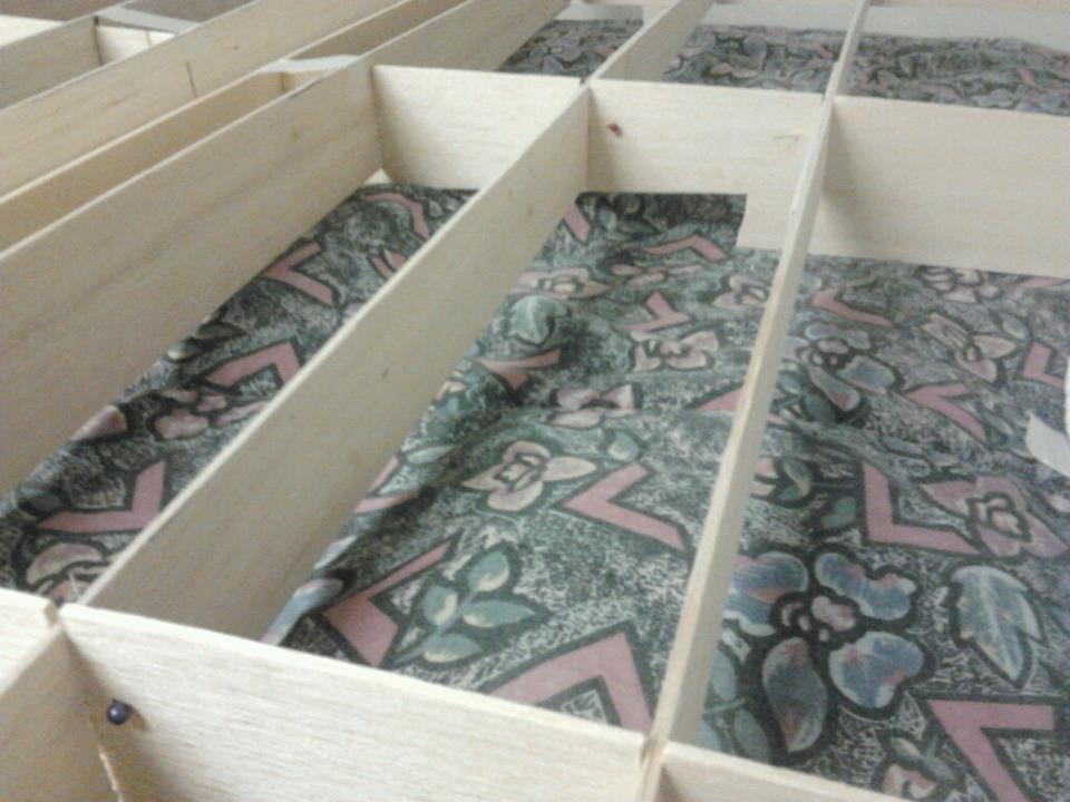

Here are pictures of the wing structure where main landing gears will mount. In first picture, from the centre, 3rd outer rectangular torsion boxes will become main landing gear bays.. Both main LGs will be mounted very close to the nacelles, just behind main intakes on the inner sides of the nacelles. 2nd picture is showing Right wing's gear box, 3rd picture is showing left wing's gear box
Should i make stiffener plates of both ribs and spars n glue them on inner side to reinforce these bays or should i just do 6oz Carbon cloth's layup on present structure and that should be good enough...

Props4ever, when you make your landing gear check which length you want. The Main gear has a shorting mechanism that shortens the gear as it comes up. If you make it the extended length it wont go in the wheel well.
