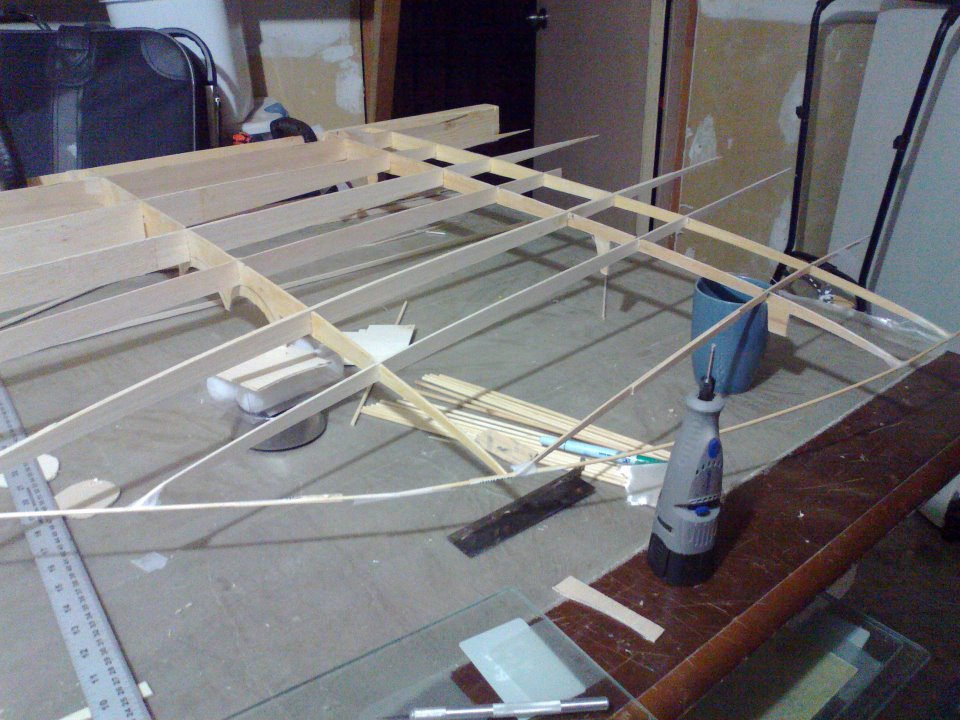

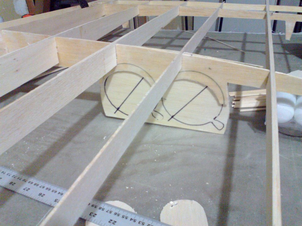

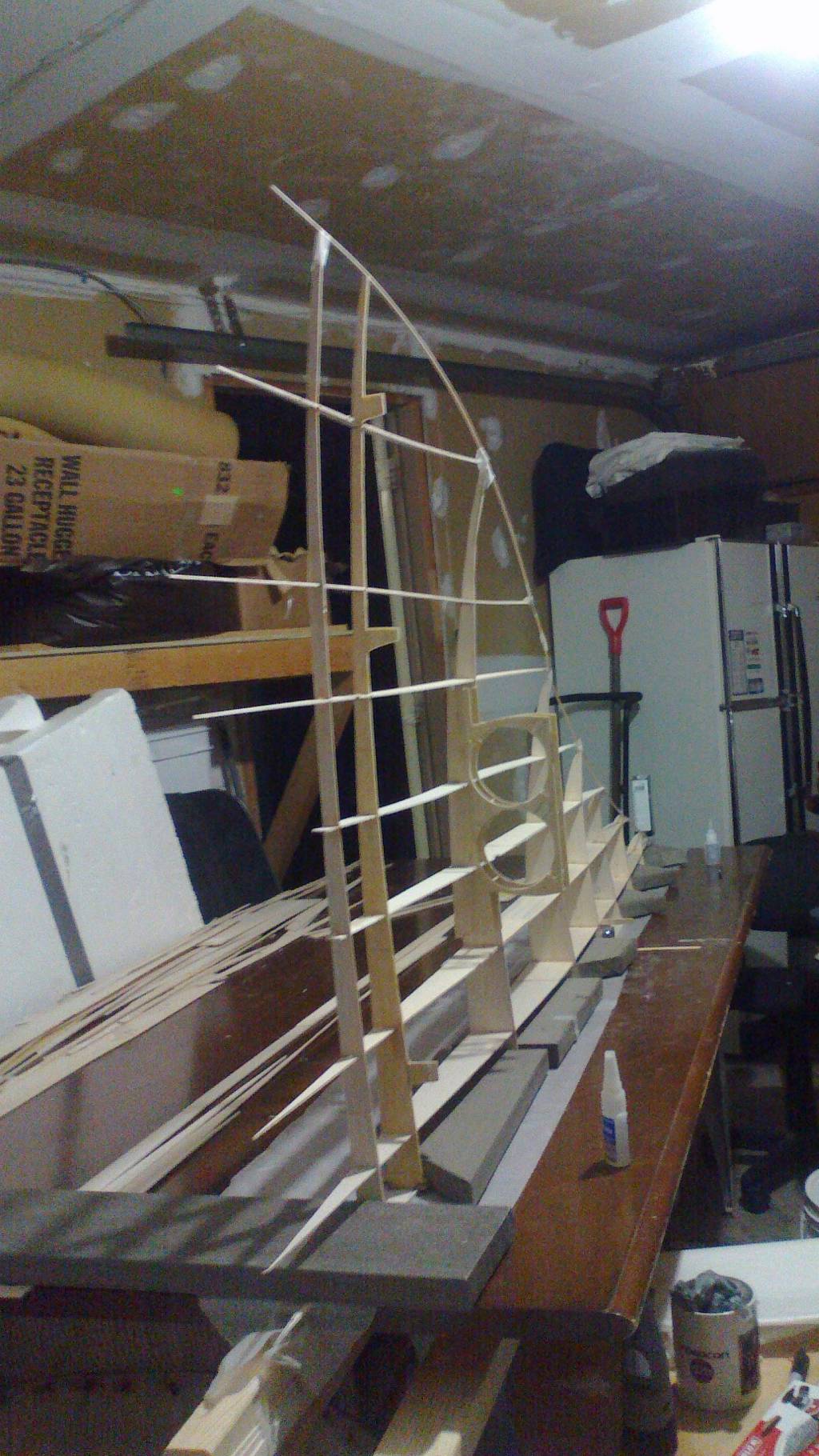

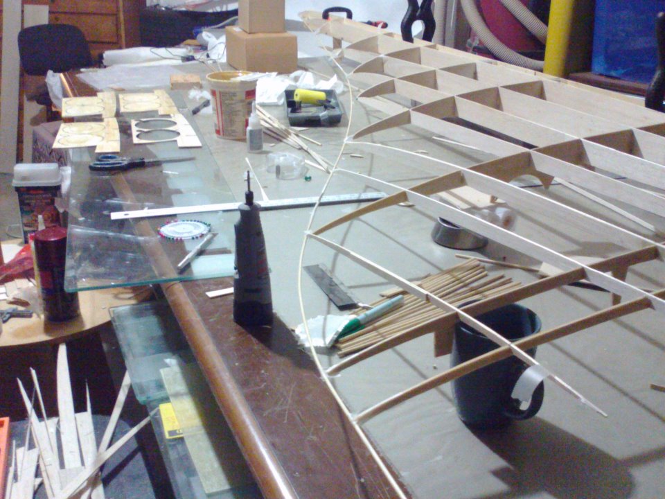

Right wing already have new trailing edge spar and both ribs installed, took off strip LE and replaced it with dowel leading edge, man it only took less then 2 hrs to modify this wing Vs other other one took days!......

After the wing, while i'm waiting for my dremel's battery to recharge, i pulled out main spar and one of the trailing edge spars to laminate them with fibreglass, while i was doing this, i thought this is perfect time to make nacelle's formers that will pick up the edf units, so made first one, then how about i make sub spars that will act as cradles of the edf units, this way i will make short hard wood edf mounts to bolt on the edf's to and then 2nd set of formers will act as edf cradles also.....

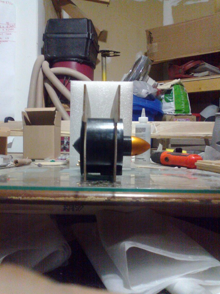

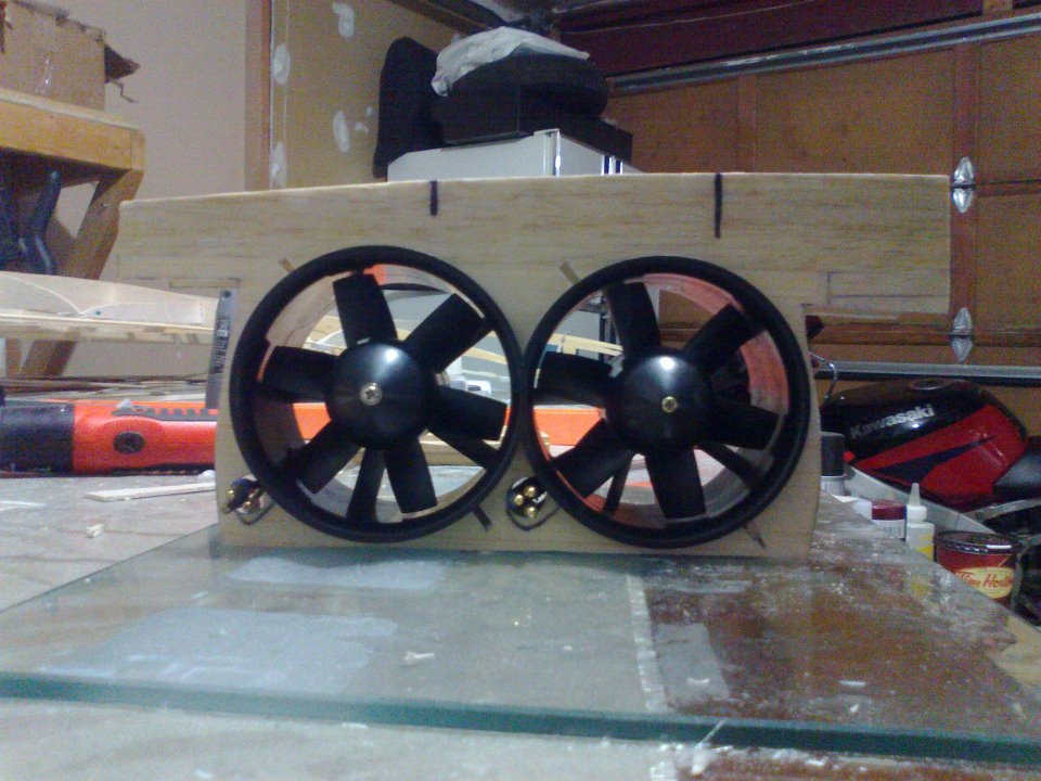

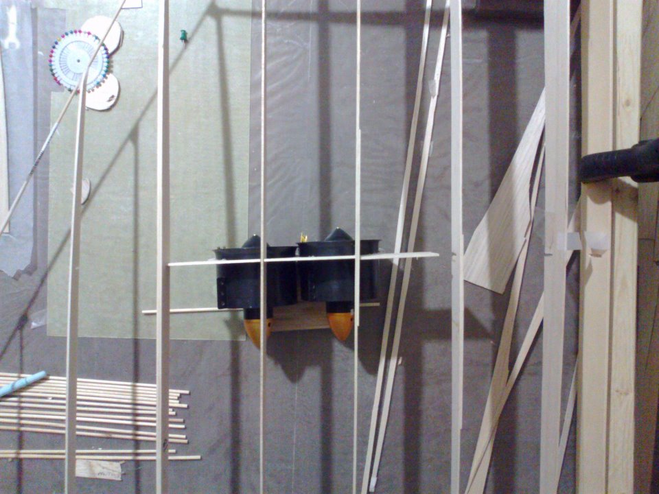

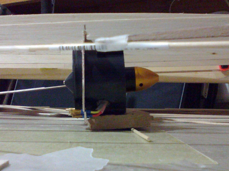

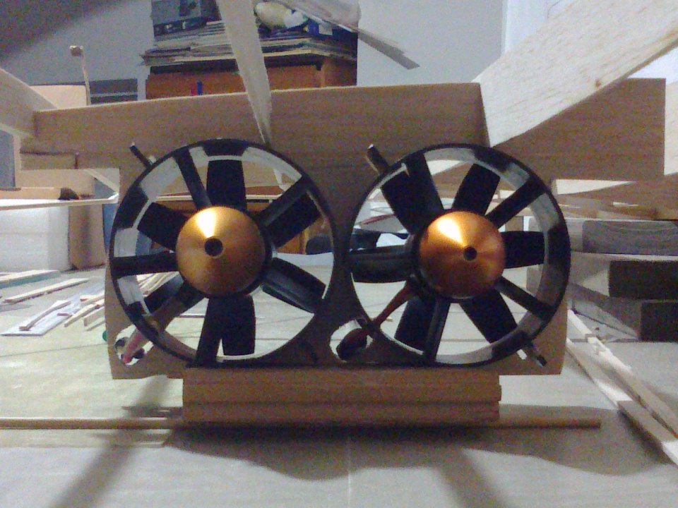

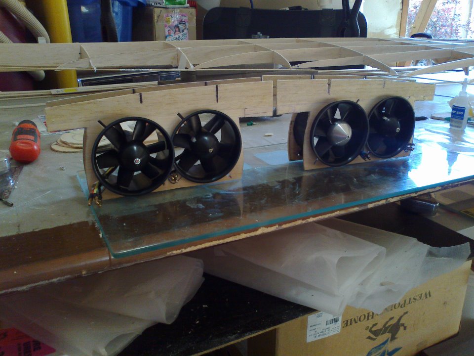

First of the 2 edf's installed in the nacelle former, then this assembly was dry fitted on the wing's bottom at the main spar's location. Now this sub-spar will be butt joined on the back side of the main spar at this location. In the side vies shot, you will notice, edf's are pointing down by -1 degree, this is how it's on actual Concordes, this pitch down angle helps lift nose and long fuselage faster by pointing thrust at an "UP" angle.....Since this is 12th scale model with 11 of the fuselage infront of these edf's is sensible to mount this on scale angle....

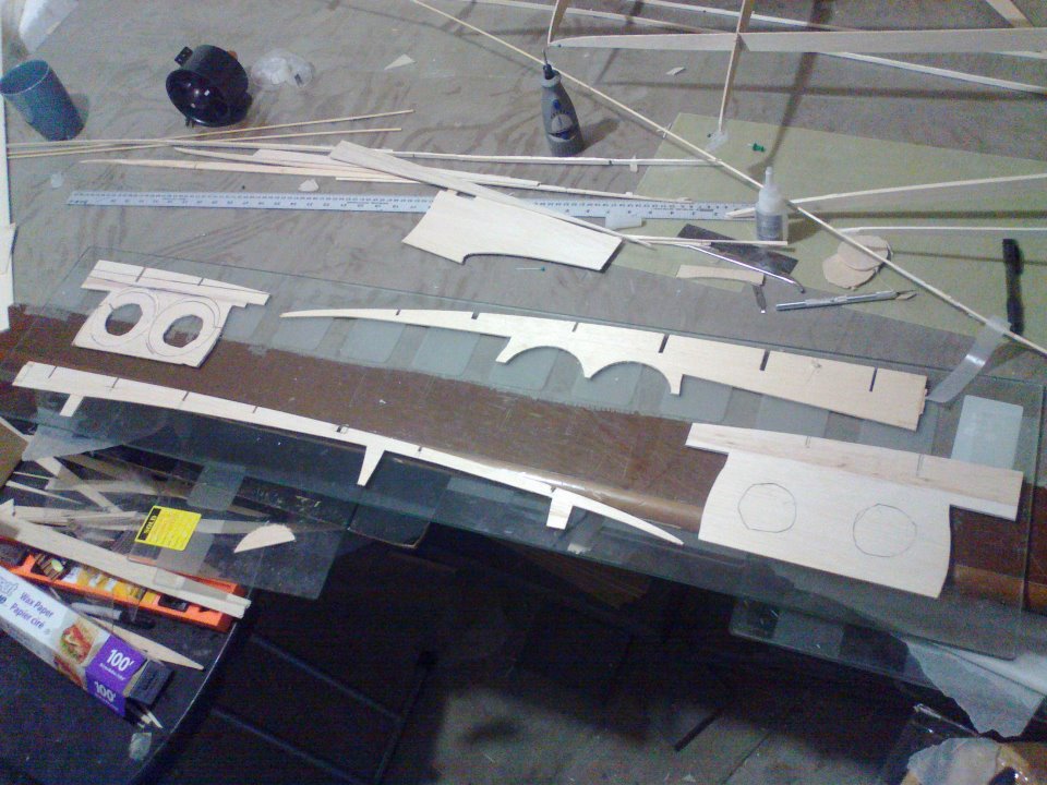

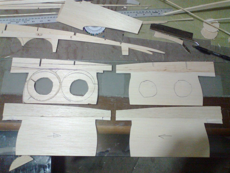

Not much as compared to yesterday's progress but i laminated nacelle formers and the 2 spars on both sides, these will turn out really nice once flash is trimmed off and parts are cleaned.

Today's update, actually evening...lol.
It took me 2.5hrs to clean all the access fibre flash from the laminated parts that were laminated last night, plus few sports of certain parts didn't laminated properly so med CA did it's magic there. Both spars are now installed in the wing, also notched and installed the nacelle former. I noticed that only 2 of the ribs are picking up the nacelle former that is butt joined to the main spar, i'm going to add 1" extensions on both ends so this way 4 ribs will pick up the nacelle former and load and vibration from edfs will be distributed evenly....

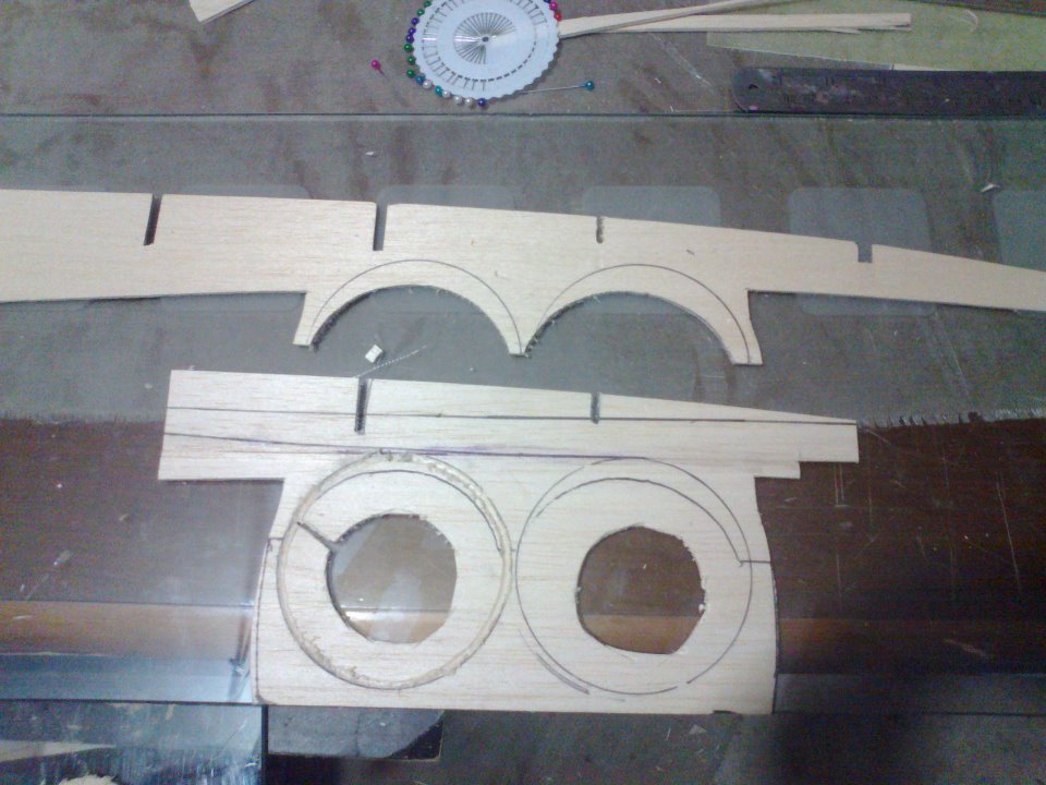

Nacelle formers were done lamination earlier today, then in afternoon/evening hrs i started to make the holes/round cut outs for the edf units , this didn't fly good in the beginning, then went and got myself a compass, made a slit on the back of it's pencil, glued blade on it, tried out to make the round cut easier but , it was anything then easier, so after making first cut out, used it as template to cut other 3 round cut outs with new blade on x-acto knife and my hand made drum sander....Well here is the result.....

Are those 70mm units?
Old 07-08-2012, 09:13 AM
  #85
Props4ever
Join Date: Aug 2005
Location: Mississauga, ON, CANADA
Posts: 4,196
Default RE: 1/12th Scale Edf Concorde

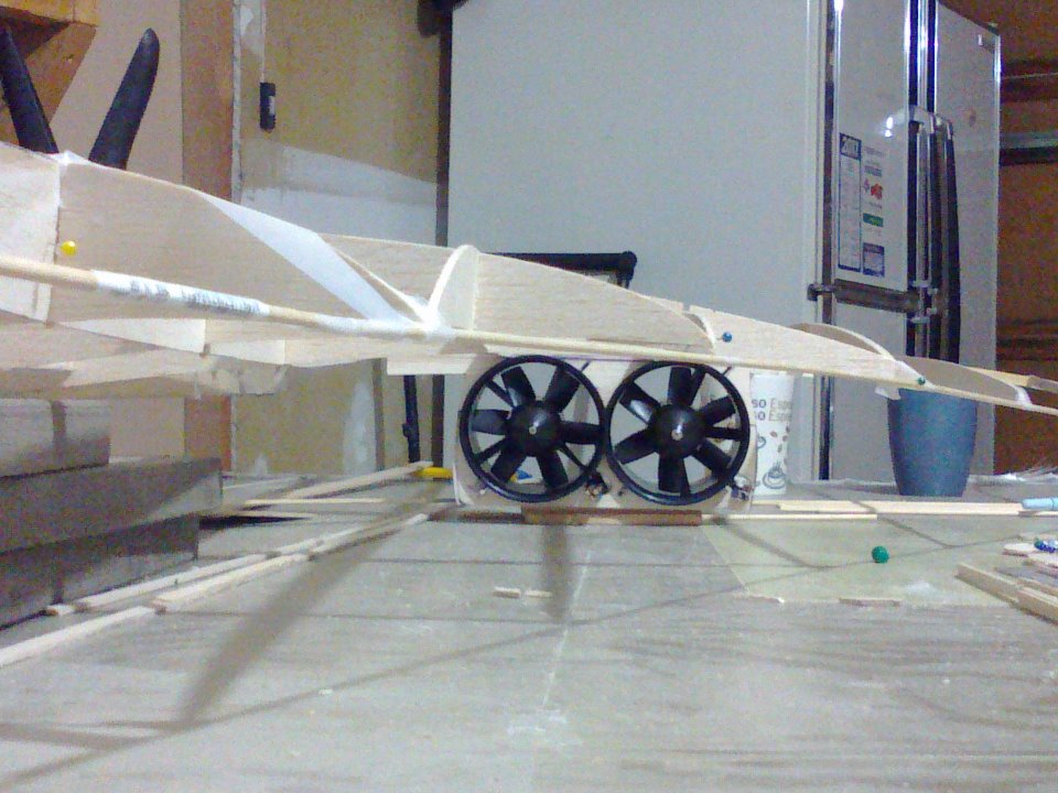

90MM Freewing edfs with 1750 KV motors...producing over 5lbs of thrust each on 6S 5000Mah Lipos

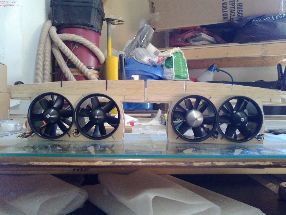

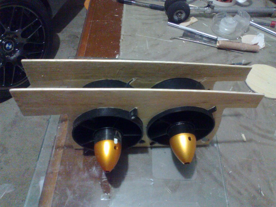

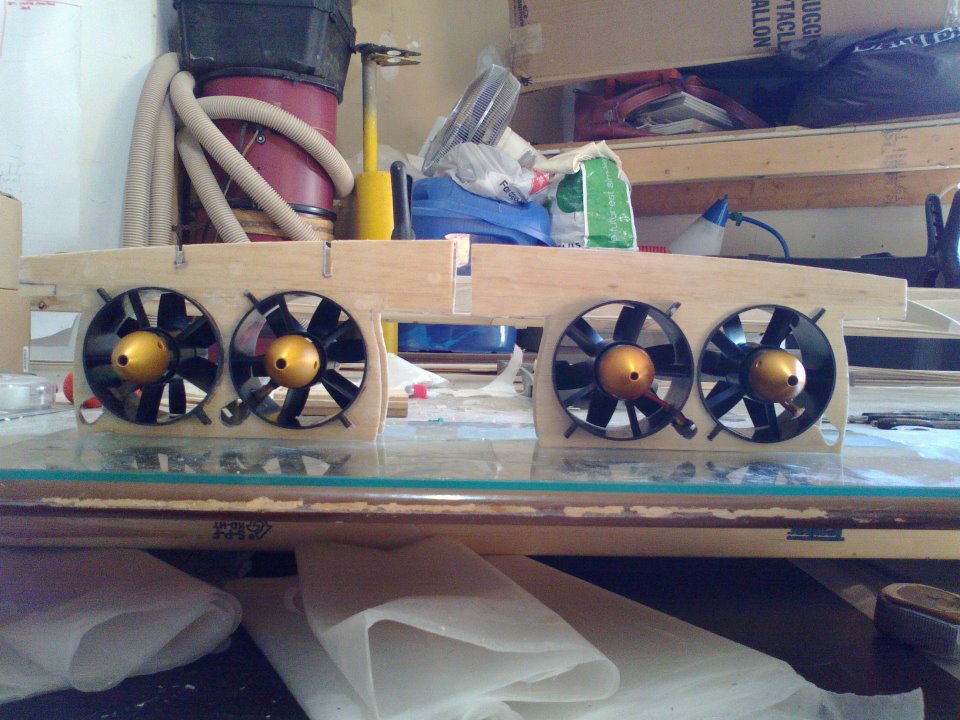

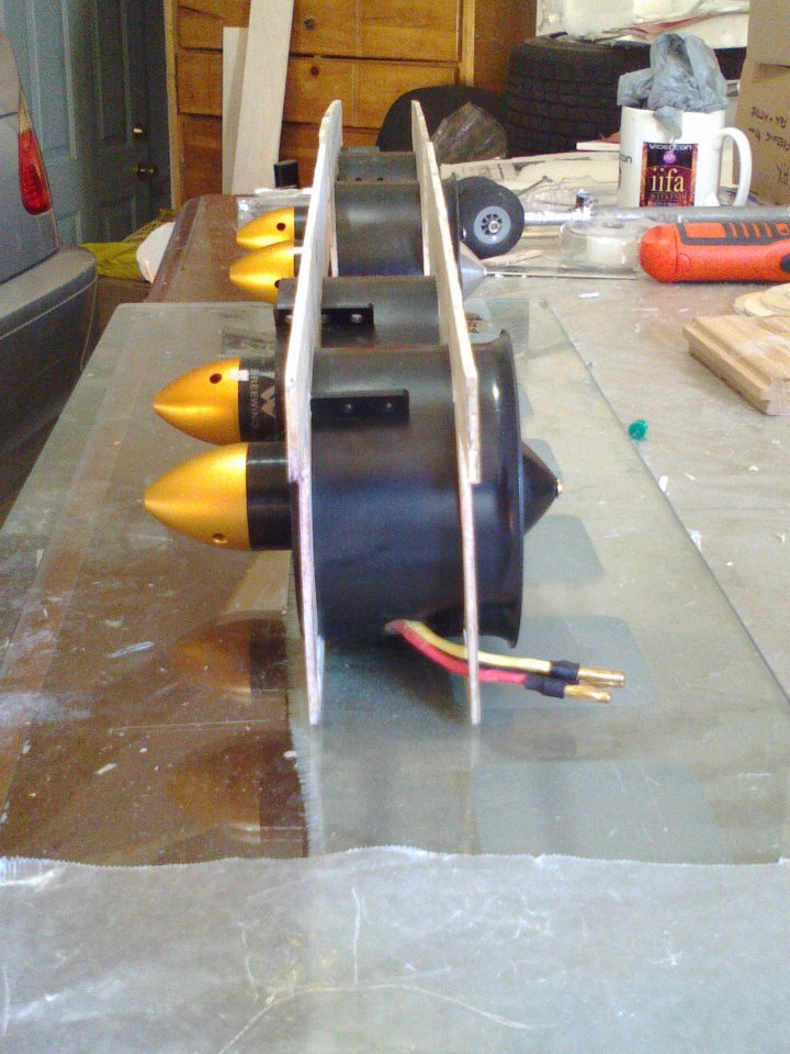

Dry fitted all four EDF units in there cradles that i finished making this afternoon. I have marked the locator sharpie marks where 1/4" x 1/4" balsa stocks will be mounted to make 2 of these cradles into one unit/frame work. I will make lite ply mounts to mount edf units in this frame so they will be secured properly.

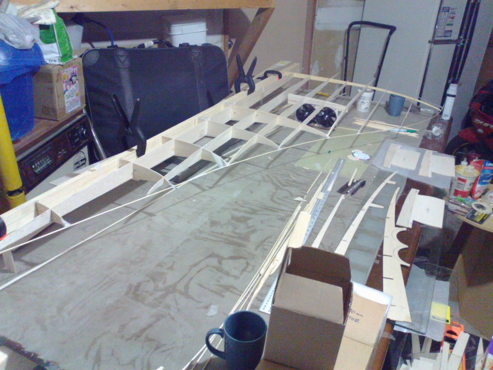

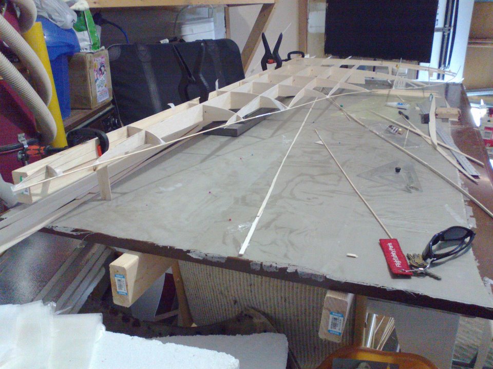

Working on the wing of Concorde once again, had to make another newer trailing edge spars to get right washout angles at the wingtips. Wing tip ribs had to be thickened so those were also made again. Right engine cradle is under assembling at this time. Soon will start on making under slung engine nacelles for both sides.

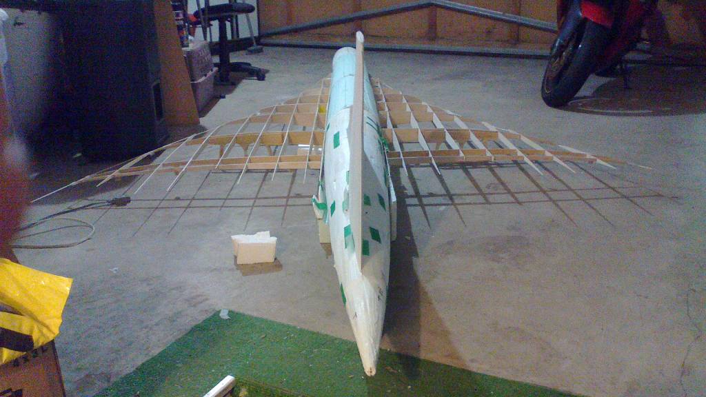

Wash out angle question:
I'm having bit hard time getting actual -12.5 degree of wash out angles at the wing tips, presently i'm at -8 degrees comfortably after making newer trailing edge spar with light curve on outer tip. What should i do about it, i'm sure if i twist the wing a bit and ever so slightly pull up the tips of the spar, i can get very close to scale wash out angle but then it's bit of manual twist in the wing through pressuring it.....
Any ideas or should i leave it at -8 degrees and not worry about it?. I just hopie airplane won't tip stall if i brought her at + 8 degrees on approach and pull up its nose bit more as i flair it juss before touching down.....

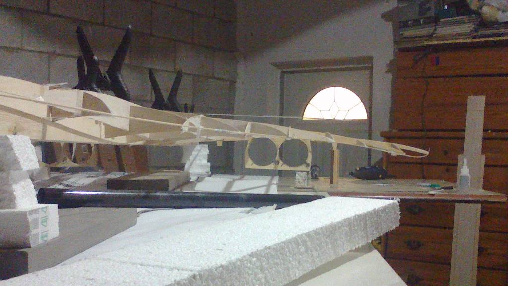

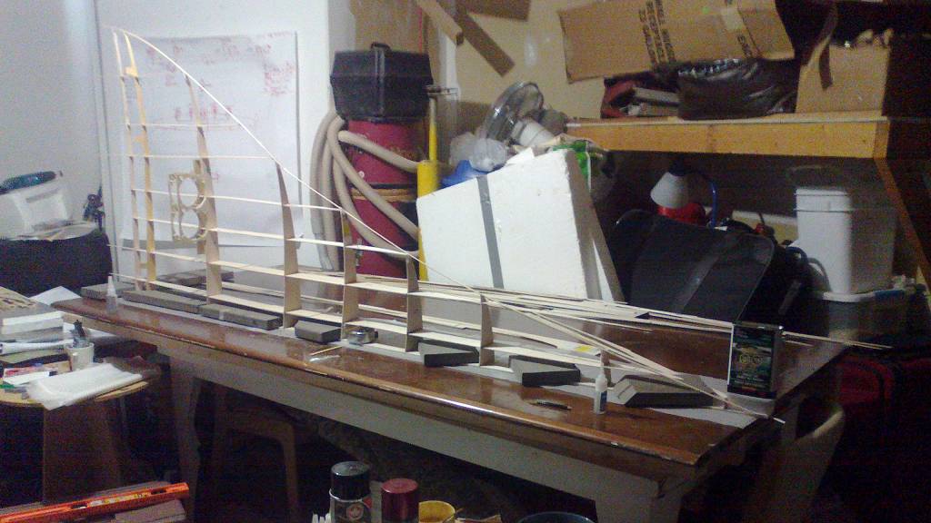

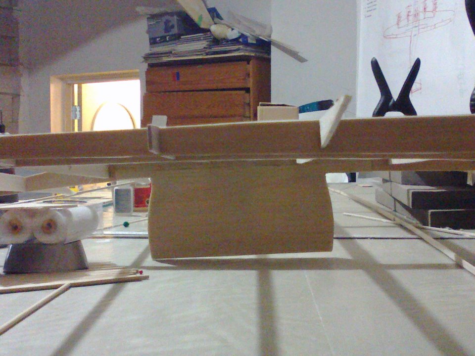

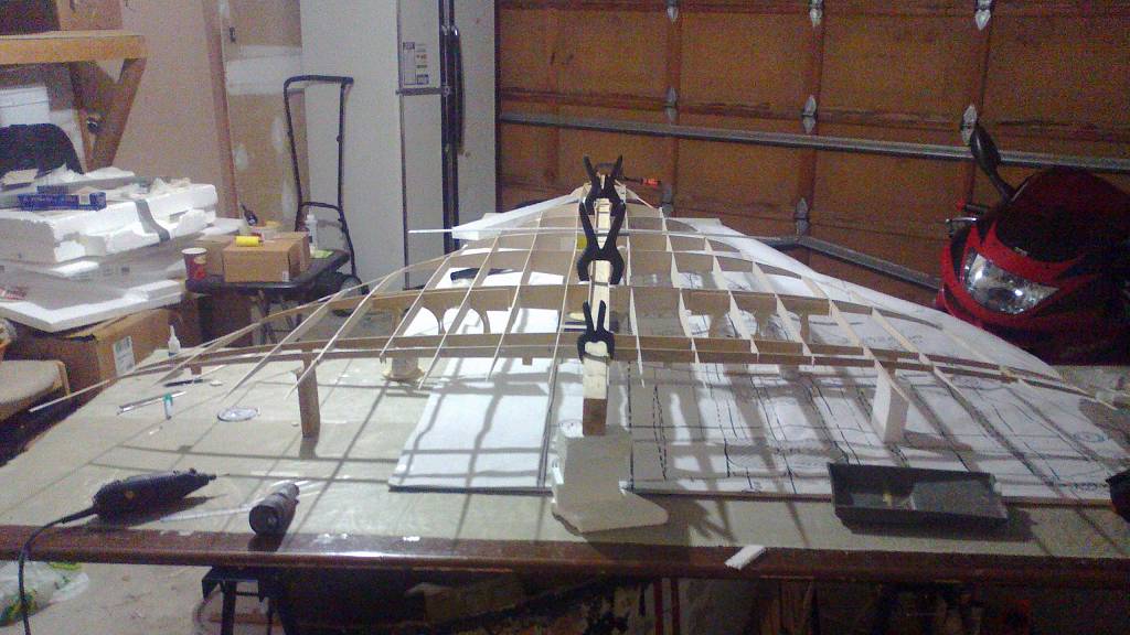

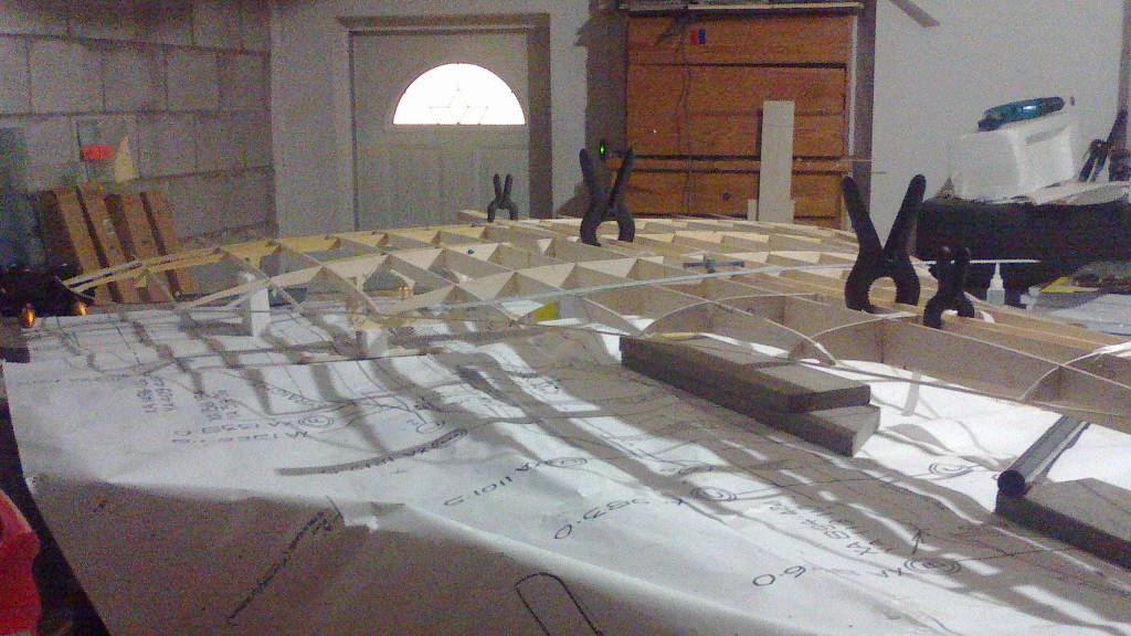

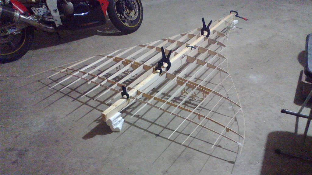

Both wings are presently joined togeter with claps on 2x4 stud with drawings under it on top of the table. have been measuring all the spar tip points from one side to another to make sure both sides are same. where adjust meant is needed, that area is getting adjusted accordingly.
All 4 edfs were installed in there cradles a man does wings become heavy instantly....lol
if i get all nice n square, i will start glueing wings together n yes this model will have -12 degrees of washout!...

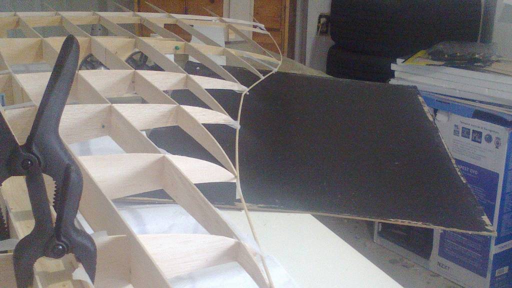

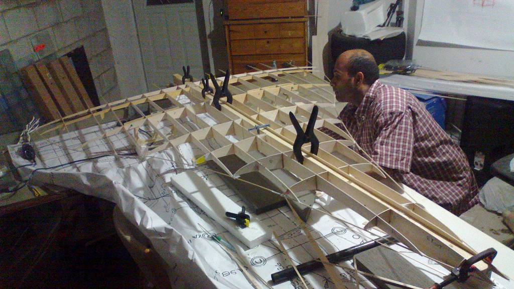

Well guys both wings are built as i type this post, all joints glued together and man i had to be quick while doing spar or rib joints as CA glue is fast curing even at medium speed!!....both edf cradles are on the wings with all 4 edf's in them. I will do weight test later tonite....
I did had couple close calls as few notches were given hard time at wrong time, but i got it all done perfectly...
pics to follow soon...

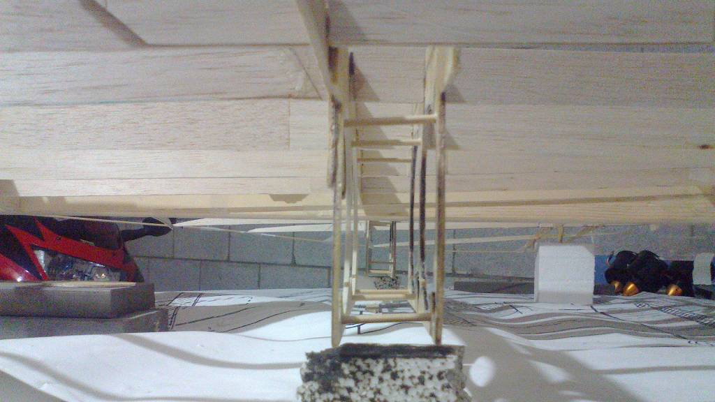

Pictures from yesterday's progress....
I also added scale "Kink" on both wings, this was done according to actual drawings of the aircraft to make sure angles were exact as on actual aircrafts. There are few gradual angle changes on this wing planform that a lot of people dosen't know about, i'm trying to add all of on this model's wing.
Next major step is to get the resin and start making fibreglass sheets to be cut into skin panels of the wings.

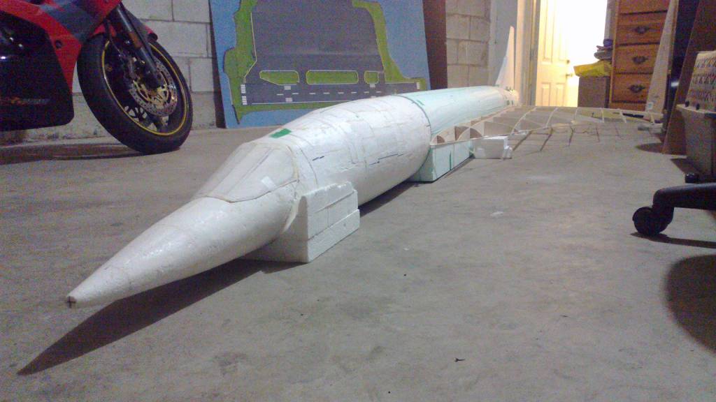

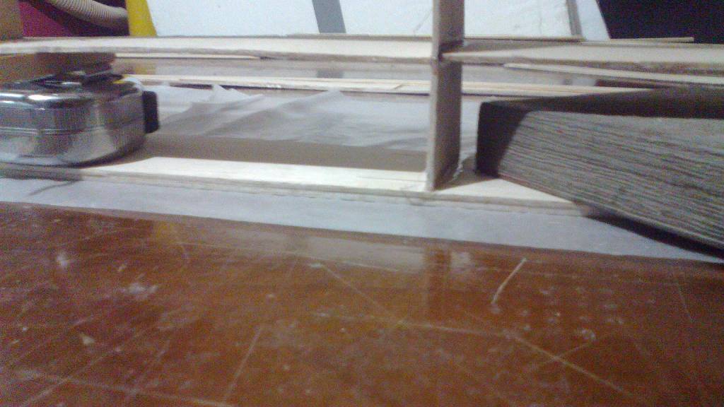

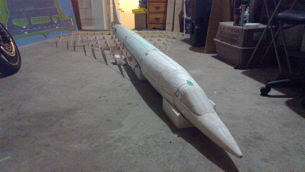

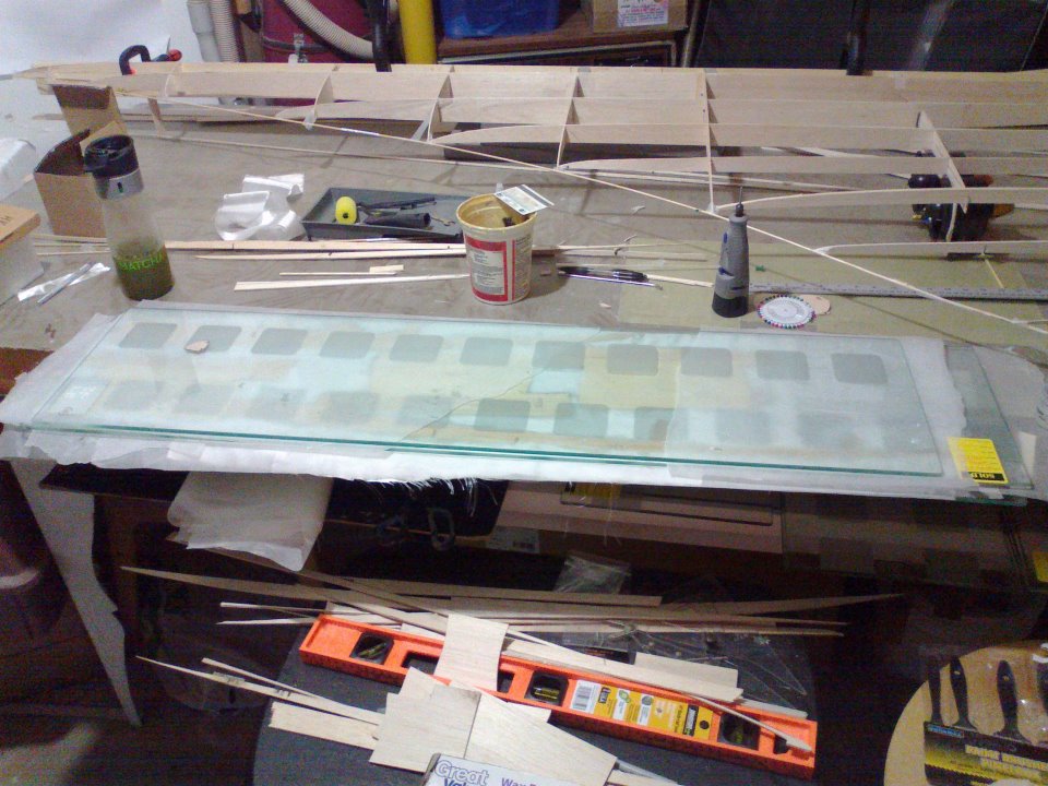

If you guys remember at the initial time of wing builds, I first chose to use 3/32" balsa sheeting to make all the ribs including root ribs but after lil while into the build disregarded balsa root ribs and re-selected lite ply for the root ribs which indeed left wing has, well since i was out of enough ply back then to make both ribs, i had kept one of the 2 balsa ribs aside and after both wing frames were completed night before last night, i didn't really like flexing on the right wing at the root due to being balsa one, so this spare rib came in handy as I set wing on it's root on the building table and epoxied on that spare rib on this wing root as doubler, this also reinforced the root rib and it's strength and slightly extra thickness on the root, doesn't really change the wing's diementions span wise either...
