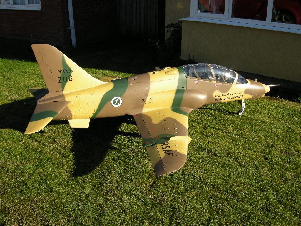

A random shot of the fuselage side, giving some idea of the paint finish. I am not sure if the markings are logos or painted? I do know they are not a sticker on the outside as you can feel that the top coat covers them.
