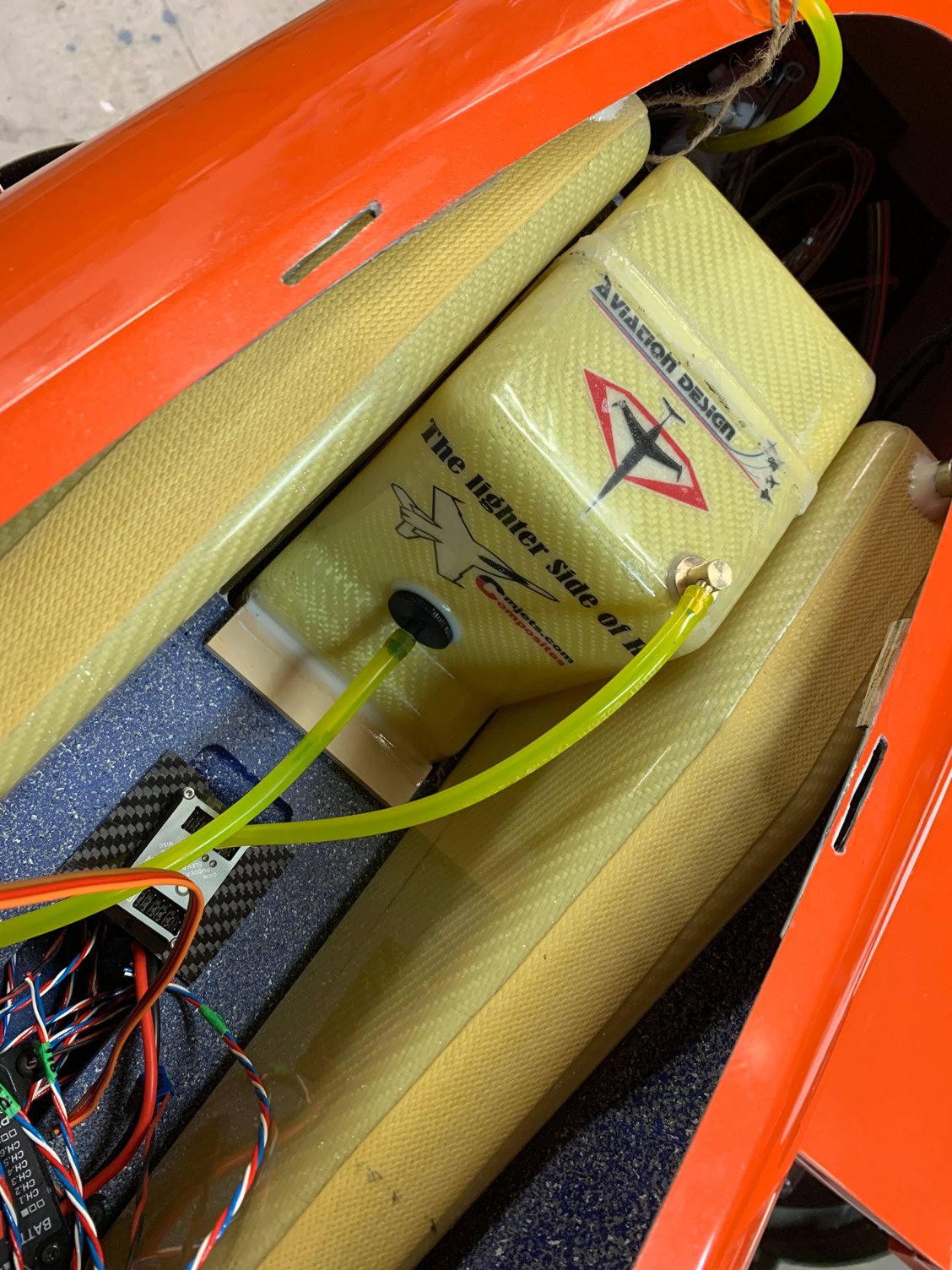

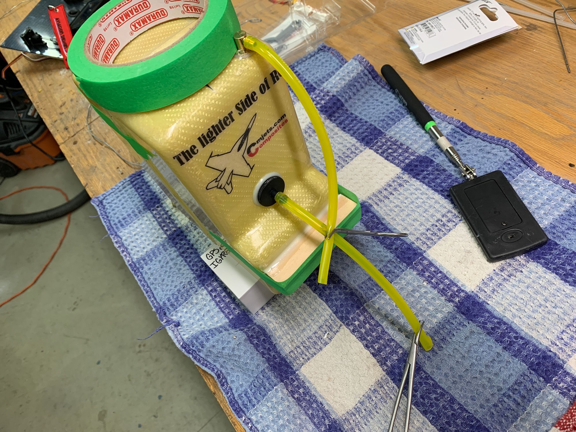

Smoke tank from CMJETS.com!
Preping smoke tank with tabs. Would work fine to sit on the bottom of the fuse but the skin is flexible so I would rather have the former work supporting the weight.
opened up the opening about 1/4" on 3 sides for tank to fit.
Custom Skycandy Lighting setup. Missing nose gear light in picture. Wait till you see these things.

Silicone added to tanks to keep in place. If removal is required later feed fishing line or safety wire under and it will slice through.
bit more oranizing.
Skunkwrks (12-16-2020)
