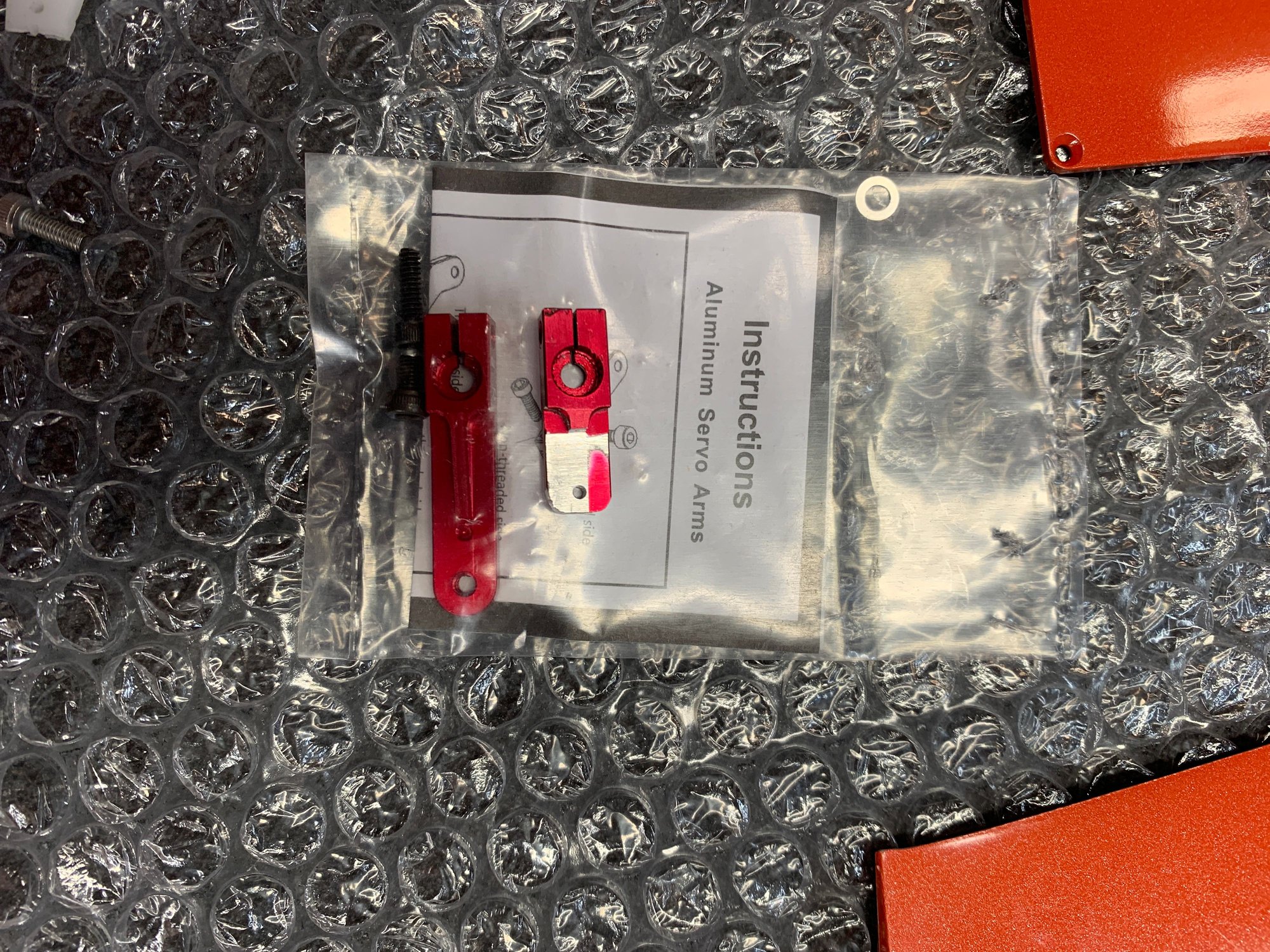

Servo Horns need to be 14mm if your doing them the standard way with double clevis.
Used a HD JR one as a guide. Marked aluminum horn with a drill bit and drilled it on drill press so it's square.

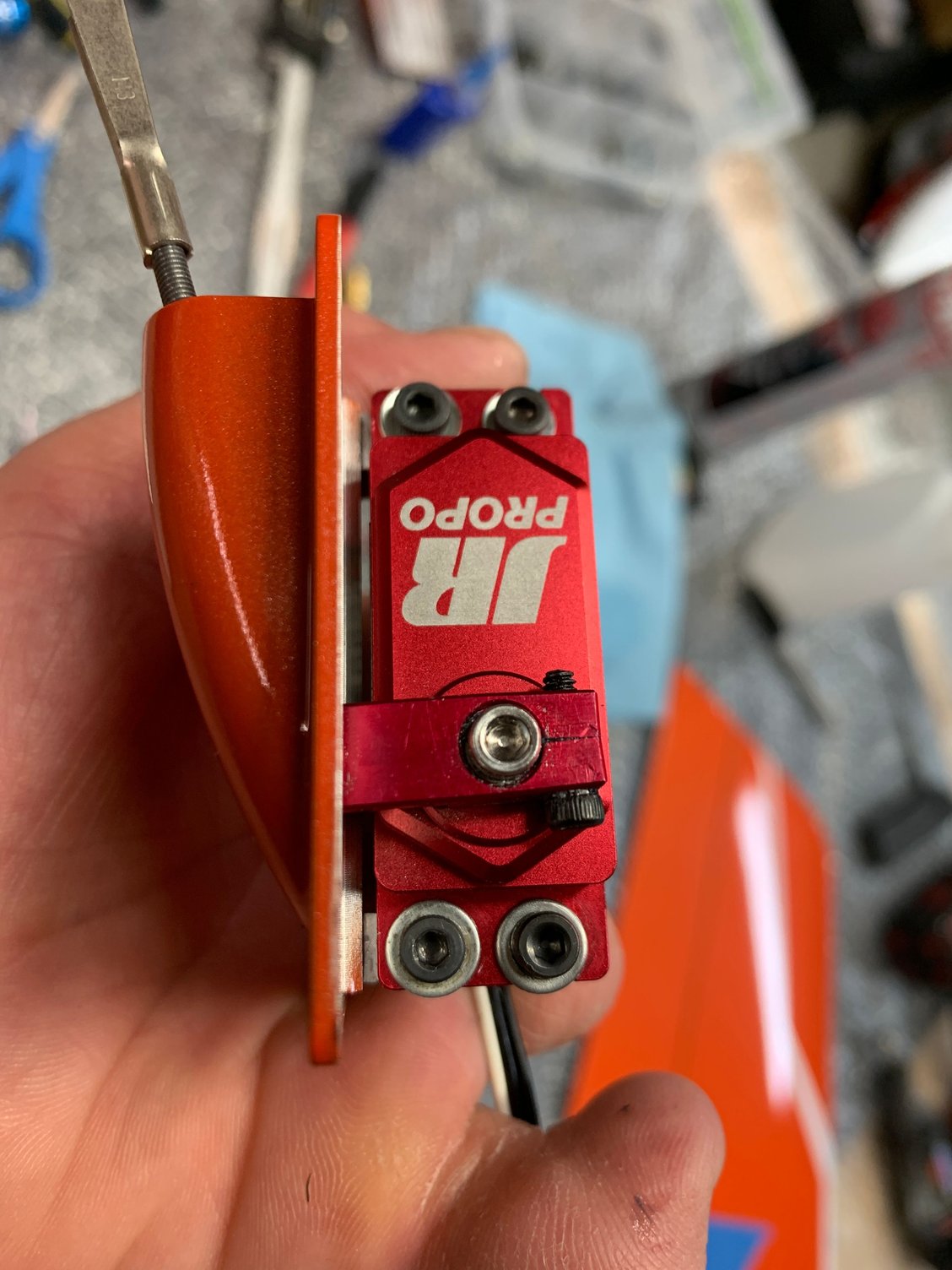

If you watch the video, I explain it but basically don't over tighten the set screw on the vertical risers for the servo mount. If you do it right you can get it at a 90 degree angle when it's fastened.
2 x 3mm washers needed behind servos to bring into proper alignment. This pictures shows the wrong adjustment on the servo mount. See the angle between the plate and the mount.
mount is nice and level.
The top hole is sized correct to tap 3mm threads which makes lining everything up much easier. nut and bolt was used on bottom hole.

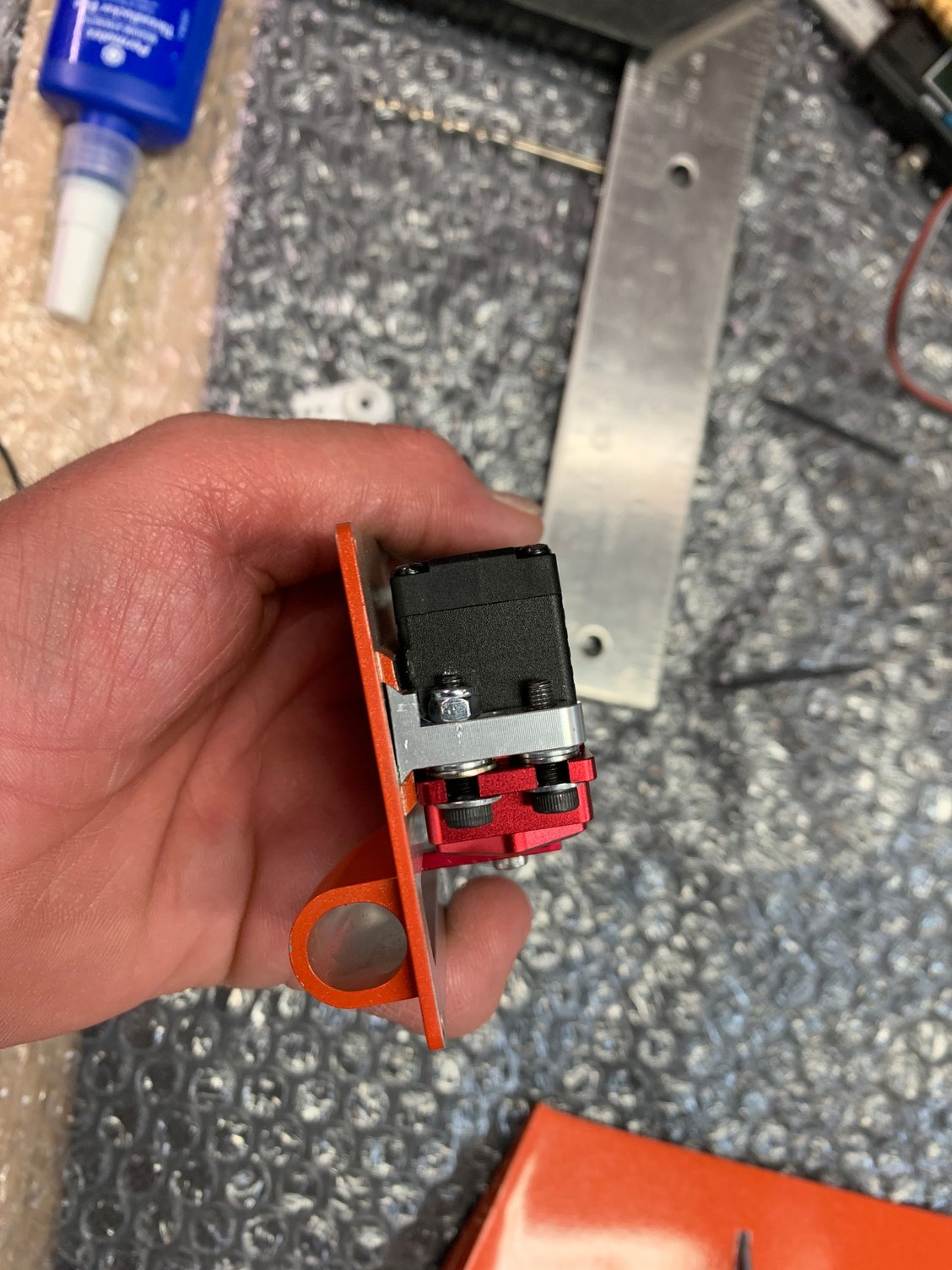

Servo does not need to be tight against the cover. If it is, you may run into clearance issues. there is room in the servo mount to adjust a few MM's away from the mount which makes everything work.
Servo tight against cover
servo spaced out from cover.

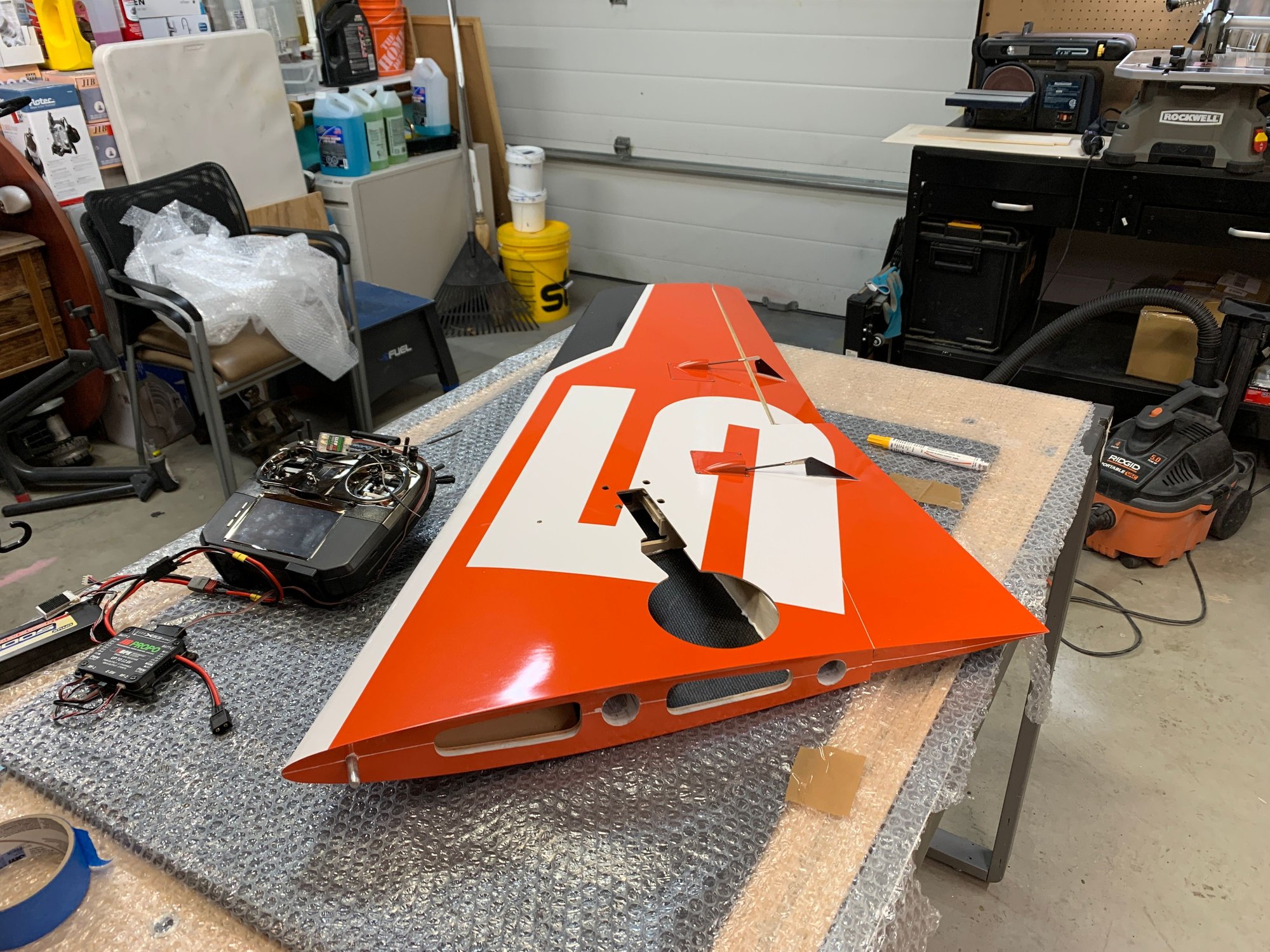

Last batch of pictures. servo mounting areas need to be opened up slightly to accept aluminum mounts and servos.
Opening in elevators. opened these up more later on.
Will do final clevis attachment/surface centering later.
