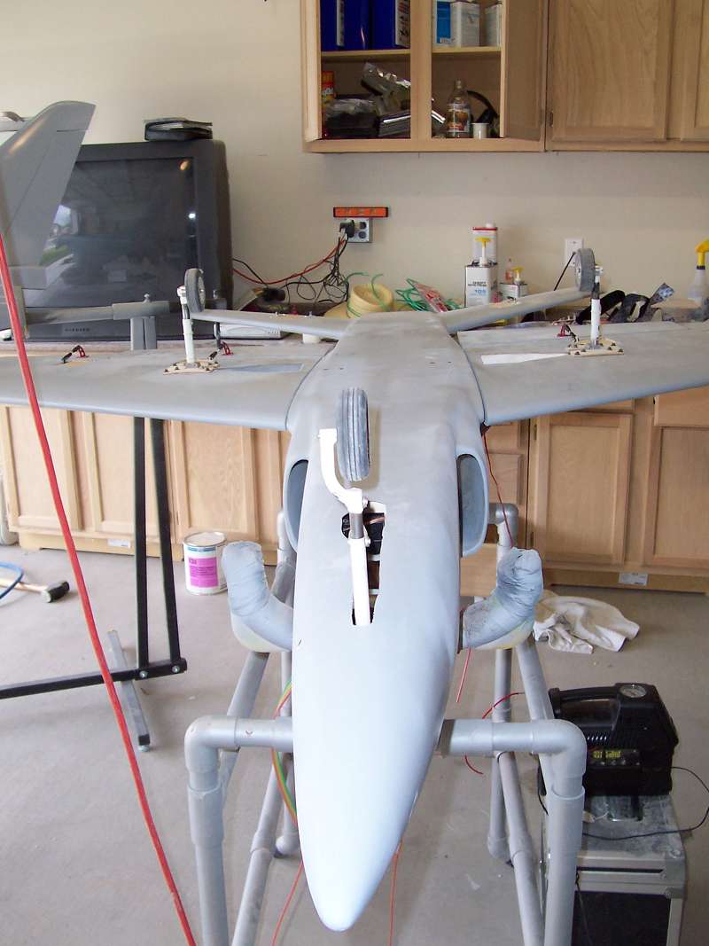

Essentially I finished the build last night, just took a couple pics this morning on the way to the office. Will take more detailed tonight and the next few days. I installed some easy access information and fill ports. First time I've done this, don't know if I'll like it or not.
Next is turbine, exhaust, fuel lines install. Looks like I'll be test flying sometime this weekend weather permitting.

The fuel tank I built ended up a compromise between what I wanted 185 ounces and what exists for an isobar tank. A stock isobar tank is 140 ounces. I filled my tank and then emptied it by defueling into several 26 ounce graduated cups. My tank defueled to bubbles at 168 ounces. Did the same thing with stock tank came out 138 ounces. Plus, my tank is further back on the cg by being formed into the intakes. I leak tested my tank, NO LEAKS! Pretty cool [8D]
Look closely and you'll see Todd and Kim's zip tie pull pull cable tip!

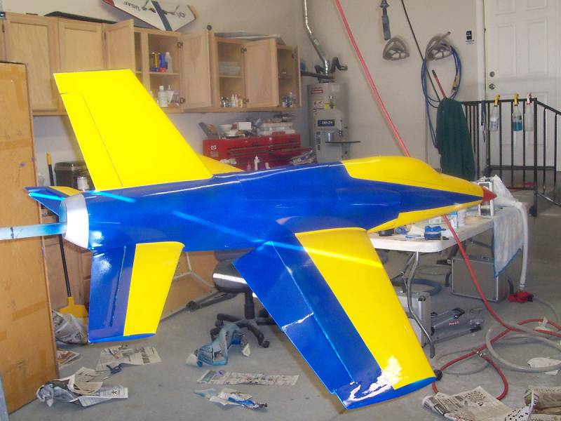

Since you guys sometimes don't see a finished product. I'm gonna paint this later this year. I just ordered a P-200 Pipe and Bypass.
I will maiden the airplane probably sometime in June. The initial ground testing of the airplane showed that the pipe I made was too small for the Merlin. Another Isobar here in Austin maidened on a P-200 last weekend and I'm lot more happy with that bypass and pipe setup than what I have.

The pipe I made was 88 MM or just a hair under 3.5 inches. I believe that is ok for a Titan, but the Merlin is moving a lot of hot air so to speak. A single wall pipe wrapped in aluminum wrapped in ceramic blanket was getting so hot at the inlet of the pipe that the pipe heated the resin out of my fiberglass by pass where the pipe meets the bypass.
A couple of lessons I learned
1) I had the engine moved as far forward as possible in the engine compartment to get CG requirements in check. This meant my pipe inlet had to follow the engine to get proper clearance between tailcone and pipe. When I did that, I brought the pipe about two inches inside the bypass. This cause another suspected problem in that there may not have been enough cooling air from the inlets through the by pass and into the pipe to mix with the hot air coming out the engine. While my EGT never hit 600, my pipe inlet went well above that.
So I chopped off some of the pipe and was working towards moving the bypass more forward to make up, but long term I just decided I was chasing problems rather than just buying a correct solution. A couple more hundred bucks for the right stuff will go a long way.
2) That aluminum hvac tape.......... The aluminum is good to some pretty high temperatures. The adhesive is not
3) The only guys I know that can make a single wall pipe work are a NASA rocket scientist and a polar opposite trash talking cajun weatherman. I need to stick with commercial solutions for now as I burned up all four pipes I made (burned up in the sense they turned blue and I don't trust blue pipes as a rule).
The P-200 Isobar that flew last weekend didn't even turn their dual wall pipe bronze. That's a solution I can live with.
Anyway, once I get that stuff, I'll post here as it comes together.

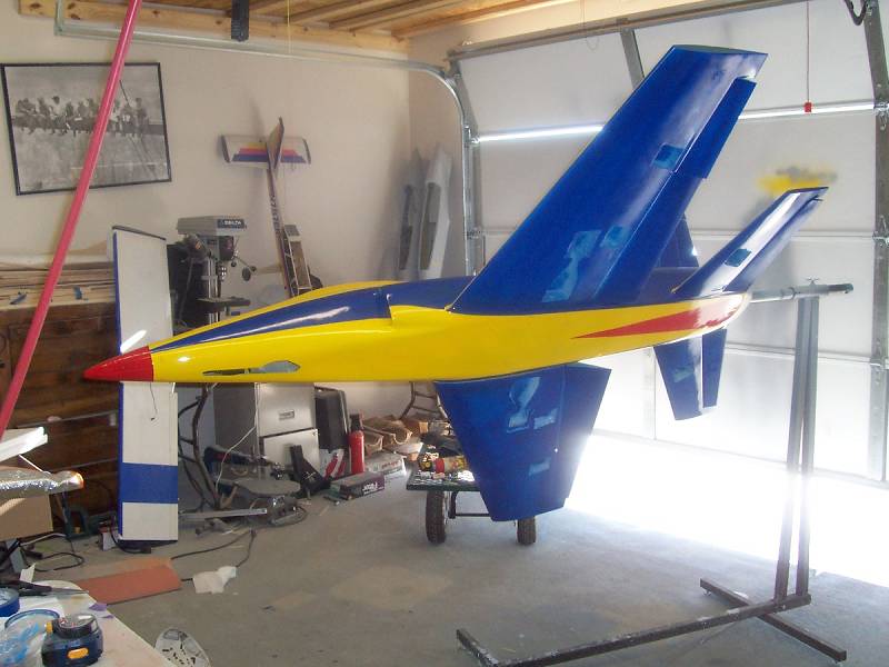

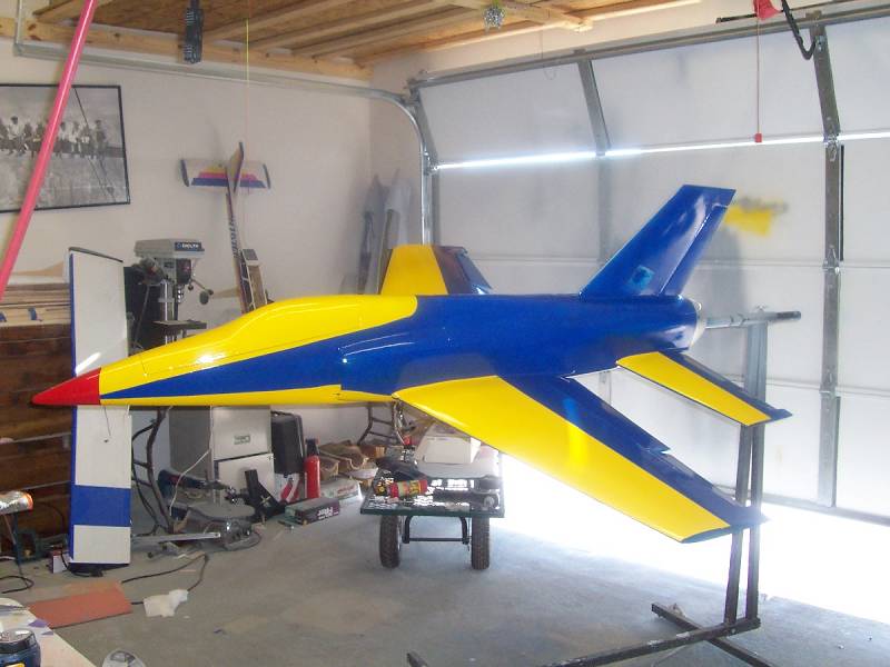

Got it painted, sorry so long since an update, I'll have the new and improved insides to show later!!!

Sean, love the paint scheme. Very cool. When do you estimate first flight? What motor?

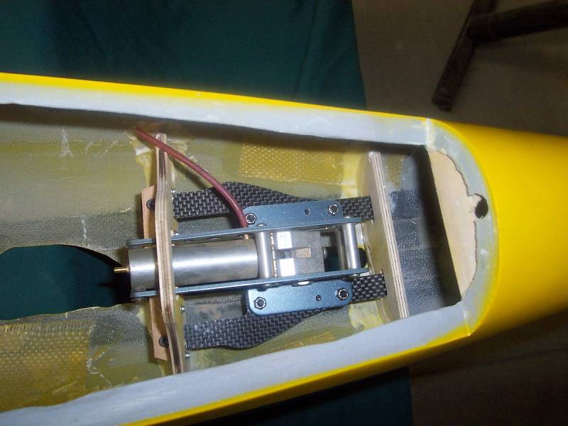

Jetcat Titan. It's got a Tams larger Diameter pipe, and I custom made a bypass a la BVM with removeable cover held by velcro. The nose gear has been retrofitted with formers from a Kingcat with BVM Kingcat Flex plates. The design is wonderful and really fits well in the front of the airplane.
The landing gear has been upgraded all the way around to Robart 635's. Intairco 3.5" wheels are on the way.
I didn't paint a circle at the cockpit cause I've got a custom cockpit designed speciffically for the isobar coming.
Gonna be Pretty cool!!
I'm probably going to maiden it at Mississippi Afterburner.

Other pics, Jetcat Titan, new nose gear landing mount system
