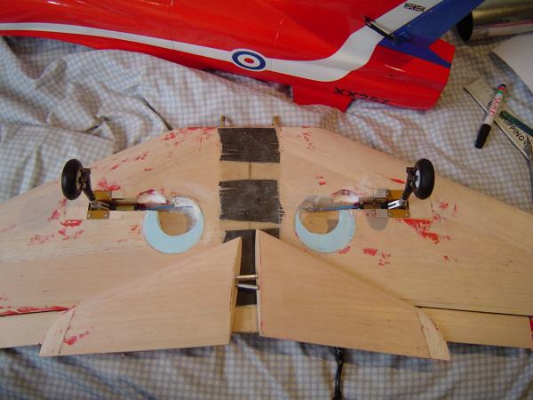

ORIGINAL: EASYTIGER
Do yourself a favor and do a good job here, or you will probably be doing it again.
Every AMD product I have ever seen, flown, or owned, had the same jokey retract mounts, and you are better off fixing them first thing when you open the box, because they are underdesigned, using low quality materials(like double layers of lite ply!) and poorly assembled. Seems like it's a price you pay for these cheap airplanes...I can live with it! But it's easier to deal with right out of the box than after the plane is built. Retracts through the top of the wing, or tearing out on a nice soft landing is NORMAL, not unusual!
ET
After SJN's experience and your comments, although not really wanting to, I took a screw driver to the mounts and it sure is the cheapest lite ply with minimal glue, relying on the strength of first layer of foam beads with zero glue fixing behind most areas. Thanks to you guys I've started the retro fix last night which will provide me with long term service. Still happy overall with this AMD Hawk model but it sure would have been much more frustrating without the help provided here.
Paul

Every AMD product I ever had had the same problem. It's one of those "you get what you pay for" issues, the planes are still a FANTASTIC value. The whole thing is easier if you just adress it right out of the box. Tear out those mounts and put in new ones. Any futher engineering you want to do to spread the loads on those mounts is cool, too, as the basic design is not particularly brilliant.
But the lite ply thing...even doubled up, that stuff won't really hold screws, it's too soft. Even IF the mounts hold, the screws will come out. Unscrewing the screws again and hardening the threads with CA will give you a few more flights, but it's just a temporary solution. Don't confuse "lite ply" with real plywood. I cannot tell by looking at the pic, but EVERY other AMD plane I have ever seen(except for this Reaper I have right now) had the same material in the mounts.

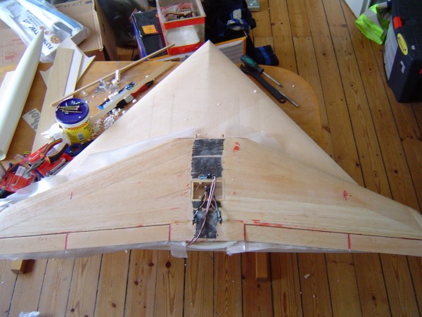

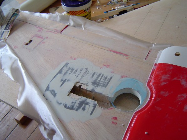

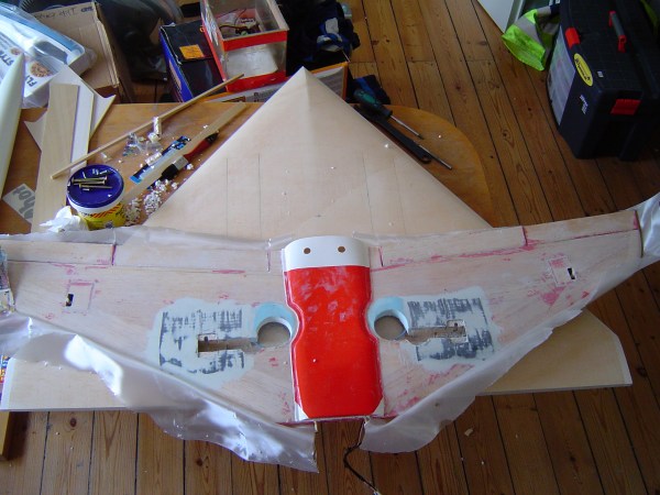

Im going to glass the elevators too........ prevent hanger rash

That looks like a solid installation. I can't face ripping mine apart at the moment so I have run thin cyano into all the joints and fitted two strips of triangular stock in the corners and glued this well to the retract box sides and the top skin as you suggested.
My Hawk only weighs 10lbs with the Wren 44 so I am hoping I will be lucky!!

John, I think you will be just fine!
If I had done the same as you before the first flight, im sure it would have held up. Zero glue, holds nothing
surly some others out there must have flown this plane by now.....come on guys.....chime in on your experiences!

I'm in the process of resurrecting one of these kits from its out-of-box crappiness. I have a vision of a nice final product, but what I'm starting with is pretty sad.
ianober, I am pretty sure I was bidding against you at one point on ebay for these, haha! We each ended up with a copy of the same kit. I believe this kit is worse than SJN's as the hardware is much poorer (judging by pictures) and quality control is lacking, i.e., my stabilizer anhedral bars are bent at different angles. My kit does include a stab joiner, but it is slightly corroded. One of my stabilizers is asymmetrical while the other is symmetrical. I can easily see through the covering to the wood. The fuse gelcoat is translucent. The fuse has no blue paint on it. The list goes on. What I wanted to ask you all about was yet another problem--the trailing edge of my wing is much thicker than the control surfaces. Does anyone else have this problem? Picture below.

Sounds like yours is a little different
Heres a pic of mine:

Heh, nice cross section SJN...they are the same width! On the other hand I guess they dropped the whole recessed hinge approach and went for straight TE to bevelled control surface. Easier to manufactur I'd guess.
I just ripped covering off one wing to start fixing up the landing gear and hopefully reshaping the trailing edge to match the control surfaces. In the process I have discovered some of the sheeting not glued to the foam around the edges of the landing gear and servo cutouts. Any ideas how to reattach this? My ideas were to try to inject white glue or finishing epoxy resin between the foam and sheeting.

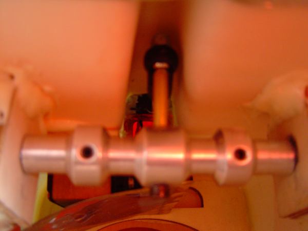

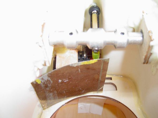

SJN, looking at your elevator/rudder servo mounts, are you essentially building them into the airframe such that you would have to cut away fiberglass in the future to get access to them? How can you get to yours?
I am trying to think of a way to make them accessible...such as with a removable panel in the top of the thrust tube (still awkward, but at least workable) or a panel near the rudder-fuse interface (might weaken the structure quite a bit).

well, not realy, but the servos would be a severe pain to get out. The elevator servo is fairly easy, but you need an ultra short screw driver, or a bit and wrench to screw out the 4 screws.
The rudder servo is rubber RTV glued into the fin. I can either cut the rubber with a stanly knife blade, or cut out a hatch on the side of the fin.
But these HS-5954MG servos I have installed should last this airfrmes liftime
So Im not counting on taking them out.

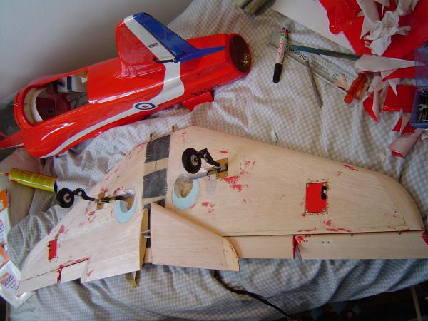

slow but steady progress on my wing [8D]
