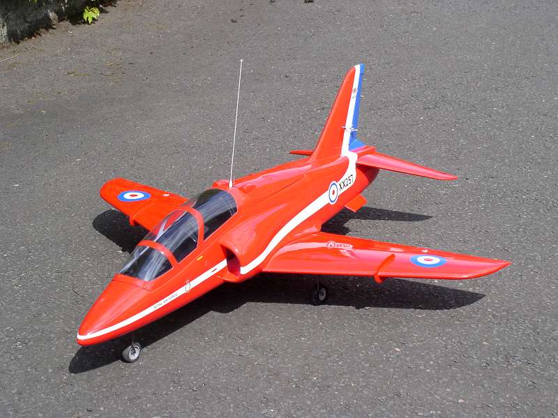

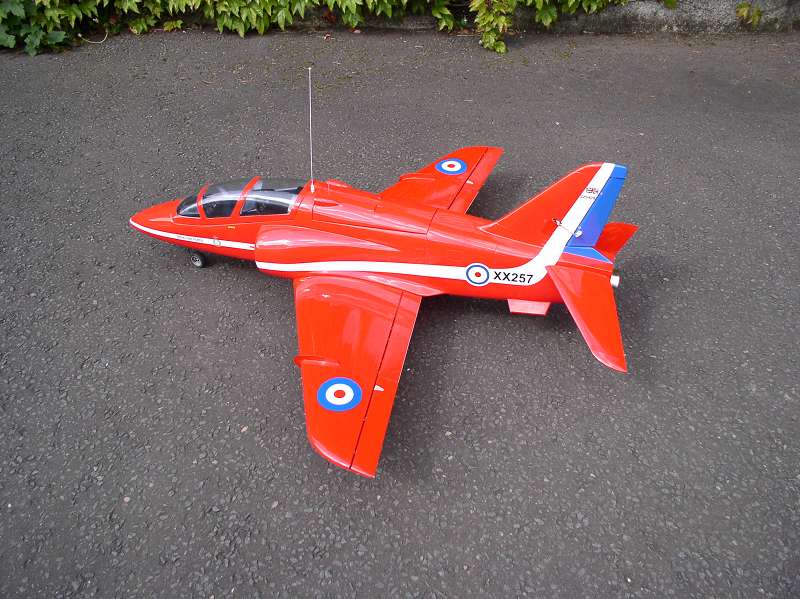

Go for a few taxi runs and check the steering is not into oversteer. From following the instructions - ours was and we finished up in violent swerves once we had some speed. Point of contact on the wheel must be behind the line of the axle. (Experts call it positive castor)
Assuming OK. For the first flight - use very little or no flap. Apply full throttle. When you have a bit of speed - she will start to bounce. Allow her to lift off but keep her very low for about 20 yards, while she accelerates. The problem you are trying to avoid is that if she is a bit heavy for the speed and you climb out normally and then she goes underspeed, she will go into lateral oscillations. However clever you are on the ailerons, these are hard to get out of. Full power and staying level is about your only hope. We have a prop powered Hawk that can clamber into the air at too low a speed and then plays these nasty tricks. Speed equals safety.
When confident of your speed then climb and turn into your downwind leg. When you have a good height start investigating the stability of the flaps at half movement. Roger of Wren Turbines has a super setup with crowe braking on the ailerons, which is really impressive. However before using the things in the air - check that they balance at height and that they do not provoke a wing tip stall. We tend to be very cautious with the flap even now. Better a fast controllable landing than coming in too slow and tip stalling just as you approach. Do not risk landing with full flap.
Both these photos show the model off the ground and from them you can see how far I travel near the ground to accelerate properly. The first two are in the wrong order.
Best wishes

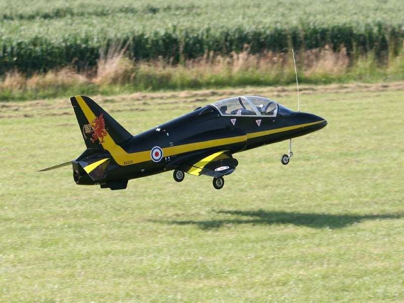

The Hawk is ready to go. Ran tests today including turbine run / range check all o.k. Final weight 10lbs 4oz dry CG 140mm back from LE dry 130mm back with full tank. All throws as per Wren turbines model including crow braking on ailerons (4mm up at full flap) elevator is mixed with flap to give 5mm up at full flap (45o) Test flight will be on Saturday.
John
John
#398
Joined: Jan 2004
Posts: 2,081
Received 3 Likes
3 Posts
From: glasgowScotland, UNITED KINGDOM
Guys

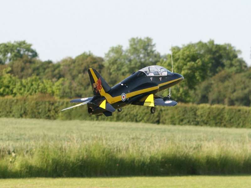

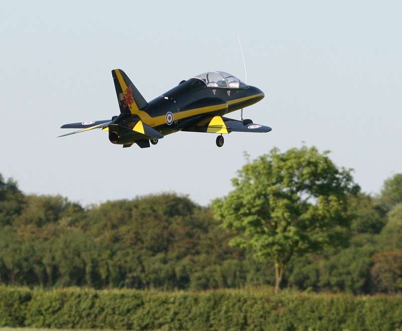

The Hawk had its maiden flight on Saturday, all set up as per instructions with CG at 140mm dry. The Hawk rotated off tarmac in about 200 feet and climbed out a little steeply using 20% flap for take off. No drama , just a dab of down elevator to let her build up speed and turned downwind ( Wind only 2/3 mph) flaps retracted and three clicks of down trim and she was flying straight and level, about 2/3 throttle required for nice scale speed, the Hawk is very nice to fly with smooth pitch response and a scale looking roll rate. Only tried a few rolls on this flight but very happy with flying performance.
Due to adverse comments about stalling with too much flap I selected take off flap for landing and flew a couple of circuits with the gear down at releatively slow speed and all seemed ok. Rolled onto finals, nose held up to lose speed and the model floated on past the pilots stance.
I did not want to risk a spool up and go around and landed the model about 70 yards away, misjudged the height, the Hawk bounced hard about six feet in the air and flipped onto its back.
Damage was limited to a shattered canopy and broken hinges on one aileron plus a few scrapes on the top of the fuselage. The landing gear was undamaged. I now reckon I should have used full flap to slow her down a bit more as the take of flap probably only added lift with very little drag, still it's a learning curve and a few hours work will see the Hawk airworthy again and I don't have to strip / renew the landing gear.
John
