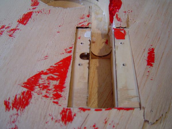

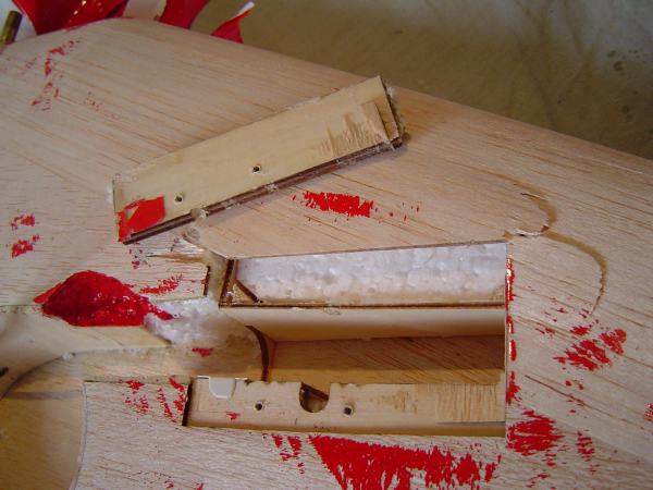

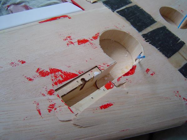

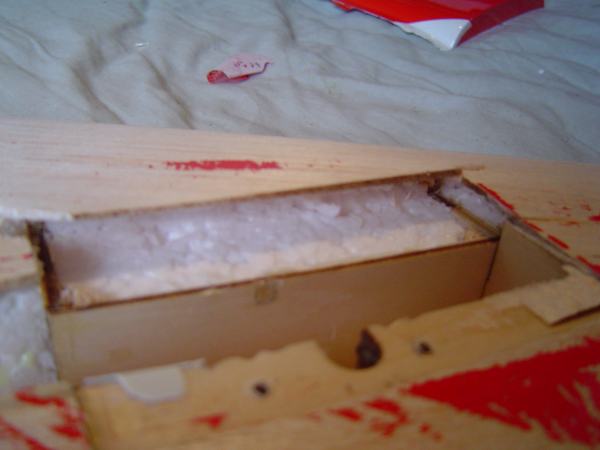

But, the gear mounting plates are so poorly glued in, that they both have been torn loose to some degree.
When the plane had landed, I did not realise this had happened until I began to refuel it for next flight. I could se some strange bulges on the top skin. When I looked undernieth, I could se that both sides had been torn loose. [:@]
I just could not believe it. The landing was silk smoothe.

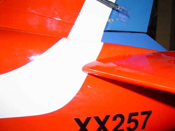

I was lucky, and the elevator neutral point was dead on
Here are some pics of the movement mine has.
First two are neutral
3 and 4 are elevator up
5 is full down.

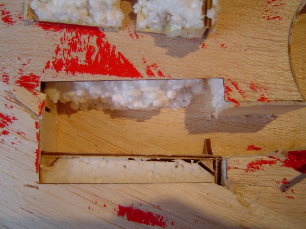

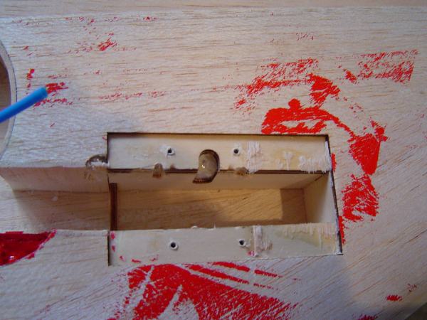

The way it is designed seems to be fine. But there is just too little glue on mine......guess I got a lemon wing.
The top skin has not been glued onto the mounting block on the left wing. My right wing seems fine.

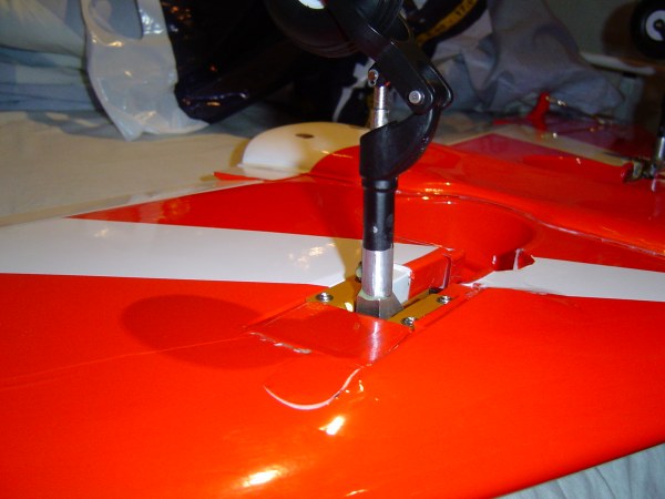

Every AMD product I have ever seen, flown, or owned, had the same jokey retract mounts, and you are better off fixing them first thing when you open the box, because they are underdesigned, using low quality materials(like double layers of lite ply!) and poorly assembled. Seems like it's a price you pay for these cheap airplanes...I can live with it! But it's easier to deal with right out of the box than after the plane is built. Retracts through the top of the wing, or tearing out on a nice soft landing is NORMAL, not unusual!

In my experience a wire leg with a spring in it (eg. springair) usually works best on smaller models flown from grass. The leg will bend and absorb the landing shock whereas the oleo strut will transmit the shock into the mount and expose any weakness there.
I found this with my 'roo and have not used oleos from grass since. The worst you will usually do is bend the wires which can be starightened in seconds.
Anyway, glad the Hawk flew well and damage is minor.

#340
The eurokit struts with the trailing link are perfect. Man....I wish I had taken the video now.....you arnt going to believe how good this landing was. There is no way ANY kind of landing gear would have helped here.
The problem here looks like that the top and lower skins have not been glued onto the mounts. Its the foam alone that is taking all the beating.
A quick fix might be gluing some triangle stock on the top skin against the ply mounts, and maybe rinning some CA glue between the lower skin, and the mount.....just be carefull it doesn`t run into the foam though

Easytiger, I think the desing is fine, but it just cant hold up if there is no glue in there...... They did not spare any glue in the fuselage, but the wing.....[:'(]
I think, though, the retract plates look like a double layer of lite ply. They use that because they cannot die-cut thicker plywood, so they double up th 1/8" stuff, and the ply they are actually usuing is usually "lite ply", not "aircraft ply", totally different stuff. If you look at most other more expensive jet kits, you will find the parts are bandsawed and sanded from much heavier material like 1/4" ply, because this stuff just does not hold up. But that's up to you. I would definitely replace the material.
Struts and grass don't mix on this scale, I have found. Wire struts are the way to go. If the plane is MUCH larger, struts are fine, but, basically, you have no fore-and-aft shock absorption with just the oleo struts, and that's what you need, more than up-and-down, when flying off of grass. I don't think the struts versus wire would have made a difference, in this case, nor 1/4" plywood, none of that is any good if the mounts are not glued in in the first place!
But save yourself doing this job AGAIN, and make things nice and strong.
Notice BVM uses a breakaway system called "flex plates" because he recognizes the loads incurred here, and that the worst thing to happen, and the hardest thing to repair, is a torn out gear mount, so they make the acutal mounts incredibly strong, then put in a breakaway point that is easy to replace. It's very, very smart.

Im not overly disapointed that my gear mounts have failed. My plan was to glass the wing anyway.
But ofcourse, its a bummer to have it happen.
She will fly again!

well, I did not fly it myself.....but it was flying at half throttle all the time. I do not think it is over powered with this engine.
It came down nice and slow without flaps, so it doesn`t seem to be overweight.
I have to fly it before I come to any conclusions for you guys
And no, de-rating the turbine is not a good idea when flying from a grass field. It needs all the afterburner it can get , to get away from the tormenting grass
If you look at the last picture Stig put up, you can already see the left leg has been torn backwards already.....the nose hasn`t even touched down there.
