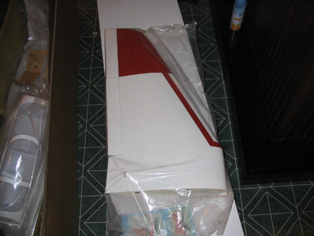

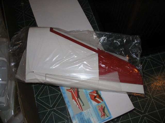

Hey guys,
I got what I thought was going to be the Red Arrows Hawk from Ebay today. It came out of the box in a T-45-ish paint scheme. I like it, but it threw me off! Construction is excellent. Everything fits very well. The paint and covering are excellent as well. The fuse formers are rock solid. I want to put a MW-44 in it, but I don't have a place to fly it locally. I have a 500 ft paved strip, but our flying area is adjacent to a large park and we have a very small box to fly in. Guess I'll have to go with a .45-sized DF. I paid $170 for it, and it's worth it. I got it from Grace in NYC. I'm pretty happy.
Will
Will

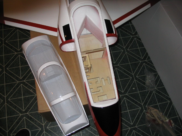

HI Will,
It sure looks like you Gae a Hawk in T-45 clothes. It still looks good. In fact it looks just like my Red Arrows Hawk except for the colors. The interior plywood is the same as mine, so let's assume it's the same kit.
Hopefully, yours is much better than mine in several areas. My rear bulkheads were very poorly glued in The glue was more like a hot gun adhesive that never got hard. I had to glue them in myself, as the all came loose.
When you start to cut the canopy our of the piece it was vacuum formed from. go slow. To begin with only cut away the ends so you can fit it over the curve of the fuselage. IF YOU CUT IT to the line that looks like it will be fie finished size, it may end up too small. I almost did that. The sides had to be left about 1/8 inch longer than the imprint in the plastic, and the front and rear more than that. If I had cut to the impression in the plastic, it would have ended up so short it would not have been able to lay over the fuselage recesses on both ends.
You may find other areas that need some attention once you get into it. Mine started out as an ARF, but has become a project. It's till easier than starting from scratch.

Joe,
Thanks for the heads up. I'll go slow with the canopy. Of all aspects of model building, canopies are what I hate the most...by far. I wish mine was already done! I'm going over the model with a fine toothed comb. I still may add some glue around the formers. What did you use to secure yours?
Doug,
Mine is clearly a knock off...just simply looking at the paint job. It has a wood wing. I've heard some had foam wings. That's the part that concerns me...no way to go in and make sure all the parts are bonded well. Just on that alone, I am more tempted to put $300 worth of ducted fan stuff in it rather than $2500 worth of turbine in it. I'm sure it'll be fine, but I don't know if I'm ready to take that leap of faith.
By the way, the instructions suck. They weren't even in the airplane box. They were in the shipping carton around the actual box. Go to the AMD site and download the manual there. That's what I did.

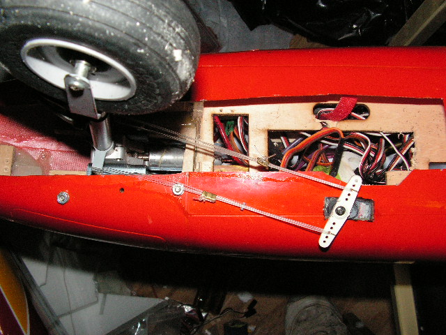

Hi again,
My version is the built up wing. As for the bonding, I was very suspect. I squirted liberal amounts of thin CA every where I could reach. HINT. Be sure your hinges are not stuck into the holes before you do this. In fact, that woudl be a good place to put some CA to be sure of getting it in the outer structure. It can't hurt anything and it sure won't add much weight.
For power, I 'm going with the DynaMAx fan and OS .77 VRDF. I had this package in an old JJH F-86 and it flew great. I don't know how the weight or area will compare, but I think with the flaps, this should be OK.
BTW, I plann to make up a new tailpipe. What I was provided with was stiff (not a problem) and very heavy. It weighs six ounces by itself. I know I can cut that in half. There is no structural issues with a light exhaust duct, other than it holds together and is fuel proof to keep the aft fuselage from getting soaked.

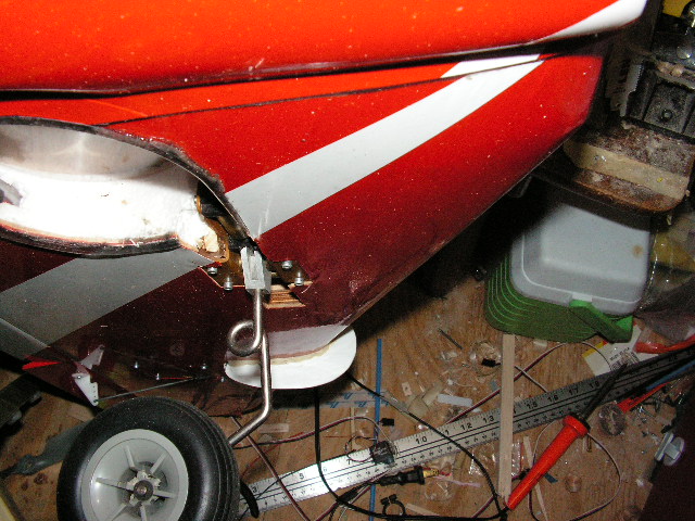

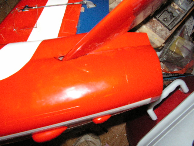

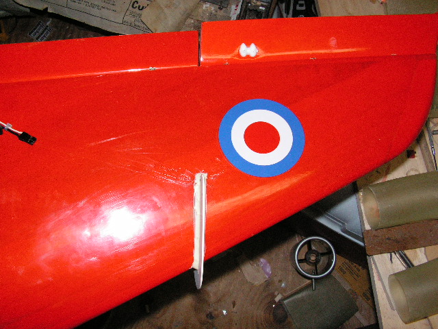

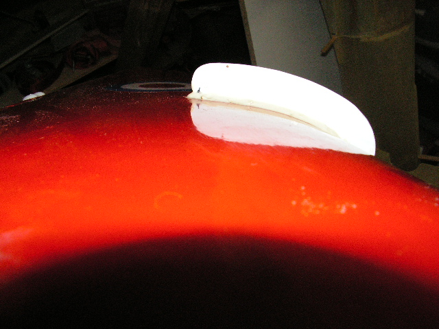

Make sure you add the fences on the wing! With those it is basically un-tipstallable. Mine flies off grass with cutouts in the rear fuse side to allow TRIPLE the stock throw values and when I rotate off grass I've got full up-stab. No tipsall problems at all, it likes to drop the left wing a bit as it comes off but it is easily corrected with aileron and it flies away.
I have some packing under the fan ears to center my fan a bit, I use the JMP pipe system. You want the header they sell for the F-18 which has a 6 degree angle machined on the face.
#537
My model does not have the wing fences. I can make a set pretty easily. Do they line up with the line between the flaps and ailerons? How far back do they extend on top and bottom... I'm actually a little surprised they are also on the bottom of the wing.

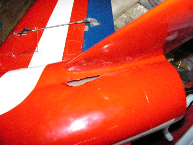

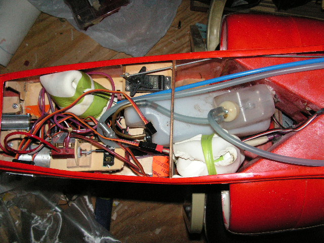

Someone posted a drawing in one of these AMD Hawk threads last year - I either used those patterns or drew some the same shape by eye, I forget which. I'll take some pics in the next day or two. And yes, I believe the aileron / flap break was exactly where I put em.
The plane is in a place I can't get to this time of night
. The pic above is pre-elevator mod, I'll get a pic of that too.

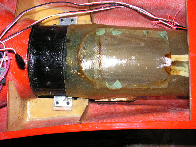

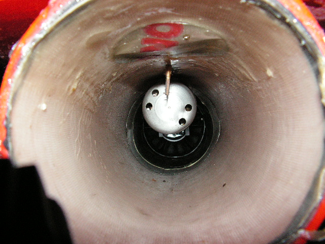

Hi Chris True,
what pipe do you have in your .91/Dynamax? Looks like yours is shorter than the usual.
The one I have (on a MB339) is quite long and I have to put more weight on the nose to compensate and therefore the total weight increase also.
Thanks.

That is the Jet MOdel Products twin outlet pipe, the one for the F-18 I believe. Originally I had the standard JMP single outlet pipe but it is in a corn field in Pa
either works fine, they both weigh about the same.
