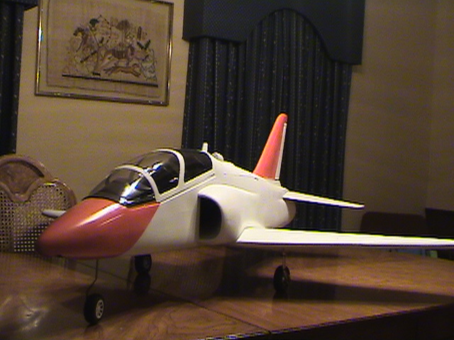

Ok, so it doesn't seem like I'm a poser, I'm posting some pics too. BTW the KMP comes with retracts for $599 and I can guarantee that there quality is "better" than the original JHH kit, the others I cannot vouch for, if there are a total of 4 kits manufactures out there I would be kind of leary of buying the cheapest one on the market.
Anywayz I also repainted mine to a T-45 scheme (my brother is in the Marines), and its not totally finished yet, still have some more painting left to do, but I do have my turbine mounted, its the FTE-500 (same as ram), however I have not mounted the solenoids, ecu, or fuel pump. The FTE is bigger than the wren, I'm just a little worried about fuel tank space, but I think I can make it happen. Right now mine is at 11.5 lbs with the turbine, all servo's, batteries, and reciever so I'm hoping to end up at around 12.5lbs. Besides the 6 in wide Carbon Fiber I also upgraded all the pushrods to 4-40 rods. Here's a couple of quick snaps that I just took.

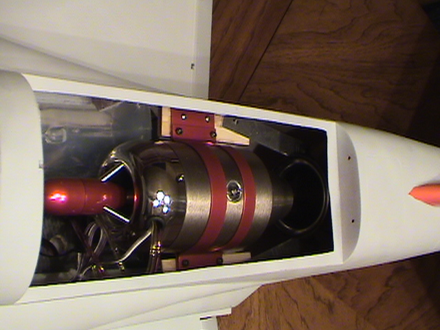

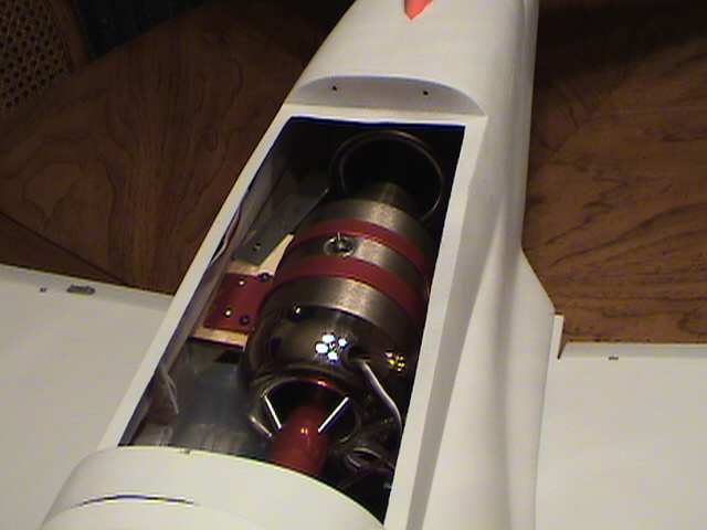

Looks good mugenkidd.
Do you have alot of downthrust from the engine when mounted on top of the engine mount ?
Looking into the rear end of mine you can see the engine mounts are far from centered in the DF thrust tube.
Ive been looking at some Turbax 45 pics, and it looks like the mounting flanges on the DF unit are not centered in the 9 o-clock, and 3 o clock position. ??
Im going to shim the mount up on the lower side of the mounts in my jet, and install the engine on that.

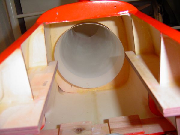

Thanks Michael
But just look at the first pic....there is no way that the turbine will be centered if I install it as it is
But the angle is all right. If i lay a carbon rod on the engine mount passing through the duct, it lies parallel.
But the engine will have to be lowered.

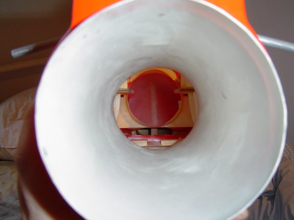

Chris, I cant realy take any better pics of the rudder servo.
I have "glued" it in with some RTV. It is sandwiched in the fin, and will go nowhere. I have had great succes with this method on other models.
Its located right above the elevator servo.
If you look closely on pic number 4, you can see the bottom of the rudder servo....
Any pics of yours ?
