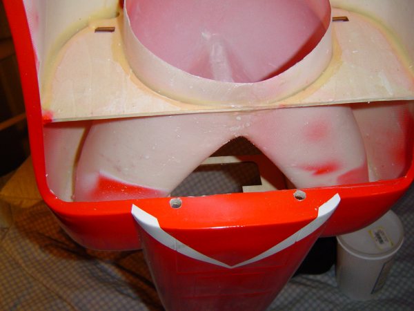

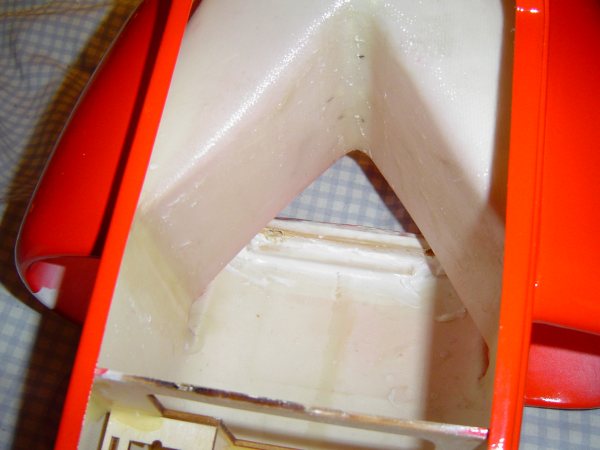

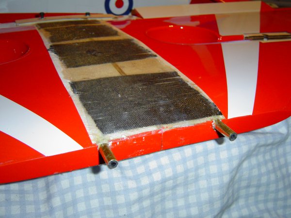

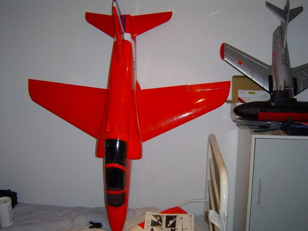

Old 03-21-2005 | 07:09 AM
  #84
SJN
Posts: 6,326
Received 7 Likes on 7 Posts
From: Copenhagen, DENMARK
Default RE: AMD Hawk.
No landing gear in my kit. Only some 4mm wire struts, which do not fit the springair retracts.
I carbon and glased the wing joint..

I installed the wings today. I beefed up the wing saddle aread both front and aft.
The wooden dowls where replaced with 7mm brass tubes, with carbon fiber tubes inserted into them.
