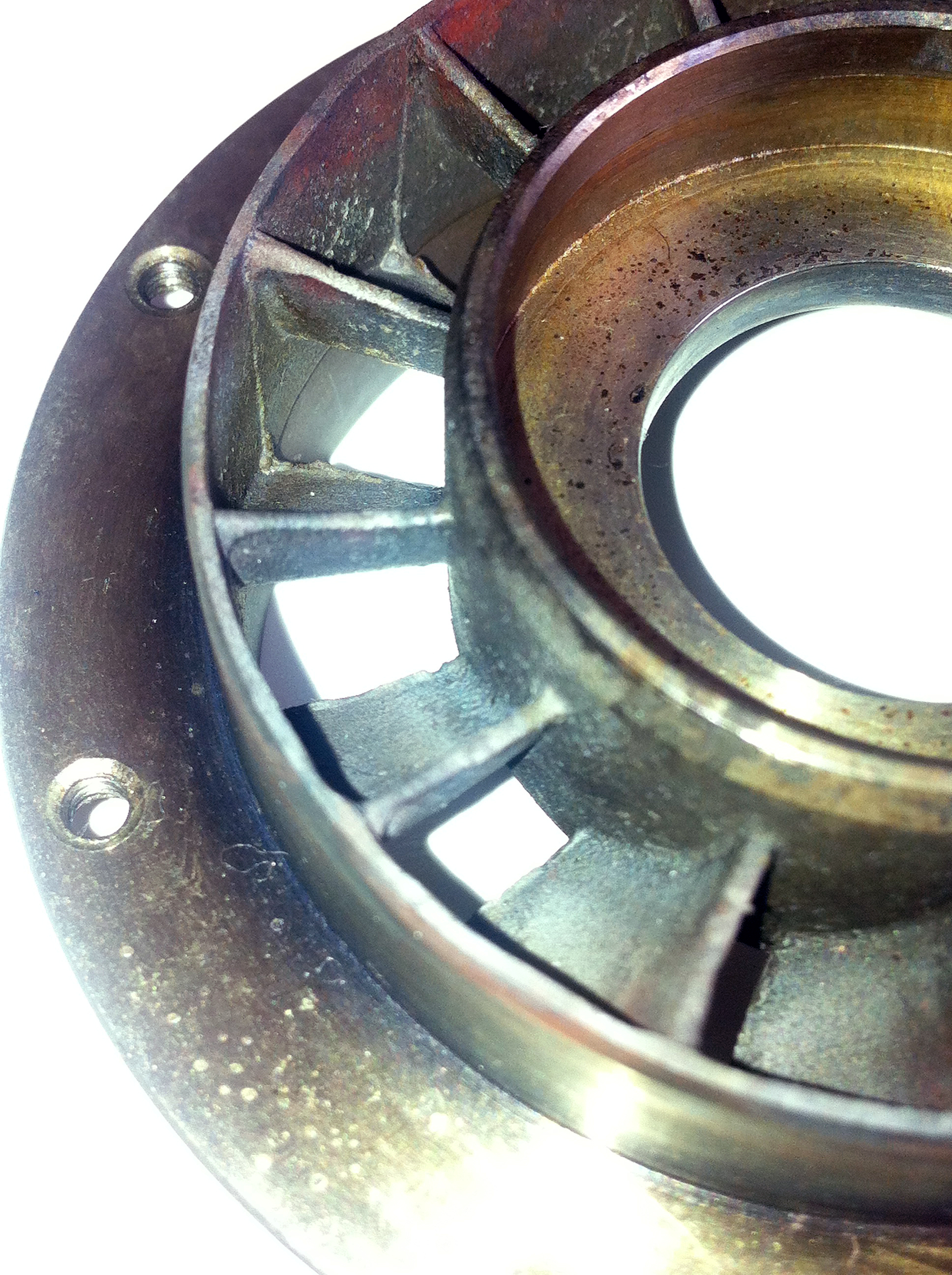

Joined: Jun 2017
Posts: 9
Default NGV erosion
Hi all,<br /><br />had my jetjoe for a long time, I think had it 2004 when they first got brought to the uk. Anyway, not used it for years, it's done around 10 hrs use and I thought I'd strip it down after reading xairflyer's thread.<br /><br />question is, I notice heat erosion on the NGV, OK, expect over time I would, but how much is too much ?
If its only discoloured then just a matter of cleaning it up, only long time effect will be bigger clearances etc, just would change it when noticeable drop in power, but shows how poor quality the metal is as true inconel wont do this so soon.
Whats your shaft like ? normally when they lie up for a while you the shaft starts to corrode

Joined: Jun 2017
Posts: 9
It's all good, thought I might find the combustion chamber corroded but nope all good. Shaft good too. Light the injectors as you showed and burned equally. Great thread/post xairflyer, been put off stripping it, but your post was very thorough.
NGV has over heat damage, I'm sure, I'll try get a better picture. Funny, but the casting of the NGV has some raised tiny ridge and I'm thinking that's lead to a change in the gas vector which has concentrated the heat, might try and grind that off, it's only tiny, but !
what did you clean the NGV and turbine wheel with?
Also, ANYONE ! I've the old Gaspar fadec with the old black hand held until which has gone belly up. Does the computer USB lead allow monitoring during start etc or has anyone got an old one I can pinch or buy ?
cheers
ian
I would just clean up the ngv with fine emery paper and/or a steel wool.

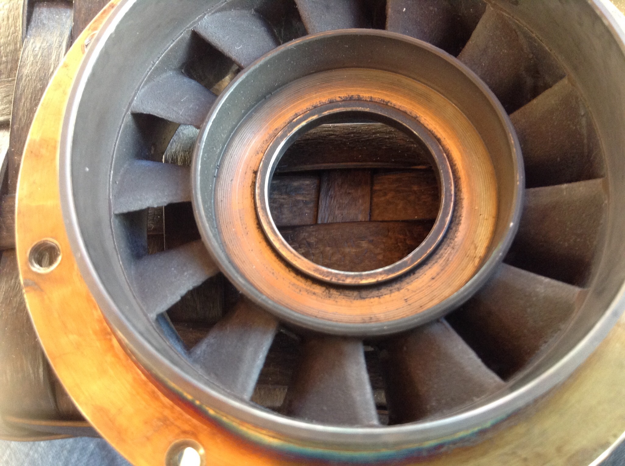

Joined: Aug 2016
Posts: 23
From: Oxford, United Kingdon
Hi Ian,
This is what the inside of my NGV looks like for comparison. It's quite nasty but the rest seems to be in good order.

Must be a bad fit on combustion chamber

Joined: Jun 2017
Posts: 9
Thx for the pic Daz, it's difficult to clean the NGV, could do with a fine blaster haha...rebuilt the turbine this am and semi run it on gas. Not got a HDT so didn't want to give it too much heat as I can't tell the EGT.
